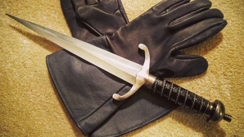

My daggers are Chinese and came in a case of six, all in individual boxes. There is no brand on the box but you can find them online using the tag Vendetta H-5536.
http://img.tapatalk.com/d/13/08/17/8ugatyza.jpg
They are stainless steel.

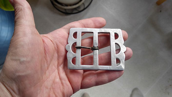

Does anyone still produce the belt buckles? Or belts? I'm going to be putting some V stuff together soon and I'm just trying to locate some pieces! All these threads are very helpful! The belt patterns look good... I may have to have a crack at making one if I can! Thanks in advance.
I had this made last month on Etsy from a seller named TheIronRing. They had a similar cast pirate buckle and created this design based on lots of photos and measurements from here. Price was $60 US. I don't know if you could get it for less now that they have a mold. It's a nice, solid, lightweight buckle. I would have liked it a bit more smoothly polished for the price, but otherwise it's quite nice.

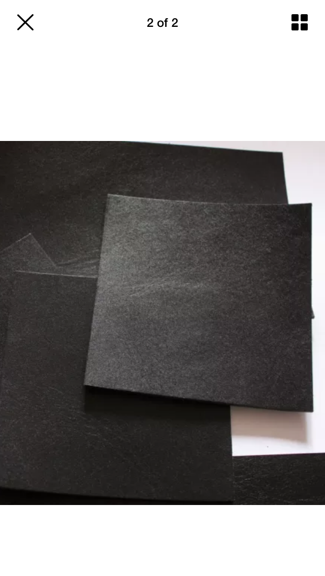

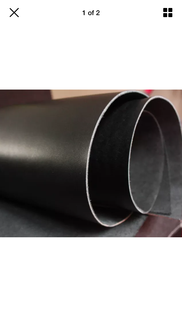

Hello! Quick question... is 2.5mm thick black leather hide the right way to go with the belt? I have someone who is providing me with some leather and wanted to know thickness. He also asked if I'd like it in one long strip of 40" by 15" any advice on this would be great! I'm going to try my best to follow the pattern. Would you be kind enough to post your most updated pattern links in a new comment below just so I know I have the best possible start? Thanks for all the hard work. Looking forward to making this.
2.5mm may be fine if you double it for a 2 ply belt otherwise it's too thin. Thickness in leather is not always consistent through the entire hide so I'd recommend you to go with 3mm if you can just to be on the safe side. 40" is just enough for a size 30". If you're not a size 30", you'll need a longer piece of leather.

Thanks for the reply! So 2.5mm double ply is 5mm. I'm having trouble finding a nice solid 46" x 6" piece that is thicker than 2.5mm right now so I think I'll go with a big enough piece that I can double ply it. Am I right in thinking that 3mm single ply leather would be the thinnest I could use if it weren't doubled? Sorry for all the questions just wanna get the right start.
I should be able to get a hold of some 2.5mm thick black leather size 43" x 20" so I'll get a full double ply belt out of that I think. The belt sits around the outside of clothes I'm probably 32" there so fingers crossed I'll be able to knock one up.

3mm is too thin for a single ply belt. Your belt needs to be at least 4-6mm thick overall, whether it's from a single ply or two. V's belt is 2 ply anyway so you should just go with that 43x20 piece. You'll even have enough for two 2 ply belts.
