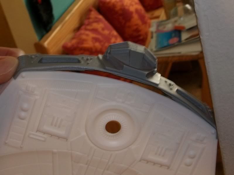

This piece does not fit.:eek
I can *make* it fit by taking off a few mill or so in the center of the part, it'll get covered anyway, but man, this slows it down.:angry

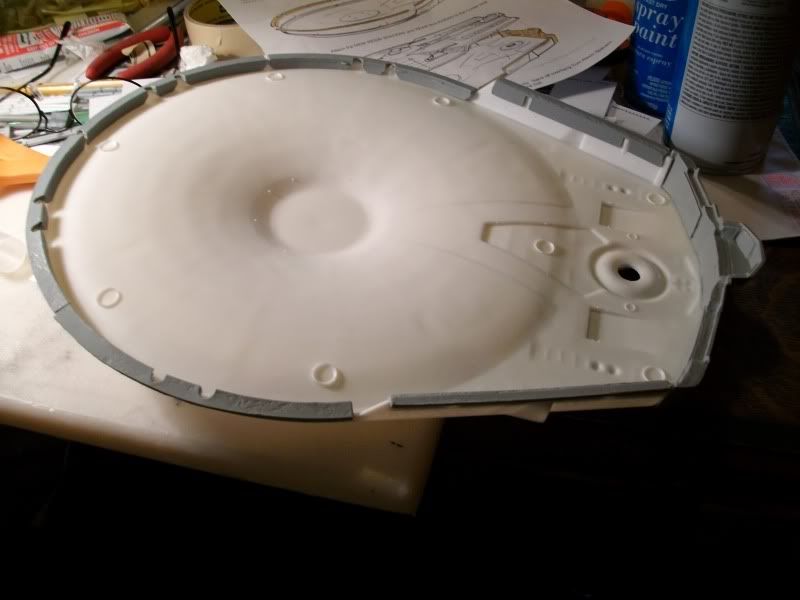

I think I'll see if I can shrink it just a bit before I cut it...
If the primer sticks, then you got all the release agent off.

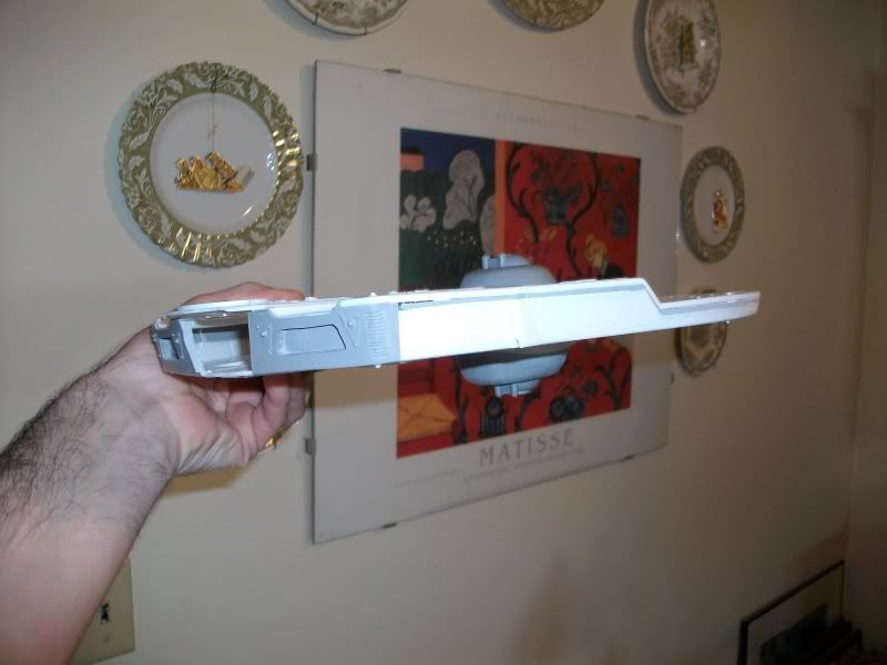

Hey- I solved my fit issue with a hair dryer & some creative sanding- no cutting necessary!:thumbsup
Oh okay. I thought Steve was talking about how to get the part to fit. He was actuially talking about the release agent removal.
Two words. Heat gun! The LHS has them for model airplane covering and they are about 19 bucks. Better than a hair dryer. Great for garage kits because they all get warped no matter what you do except let the part sit in the mold over night. at that rate people would get their kits next year. I've learned this well over the last three days of casting up hundreds of parts for my kits.
All resins have a memory so when you hit them with the heat gun they return to their original cats shape.

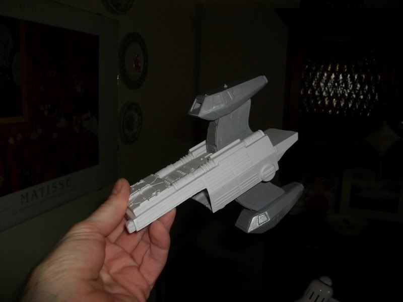

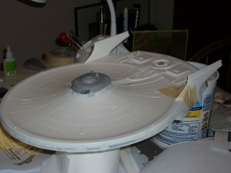

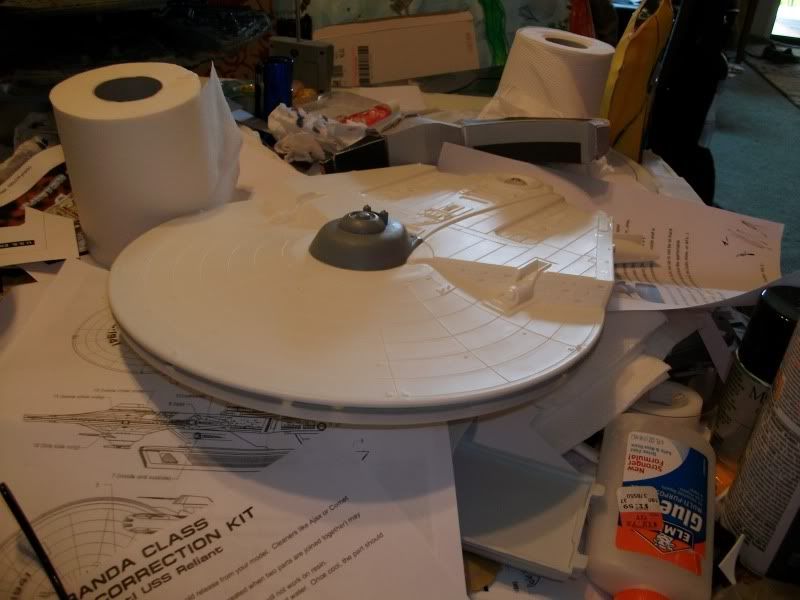

More progress:
Man, there is more SANDING on this project than any other I've ever done, given the size.:wacko
