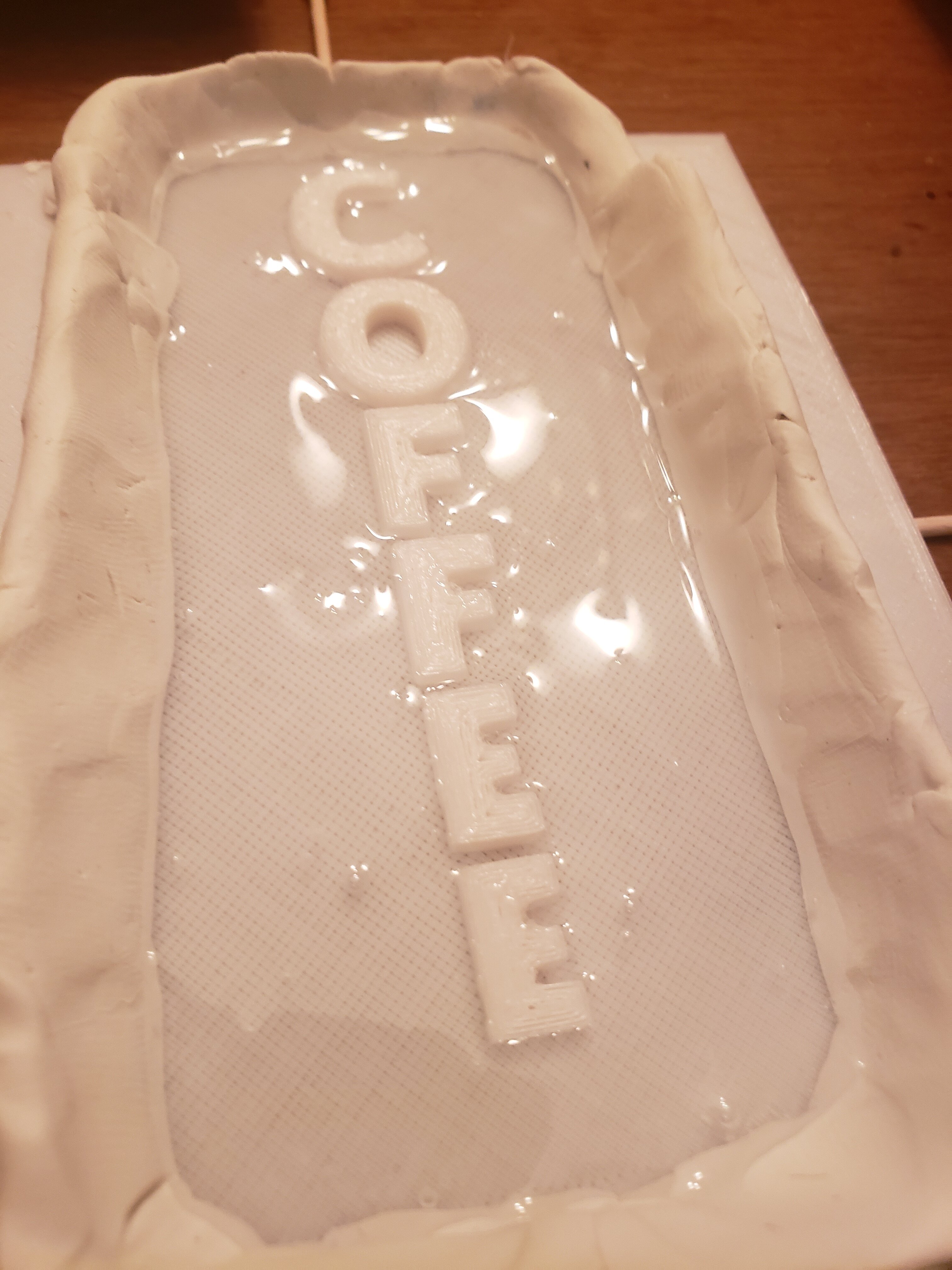

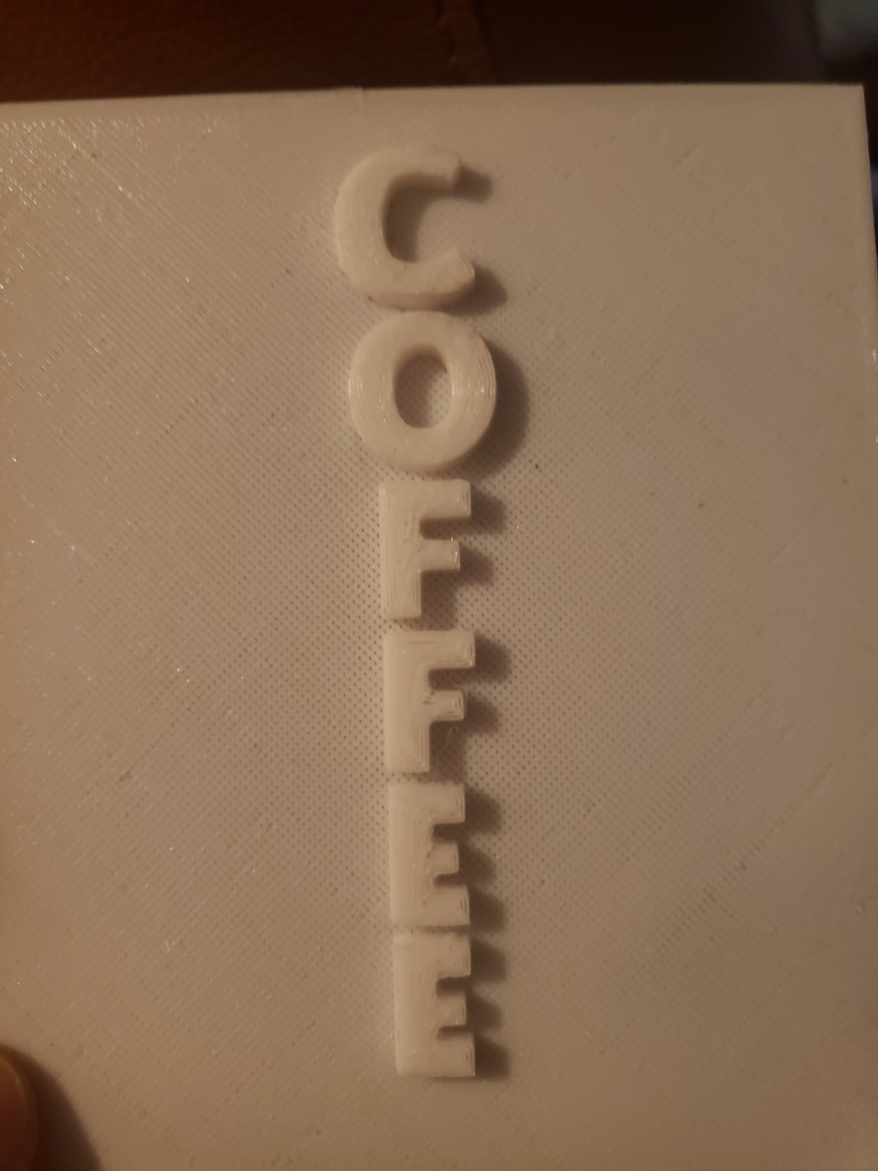

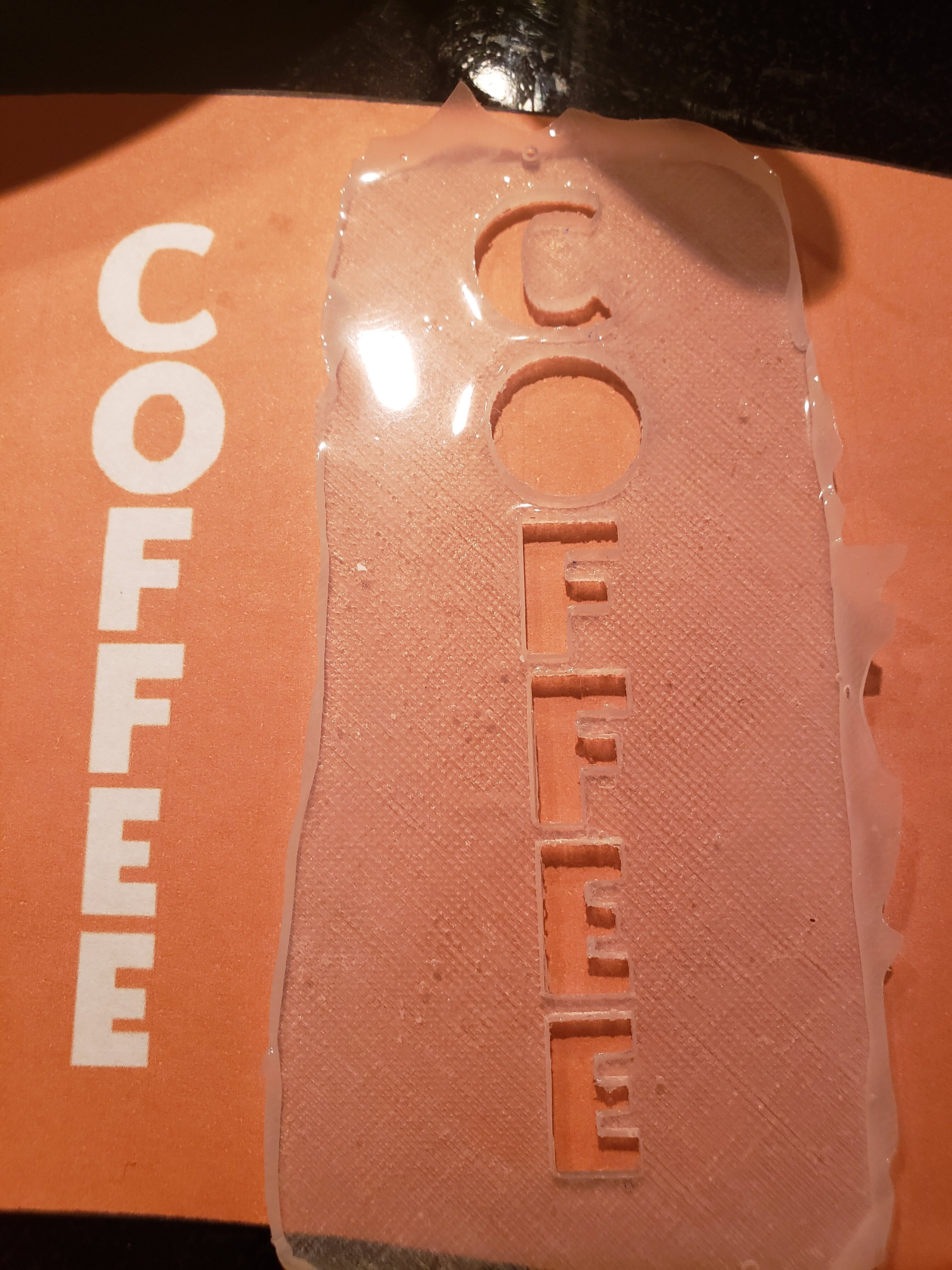

I recently used a 3d printer to print out letters, then used Sorta-Clear40 to make a stencil. Sorta clear could have been used 3d as well
