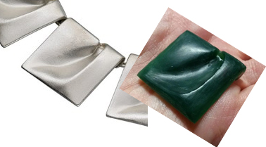

It does need to be shaved a touch on the bottom, but it over-lays with the picture fairly close, mine measures about 28.5 x 27.5, I calculated the % shrinkage that resin claimed it would have. As I said, I anticipate having to do this again so at least this way I have my measurements down and can see what, if any shrinkage it will have so I can better calculate the second version and hopefully improve my shape. (I wonder when I get to metal, though, if there's a shrinkage to it...) Since this first one is resin, I can easily sand a bit off the bottom to remove a bit of the squareness.
This is mostly for a costume, but I always strive for accuracy! That's the fun part! I'll work on this first one with what I've learned and hopefully you guys who know more than me can give me more tips on how to fix my inevitable mistakes o_O

As for your piece, I wouldn't worry too much about shrinkage, at least not with resin (depending on the type you choose to pour). Check Smooth-On's data sheets, the shrinkage is listed there. Silver, pewter, white metal, etc. may be different though, I've never worked with them.
Out of my own curriousity, and because I'm stuck in a project of my own and need something else to think about, I still think you can do this in a two part mold. I'm trying to work out how to incorporate the vents and sprue into it. If I have time this weekend I'll see if I can rough one out in Super Sculpey. I have half of it sorted on paper but I just can't "see" that last piece of the puzzle yet in 2D.

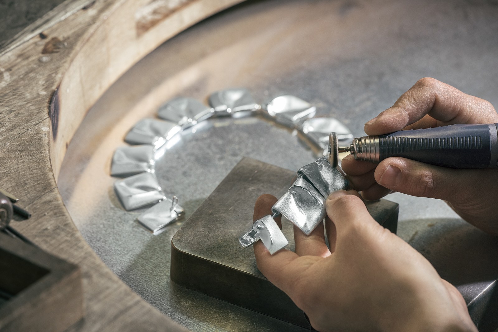

Here's a pic I found from Lapponia while Googling around the other day that shows someone polishing the pieces with a buffing wheel on rotary tool...

I've cast bronze before, and it comes out with a less than polished surface, but nothing as rough as what those silver pieces look like. It's almost like they were sand cast.
If you look at that image, they are not polishing the main surface, they appear to be focusing on the raised edge. If you look closely at this image....

...you will notice that the raised edge is not textured, it is smooth giving the detail more pop. Not something I noticed prior and would not have except for your image.

But yes, the texture is interesting, I didn't know if that would happen by putting the silver in a tumbler prior to polishing or what. I'll have to see how the cold casting turns out. I might even try pressing Silver Clay into the mold and firing it.
