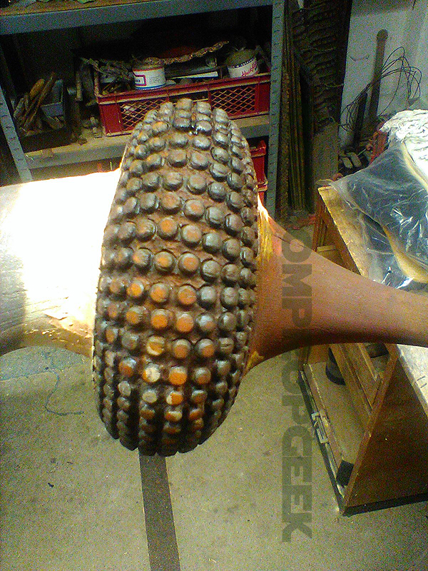

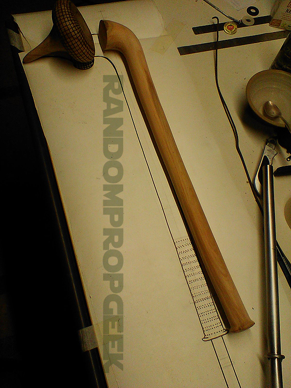

exactly what i did! would you mind sharing pictures of the one you made?
Not at all:

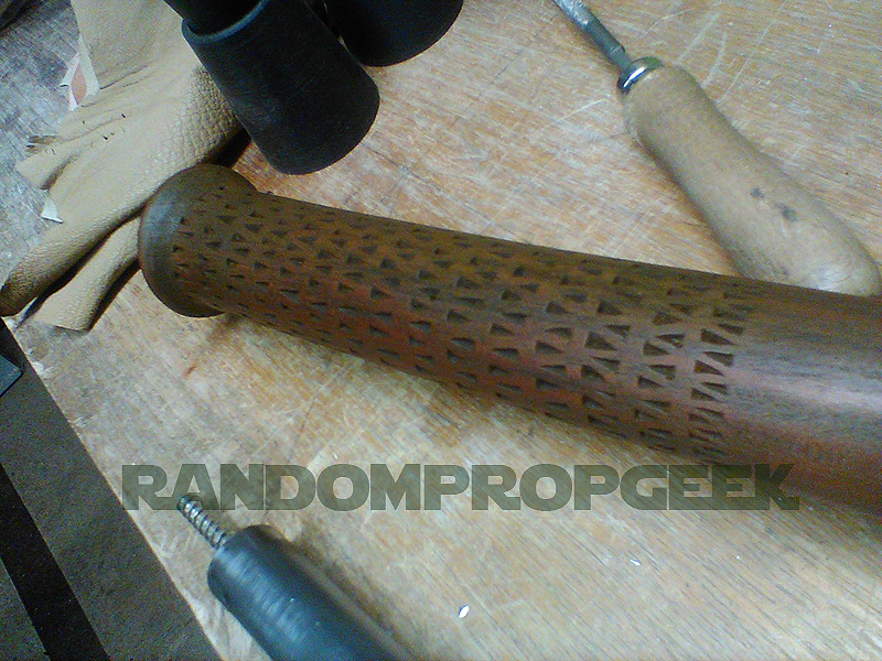

Can I ask how you did the wood handle?
Amazing work!!!!!!!!
Shure thing:

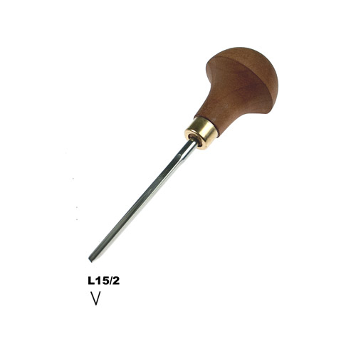

It's made out of cherrywood, sawn, filed and sanded. The cutouts are done with a traditional wood chisel called "goats foot". It has a "V" shaped blade which you make the main cut with( wedgeshaped), then you use a sharp pointed knife and cut out wedge. You get the chisels in various sizes and angles. Here's a german vendor that sells them all:
