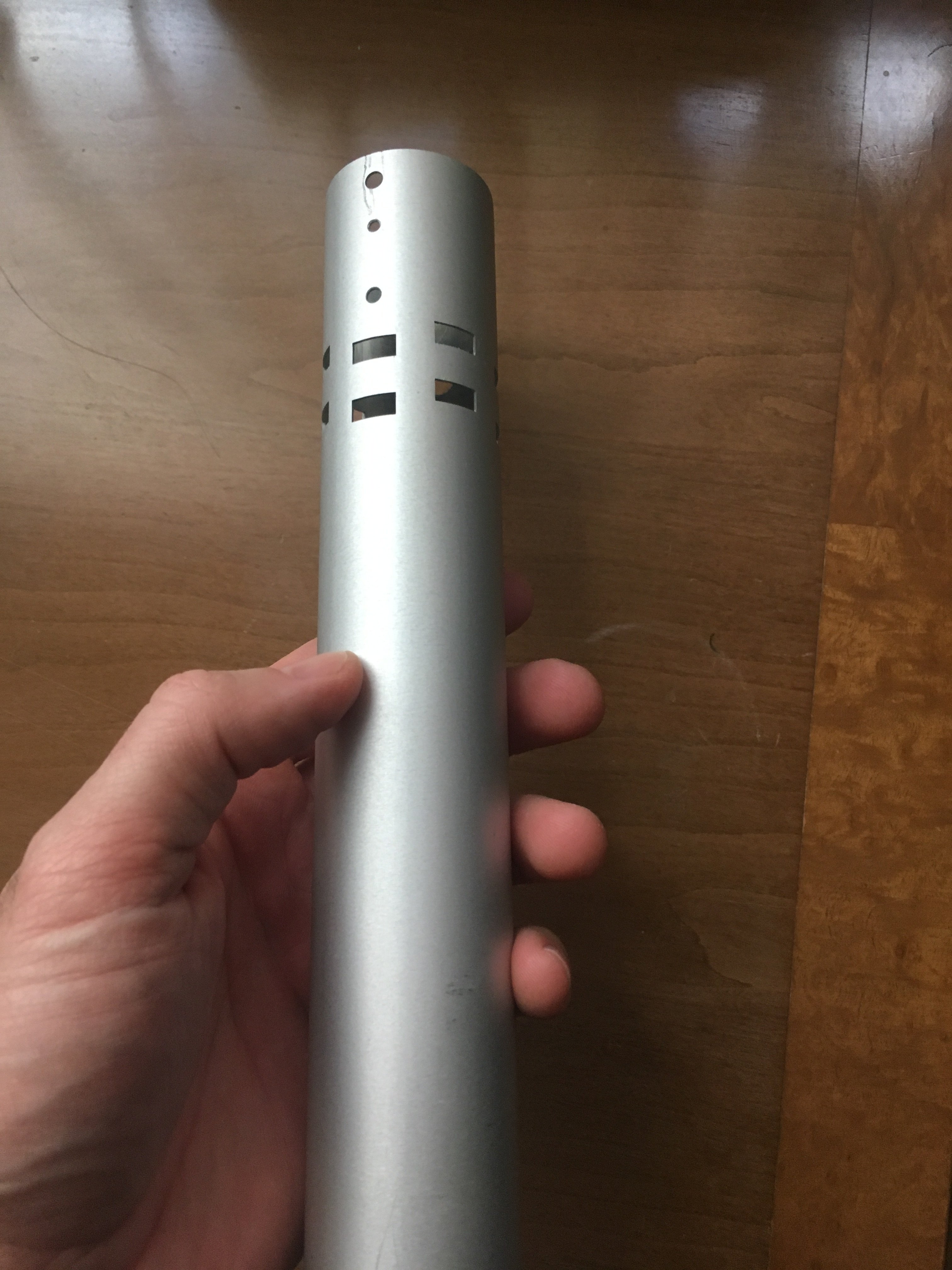

I used my drill press as a lathe to slice the endcap in half, and then sand it to diameter. It's now stuck in the bottom of the tube, without the sleeve. Unfortunately this tube is VERY soft, and part of it split while I was tapping the endcap into place. No pressure fitting guys!

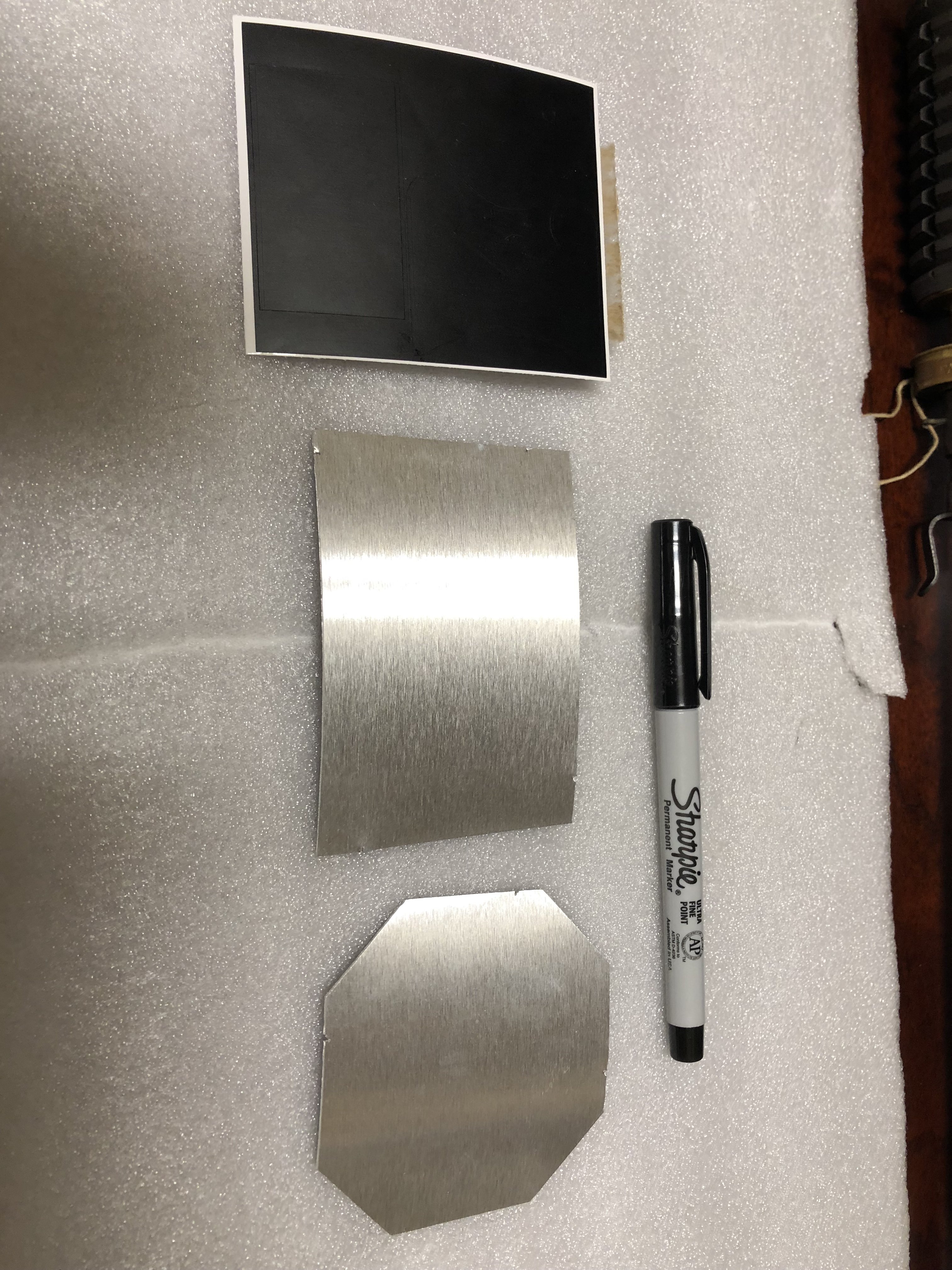

I had .016 inch hobby aluminum sitting around, but it seemed too thin.
I also have a large bag of scrap aluminum from my R2-D2 skins. It’s .035”.
Ready for cutting!

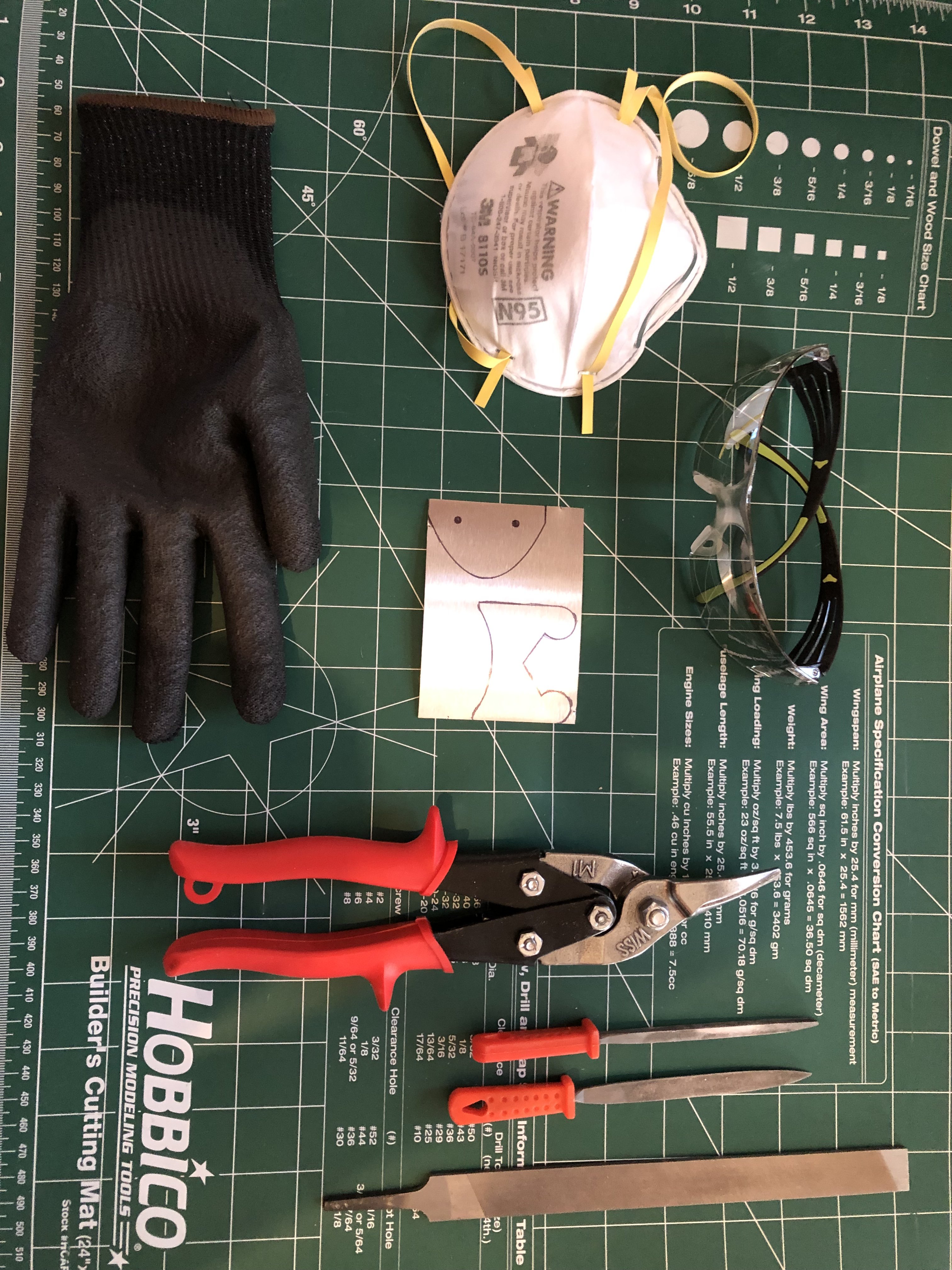

This is great! I was so worried that it was boring, I hope showing how I cut the lower shroud helps
I cut all the way into the corners to keep the corners as sharp as possible
The gloves also helps protect you from the sharp edges
One other thing about the gloves is.. we are sanding aluminum, and making aluminum powder
I know when I’m making the explosives for the pyrotechnics company i would for, there is all sorts of warning labels on the powdered aluminum.. so it’s not very good to get on your skill, I believe your body absorbs it..

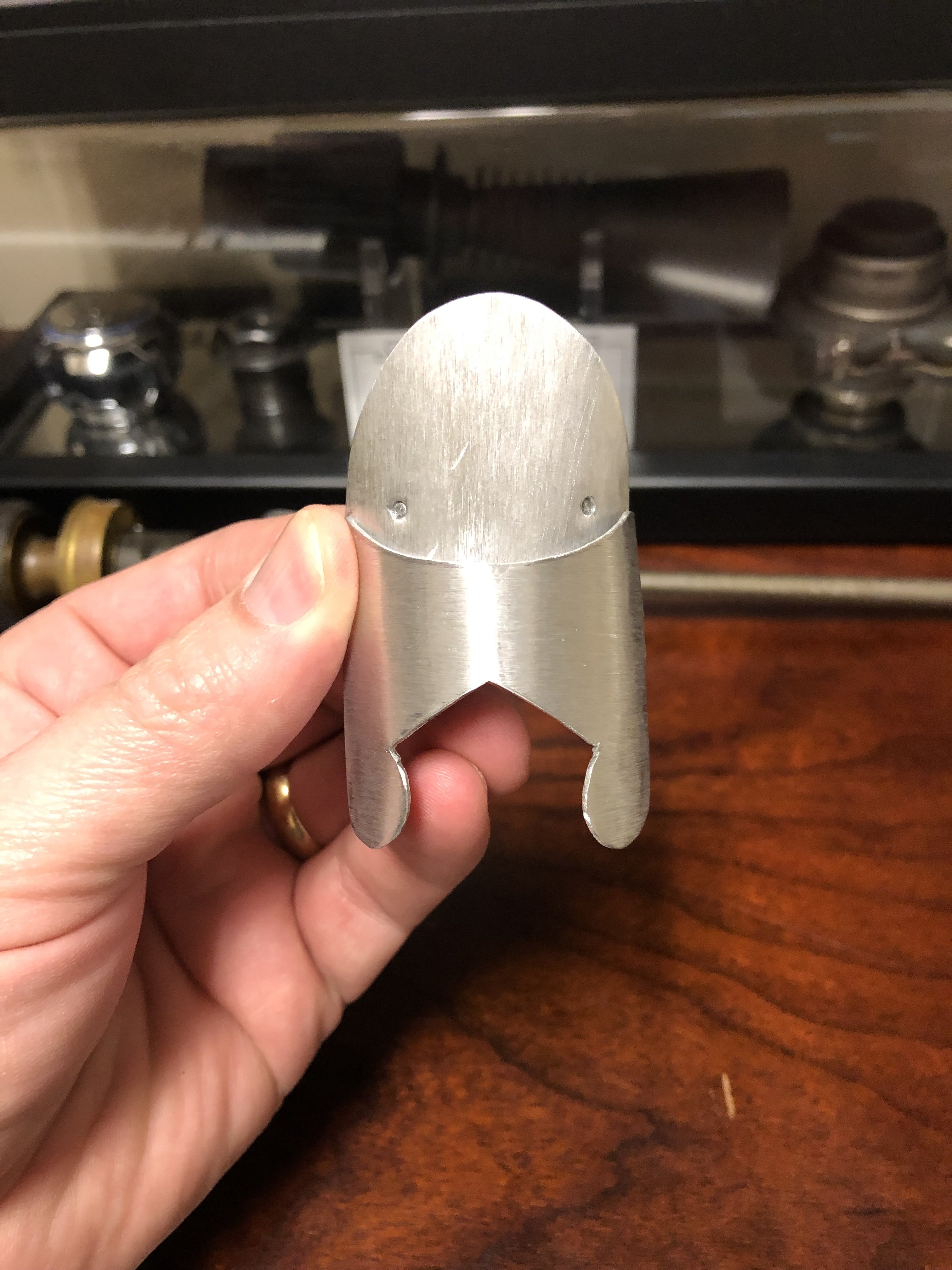

Ready for cutting!
Chris that looks great!! Mind if I steal those photo’s for the tutorial post?
Thanks!

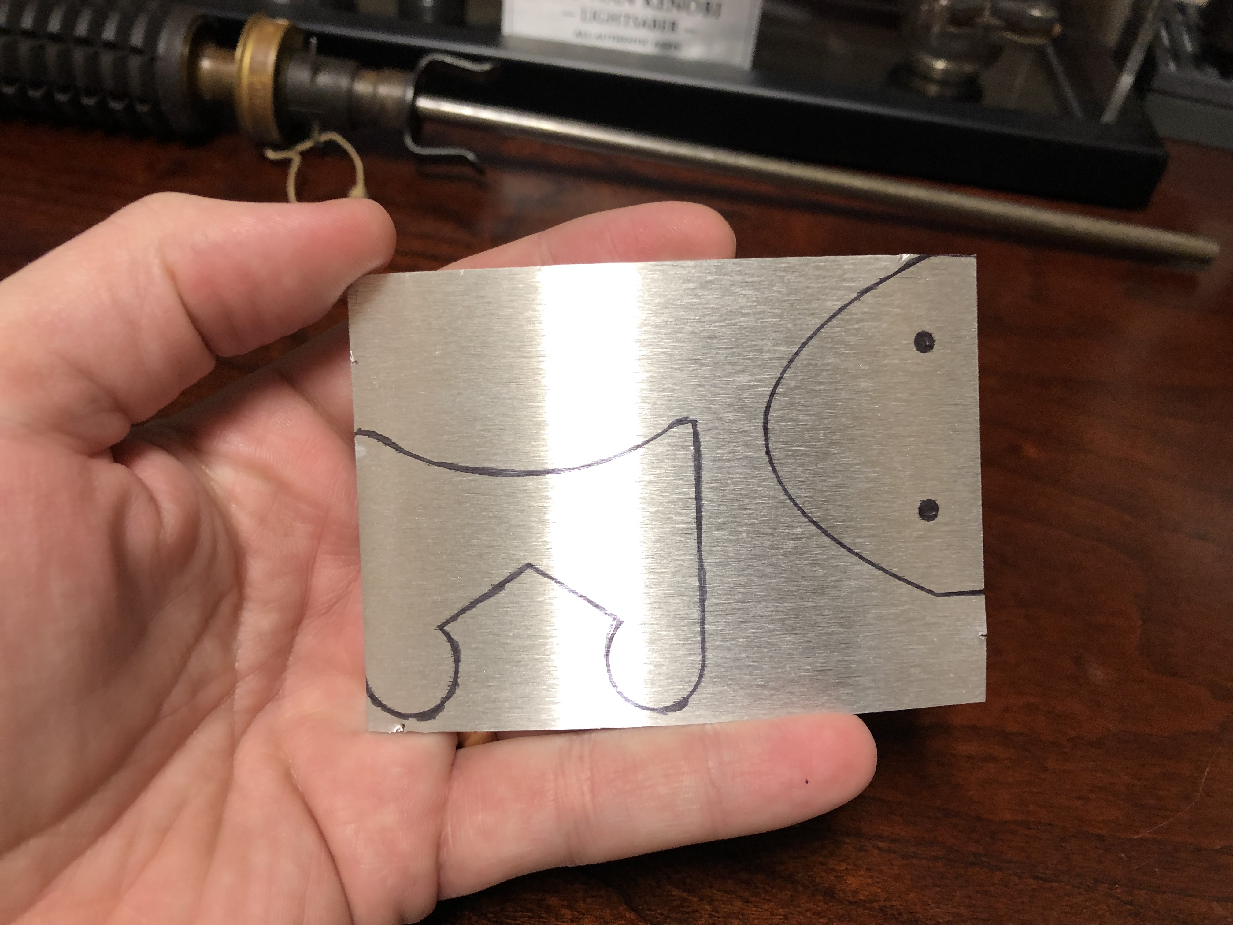

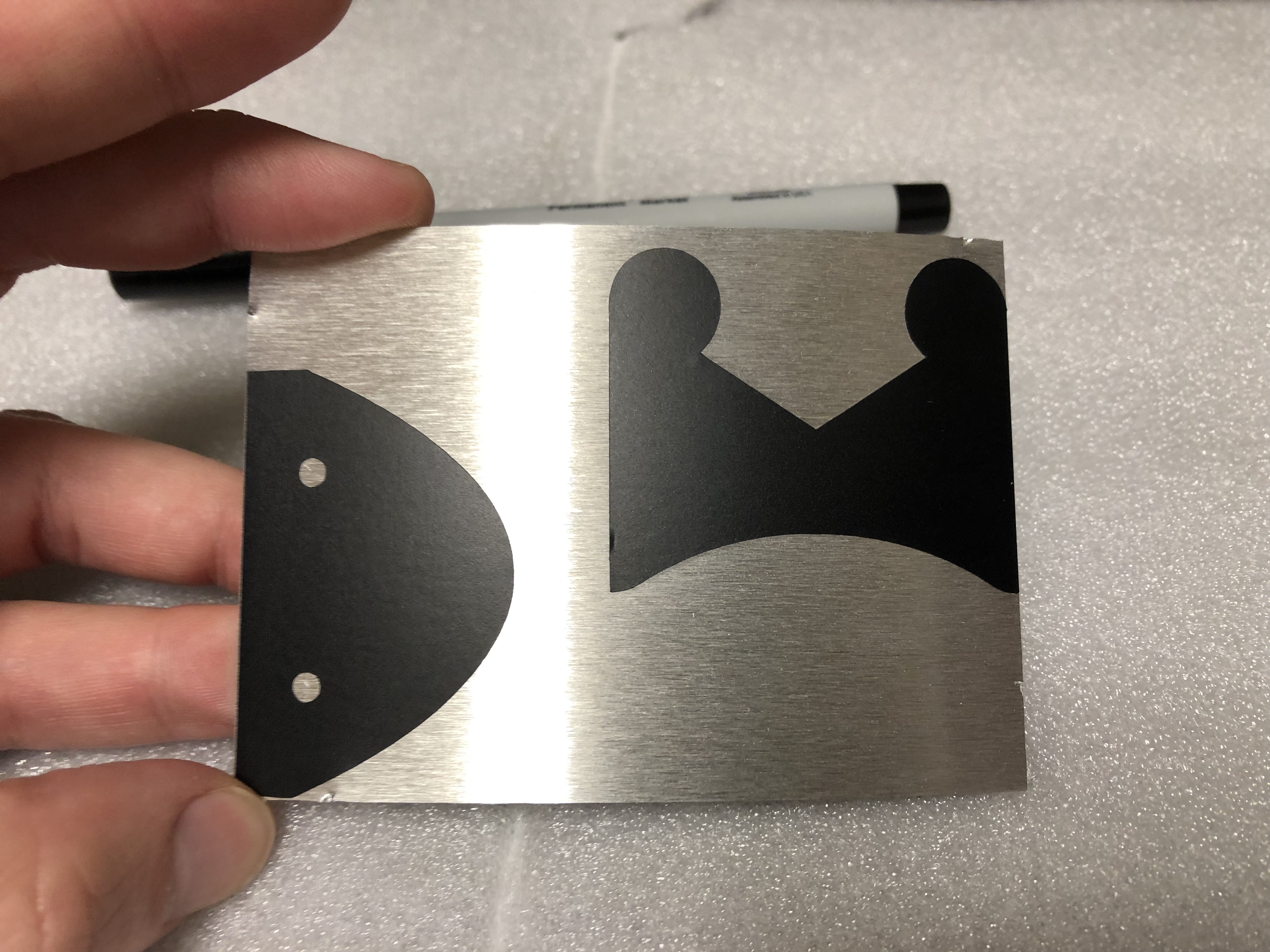

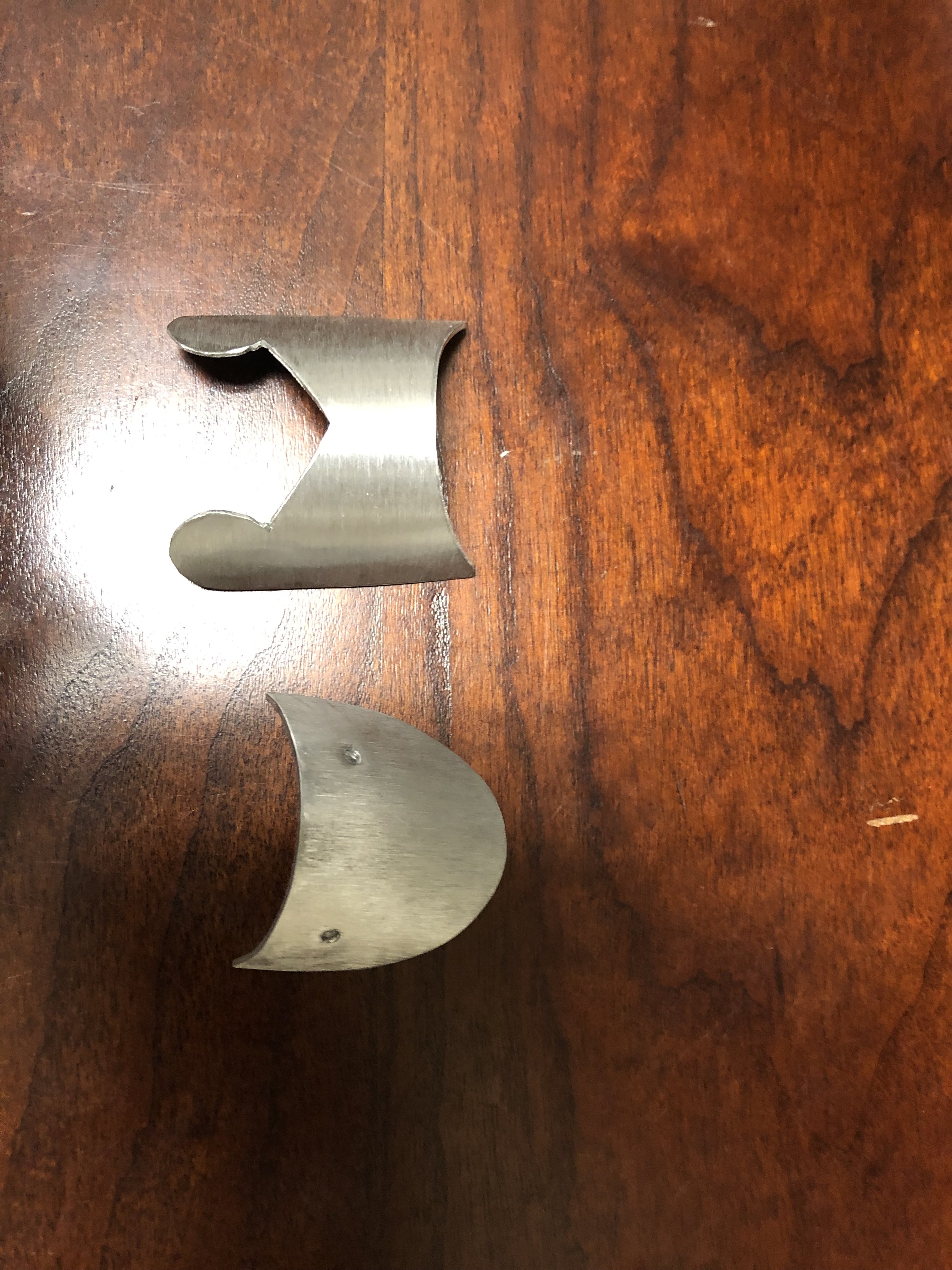

Not at all. This thread is your baby. I’ll take pictures as I go and send them to you. I even alternated the grain on the aluminum like you said to.
Test pieces!
Plenty of filing and sanding still to do, but I’ll be cutting a new set tomorrow now that I practiced.
