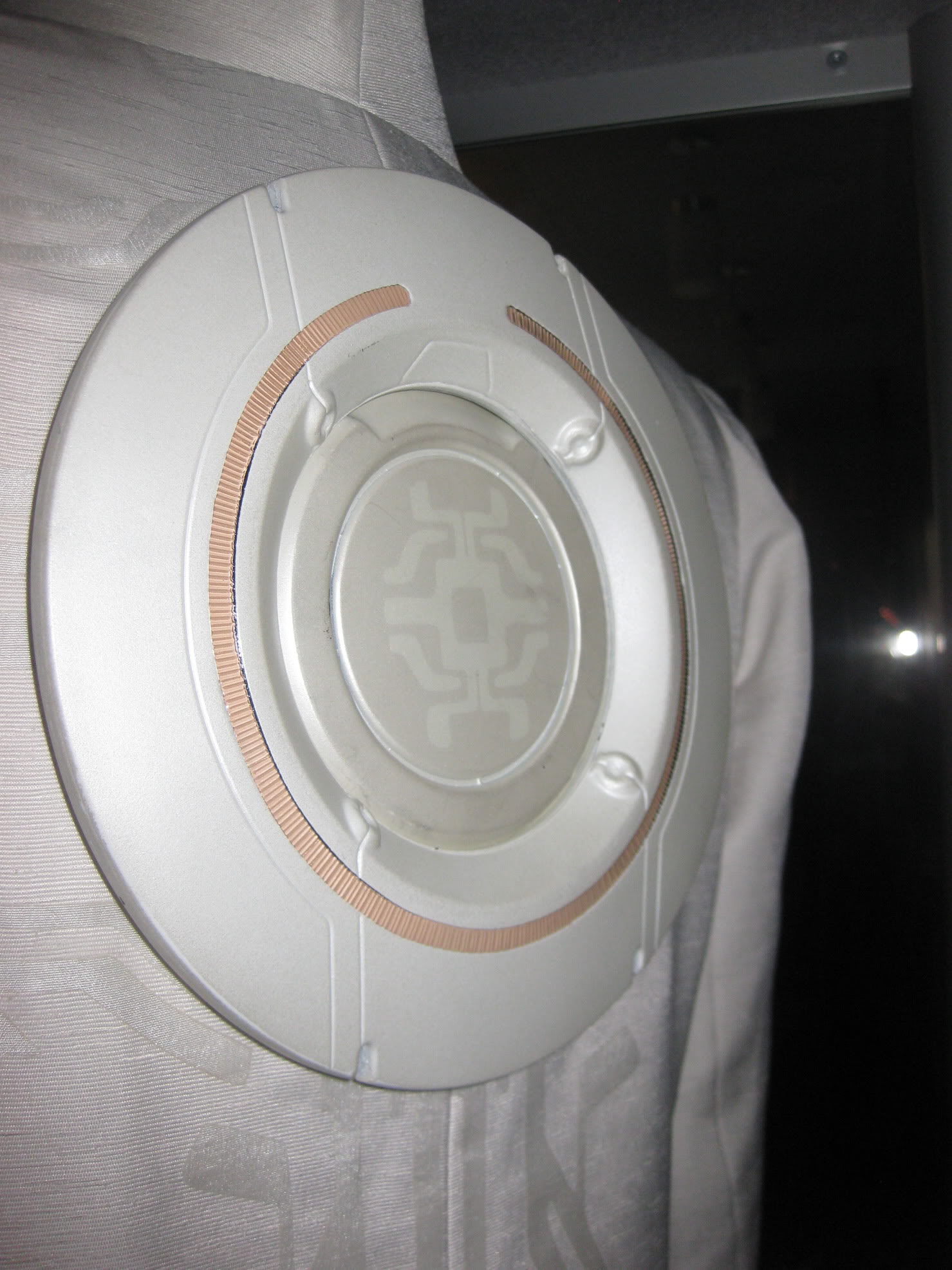

If anyone is going for the white one here's a pic of the back of the actual movie robe. It doesn't show the whole thing, but it's a start.
