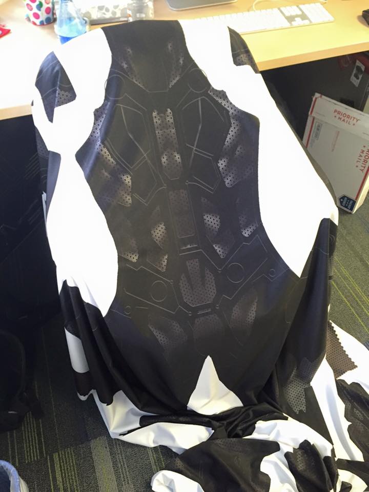

Got my Rinzler sub dye print in today! Can't wait to sew it up. Once the first suit is done, I'll make any additional edits and offer it for sale.

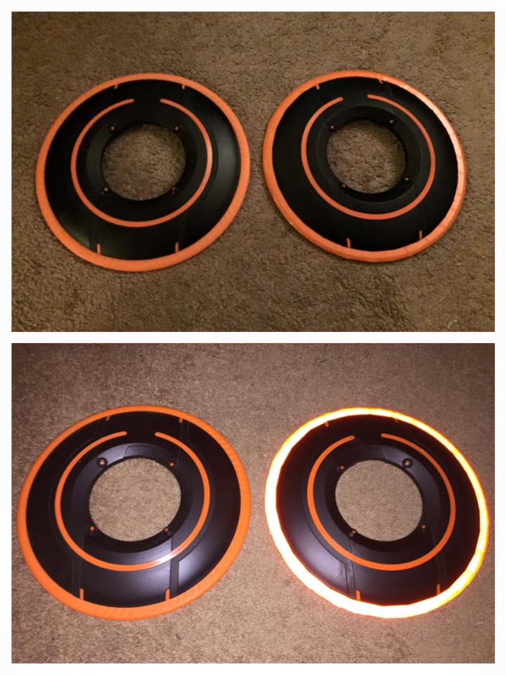

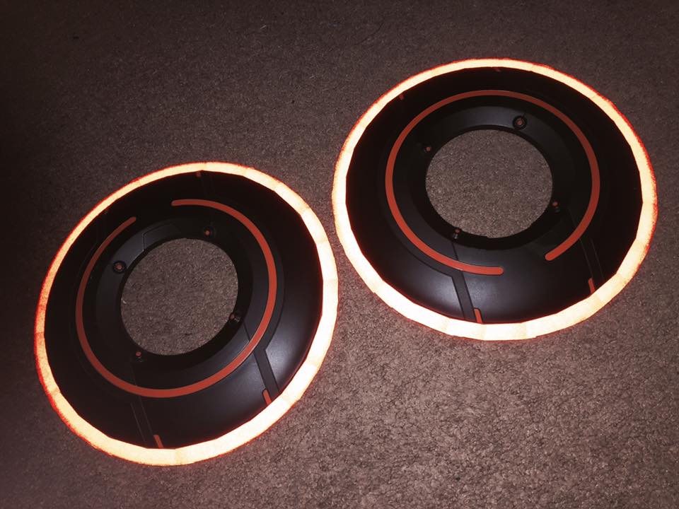

My suit is being sewn by Raven Roth, who put together my MGS Gray Fox sub dye. In the meantime, took some of the reflective tape I'm gonna use on the suit, and did the edges of my two discs!
Looks great!! Where did you have your pattern sub-printed?
Fabric on Demand. They're a bit pricey ($140 for a suit print), but their color and fabric weight are some of the best I've come across. Little color fading when stretching and the fabric has nice thickness.

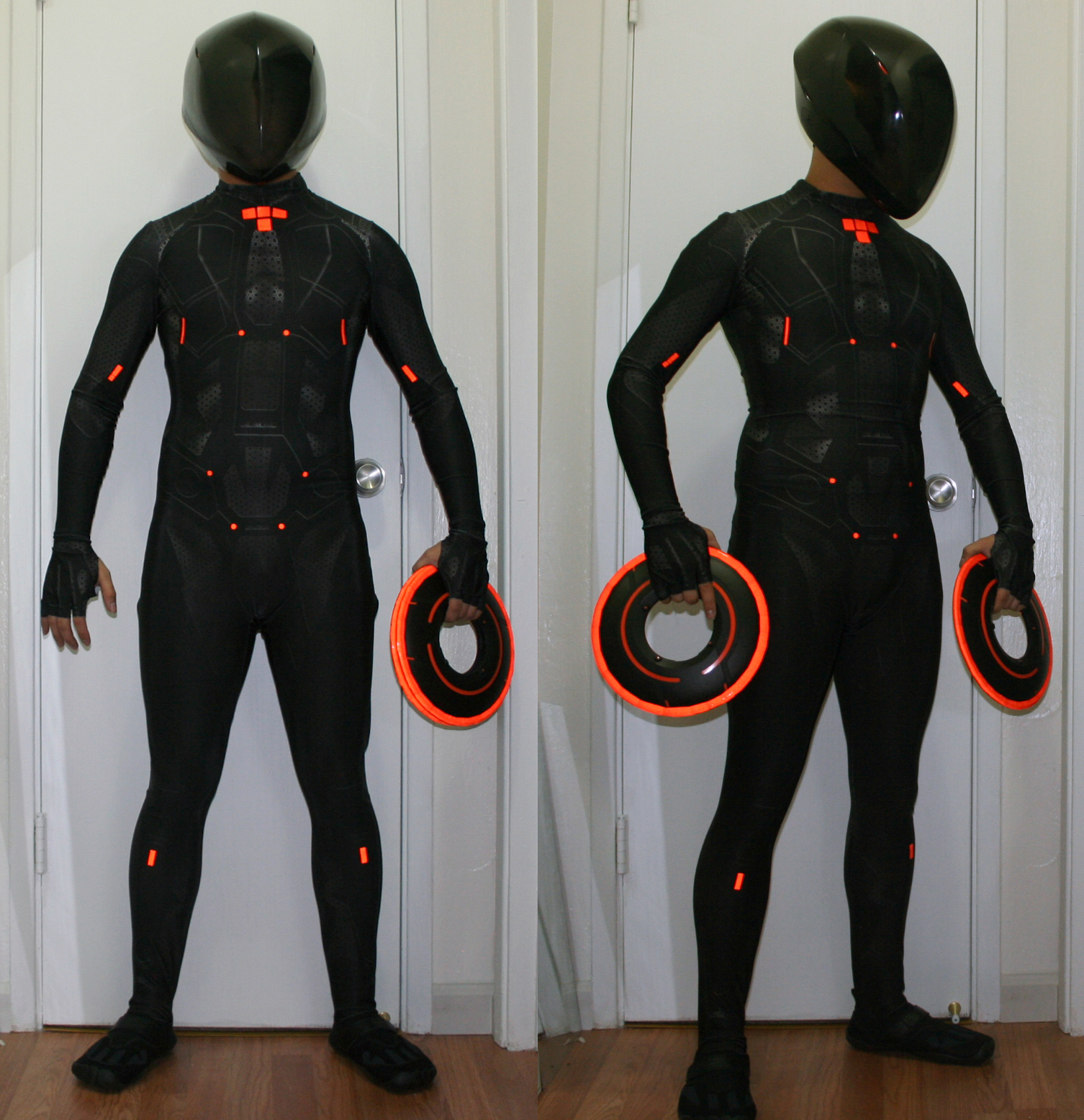

Hi! Here's my cosplay. I'm supposed to be a Resistance program.
I just ordered one of SoulInertia's disc kits so hopefully that's step one of getting this costume to pro level... next up is the papercraft-resin-fiberglass helmet process, I want to use either an Anon helmet (thankfully people have already .pdo-ified it) or commission someone to design one for me (or even do it myself!), and then replace the spandex undersuit with a hexagonal-patterned one, or just spend the time with a ruler and a stencil and a silver sharpie to do it by hand. Speaking of which, does anyone still do that hex-pattern fabric? Nobody seems to make it anymore, which is a real bummer! I'd like to make gloves and stuff with it. Also on the list of things I want to do: add lighting to the arms and legs, as well as create a disc dock with magnets for the upgraded disc to stick to. It's not much, but it's a start! 'u'
