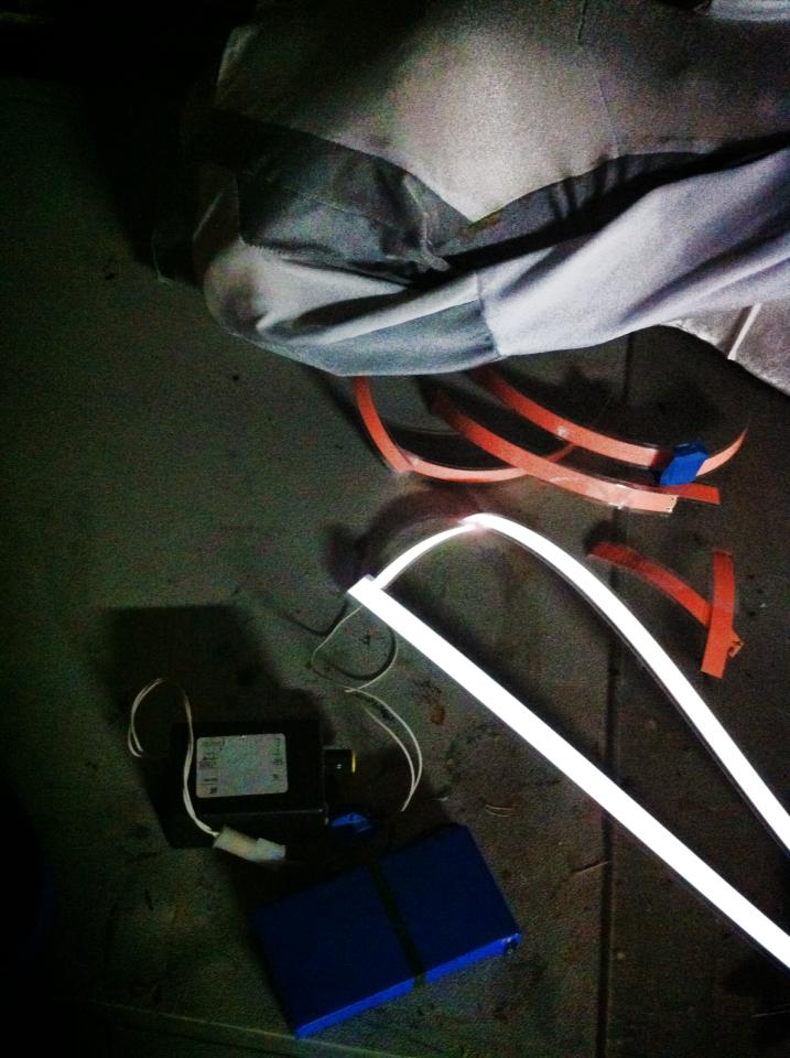

Here's a shot of me testing the Lite Tape strips which I am adding on to my Siren Gem costume. Onto rubberizing the suit next before I adhere the light strips.
P.S. I have a little over 8 feet of this FlatLite Tape left over. Over estimated how much I needed.
I am selling it at cost $5.95 USD per foot or $48 USD for all of it, just under 9 feet total uncut length.
It is 1/2" width Split Electrode Lite Tape in White. Here is the pricing list. You will need a 12V battery source to illuminate it and an inverter. Plus some ETCO connectors or copper eyelets to attach to the Lite Tape then to the lead wires, plus Molex connectors for the lead wires to the inverter. All these can be purchased from LUMINOUSFILM.com where I purchased this Lite Tape.
You can learn more about this product here and contact the company with any questions you have. There is a Tech. sheet to show you have to illumiate this product.
