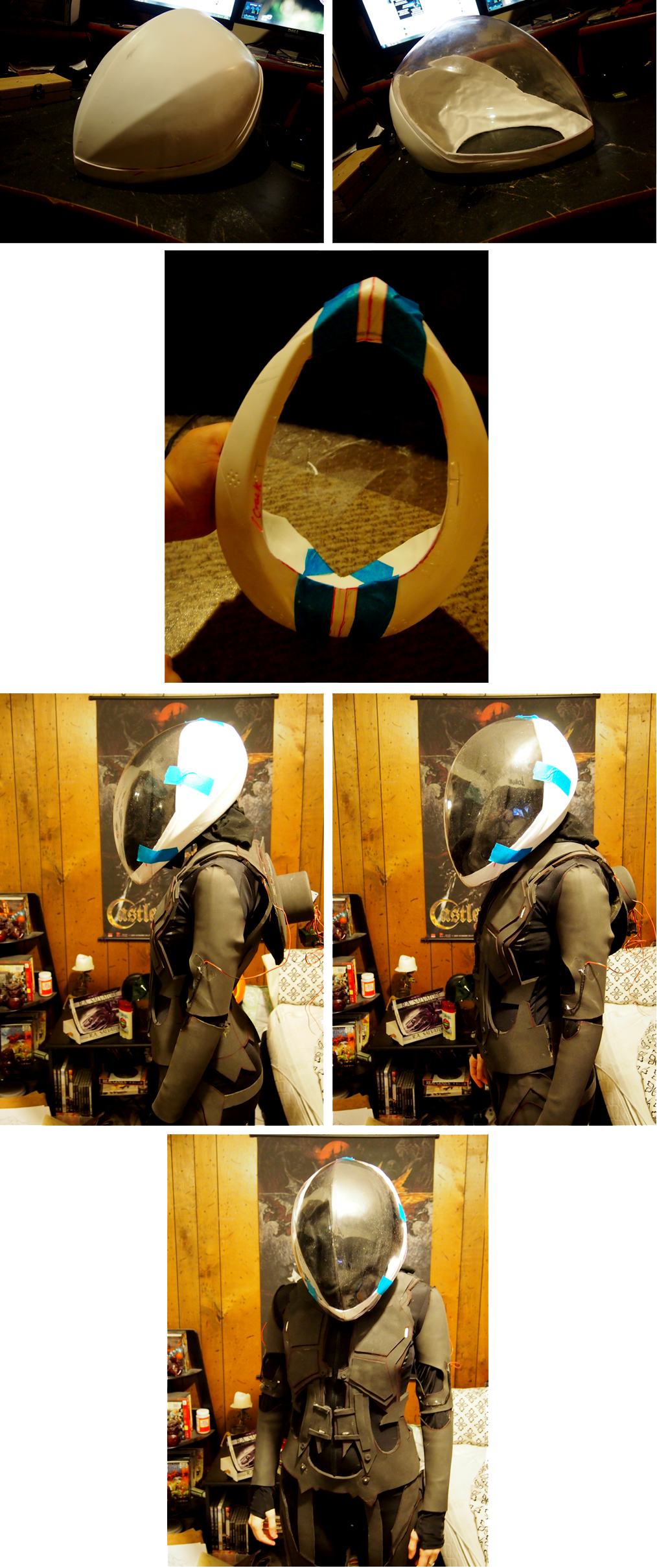

Finally got the helmet in. The mail service got our address wrong so it took a while for it to arrive. We ended up having to go and pick it up.
Anyway, when I tried on the helmet it turned out to be way too big (because it was made to fit an adult male and I'm a petite female). J (my fiancee) has spent the last day working on shrinking it for me. He had to dremel the white resin visor off, as well as trim the resin base about an inch and a half in (he's currently trimming it a little bit more so the two halves match together). After that he trimmed and heat shaped the plastic visor to fit the new base. He still isn't 100% finished, but it fits a lot better than it did.
Once everything fits together properly we're going to tint the visor, paint the base, stick em together, drill holes in the back, drill holes for the lights, install the lights, and then finish off with the padding. I'm also adding Rinzler's humming sound to the helmet as a little bonus detail.

Got another update: http://fc06.deviantart.net/fs71/i/2...__07___helmet_02_by_petitealtesse-d4rbdd8.png
(Sorry for the messy work room. We're in the middle of remodeling it. lol)
The first picture is showing the original size of the helmet compared to the size it is now. My fiancee took it in about 50%.
The next pictures are to show the helmet on me (now with tint). And I know... I need to polish it. lol
The bottom two are to show the hands lit up, both in light, and in dark. Now, they are not done. I know they look rough right now. This is all the base. There will be more details added.
We also put on layer of black latex paint onto the chest and some on the legs.

Looks good. What did you use to tint your helmet?
I used a brand that Volpin recommended: VHT Nightshades
It's on Amazon for about $6. I would highly recommend it as opposed to getting a can of spray tint from Auto Zone. I tried the Rustoleum brand and I could not see what so ever. It was very blurry and splotchy. VHT is literally like looking out of a dark pair of sunglasses. It'll be hard to see at night, but during the day it should be fine.

Thanks. I'll have to look into that. I was also considering limo window tint film since the lenses for my helmet are pretty much flat.
Agreed on the VHT NiteShades. Good stuff. I found that my Advance Autoparts store carries it. ~3 passes 10min. apart should give you a nice tinted look.
What i'd like to know is what removes it if you put too much on? I've tried paint thinner & brake fluid to no effect. Tough stuff!
