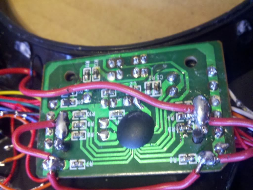

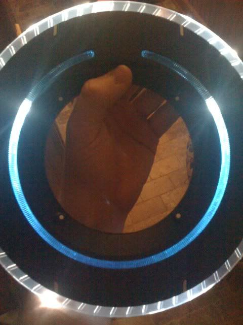

does anyone know of a way to keep the ID disc to stay lit without having to replace the inside lights?
I know someone made a post saying that you could just rip out the sound board. I just got my Identity Disc yesterday and I've been wondering the same thing.
I'm a little iffy on just taking the components apart until I get confirmation.

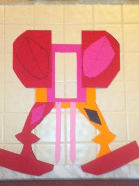

so as most of you know, i am building a tron betrayal costume, and theres a few things i need help with. if anyone can see any problems with it so far (not design problems, thats perfect. im talking about like problems with it being even.) i would appreciate being told. also ive put the outside rim of the kevin flynn disc on the sam flynn identity disc to make it look more accurate like in the movie. again, this costume is the one from the flashbacks of tron in tron legacy (also in the comic tron betrayal). does anyone know of a way to keep the ID disc to stay lit without having to replace the inside lights?
There is a mod on these forums to do the 'Always On' setup. It kills the efects of blinking lights, but leaves the sound. It also means having to solder 8(?) points on the main board.
You splice a lead to the Black -Neg wire on the battery box, directly to these points. Battery Neg point to the R3-R10 pins, in this case made with less wiring by dropping a solder bar on the 6 pins along R3-R5/R8-R10.
This mod gives you this, without the flashing lights, but with sound.
Can you still switch On/Off the powersource without killing the battery life though?
You splice a lead to the Black -Neg wire on the battery box, directly to these points. Battery Neg point to the R3-R10 pins, in this case made with less wiring by dropping a solder bar on the 6 pins along R3-R5/R8-10.
Yup Cos, you can switch it On/Off with the main switch while still getting the sound and a 'tiny' flicker of LED light with the swing momentary switch.
