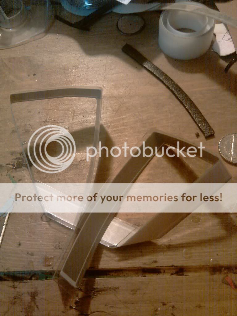

The 1.5" strip is cut to a curve, since the narrow EL strip would bow out trying to match a compound curve.
The curved strip is spliced off the main one with duct tape and wire which works unless you move a lot. The staple method didn't work for me. Any intermittent connection would cause arcing and burn on the conductive strip under the wire. I'm going to try window defroster repair kit to glue the wire down under the duct tape.
If I can't get a reliable connection, I may have to simplify the arm and leg lights to minimize the bends.

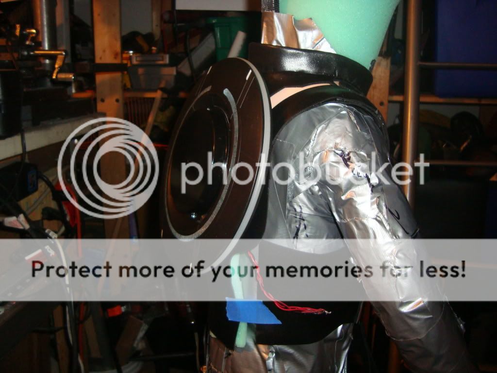

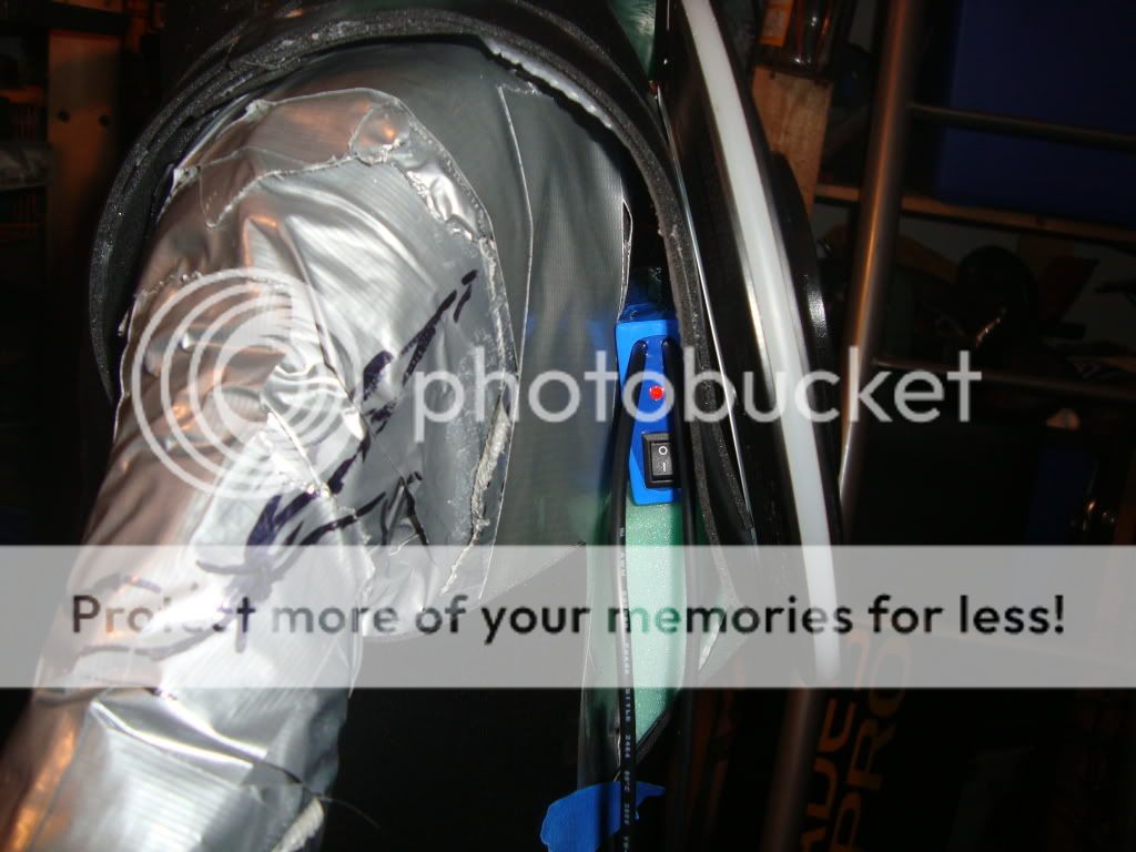

The disc holder riveted on the back. The (2) 4" knockout plug are screwed back to back, while the 3 inverters are housed inside.
Here's where I put the battery for now. I don't like the big gap behind the shoulders and the costume. I need to figure a way to fill the space with a smooth transition.
I'm going to glue the shoulder, arm and leg panels directly to the under garments. That should keep it from slipping and it's easier than having velcroed elastic bands everywhere.

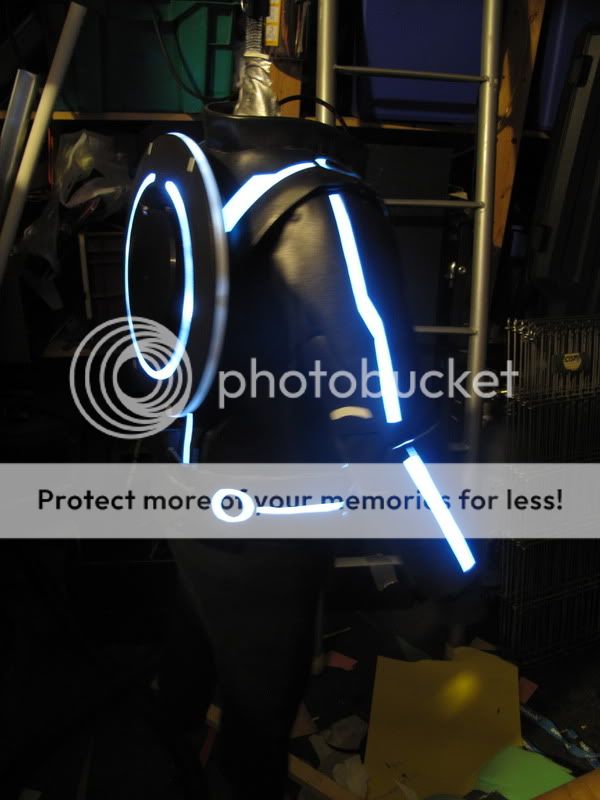

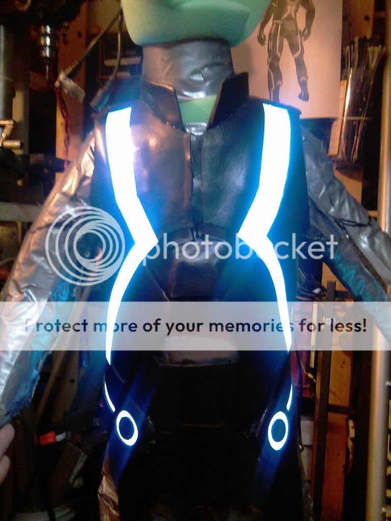

So I tried folding the el tape to get some angles:
It looked like it was working great until I glued the panels in place and a sharp crease caused a portion of the strip to short out. So I had to tear it out and redo with a simpler one with only one bend on each side.
I got the upper body almost complete, with the hip panels done.
It just needs a little reflective tape for the front.
The legs come next, and I am doing the dual baton battery packs. The LI-Ion pack is just too bulky to fit under the costume.

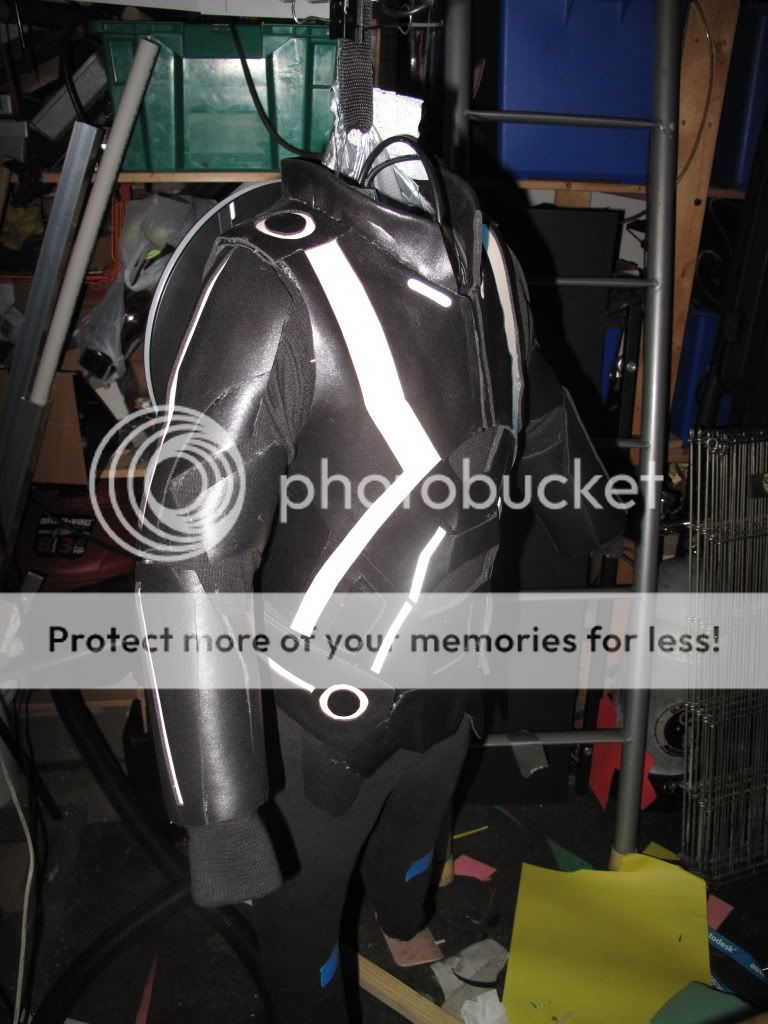

I started making the baton battery holders. I scored a place mat and folded it into a baton shaped tub which the battery holder would slide into. Then I shaped some wood plugs for the end to give the tube the correct profile.
I also finished the arms with the lighting. The panels are incorrectly scaled and are not accurate, but since It's glued to the undershirt, I'm just improvising.

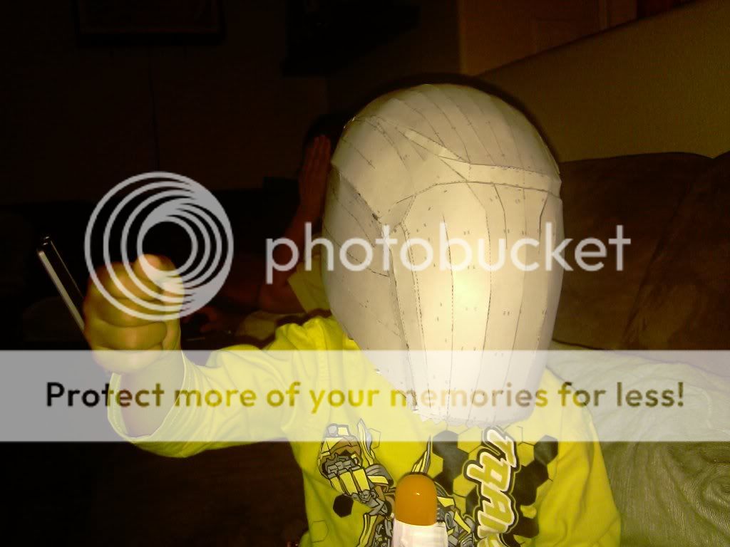

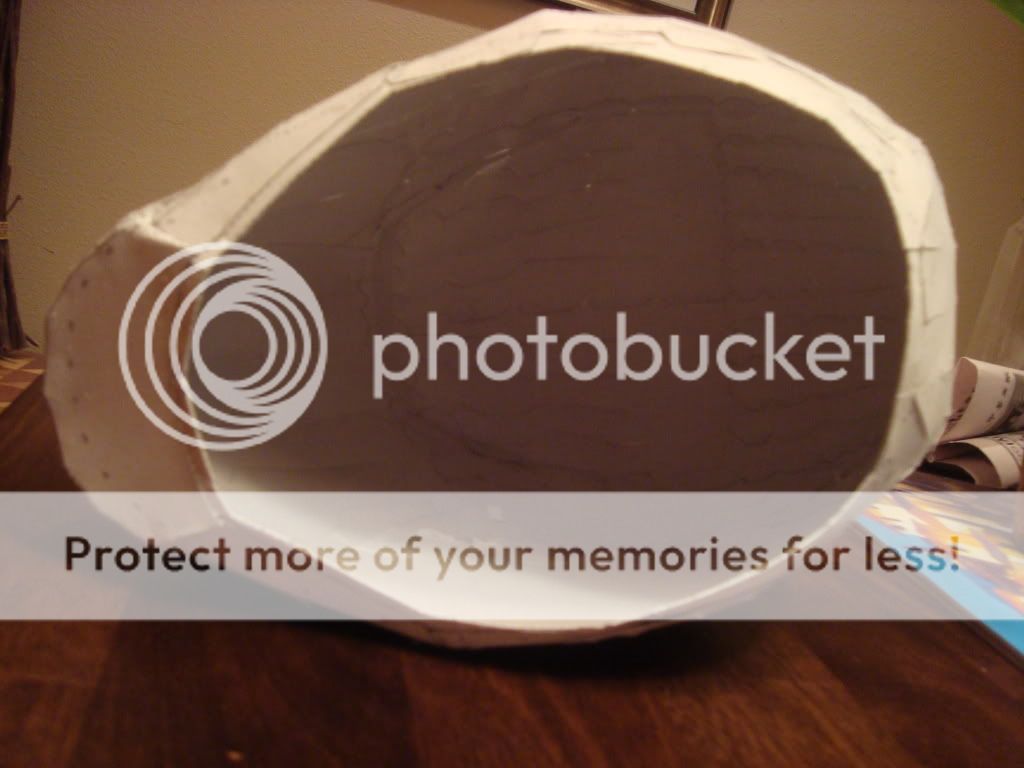

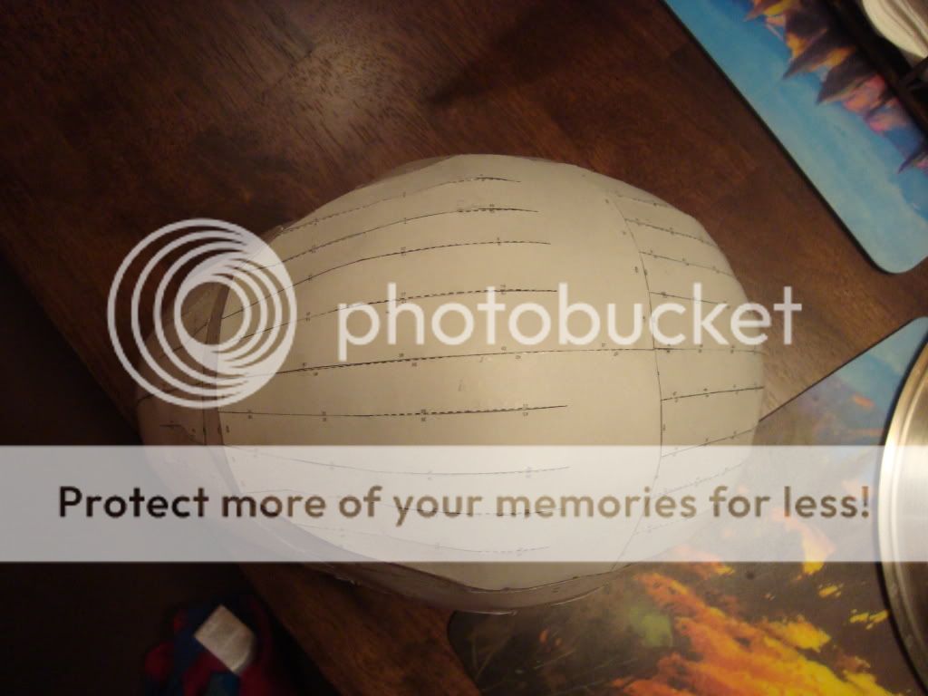

I spent the last 2 days assembling the pep helmet. I scaled it down 80% and it barely goes around his ears. I just roto-casted some smooth-on casting resin on the inside and it soaked right trough the card stock. So that saves me the trouble of doing the outside. It's still flexible, so tonight I will add the lighting and and a layer of foam on the outside as the finished surface. I will cut out the faceplate and replace with a tinted motorcycle visor that I heat molded to approximate the shape. The compound curve isn't as pronounced as the pep model, but it's close enough to fit.
Here are the pics.
"This better be worth it"

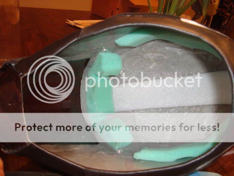

Finished the helmet tonight.
After the resin cured, started layering the foam on the helmet with hot glue. I had to stretch the foam to get it to conform to the compound curves.
After the skull cap was glued, I trimmed the edges using the pep lines.
The face plate was cut and I added some foam to the interior until it sat snug on my son's head, making sure his vision isn't obscured.
A bit of trimming and curving of the tinted visor and it was riveted onto the helmet.
Then i proceeded to glue on the remaining pieces and finished it with some reflective tape.
