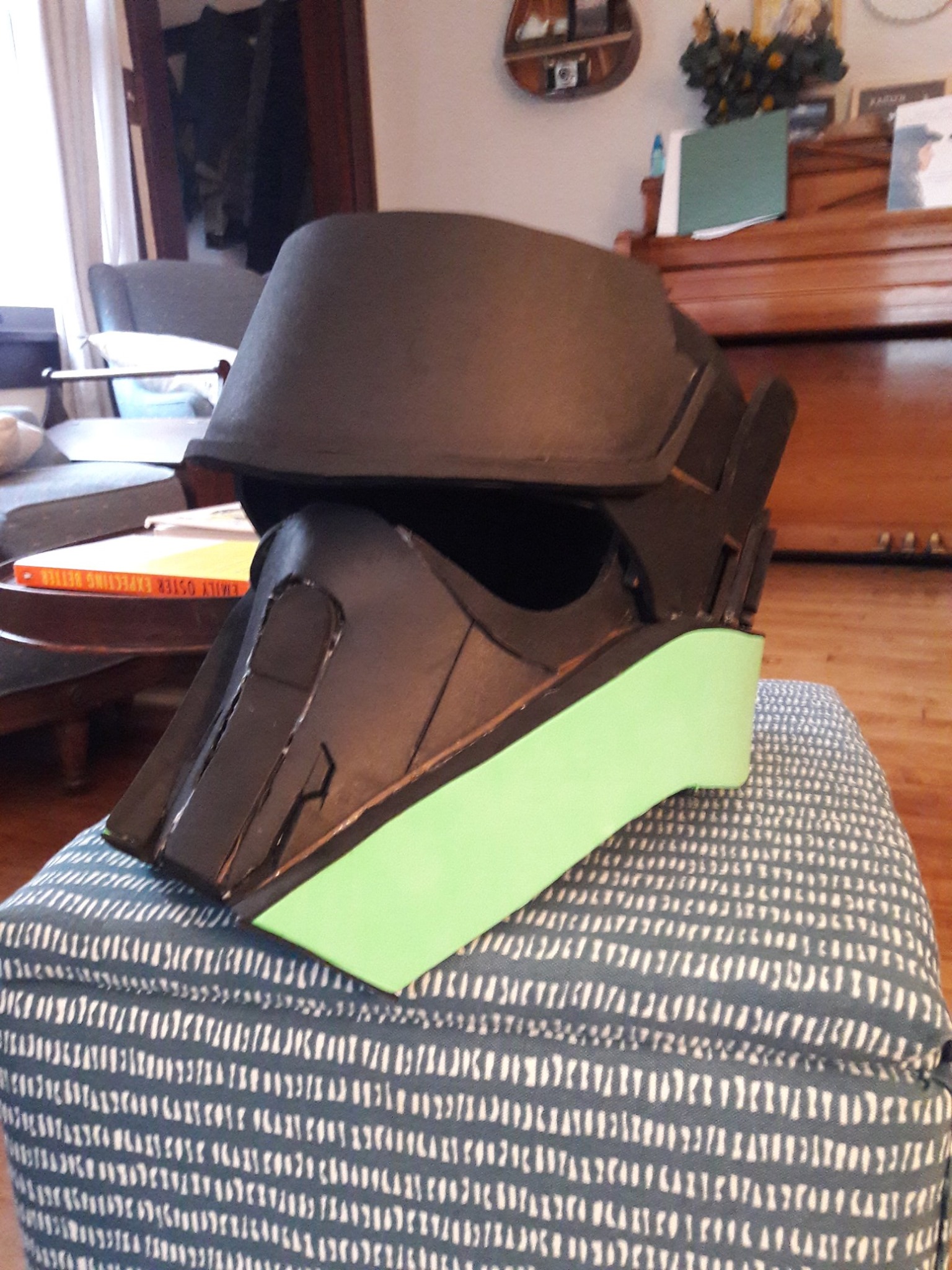

The first Light Infantry helmet, while obviously being a bit "rough and ready" at first glance, actually doesn't look too bad! Detailing, paint and distressing will cover a myriad of missteps. And hey... it's just a prototype. The next one will look a good deal more refined!

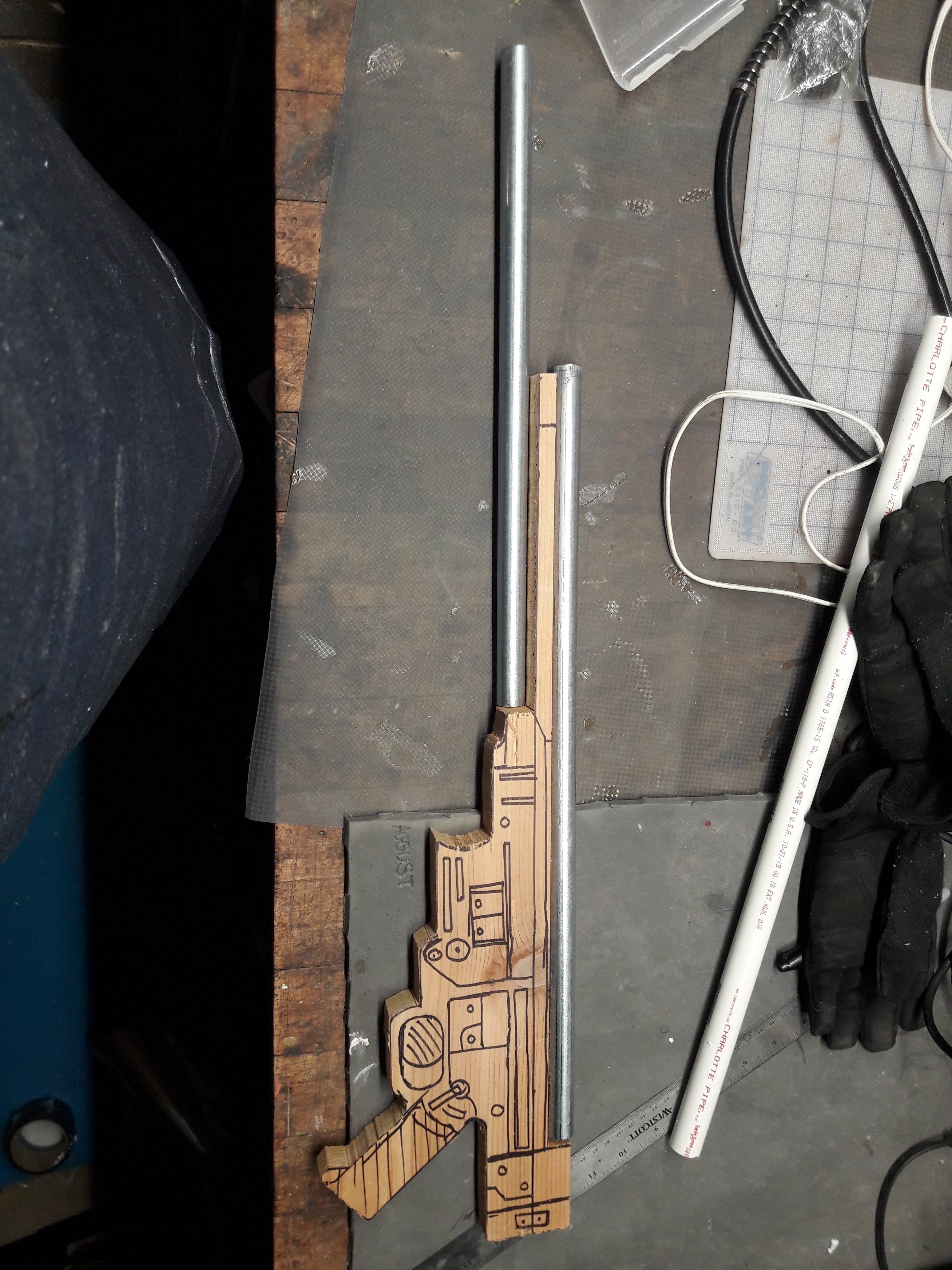

Here are the most recent progress shots of the prototype a-295.
Cutting some the section of steel tubing for the barrel and upper receiver. Since the A-295 is based off the STG-44 as opposed to the m16, having the appropriate contours really sells the "surplus" look of the blaster.
Rough layout of the main body. I left the barrel a bit on the long side so I could trim it down later if need be. Better to cut too long than too short.

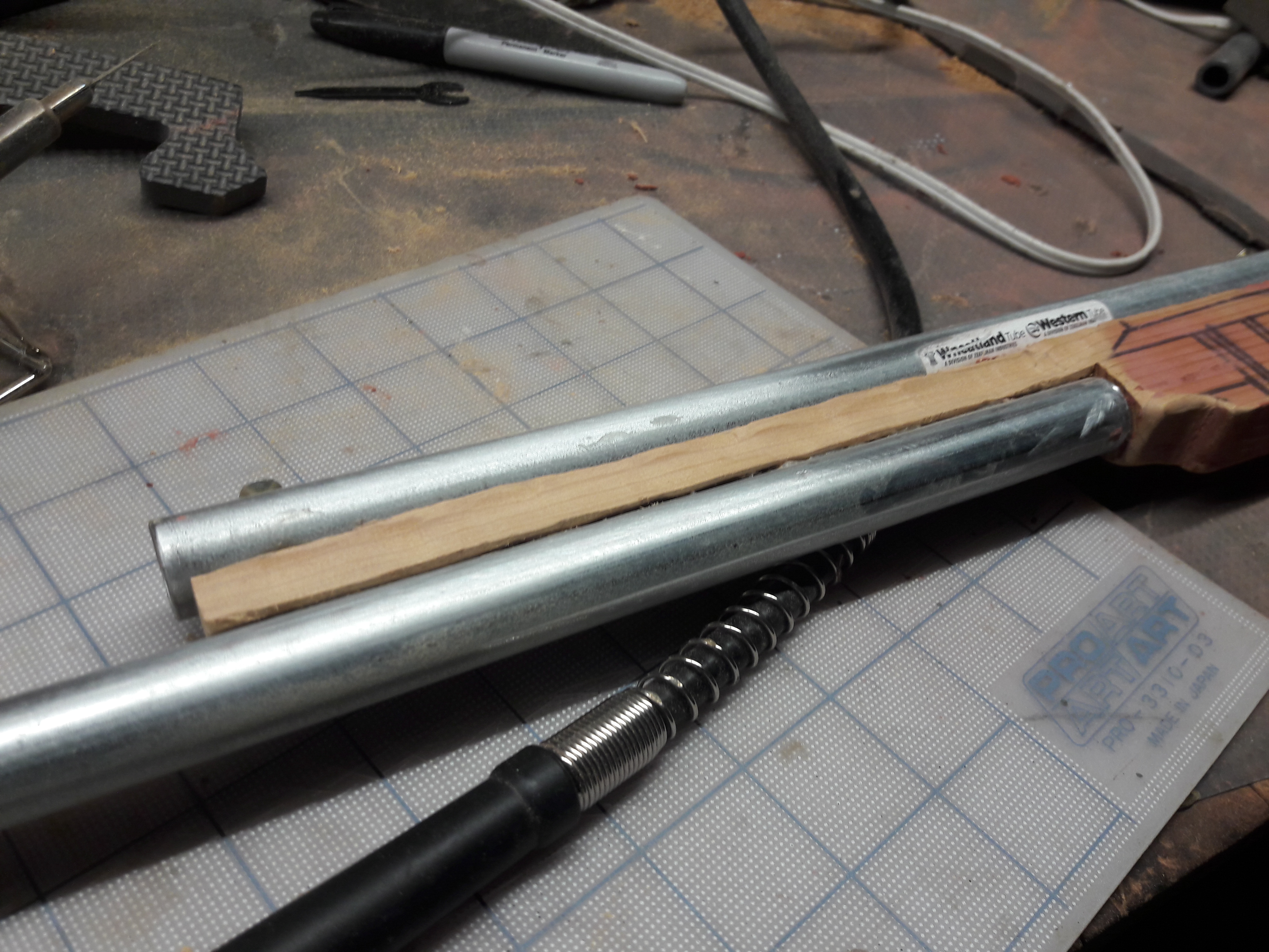

While a router would have been more "proper", the joins between the tubing and the wood are going to be so thoroughly obscured by greeblies that I opted to simply dremel out a channel to help the tubing seat properly. Besides, who doesn't love the smell of cedar sawdust?
Tubing seated and screwed into place. The screws are placed at strategic intervals so as to provide structural integrity, but also so that they are covered by other elements of the prop.

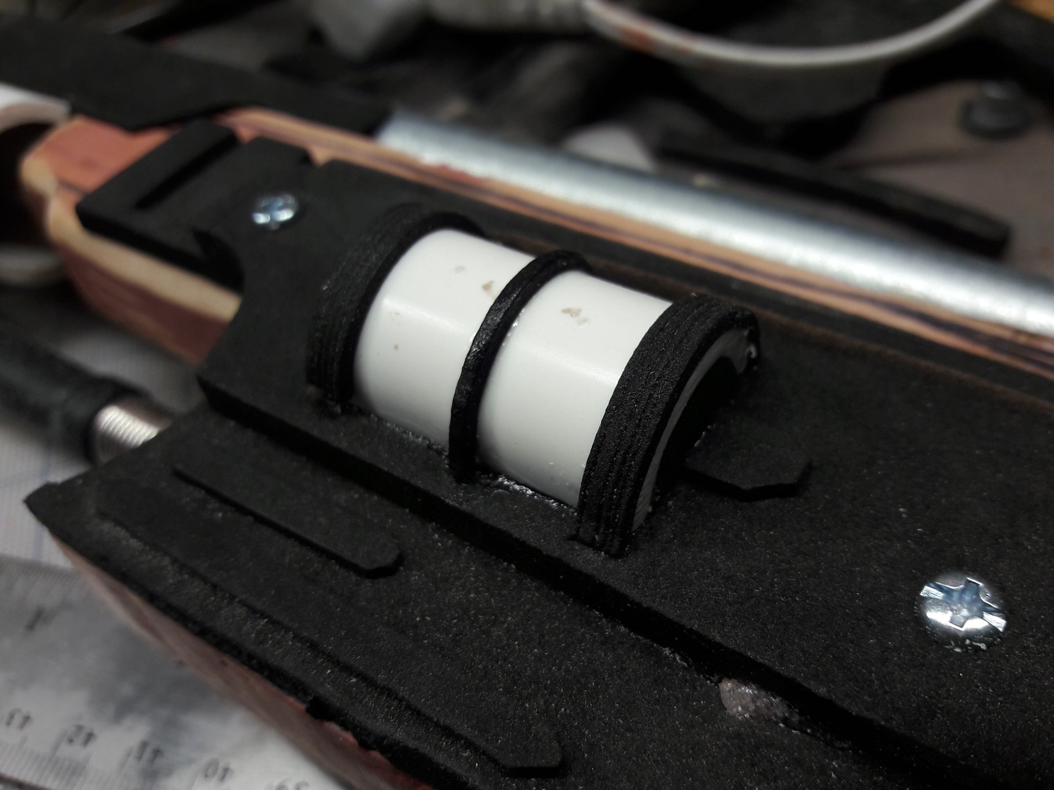

With the application of some judciously-applied foam, it's starting to look like something!
Starting my poor man's variant of the infamous "Revell Piston."

With a spot of dressing up, it doesn't look half bad. Final detailing to come later.

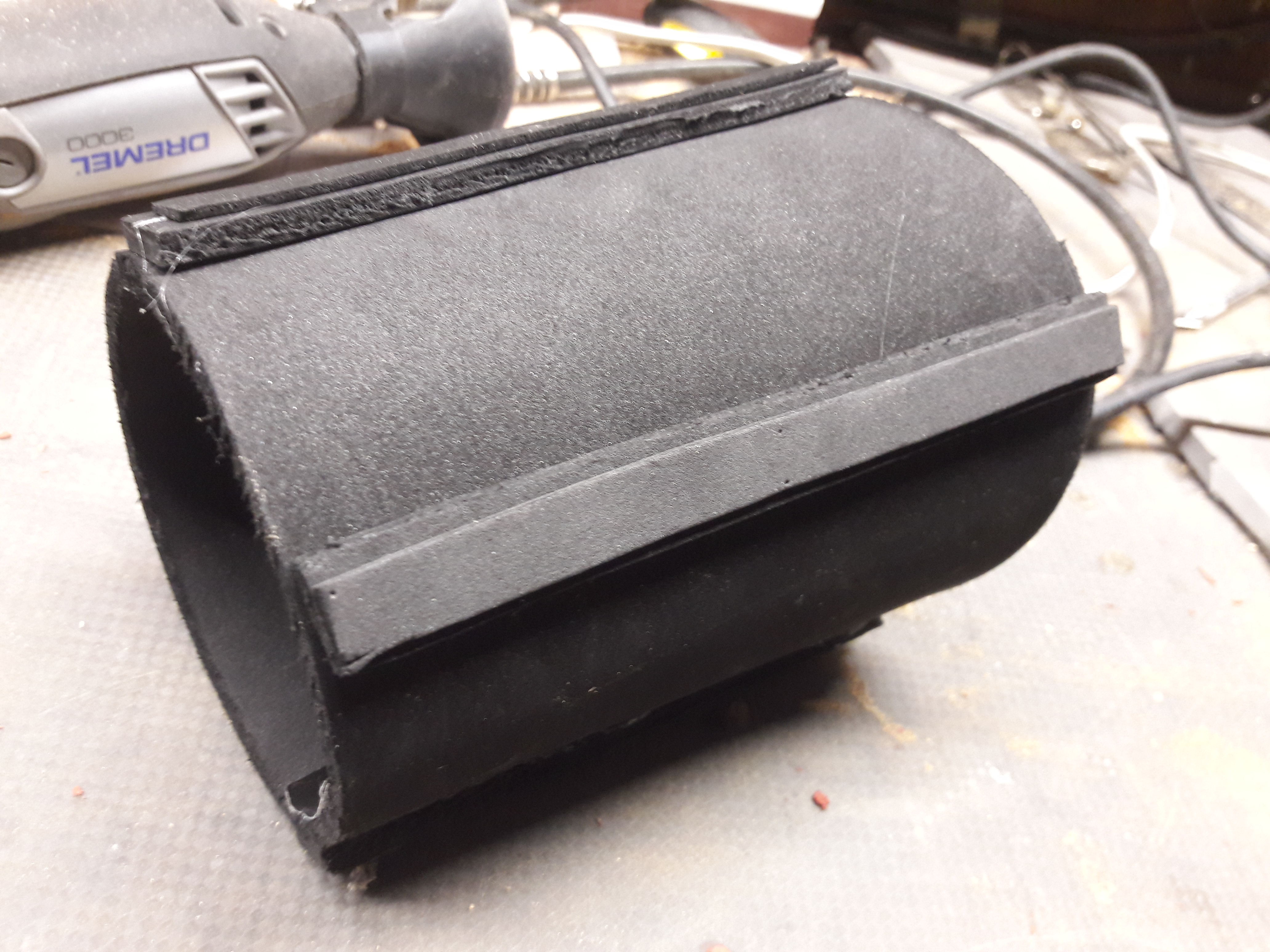

I've elected to brush down all the foam ebellishments with liquid super glue after letting everything cure. This not only makes the foam easier to fill and sand wherever necessary but also helps with paint adhesion.
Slowly but surely, the familiar textures we first saw in the trenches of Hoth is taking form...
