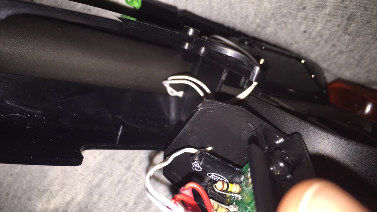

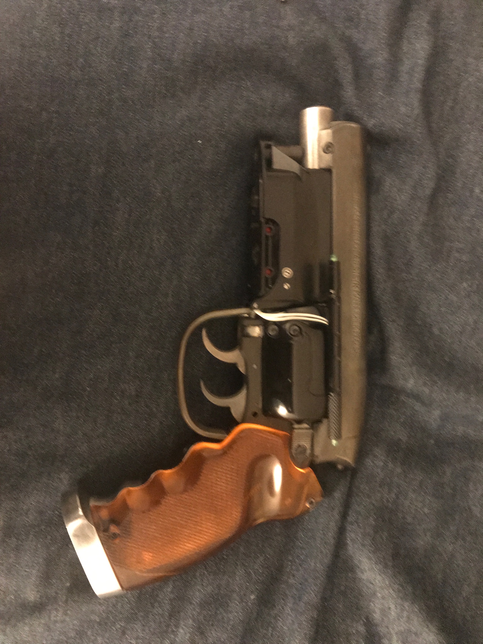

Excuse the crappy photo, it's very hard to get a good shot of (and the fact I've only used 2 wires, 4 can still easily fit). Basically the wires can be run up between the trigger guard and magazine housing (towards the barrel) and then fed in between the small gap between the MH and barrel.
EDIT: Also ignore the wire in the magazine hole, I only put it there to keep the excess wire out of the photo
That looks like it works perfectly! Thanks for posting the photo :thumbsup

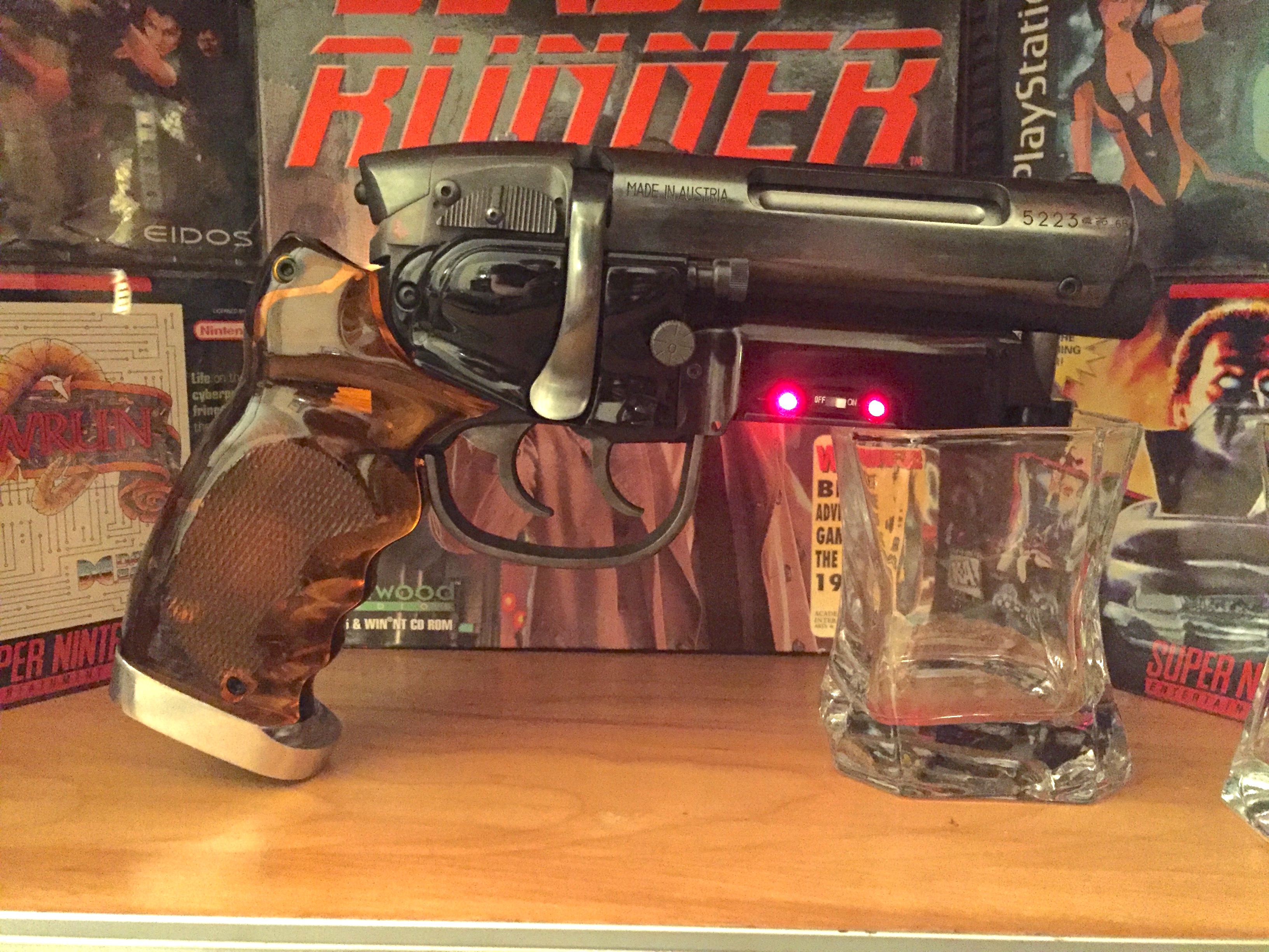

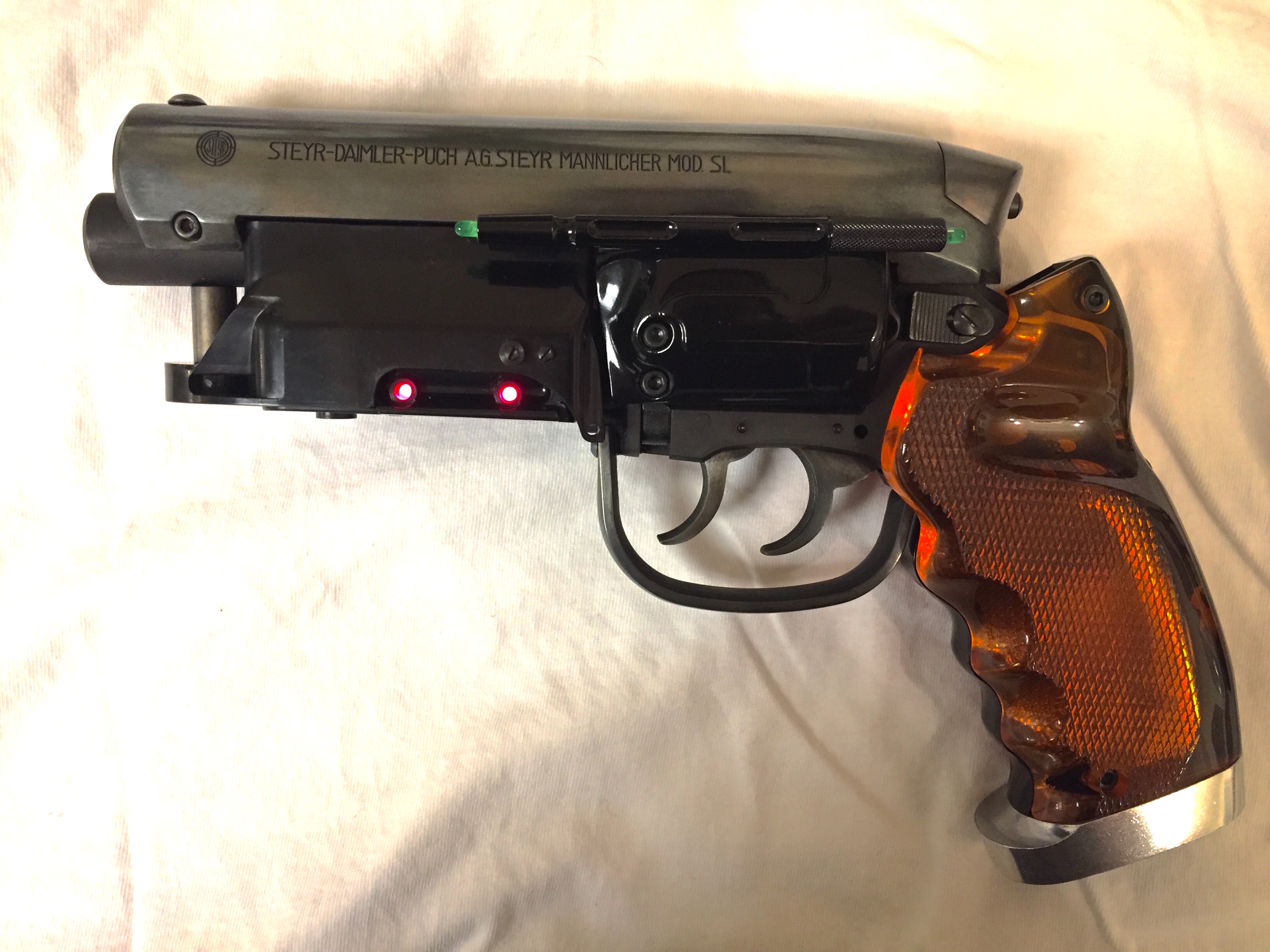

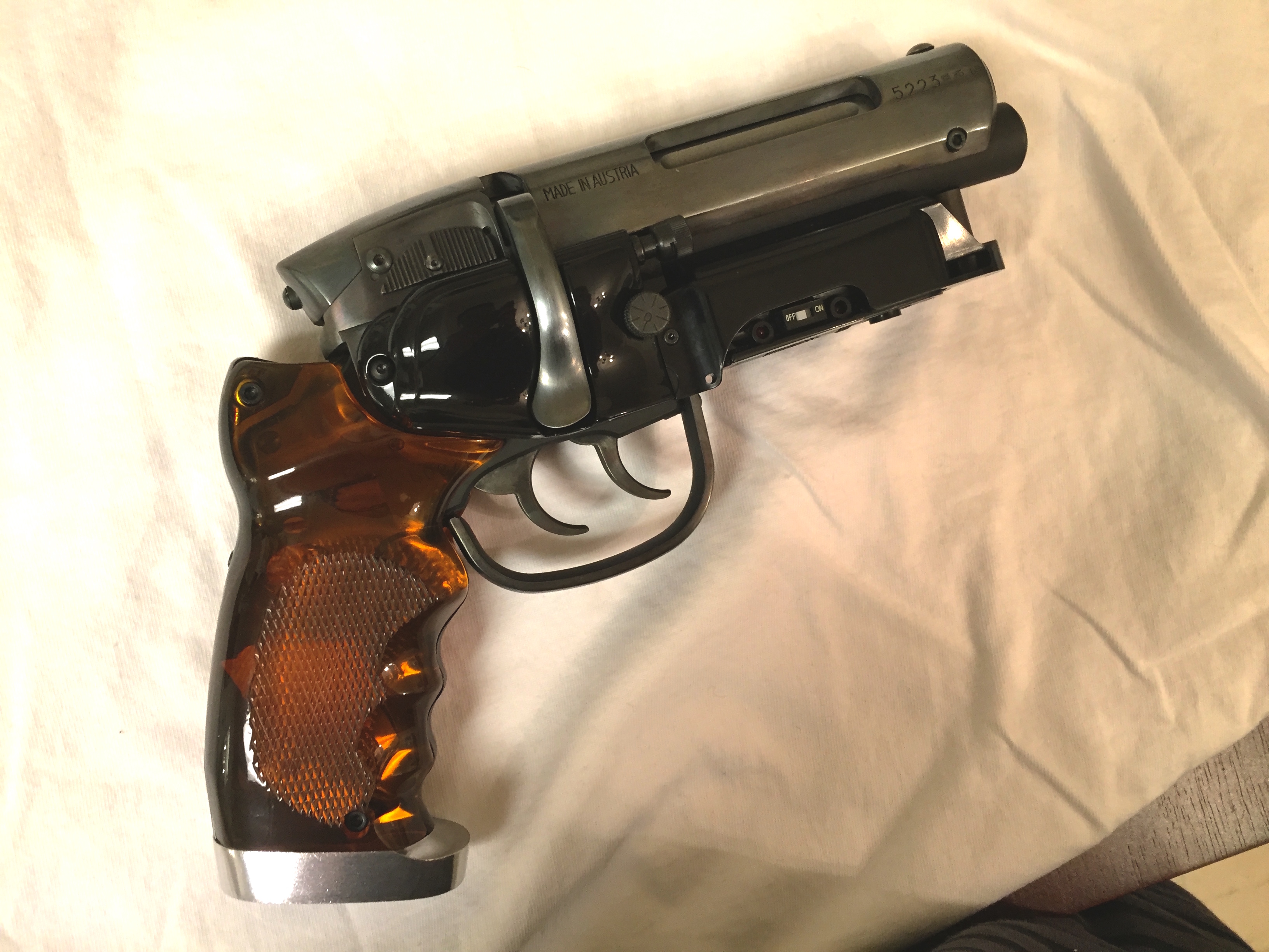

Wanted to get some quick Glamour shots of my Tomenosuke kit before it gets sent off to scottjua to be converted into a live fire! (Also got a real Steyr coming in for this.)
Mods made:
- Painted and weathered as accurately as possible. I’ve opted for a more natural weathering on my side plates, thus the lack of weathering on them
- Blued anything gun-relates (terrible lighting makes the bluing come up much darker than it actually is)
- real Weaver Knob, Phone Binding Post, and S&W K Frame Trigger added onto blaster
- Wires added (this includes the notch into the cover to accurately run them.)
- added SD Studios Steel Barrel and Don Parks Steel Cylinder
- cut the crack into the Tomen Grips
Some things I might have Scott do once it is live fire is adjust the grips (as there is about a 1mm gap between one of them and the butt plate) as well as strip the anodization off some of the screws and accurately blue them. Maybe a new trigger guard as well, just little things to further improve it. But this thread definitely helped a tremendous amount with this build!

I want to light up the my green led lights, but do you guys know exactly where I need to connect the extra wires to the board?
