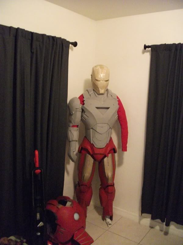

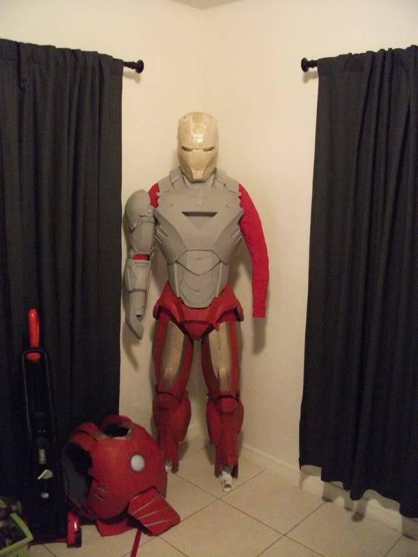

Small update. Please note cod and legs are from old suit and will be replaced with new and improved pieces.

Bump for small update last night.
Hoping to start building the cod and hip pods tonight maybe tomorrow. I am avoiding doing the other arm like the plague lol.
