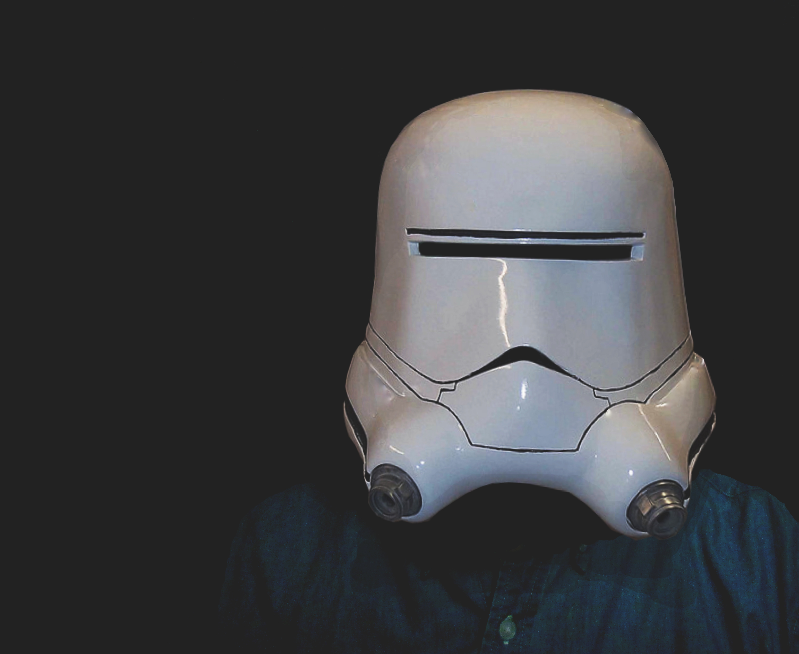

To that end, I boxed up the aerator prototypes for molding:
Then I poured in some rubber:
The mold came out great:
Here's the first casting:
That was basically just to clear the last little bits of the prototype out of the mold. Then I cold cast a pair with aluminum powder and installed them into a helmet:
I'm pretty happy with the end result:
I grabbed an old can of flat black paint and a slightly too large brush and added in the stripes:
I'm calling this one my rough draft:
Next I'll be painting one up with proper automotive paints and clearcoat for that First Order shine.
I'll also be installing a bit of tinted acrylic into the eye slit and adding some breathable mesh to the mouth hole.
