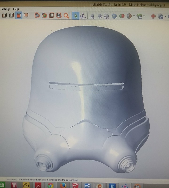

When I got back from Celebration Anaheim, I got a wild hair and decided I'd really like to make one of the helmets from the upcoming Star Wars. I got a hold of a friend who does a lot of 3D modelling for me and sent him all of the reference images of the flametrooper I could find. Here's what he sent back:
