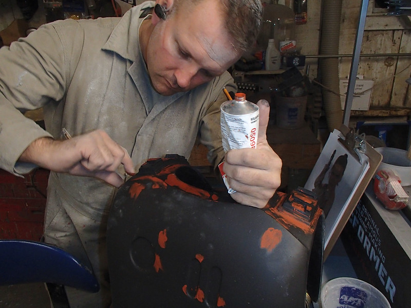

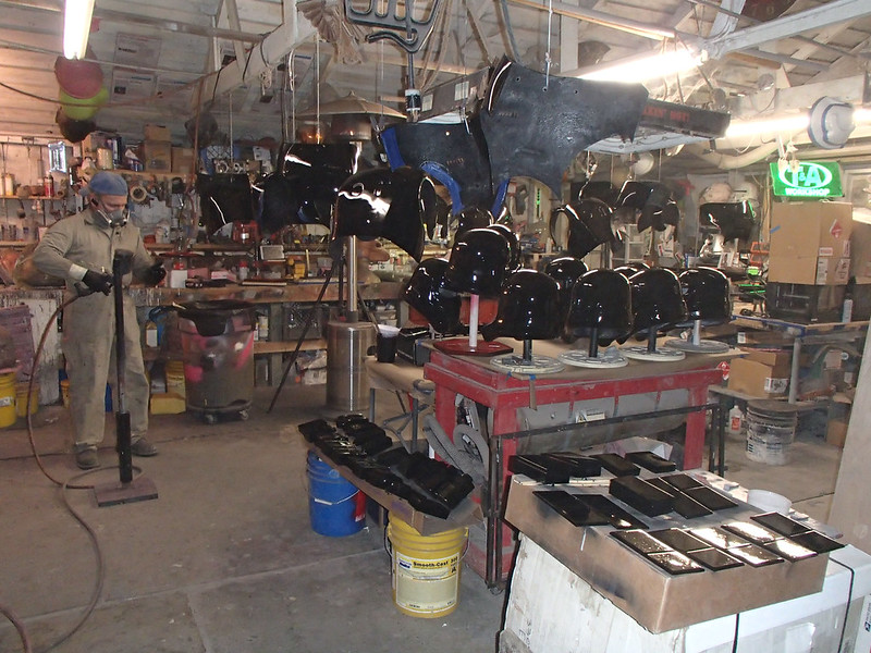

After a solid week and a half of nothing but sanding and filling, I primed all the parts. Then did more filling and sanding:
Once I thought I'd filled all of the tiny little pinholes, it was time to get to painting:
I had help:

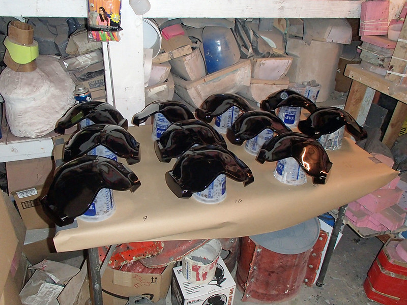

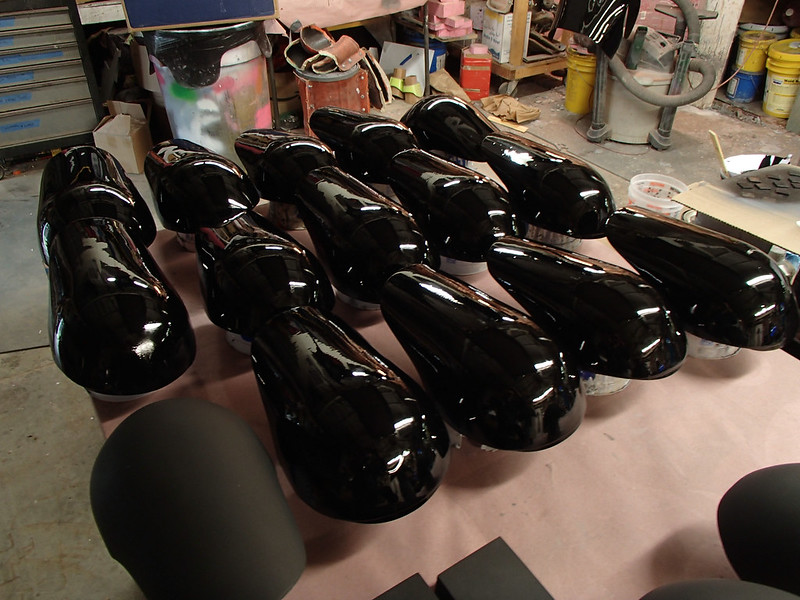

Here's the stack of shoulder armor somewhere in the middle of the process:

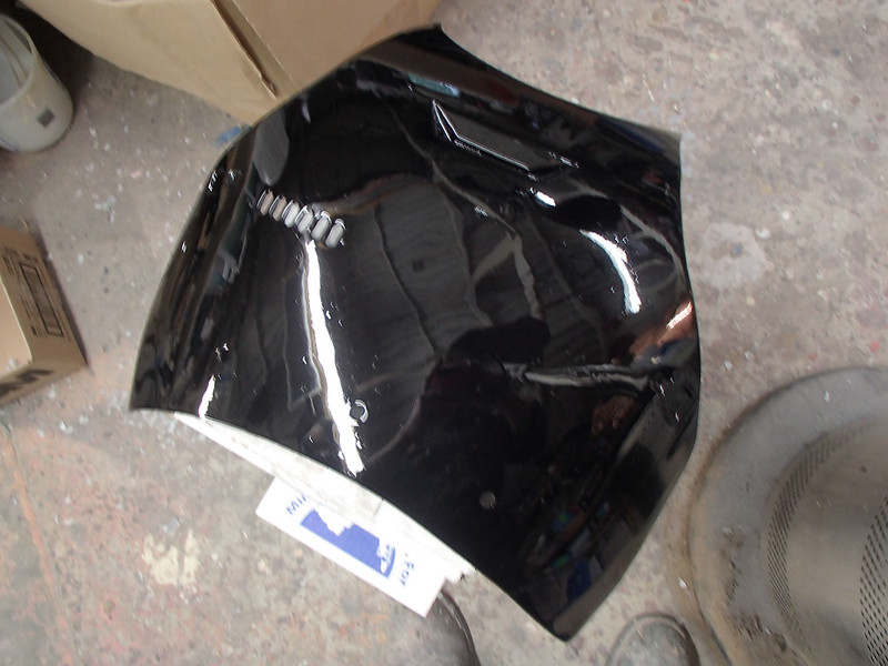

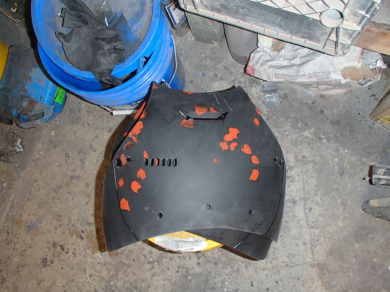

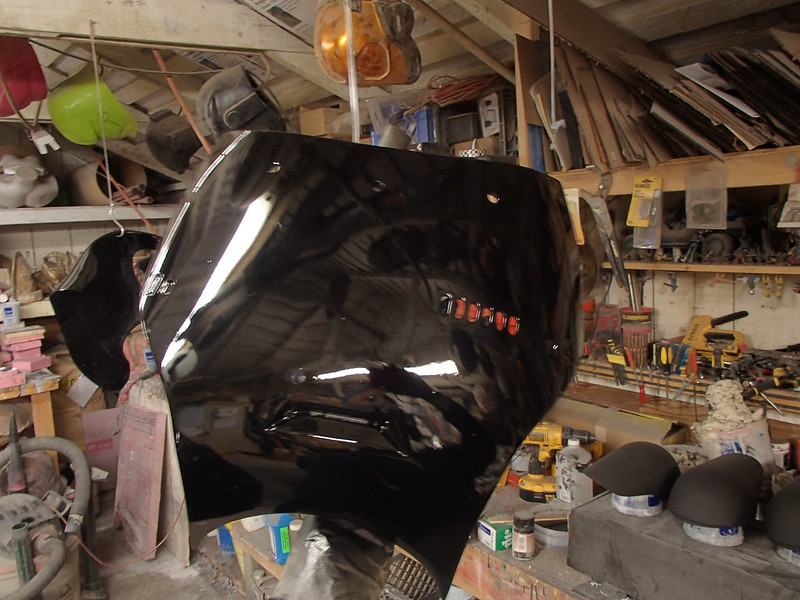

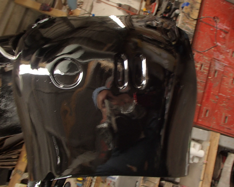

The gloss black revealed a few stray, tiny pinholes on some of the fiberglass parts:
This is the worst piece:

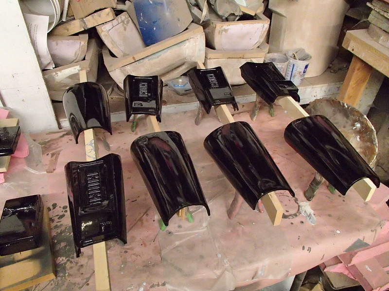

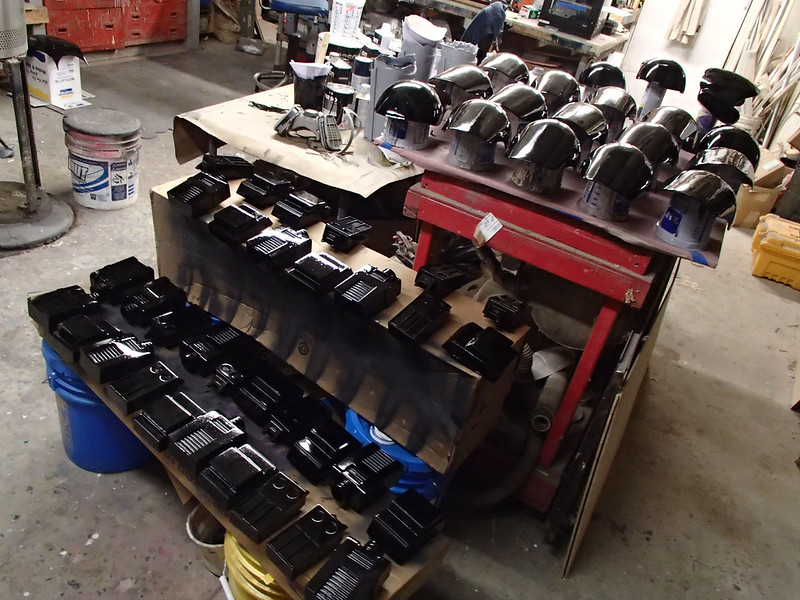

Still, at the end of the day, there was a big stack of painted chest boxes:
The resin pieces took the gloss much better:
Mostly because I did a better job of spotting all of the pinholes.
So now I'm just waiting for the paint to harden a bit more (it's cold here) and then I can touch up the pinholes, wet sand everything, and shoot another coat of gloss black. I'm using an automotive, single-stage urethane black, so it doesn't require a clearcoat. I may add one anyway since more shiny can't be a bad thing. It'll depend on how I like the surface once the second coat cures.

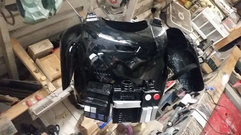

I decided to pull a hail Mary on Thursday and get a set of armor strapped together even though the paint wasn't perfect:

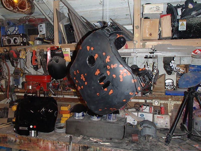

Here's another one of the chests after wet sanding with a dab of spot putty over every one of the pinholes I could see:
And one of the backs in the same state:
Since then, I've sanded them both down to 600 grit. The spot putty has been reduced to just enough to fill the pinholes themselves, so it's barely noticeable on the now dull surface.

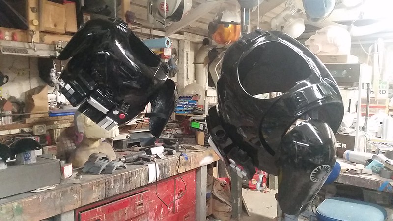

In any case, after tying down a few things so the wind wouldn't carry them away, I finally got a chance to swab out the workshop, set up for paint, and start shooting black. So now I have a second coat of paint on everything and it's gorgeous:
Once all of the paint hardens, I'll be buffing out a few minor flaws and it'll be time to pick out the details, add straps and decals, and finally say that I've finished myself one of the First Order costumes I've been working on.
