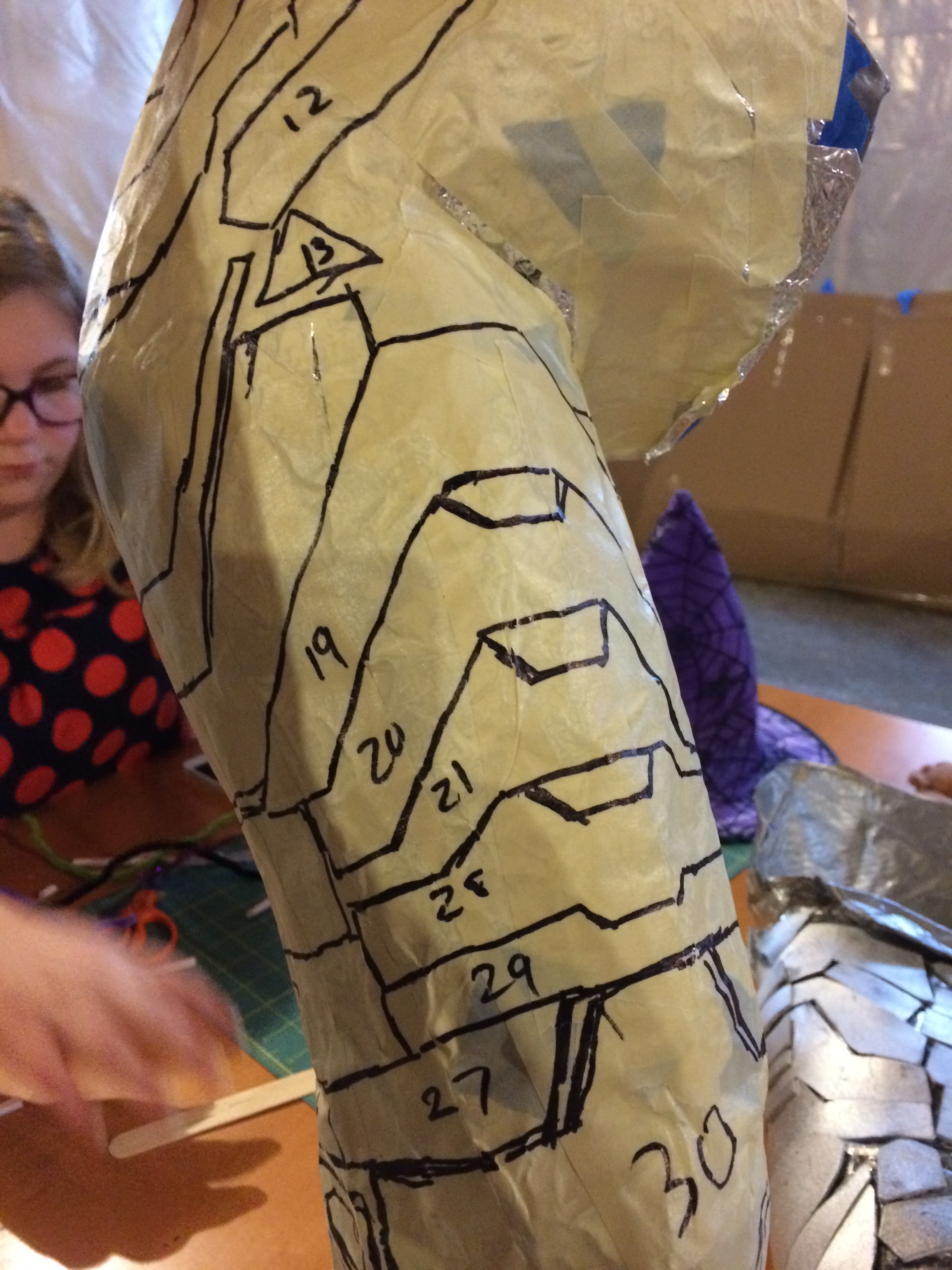

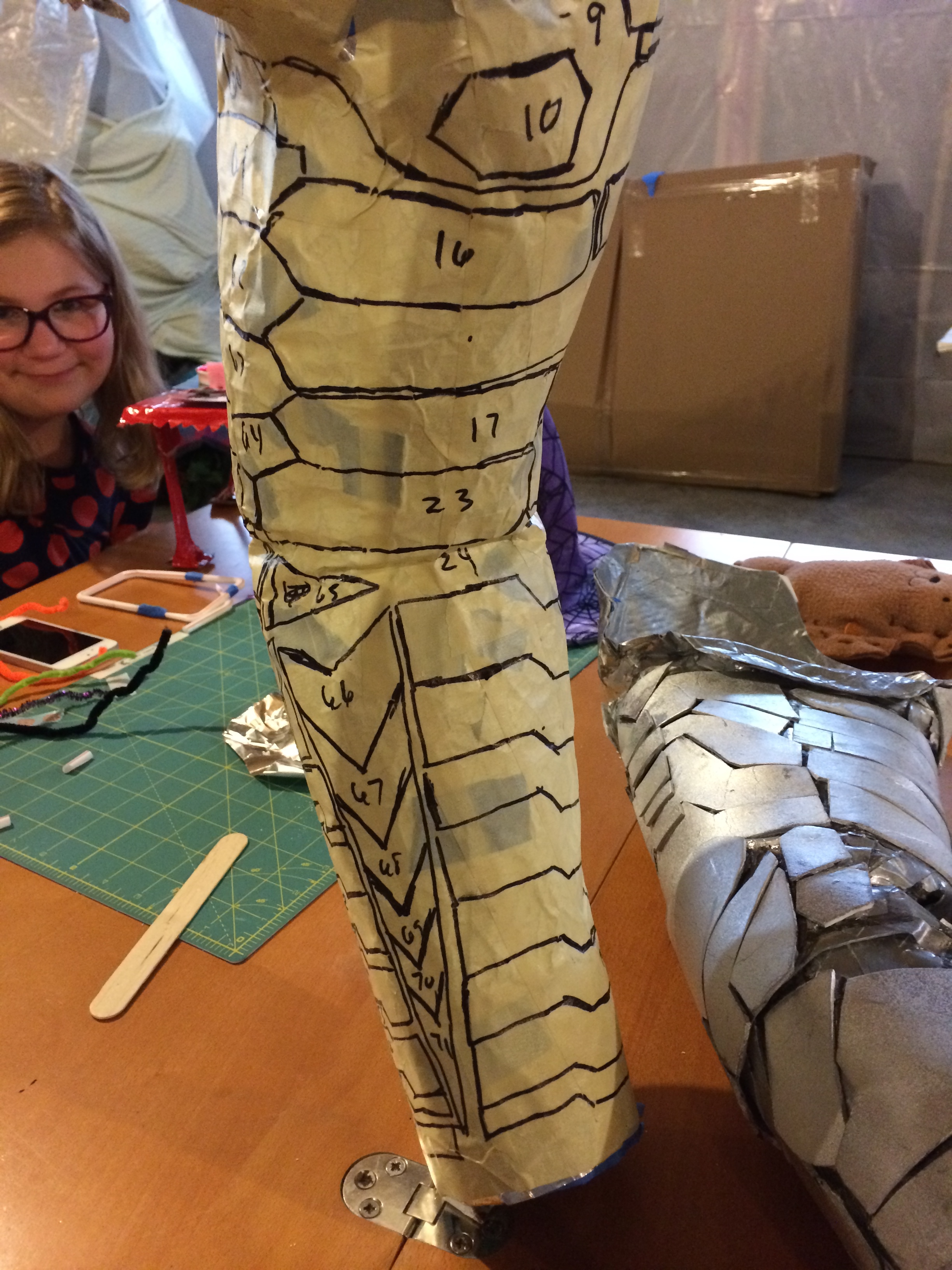

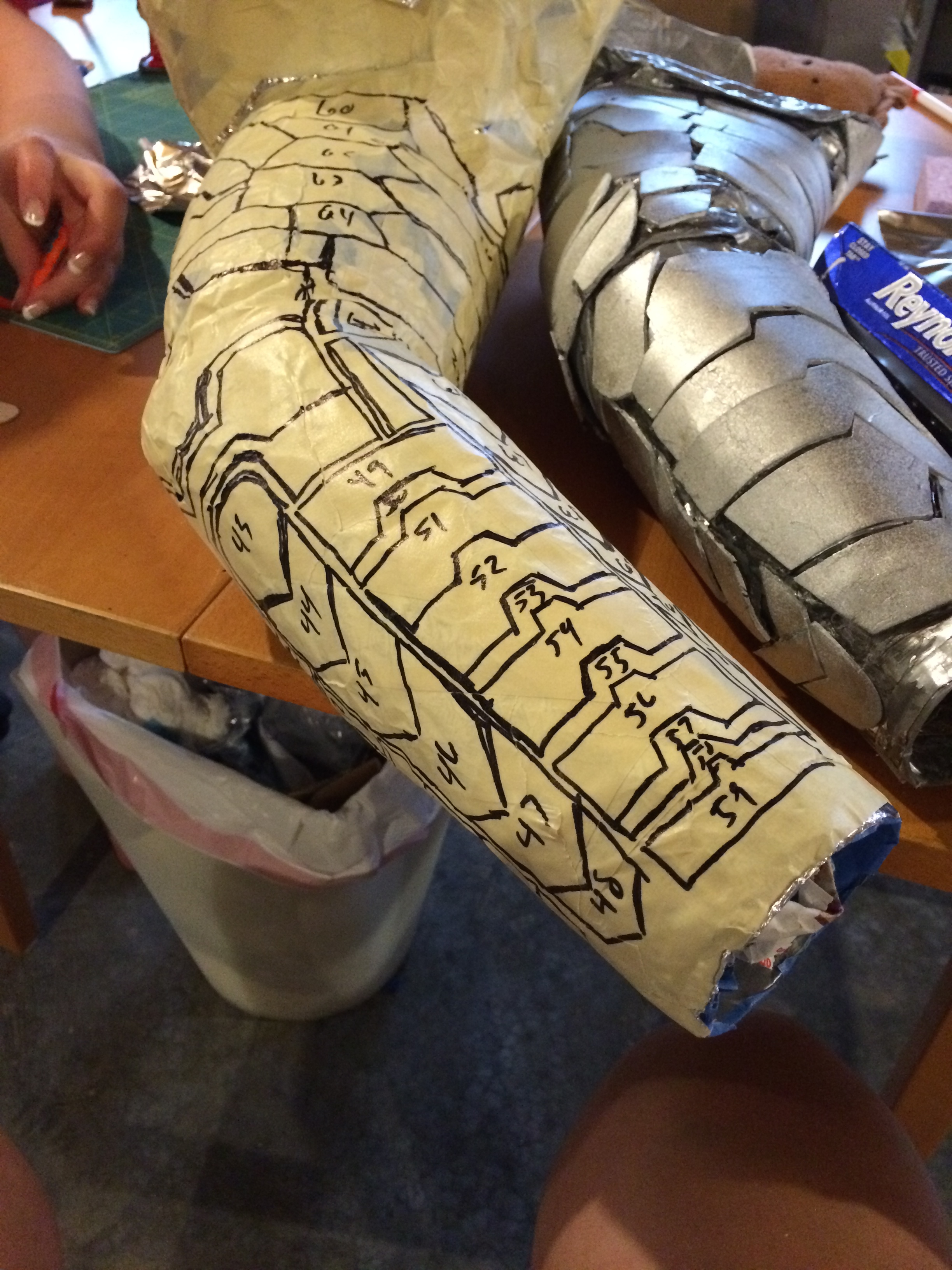

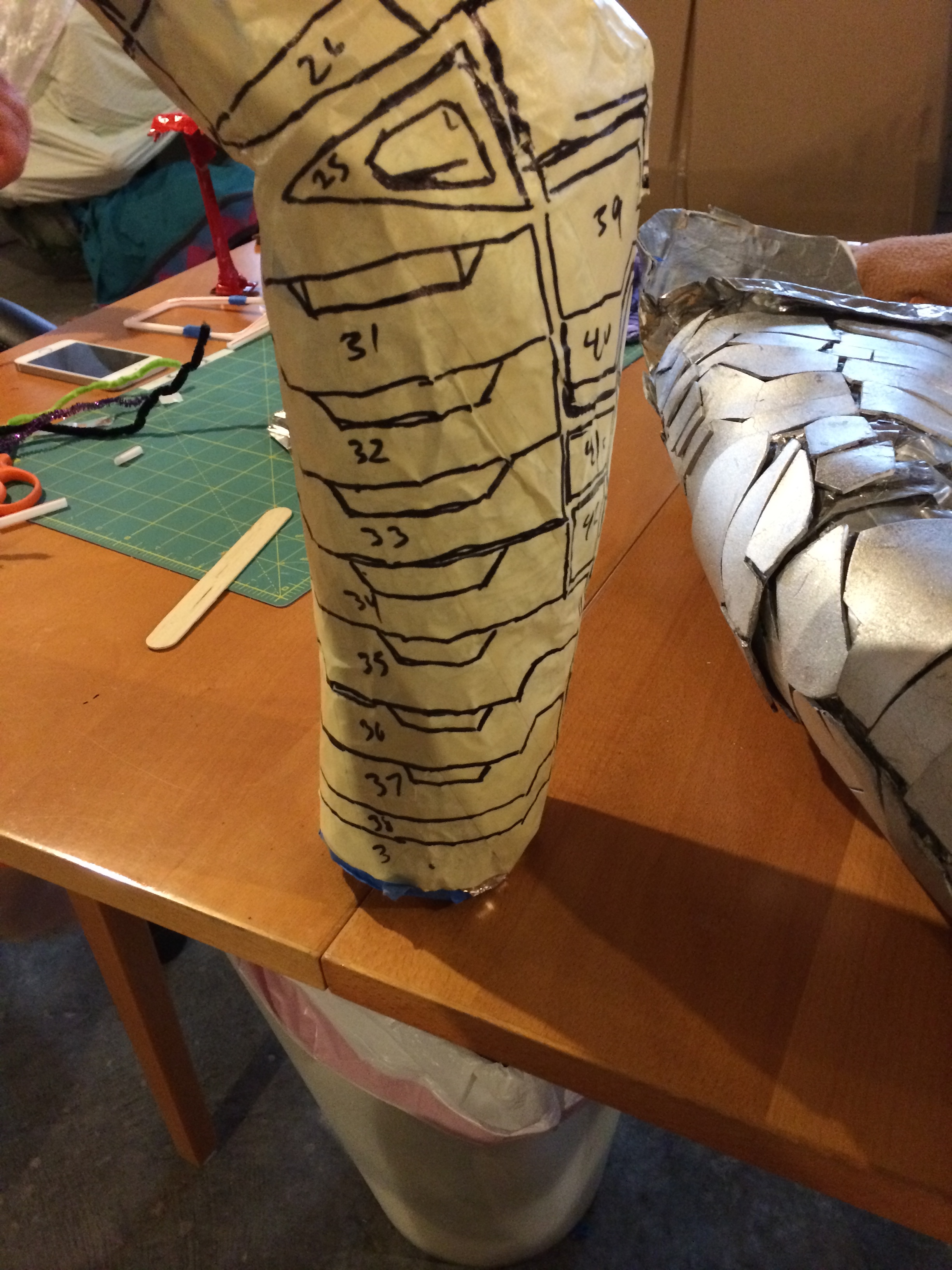

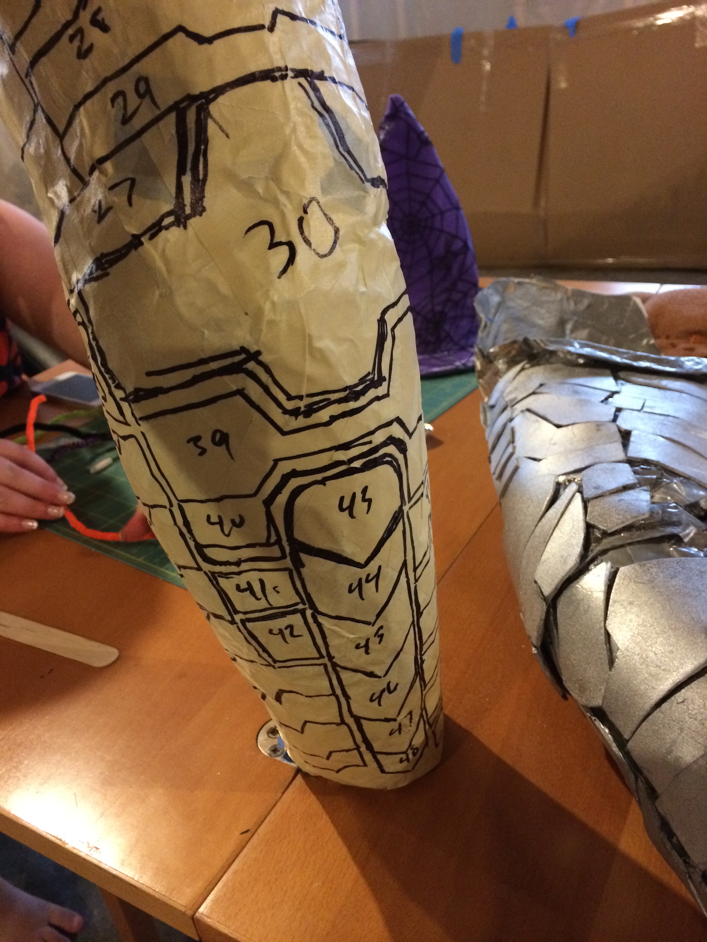

Noob here to the RPF and a Bucky Barnes Fan Girl:
I made my arm from a duct tape/plastic bag "cast" of my arm to which I drew out the complete pattern in aluminum foil overlay. I cut out each piece of foil and then cut each part in craft foam. I even articulated the elbow creatively so I didn't have to use a silver sleeve. (darn those CGI effects). I glued to my arm and then *tried* (after researching) to seal the foam and paint with spray paint. Came out great, BUT the paint flaked. I repainted by hand with acrylic silver but I'm not getting the shine. Hopefully it won't flake again with a day of Con-ing.
I'd worbla the thing, if I had a clue how to work with that stuff. Please take a look and if you have any ideas for how to seal, yet keep craft foam FLEXIBLE I'd be happy to hear them.
The last pic was of my arm 1.0 and my current arm 2.0. I also made my own mask with craft foam and a neoprene ski mask. It's a work in progress.
Run a heat gun lightly over the completed foam piece to collapse the cells on the surface and give you a smoother finish. Then ModPodge, Duraclear or just plain white glue over that for more smoothness. You can either apply 3-5 coats of whichever and call it a day or you can use PlastiDip to coat it for a more rubberized seal. Then prime and paint - I would recommend automotive paint such as Duplicolor for the best metallic look or, for the best flexibility, a spray that says it's good for use on silk flowers or NuLife which is paint that's made for shoes (vinyl and leather) and is therefore formulated to be flexed to extremes without cracking of flaking. All of those will have a silver version, but you'd have to test them on swatches of foam to see which one is the best. You may have to trade off flex for shine - so decide which is most important and go with that option.
For some great guides on foam, check out Bill Doran's books at Punished Props.
Cheers!
Thanks for those tips. When I built my arm 2.0 I researched the sealing technique you mentioned here and on other sites. I saw about using Modge Podge to seal the foam or white craft glue. I went with that method... 3 light coats, spray paint etc, and it still flaked like crazy. I also read that Modge Podge can yellow over time.
I recently bought some Modge Podge to "seal" my new hand paint job *hoping* to contain the damage and it crazes too. It's only in a few places that the foam flexes (elbow) and where I grasp it to pull it on at the wrist.
Yes, Punished Props was a useful site. That's how I got my idea to overlay the aluminum foil to make a template of all those intricate pieces. I'll check back again on him for foam tips.
