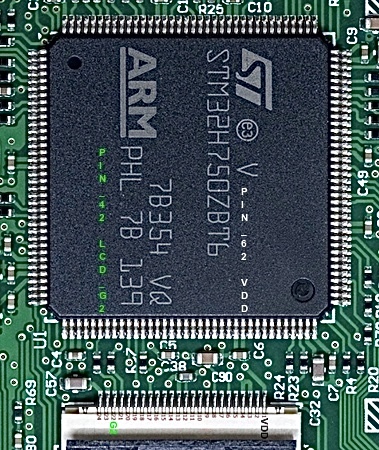

Looking at the ARM and LCD connector on the PCB…I was able to find just 2 ARM pin-outs to the LCD connector ….the rest are as previously mentioned buried and routed within the PCB layers.
I found the VDD trace from pin 62 of the ARM to pin 1 of the LCD connector.
I found G2 (Green from RGB signals) going from the ARM pin 42 to pin 22 of the LCD connector.
That’s about it (for now) …those are the only direct traces I can find on the top layer of the PCB associated with the LCD.

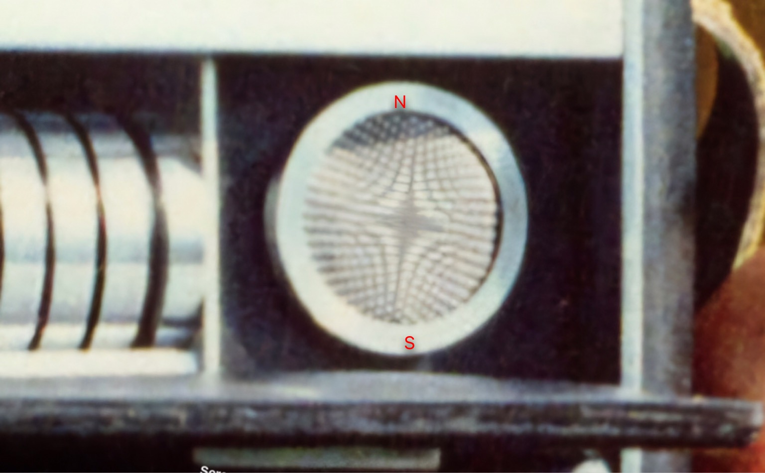

Now with two in possession, the only difference is the moire pattern seems to turn the other direction on the second one. I imagine that is just the outer insert is rotated 180 from the other. Which is surprisingly loose as others have discovered.
Is there a correct way for it to spin since the screen used one never did? lol

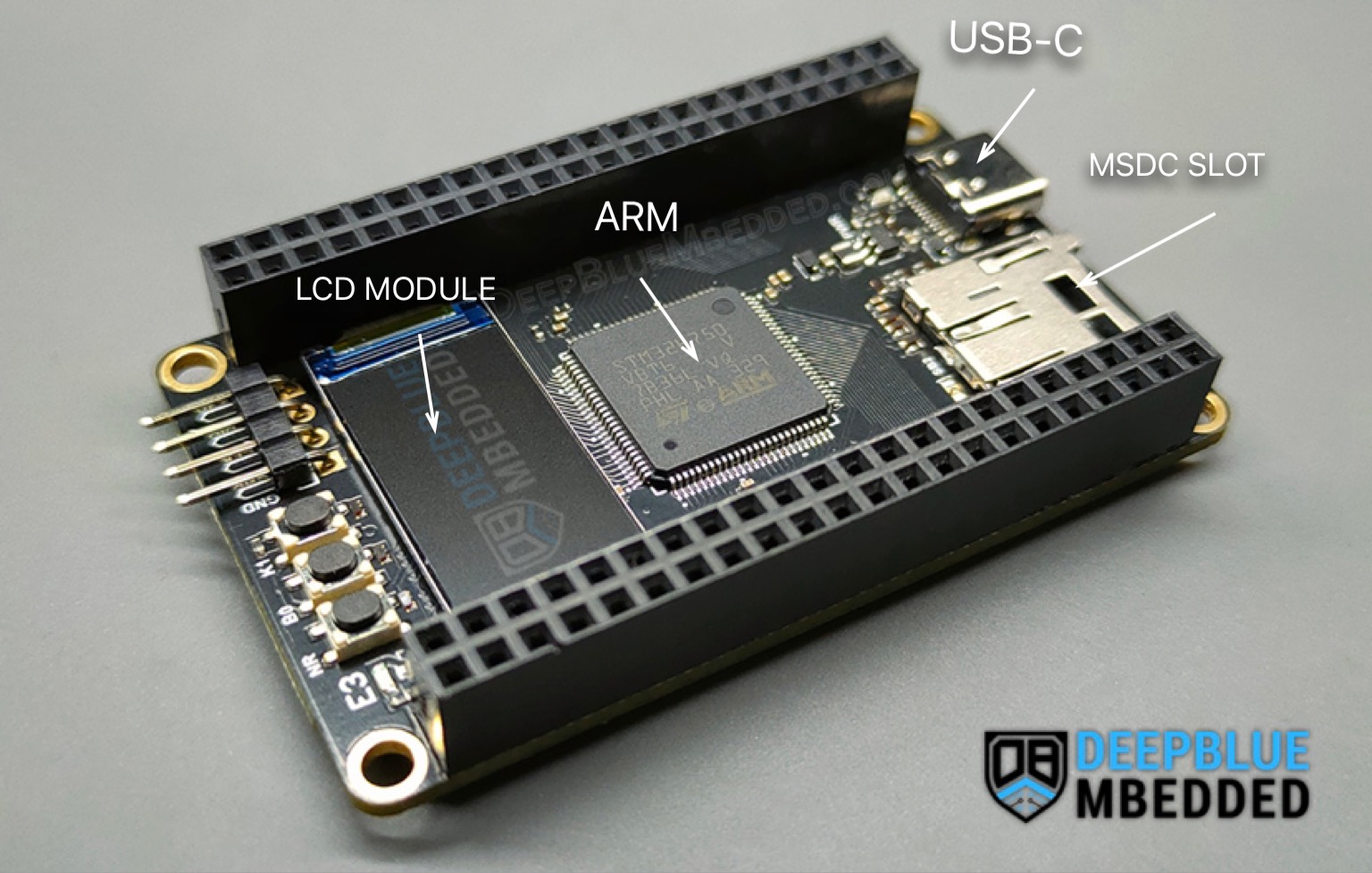

Why not try the engineering STM32H750VBT6 development board?
They are cheap and different ones if you search.
Here’s an example and what it features and comes with…some even with a color display mounted.
Tech Specs
  • STM32H750VBT6 Target MCU
  • 44×2 PinHeaders (76 GPIO Pins)
  • 480MHz Cortex-M7 CPU
  • 128KB ROM
  • 1MB RAM
  • 22x Timers
  • 3x 16-Bit ADC
  • 2x 12-Bit DAC
  • 2x Comparators, 2x OpAmps
  • HW Cryptographic Accelerators
  • 4x I2C, 4x USART, 6x SPI/I2S, 2x SDIO, 2x USB OTG, 2x CAN, 1x Ethernet, 1x DCMI
OnBoard Features
  • USB Type-C
  • User LED (PE3)
  • User Key (PC13)
  • BOOT0 Key
  • RESET Key
  • 25MHz HSE
  • SD Card Slot
  • 0.96″ TFT LCD Display
  • DCMI (Digital Camera Interface)
  • 8MB QSPI Flash Memory (W25Q64)
  • 8MB SPI Flash Memory (W25Q64)
You can experiment and use what you’ve learned …here’s a website, to start with…… LINK
The ST detailed reference manual at the link…is the real deal….an extensive section on the LTDC!
Here’s a short vid on the development board…..
Link
