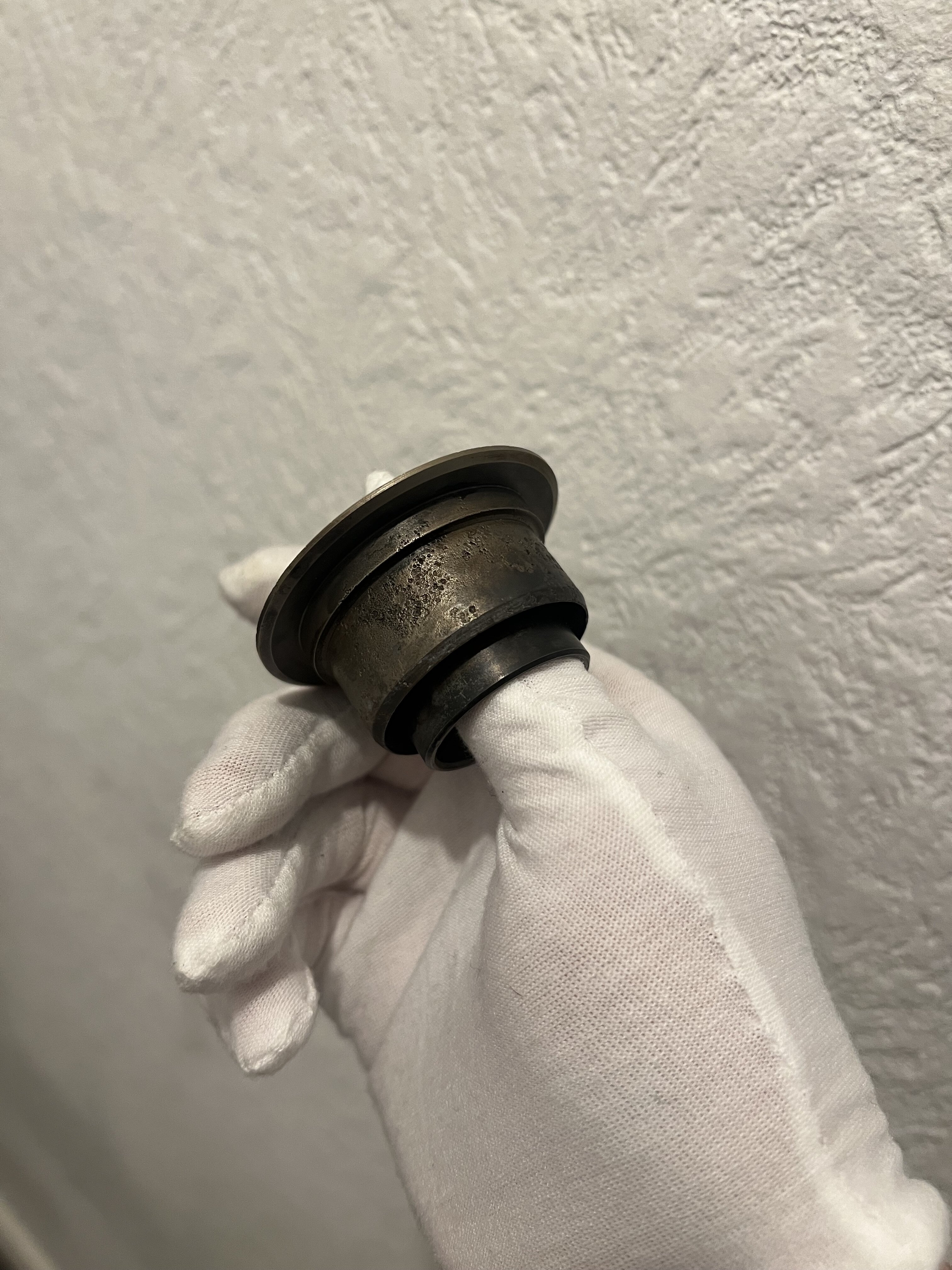

Had this spare vintage female sitting around and in desperate need of its clothes back! Lithium grease and blowtorch strat was employed !!

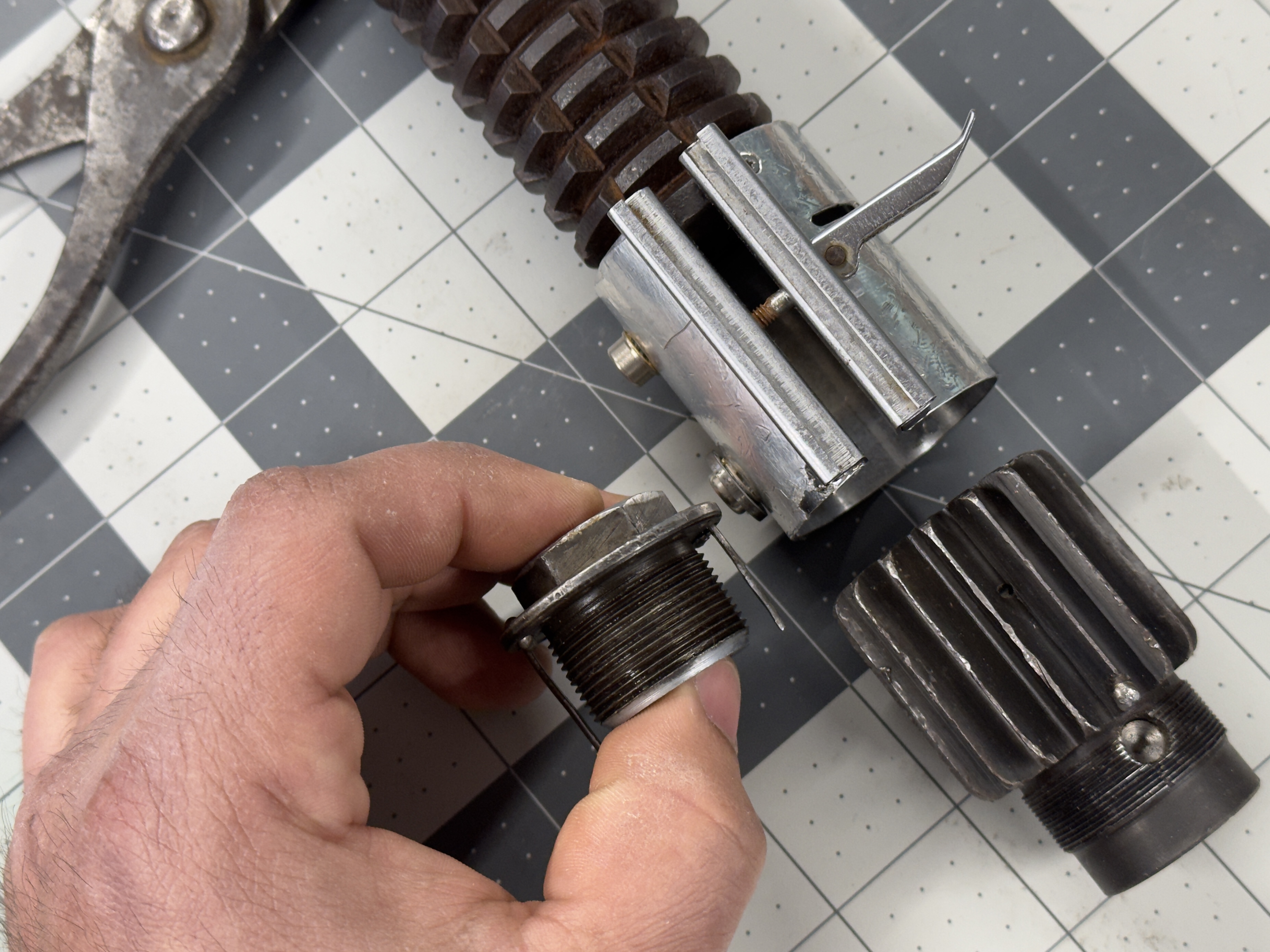

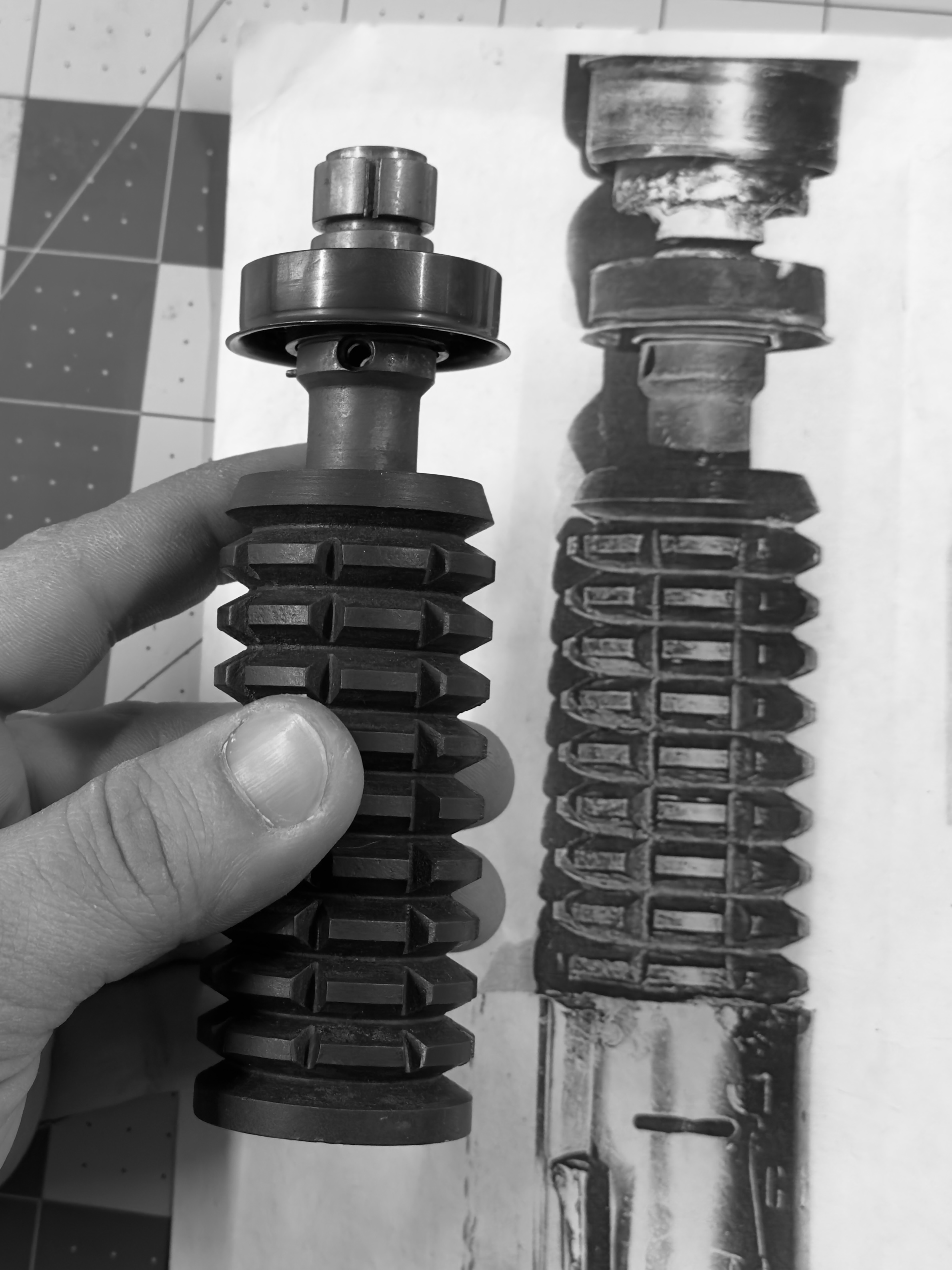

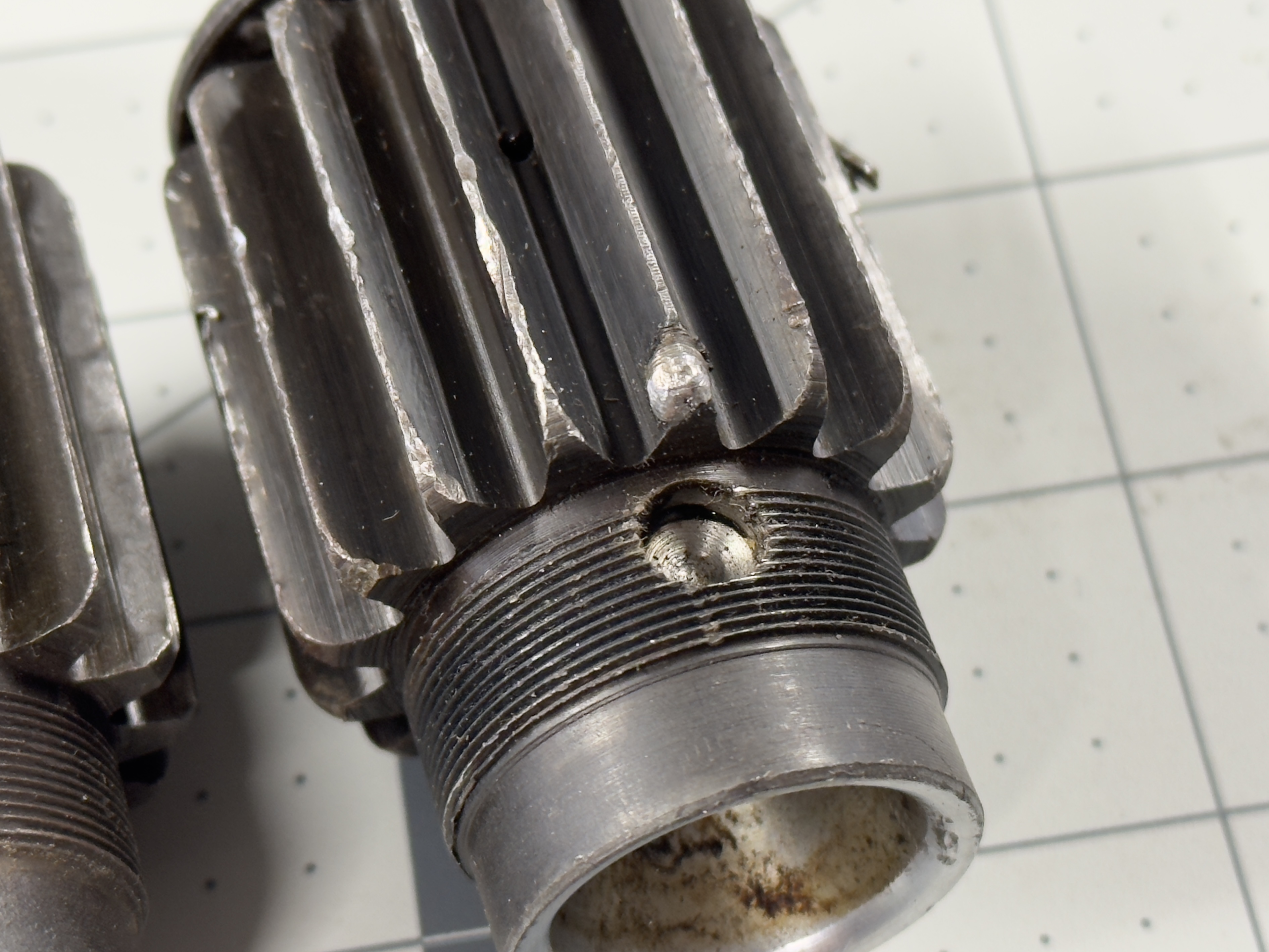

So the parts showed up in record time, shipped out Tuesday and delivered Wednesday afternoon! Very fast from UK to US.

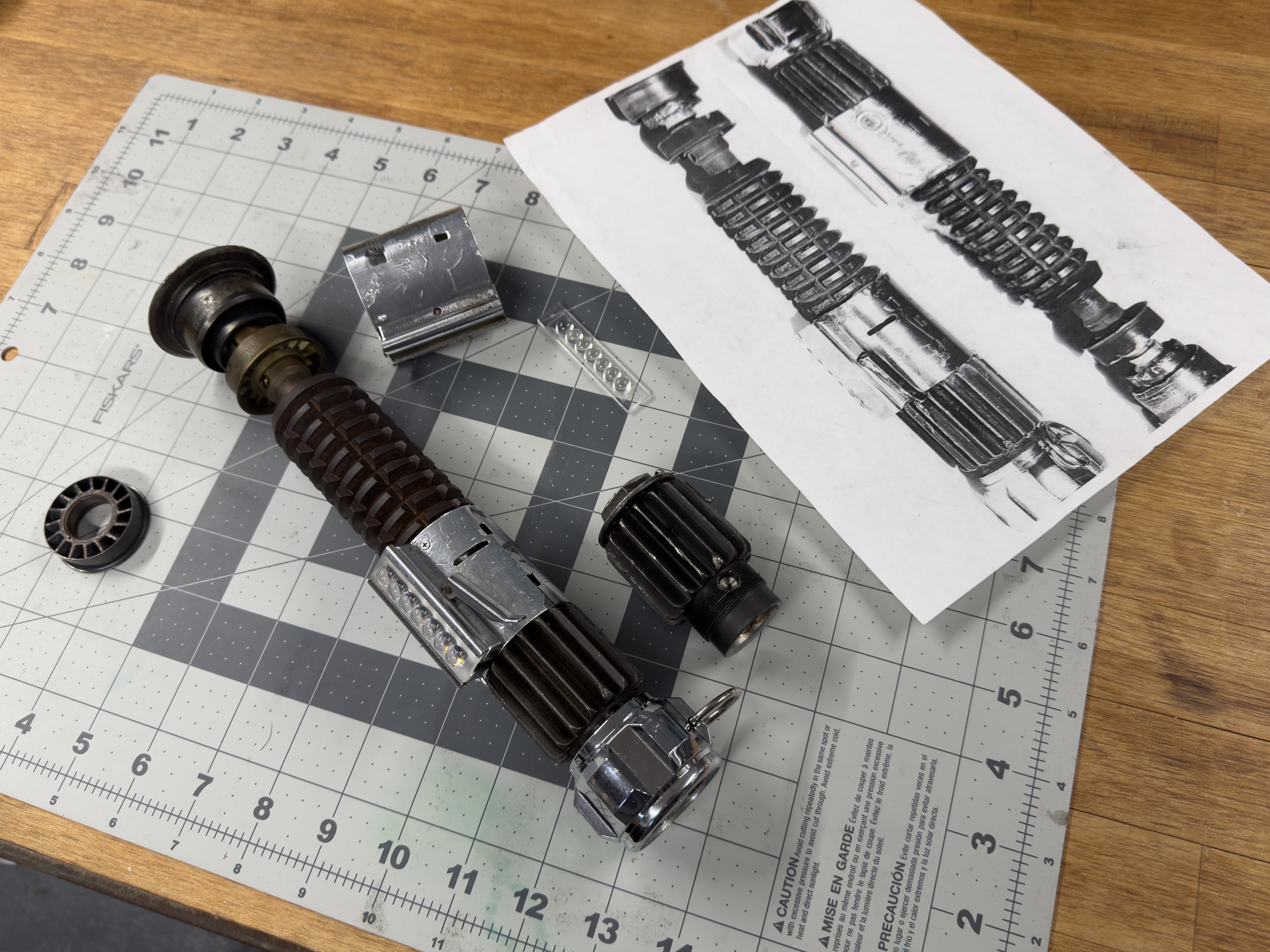

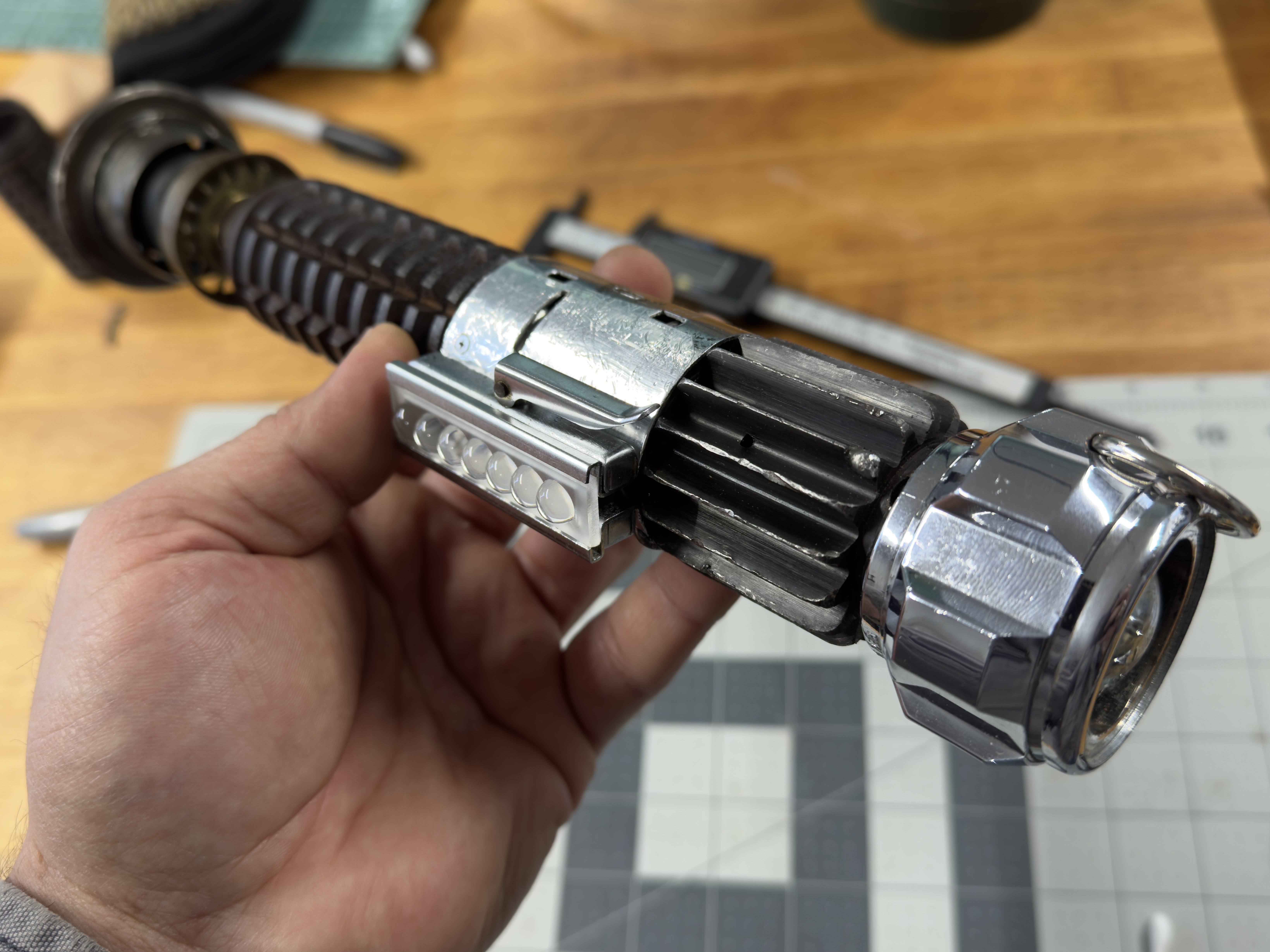

The plan was to disassemble my sabers middle section and swap the booster with my new one. Once the switch was made then it's time to assemble the bottom section for Kian!

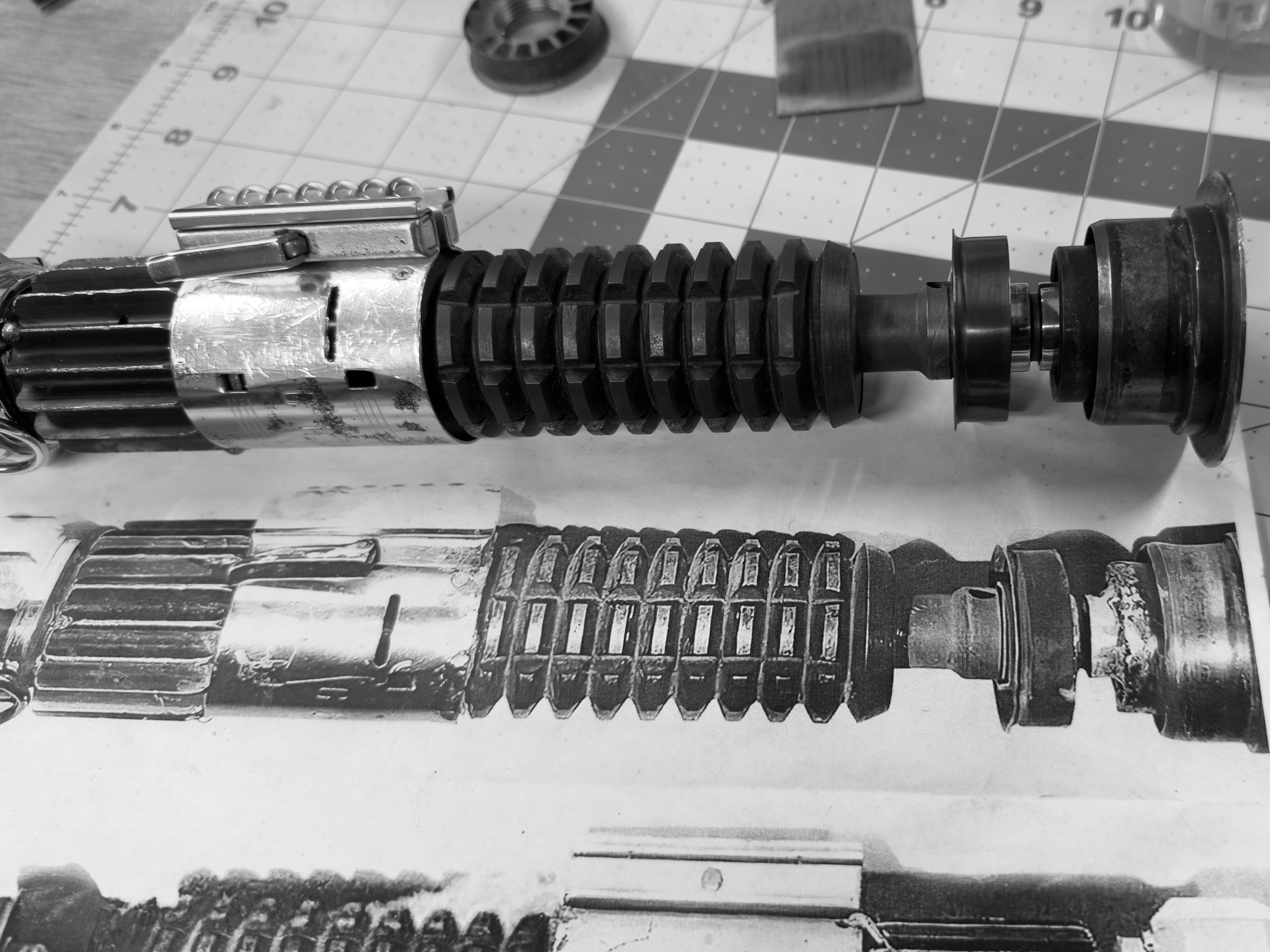

Here we've got my printout at scale which I use for alignment reference and my saber ready for some upgrades.

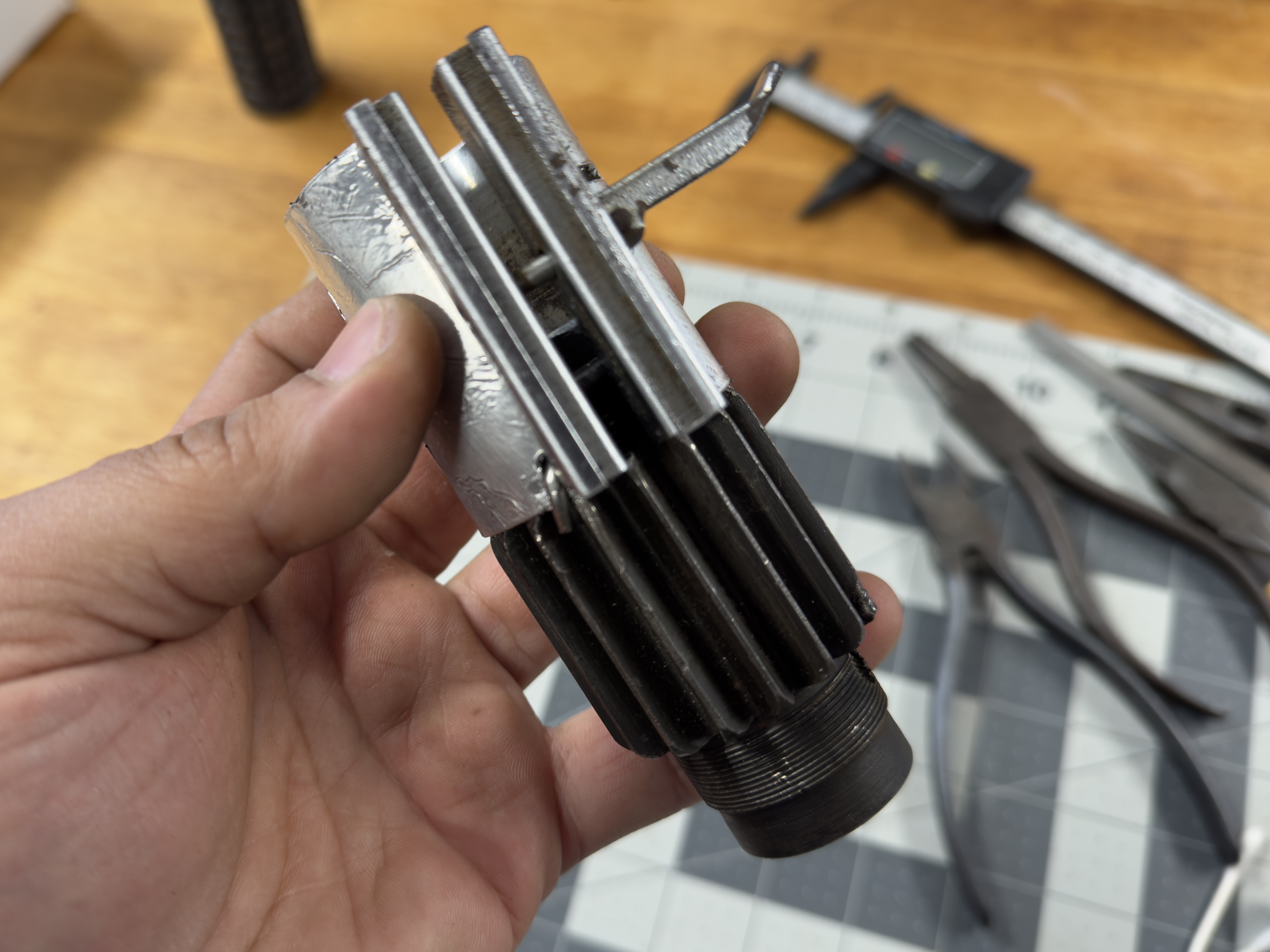

Closeup of the new booster in all its beautiful imperfection

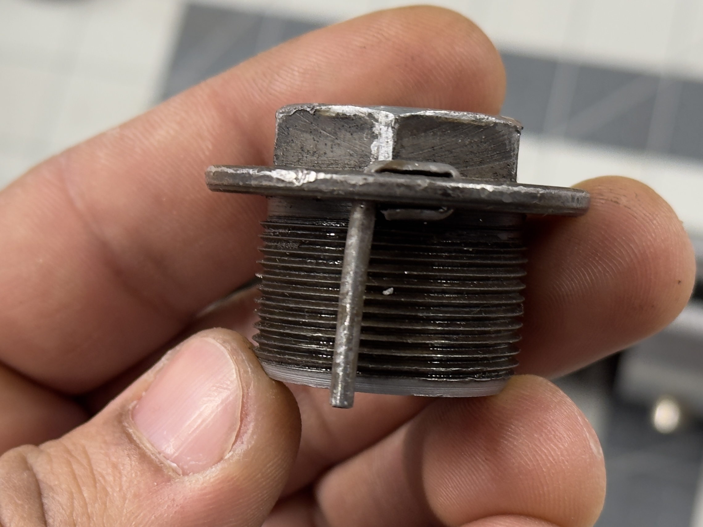

This is how the clamp is assembled to the booster. One of the first boosters I owned had copper wire wrapped just like this in lieu of cotter pins. This allows the booster and clamp to stay aligned and tight to each other.

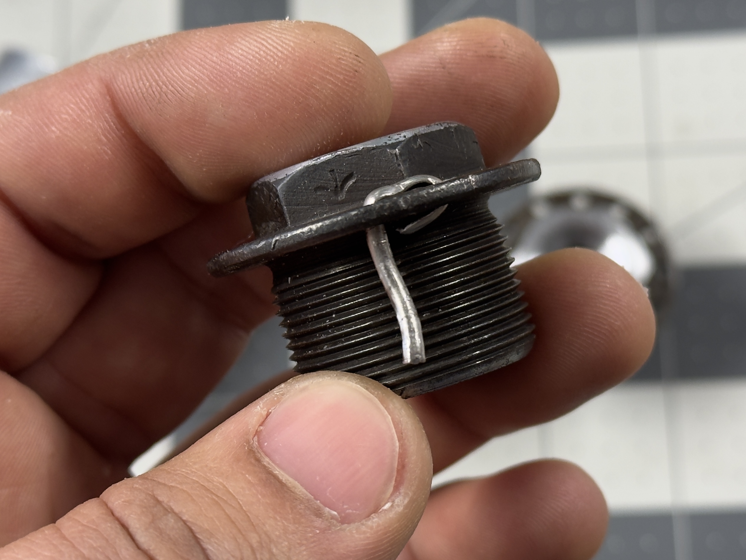

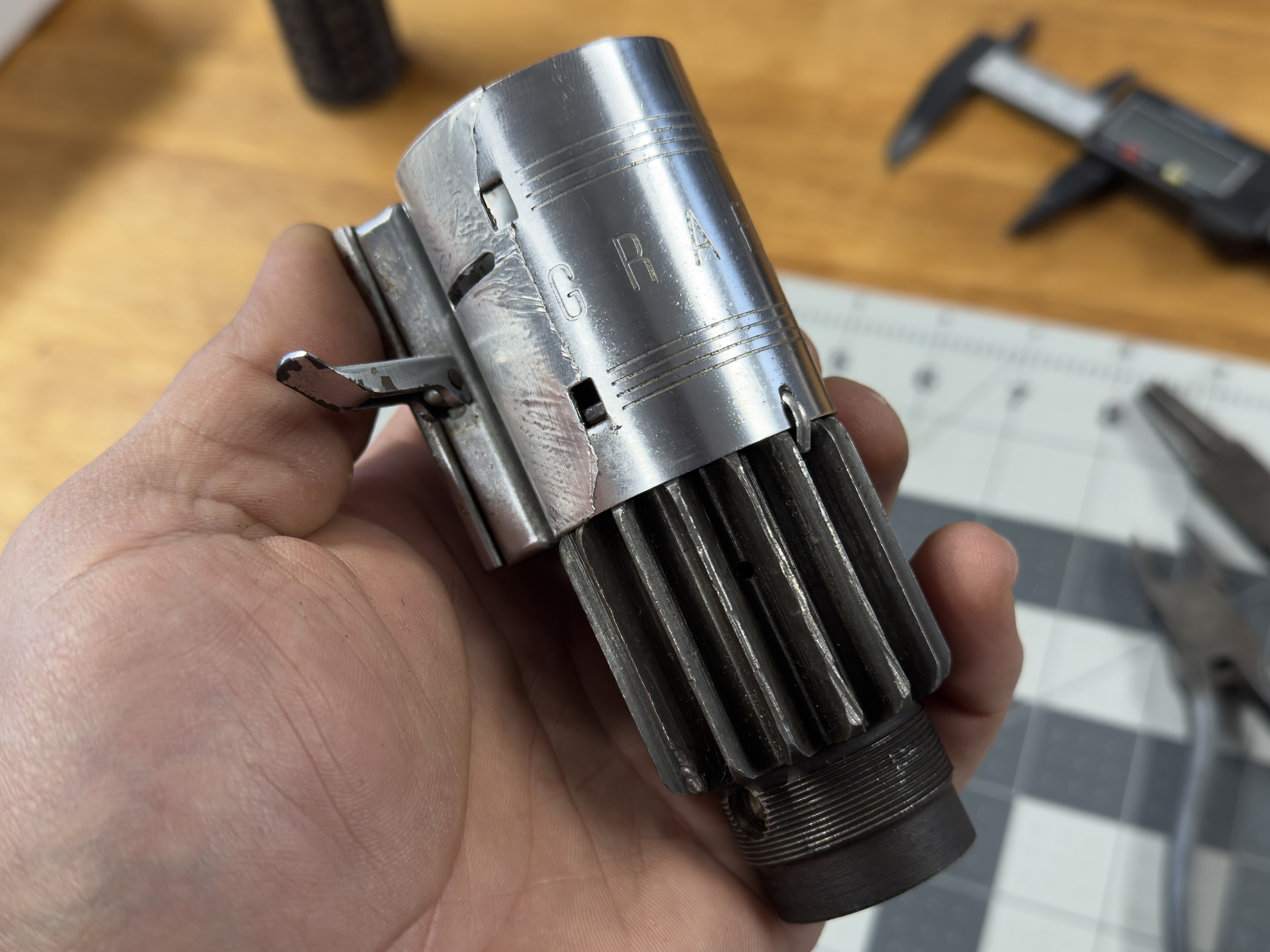

This is roughly how the bearing sits in there, with plenty of wire poking out to bend into the fins of the booster.
The first time I did this I didn't leave enough hanging out, so I fixed that on both of these clamps this time around!
There's not a ton to show in terms of actually fitting it on there, the cotter pins get splayed out a bit at the bottom and then the whole thing gets put inside the clamp. You can use the booster itself to start the threads and pull it down if the fit is too tight. Here's my saber with the booster clocked correctly and tied to the clamp.

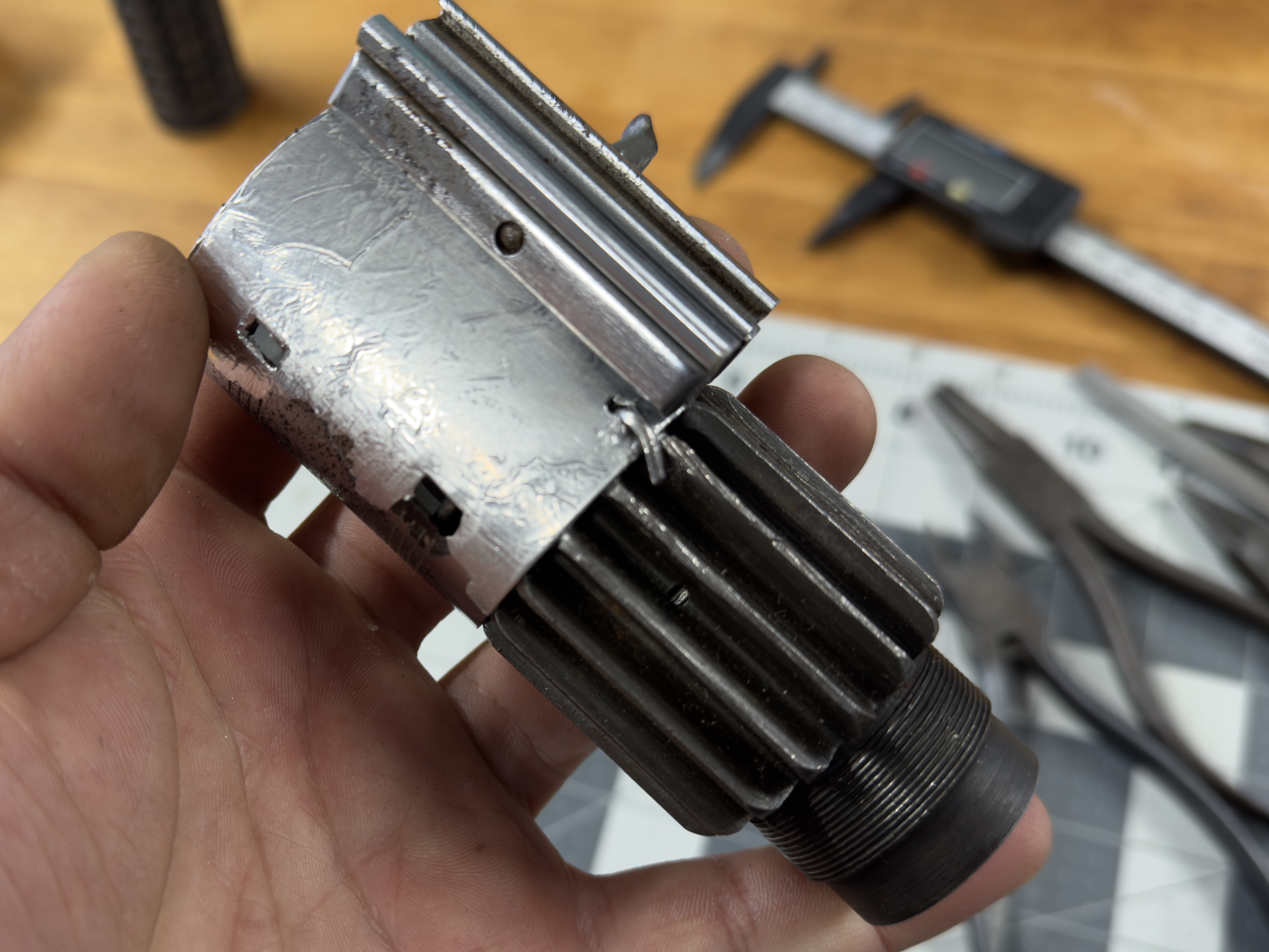

Here's how Kians clamp and booster assembly turned out.
I bent these to match the length and angle on the Chronicles photos. Both of these boosters are put on here with the bearings and cotter pins they came with which is a detail I'm very pleased with.
The other side showing the other pin

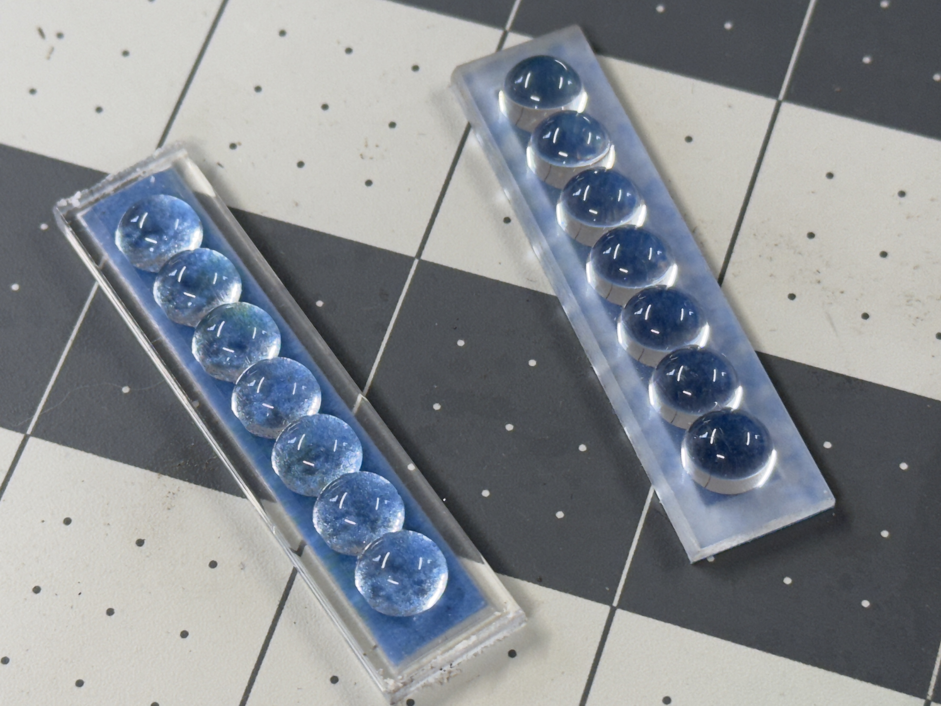

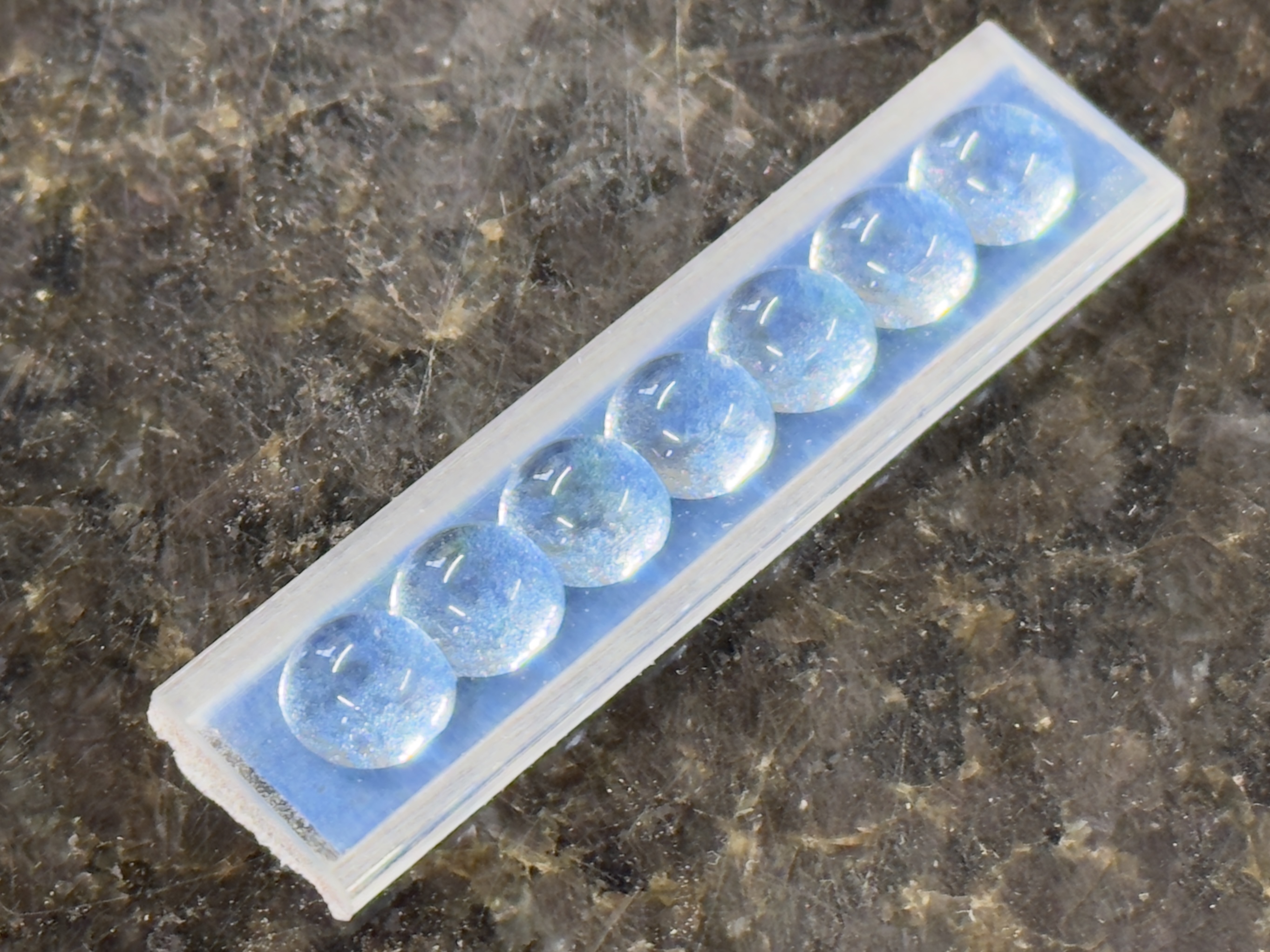

Last but not least bubble strip time! I spent all of the time figuring out how much to offset the bubbles on my strip, so I removed it, taped it to protect the back, and took it to the belt grinder as reference.
Here the offset is done and I've sanded the rails to make it a little frostier looking. I've also gone a given the sides of the bubble strip a gentle filing by hand to make it fit nicely in the clamp.

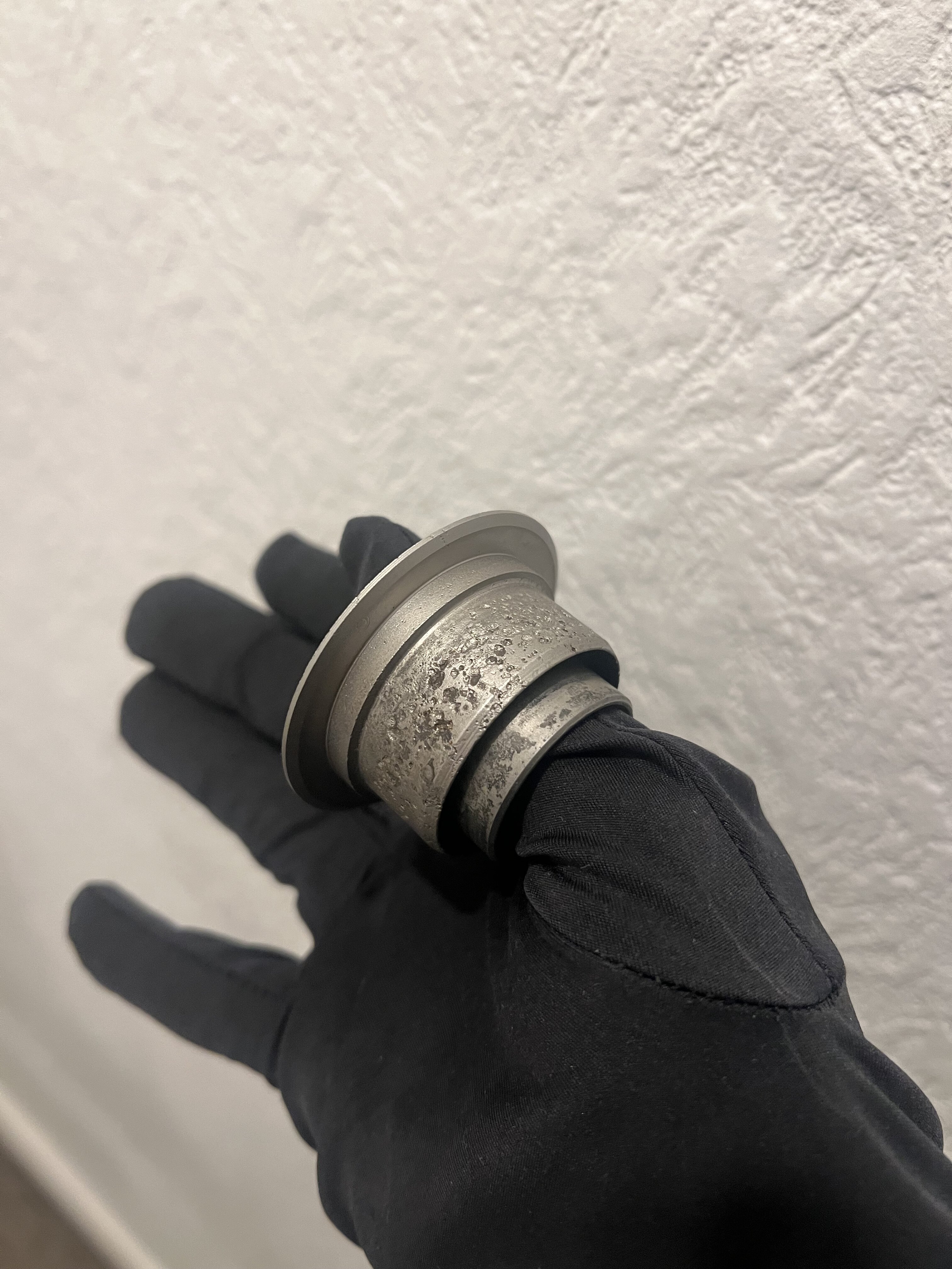

Jumping forward a bit I started playing with the wind vane to get the patina right. After a few hours and some stripping, application, stripping etc. I landed on a finish and color I liked! I tried to match the relative color values of the sections here as best as I could given the materials I was working with.
Essentially the wind vane and grenade have about the same color in terms of darkness, the bottom of the neck is brighter, and the top of the neck is brightest. The top of the neck is brightened quite a bit and then waxed, we'll see how long it stays shiny for. I'm not using a flash here so the neck doesn't light up as bright as the chronicles pics.
The first one is without the top of the neck being brightened
And here you can see it shined up, with a flash I think it would look a lot more like the reference pic!

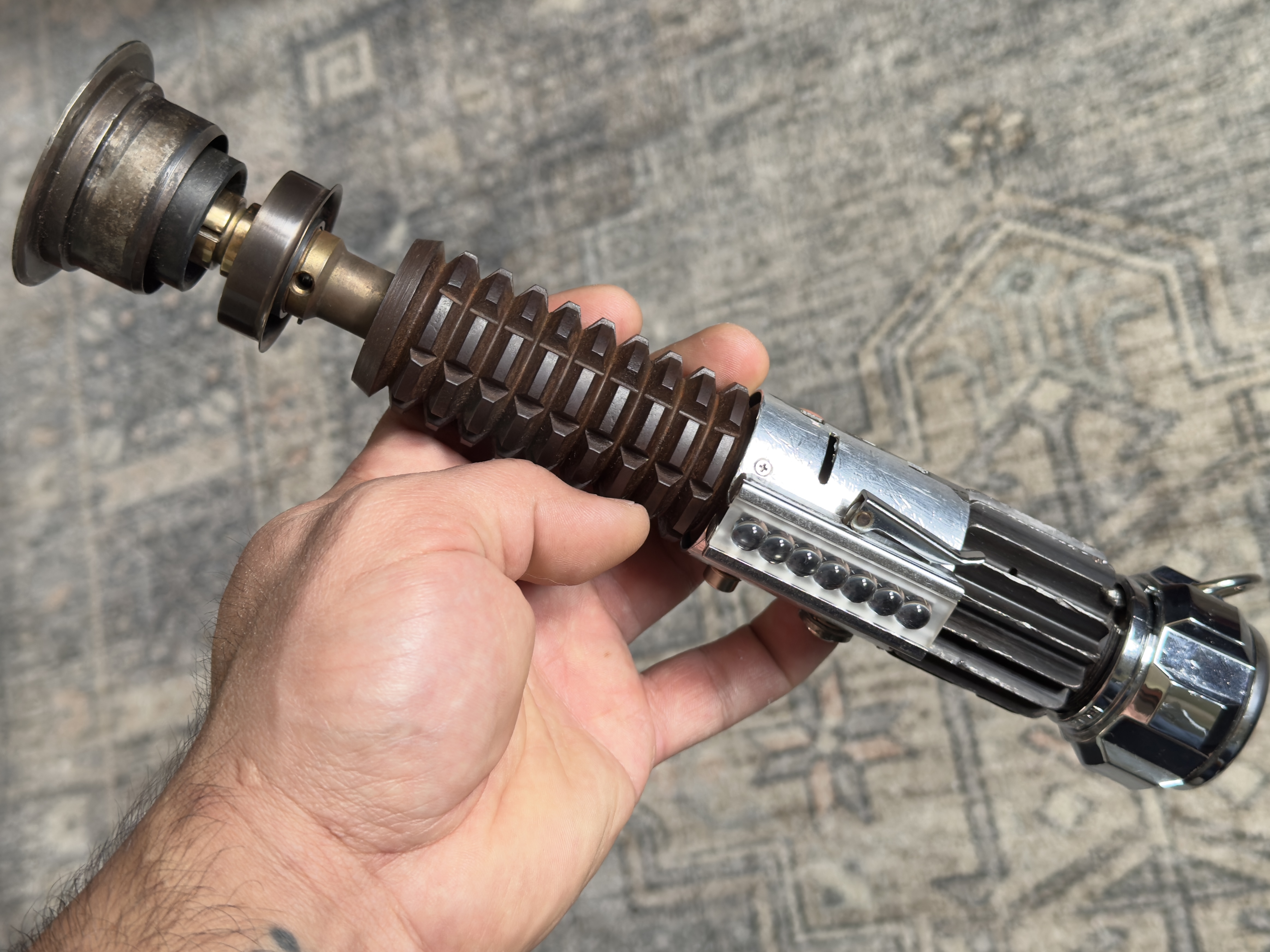

So here's where I've landed for now. Mine is done save for the cubes which I'll work on soon and once my set and Kians are drilled both sabers will be done. I'll let Kian be the one to show off the parts and then his finished saber when they arrive!

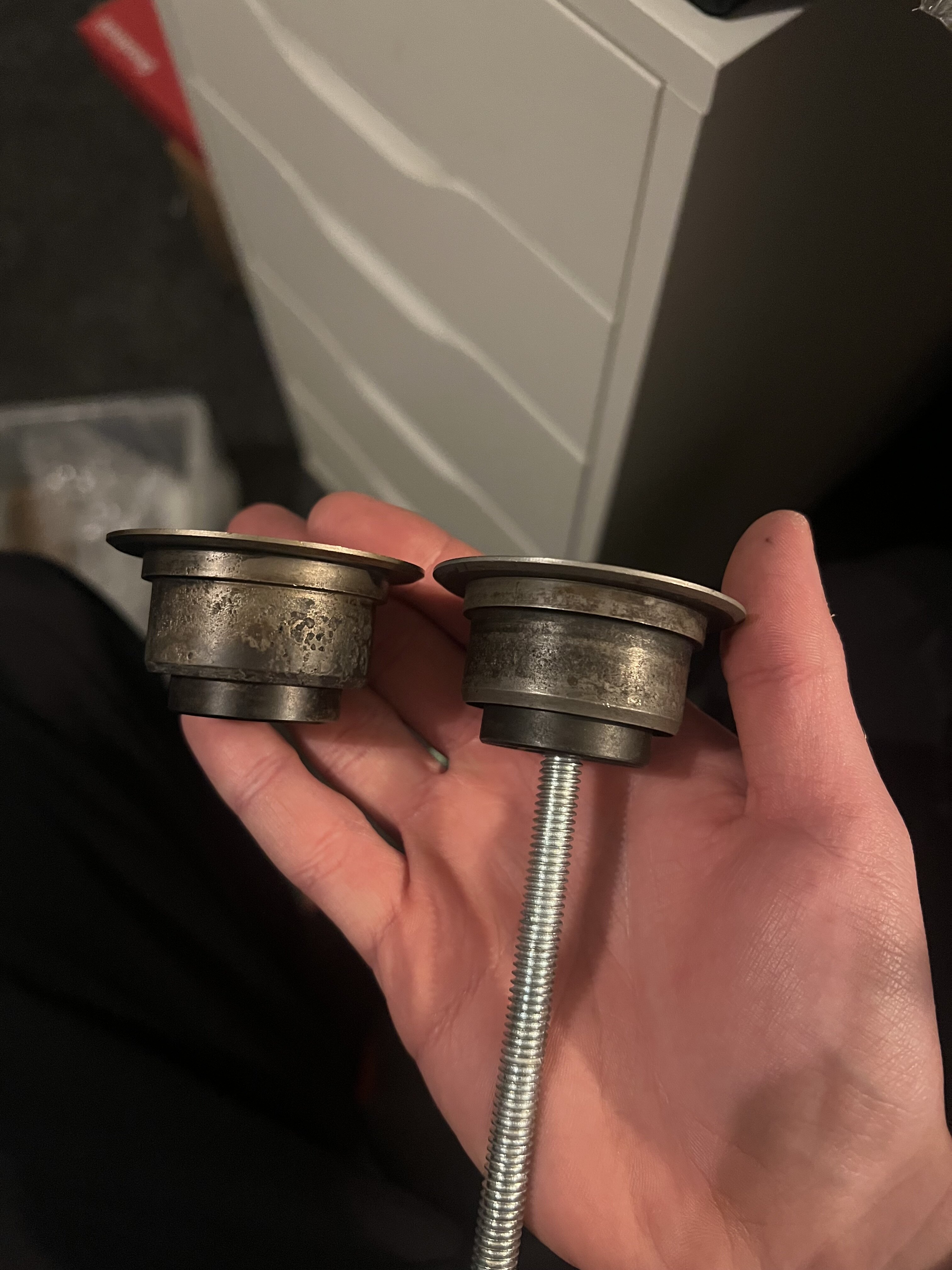

I did this and took pictures in my backyard while I did a couple years ago. I have a hero Obi Wan thread on here, used a benzo torch and some really cheap lithium grease. Weirdly I got a darker color if I put grease on after I heated it up, as opposed to cooking off the grease first.
You did this to a vintage BP, or was it a replica?
I’d hazard a guess that applying while hot means it’s more porous and therefore better opportunity to maybe take the LG deeper into the surface. But a cold application then heat would work its way onto the surface, but not get as deep into the pores?
Thanks for sharing the method, man!! It worked great
Edit: just to show you how good your method worked, here’s a pic of the refinished bp next to my personal female (on the threaded rod), which still has its untouched/straight out of the engine finish:
