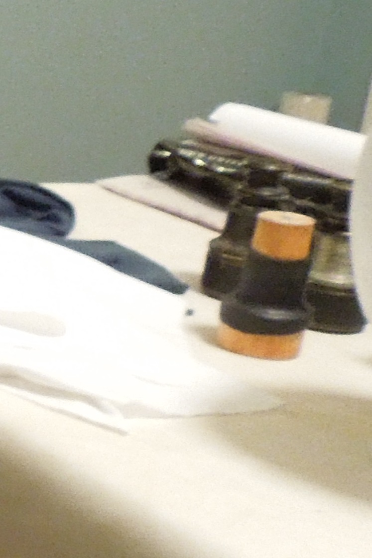

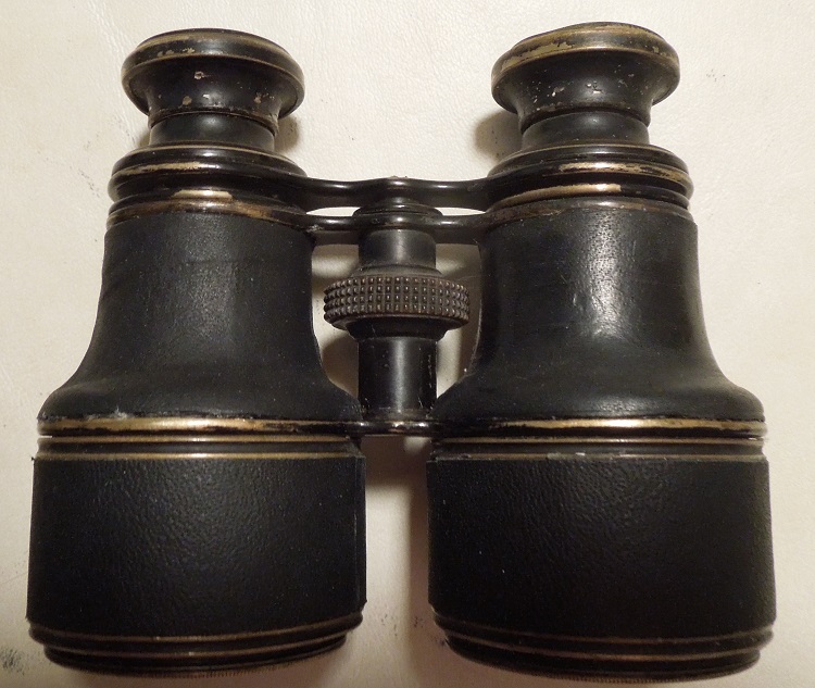

I turned a pine wooden form, shellacked it and used it for wet forming 2 small pieces of black goatskin leather.
attachment.php
These were used to replace the leather on the old pair of brass binoculars I found.

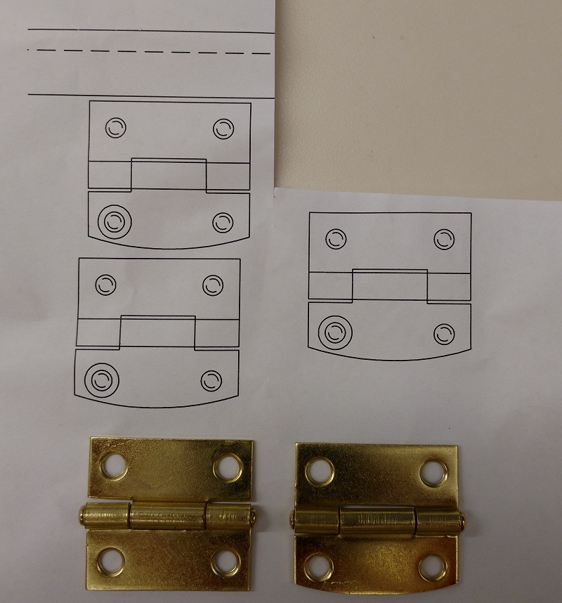

I think I have found a majority of the hardware for the build but I am having issues with the hinges. Did you find them or have they been customized to match the screen version?

I searched high and low on the Internet for that stupid hinge and then found them while looking for something else at a Lowe's Hardware. They're a 1.5 inch 3 knuckle brass plated hinge. I then used a bench grinder and rounded off one side to a 2.5 inch radius.
attachment.php
Being they are plated, I used a combination of antique brass paint misted with some flat black.

Hahah, I did the exact same thing. Good to know there isn't a magic resource of hinges that has eluded me. Thanks for the reference.
