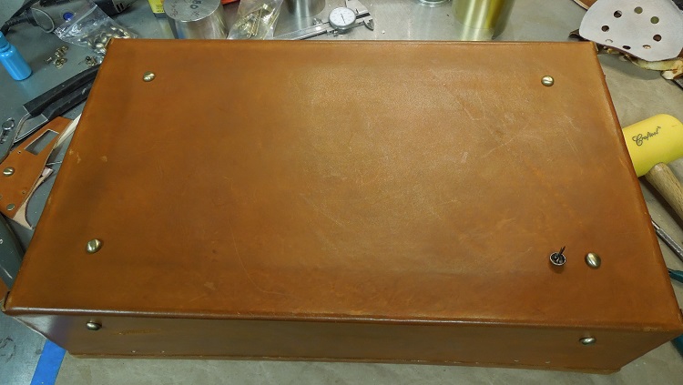

Added feet to the back and bottom of the case.
attachment.php

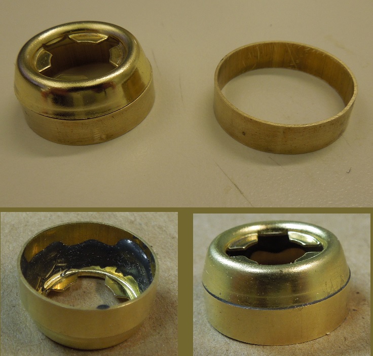

The locks on the latch plates I found are obviously not quite like the ones on the prop; the lock slide is taller on the prop to accommodate the "Muggle Worthy" flag, and the false keyhole is considerably larger. So they need to be modified slightly:
attachment.php
The red arrows point to 2 bent-over metal tabs. If these are bent up and straightened out, the lock comes right off.
It looks like this:
attachment.php
The lock consists of 3 pieces. The bit on the left is the keyhole which will be discarded. The "legs" on the piece in the middle will be too short, so it'll be replaced. The beveled piece will be re-used.
Using my Dewalt miter saw, I cut two 1/4" (6mm) pieces of 7/8" (22mm) diameter brass tube. After some filing and sanding, these pieces were epoxied to the bevels.

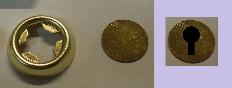

attachment.php
I bought some 15mm brass discs to use for the keyholes, but once they were in hand, I couldn't devise a way to hold them so that the hole could be drilled, and then some way to accurately add the slot.

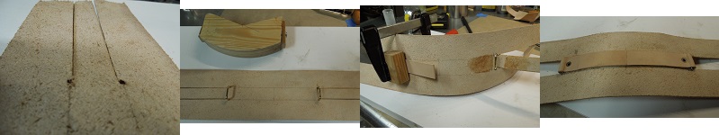

I started by making a wood form, radiused as the handle, with simple clamps to hold the rings on either end.
attachment.php
I'm using 7 ounce leather for the handle (the case, lid and corner guards are 5 ounce, and the edging is 2 ounce).
I skived the edge of the leather that folds back over the rings so as to make the handle rounded at the bottom. I then placed the leather in the form and clamped down the rings. The folded-back leather was then glued and clamped. When this dried, I added some rivets just for good measure.
attachment.php
I then used scrap pieces of leather to build up the "interior" of the handle, skiving and shaping the leather as the layers were added:
attachment.php
Here's what it looks like from the side:
attachment.php

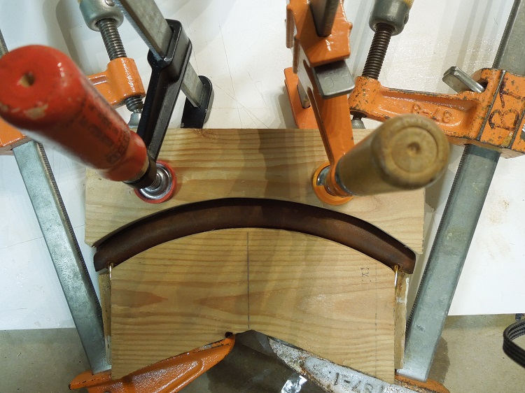

For the wet forming, I thoroughly wetted the outside leather with warm water and then bent it up, over and around the innards. It sort of molded it itself and was whole lot less effort than when I made the nose for the boots which took a good hour of tugging and pulling and kneading and nailing.
attachment.php
I then pushed the leather into a second wood form with slots, and clamped it:
attachment.php
Looking at the end:
attachment.php
The leather has to thoroughly dry, then it can be glued, trimmed, punched, and stitched.
