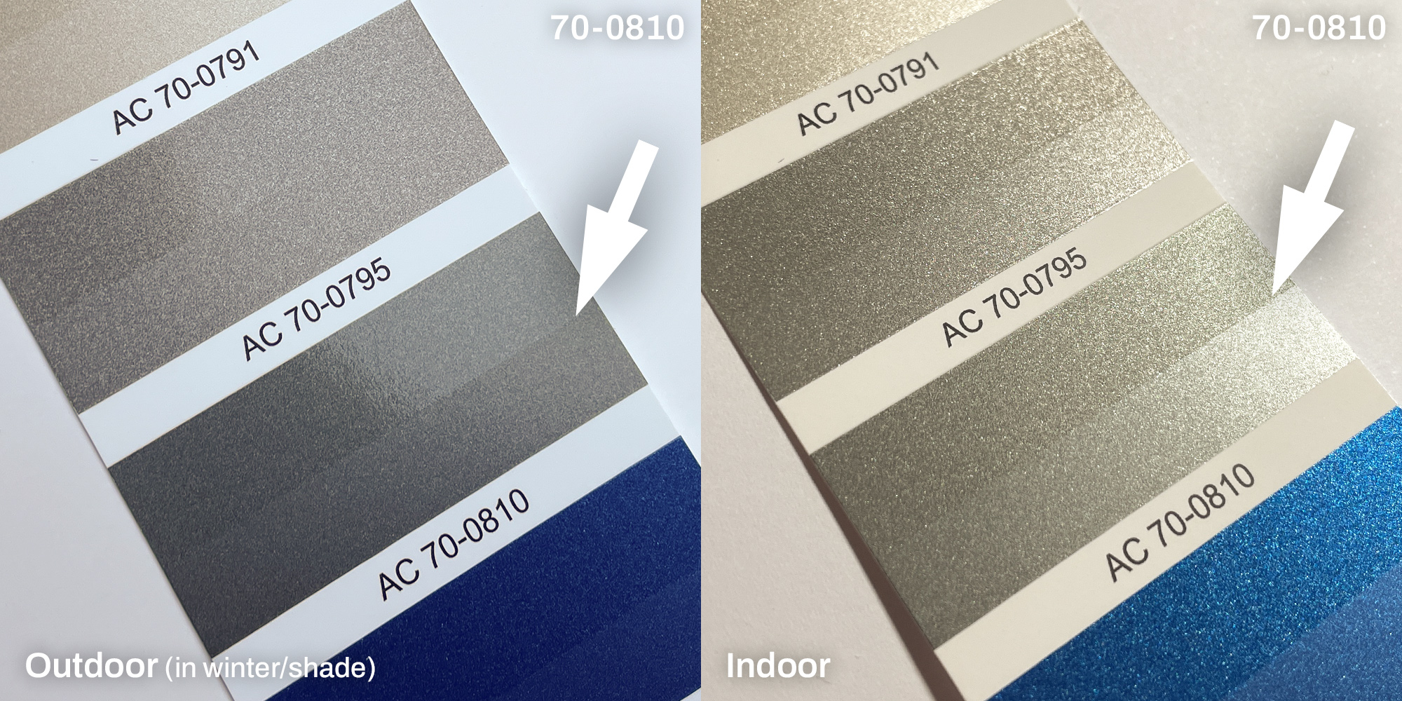

This is what the Auto Color example of ID 70-0810 looks like (top with clear coat, bottom without):

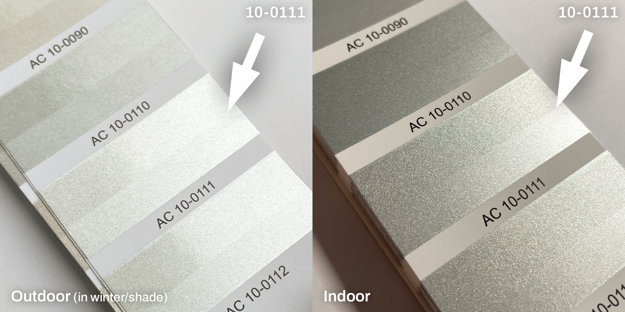

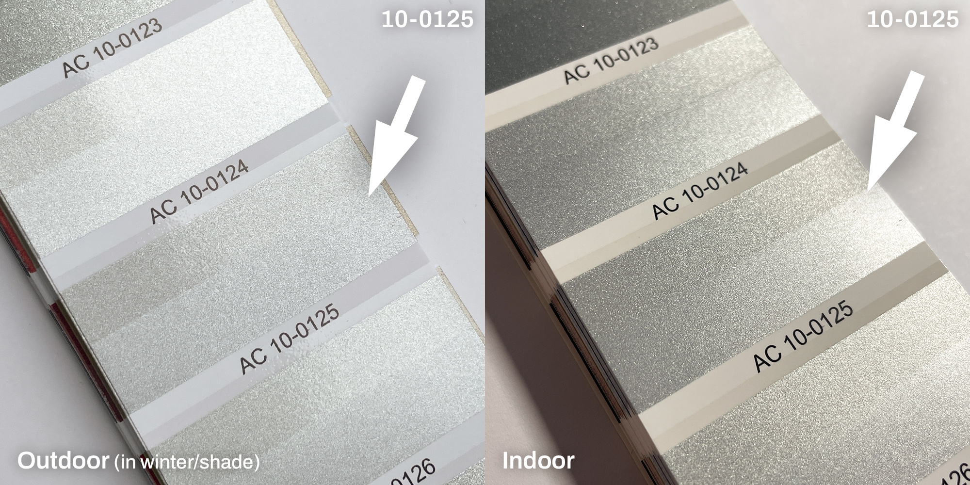

Interestingly, some Auto-Color IDs overlap here, there are 6 spray colors for the 8 “GM 15” types. This is what the Auto Color examples in the color fan look like:

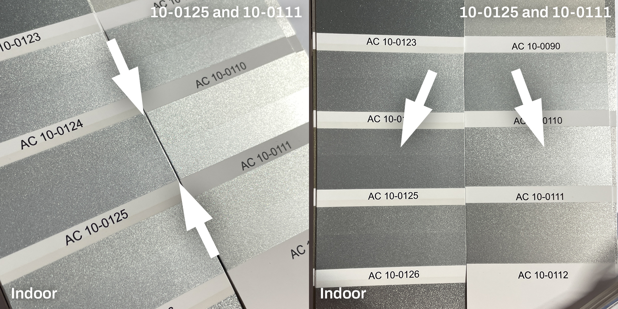

10-0111 and 10-0125 are both very light silver tones and look very similar, so I photographed them side by side. 10-0125 is a little darker and bluer:

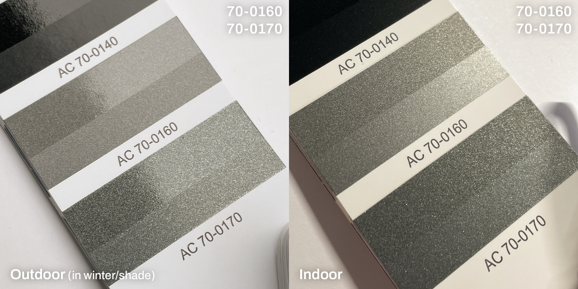

70-0160 is a bit warmer/brownish, while 70-0170 seems to be more neutral/bluish:

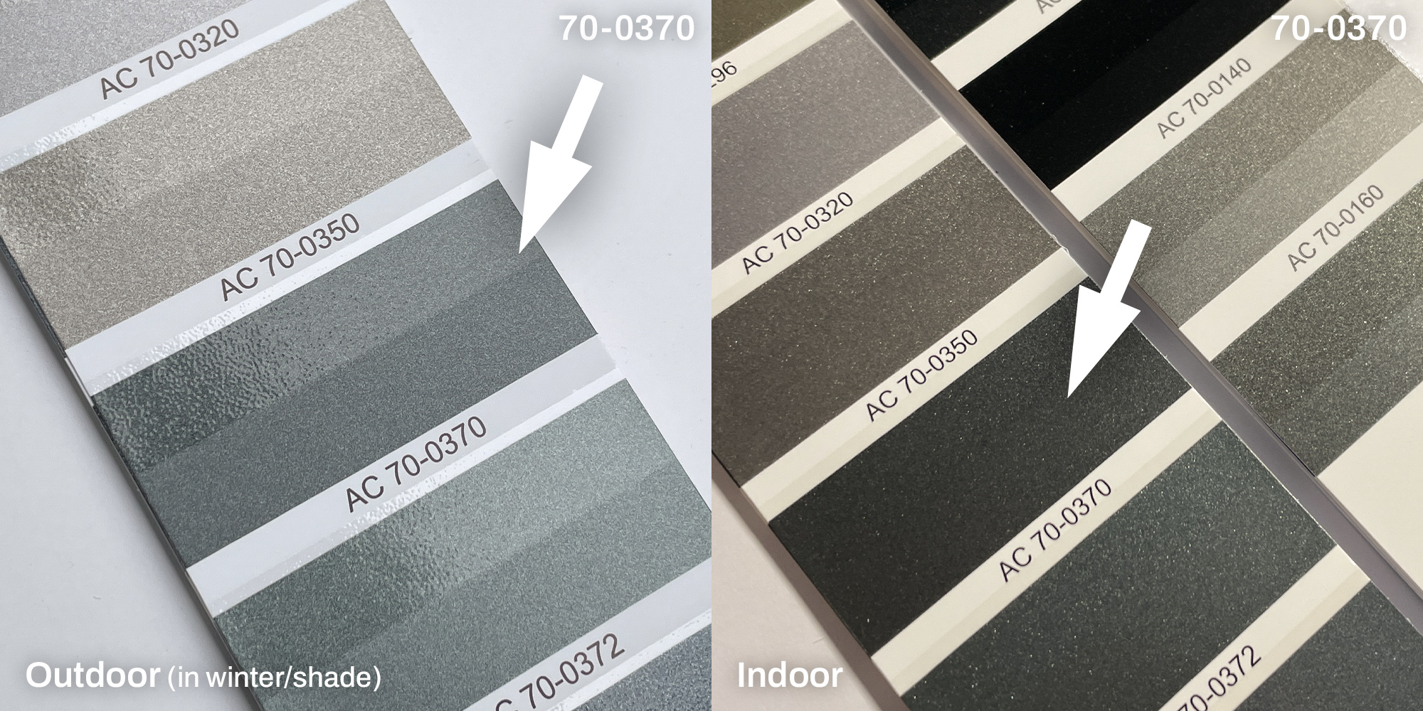

And 70-0370 is also bluish but much darker:
Of course, these pictures were taken in different lighting conditions and do not reflect the color you see in reality. But one can get a first impression. Unfortunately, I don't have a sample of the original 7173 (or the darker 7179) to compare it directly to the color fan.
I would exclude the first two colors (10-0111 and 10-0125), as well as the last one (70-0370), because they are too light or too dark.

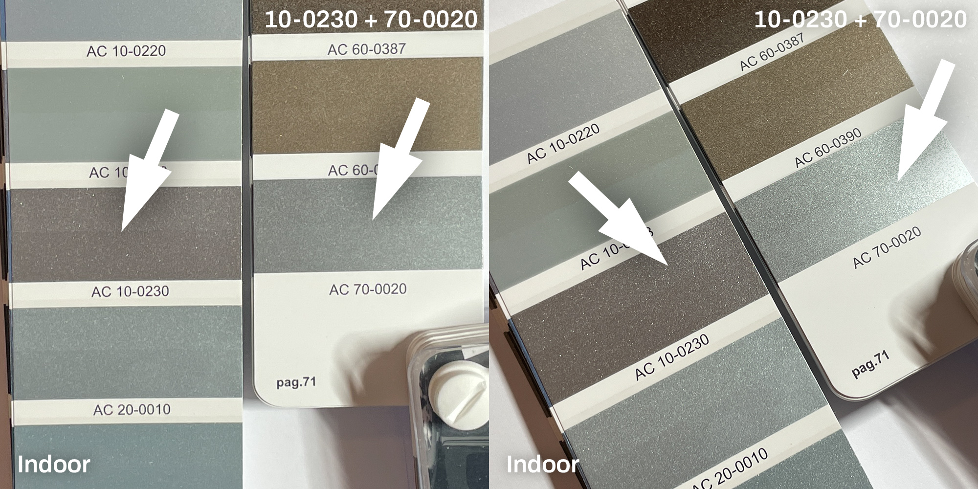

The Auto-Color ID 10-0230 is also listed as replacement spray paint for these GM models (might be helpful when looking for alternatives with other spray paint brands):

Thank you for the sample, AnubisGuard!

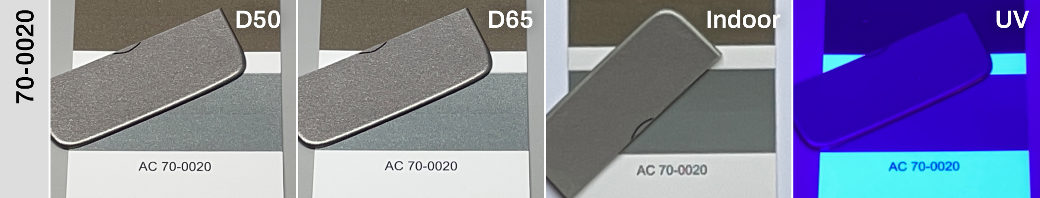

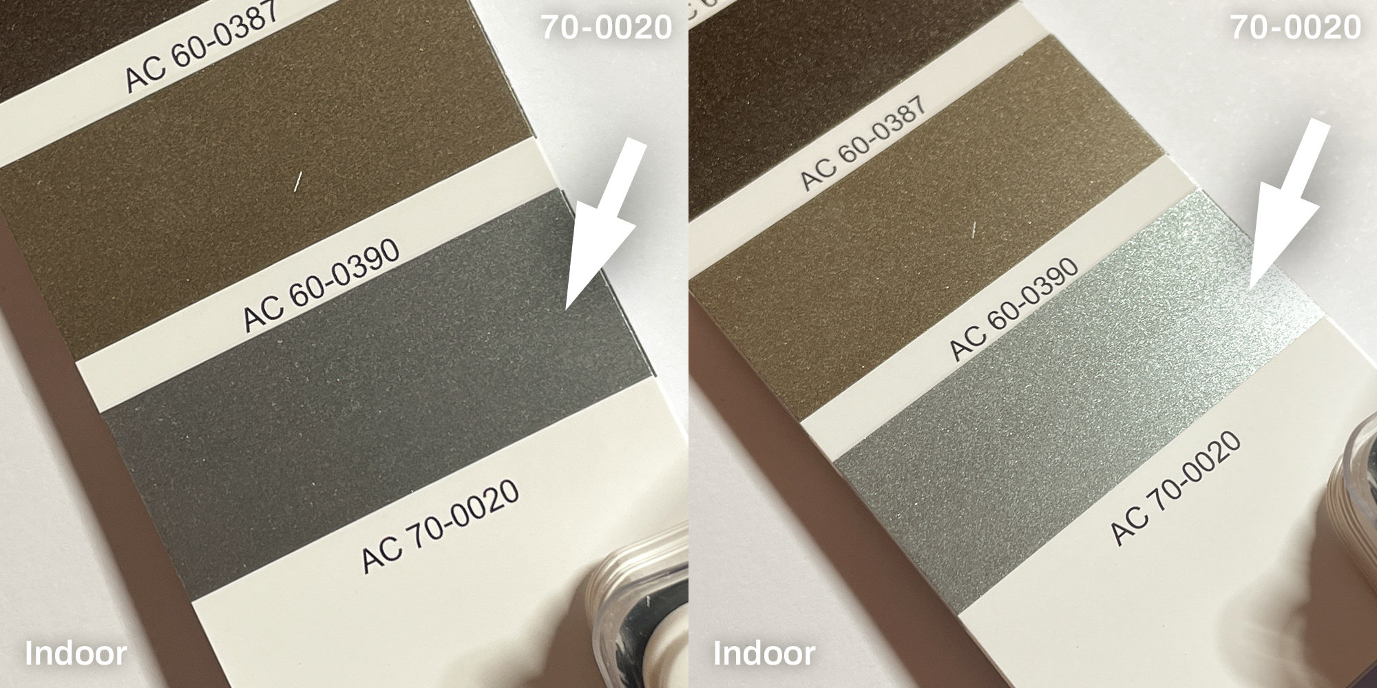

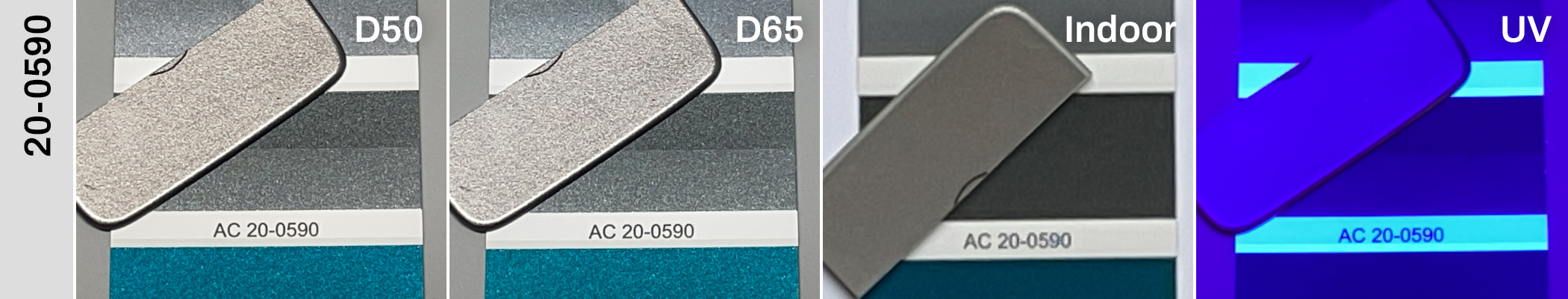

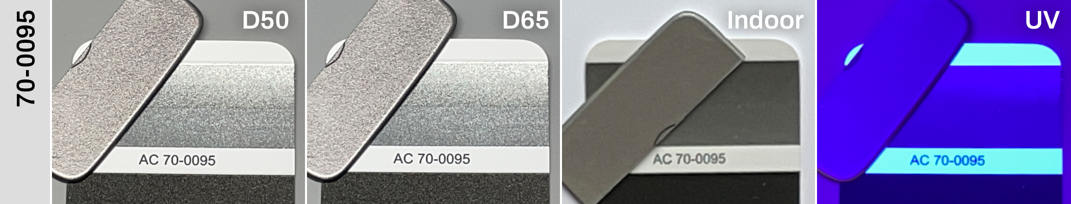

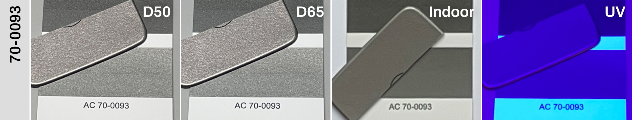

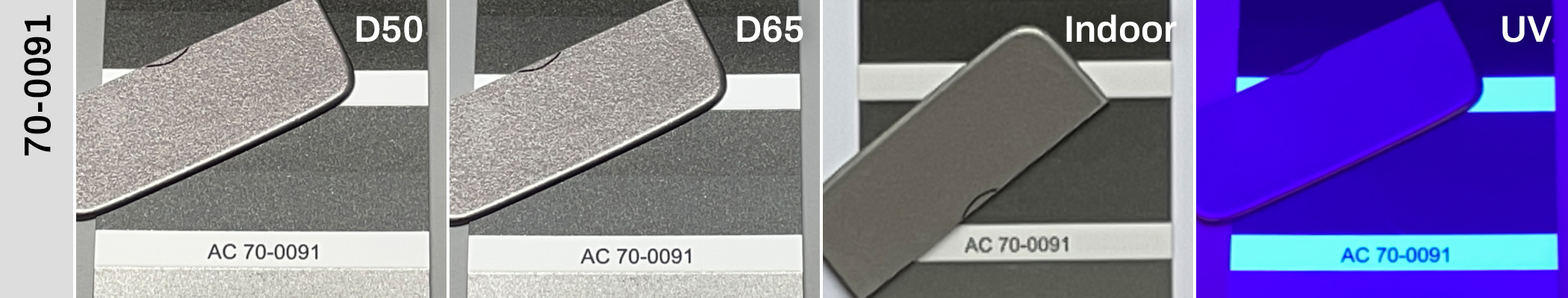

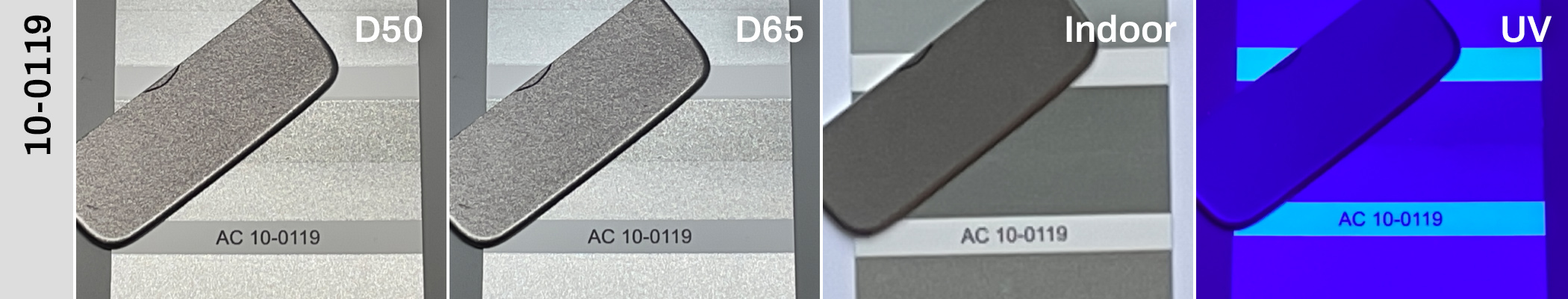

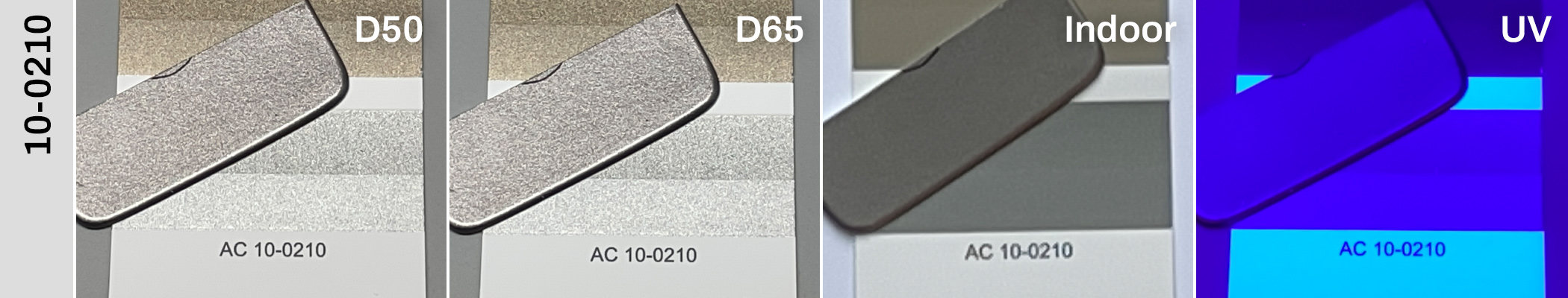

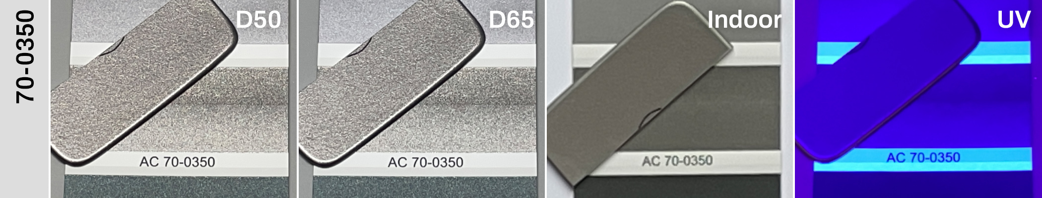

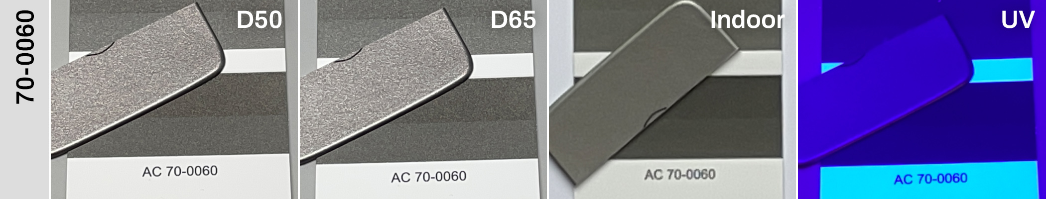

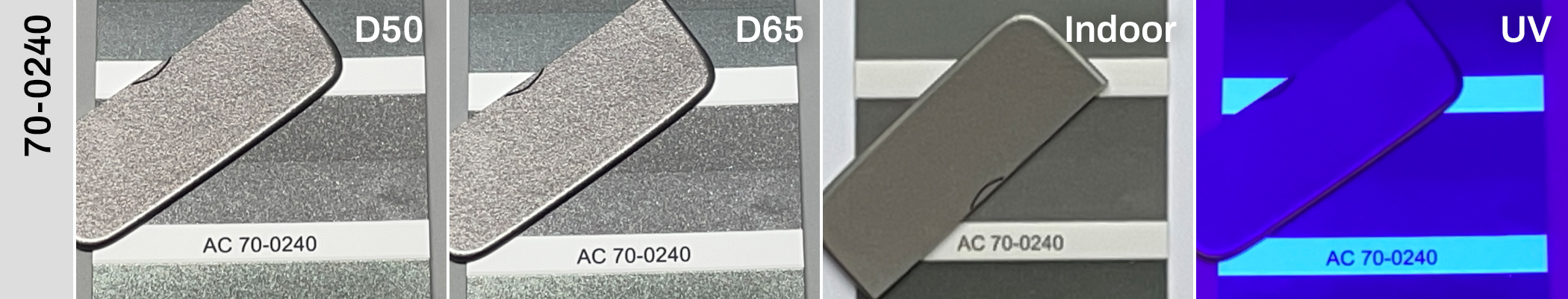

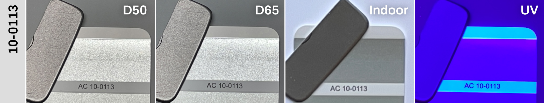

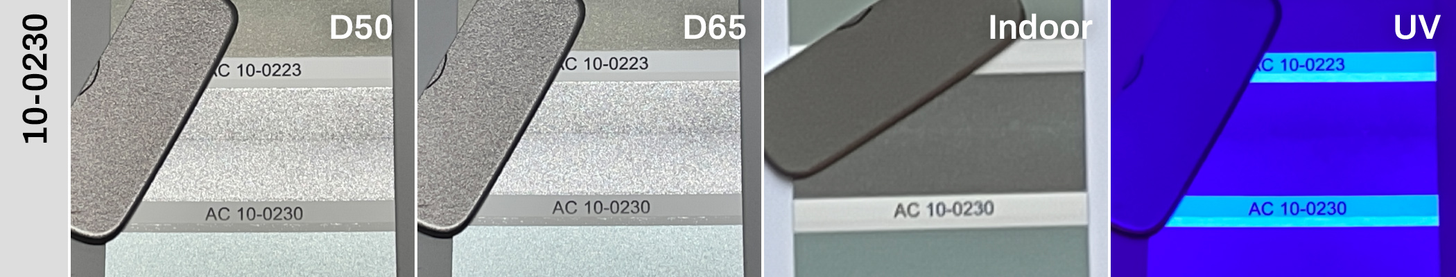

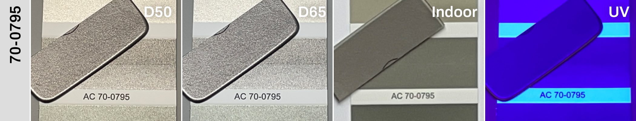

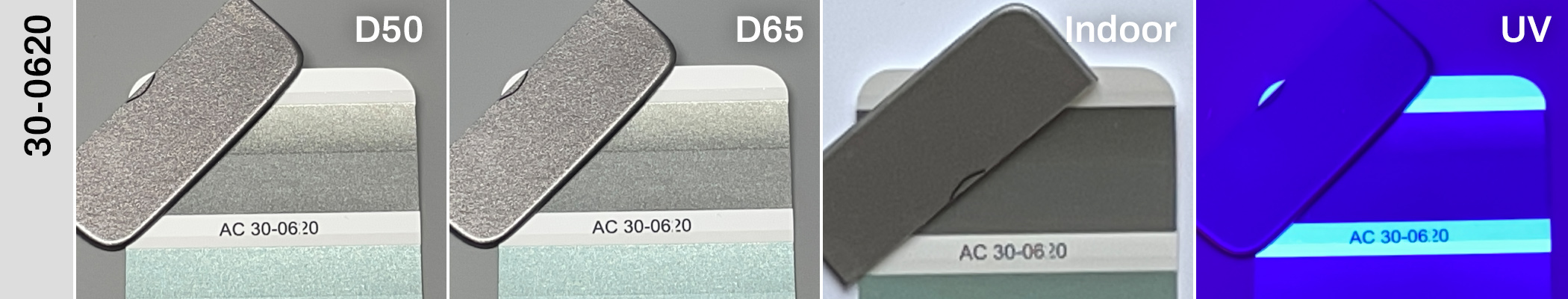

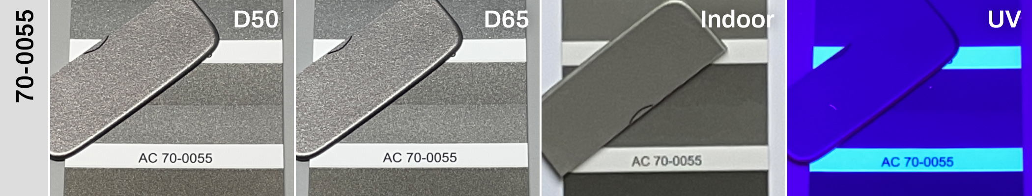

Unfortunately, the dreary winter weather still makes it a bit difficult to compare colors outdoors. BUT I got access to a light box with standardised D50 and D65 lights (and even UV light). I took the chance to compare the 7173 sample with the Dupli-Color (EU) Auto Color chips.
First of all, the colors I thought could hit Plasti-Kote GM7173 were often way off. 7173 is darker and with a more redish tone than I had expected.

  • 70-0810: too bluish
  • 10-0111: way too light (and just silver, no redish tint)
  • 10-0125: way too light (and just silver, no redish tint)
  • 70-0160: too dark and bluish
  • 70-0170: also too dark and bluish

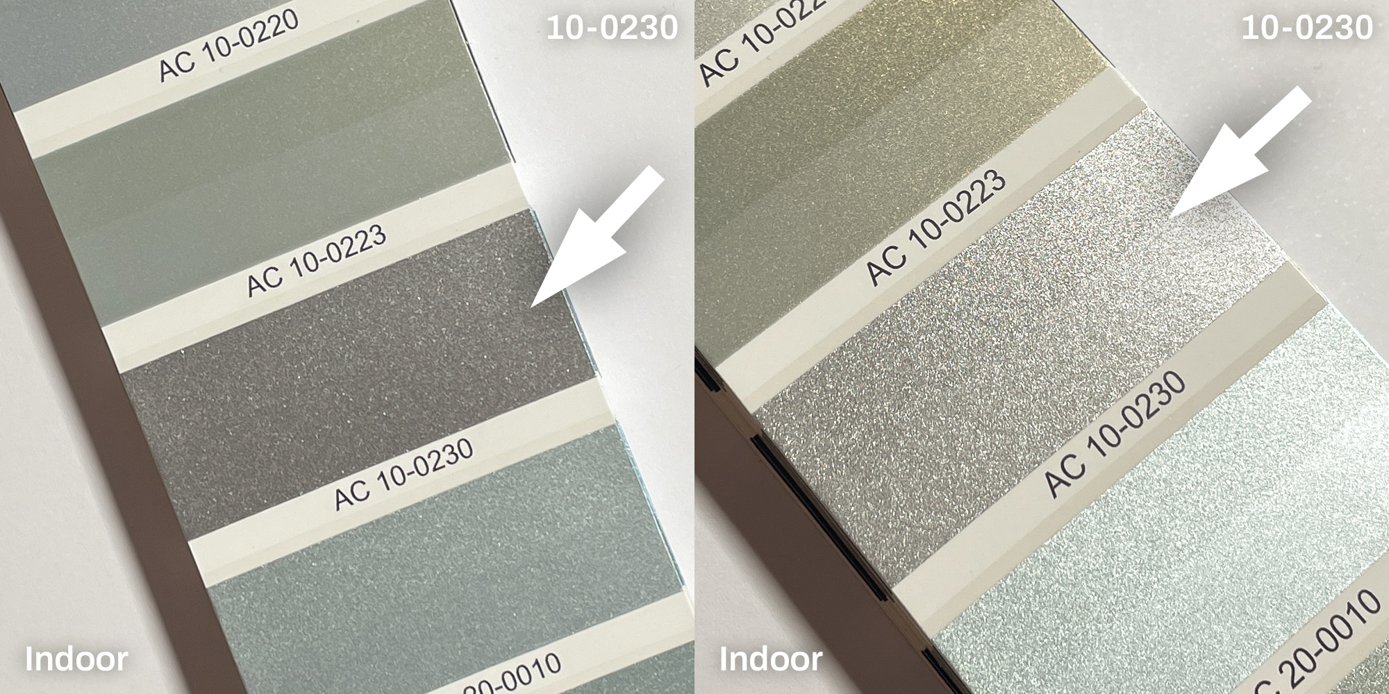

10-0230: too light and no redish tint
70-0020: too light and bluish/greenish
There is a whole range of colors that look similar at first quick glance in certain lighting conditions, but from different angles and in different lighting conditions they don't match:
10-0113: too light (and just silver, no redish tint)
10-0119: too light and no redish tint
10-0210: too bluish

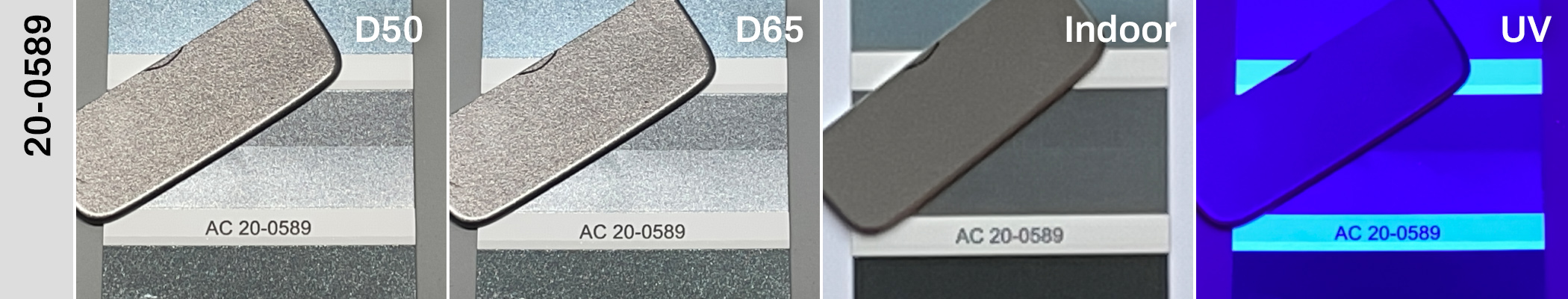

20-0589: too bluish
20-0590: too dark. Perhaps a candidate for a 7179 alternative?
30-0620: too yellowish/greenish (especially with clear coat)

70-0060: too dark
70-0091: too dark and bluish
70-0093: too light and yellowish
70-0095: close, but a little bit too bluish
70-0240: also close, but a little bit too bluish
70-0795: too light

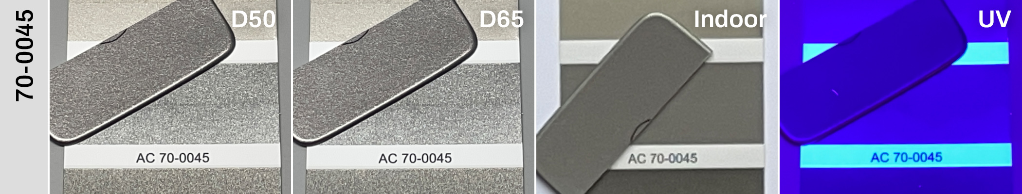

And these are my favorites (as of now):​
70-0045: close, but a little bit too light and a little bit of the redish is missing

70-0055: also close, but a bit too dark and not enough redish tint
Article no for the 400ml can is 535468 (Dupli Color EU)

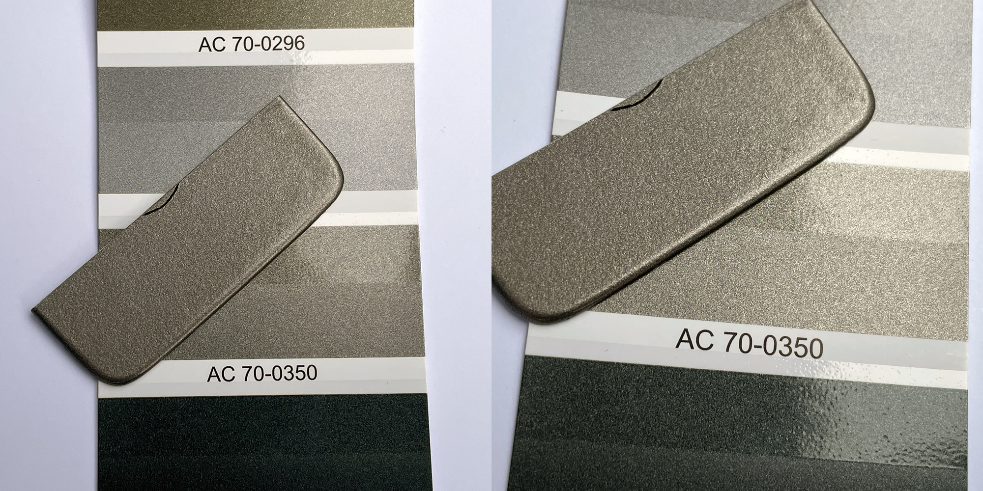

70-0350: Very close, just a little tiny bit too dark. But the reddish tint seems to be correct.
Article no for the 400ml can is 576911 (Dupli Color EU)
70-0350 is really close... outdoor test (winter, cloudy, in shadow):
I'll wait for better weather in the spring/summer to test these colors in better outdoor light.
