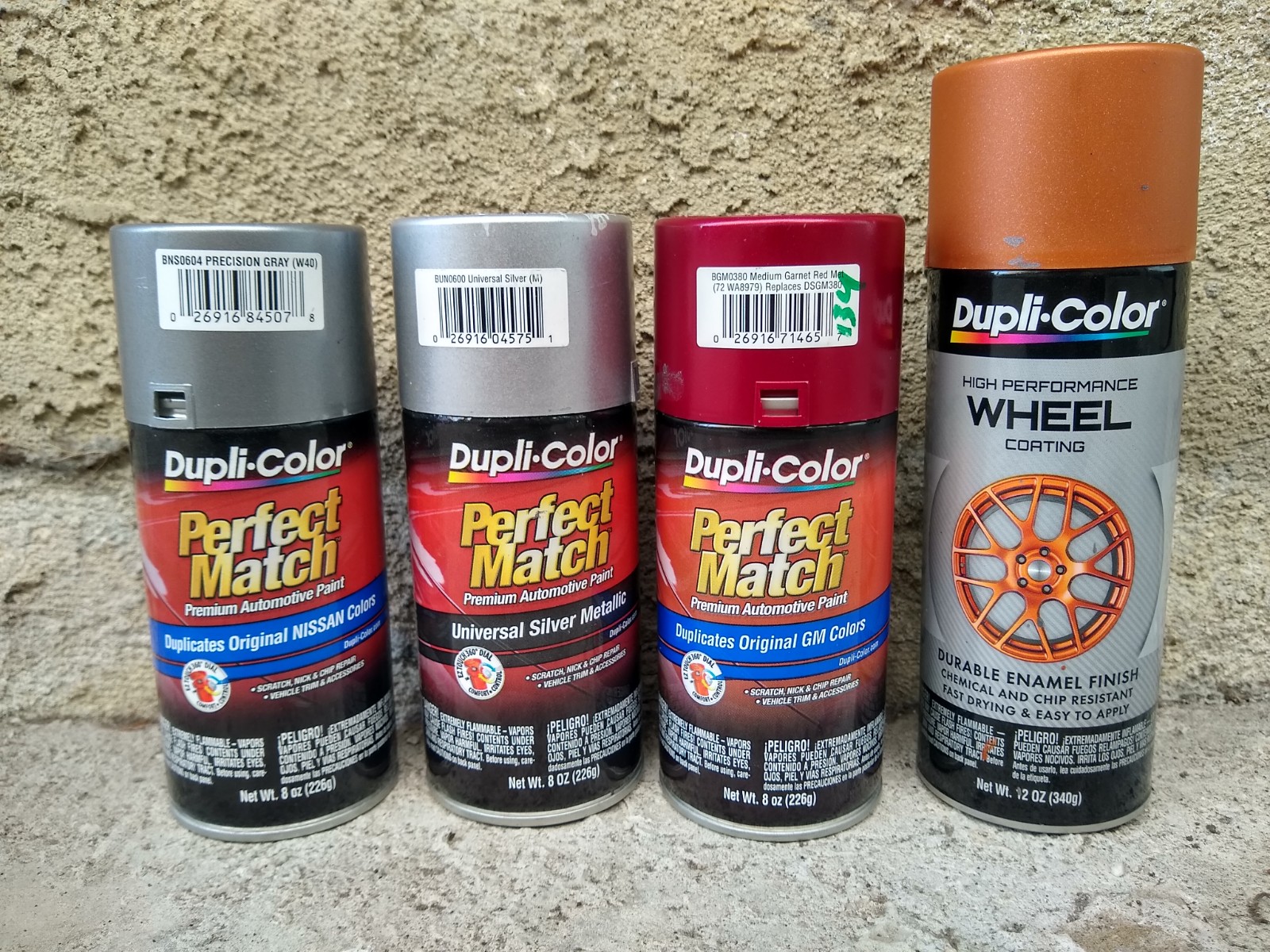

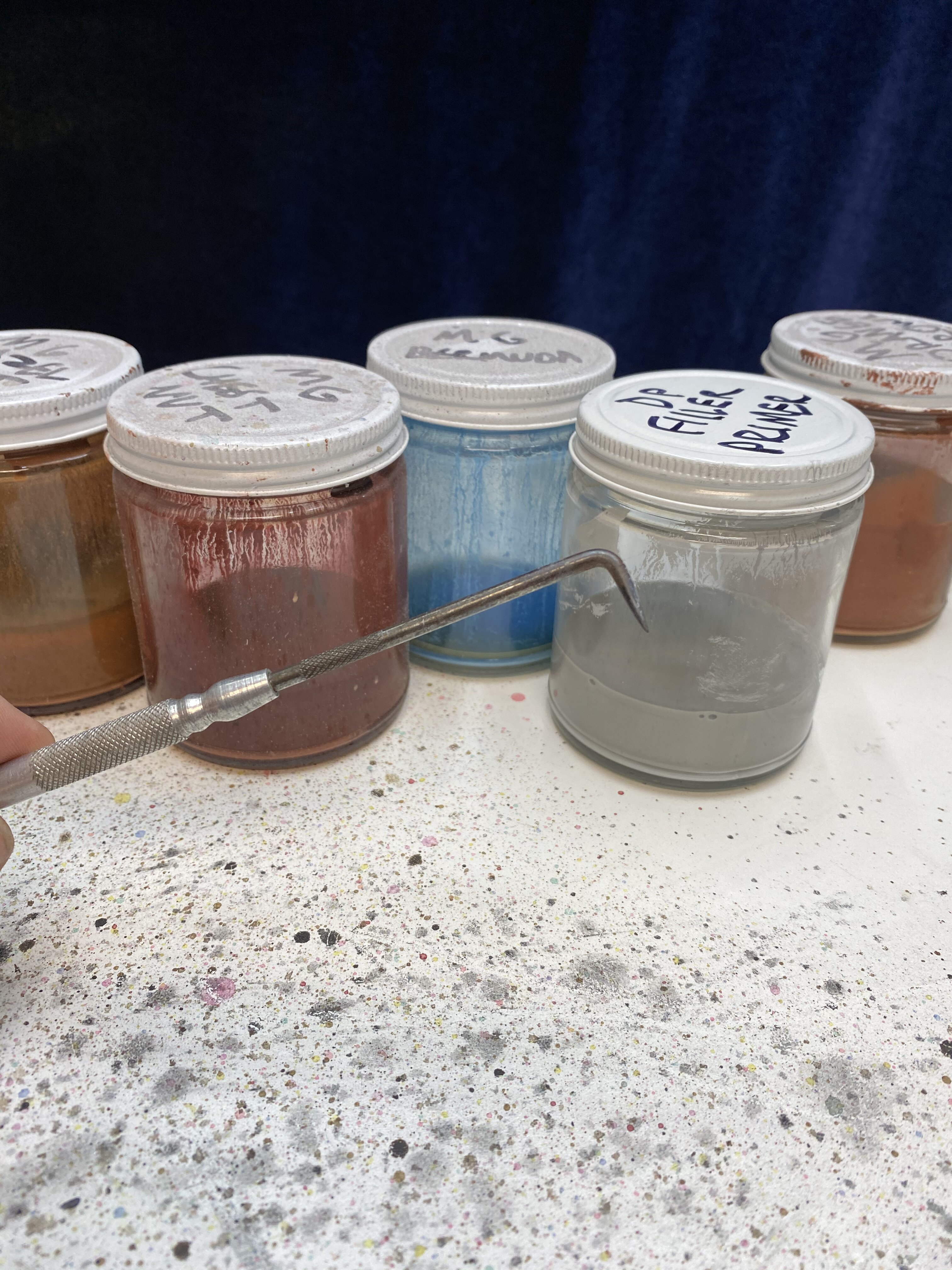

After a lot of trial and error, I settled on Precision Gray, Universal Silver, Med. Garnet Red, and Copper Wheel Coating as the base colors.

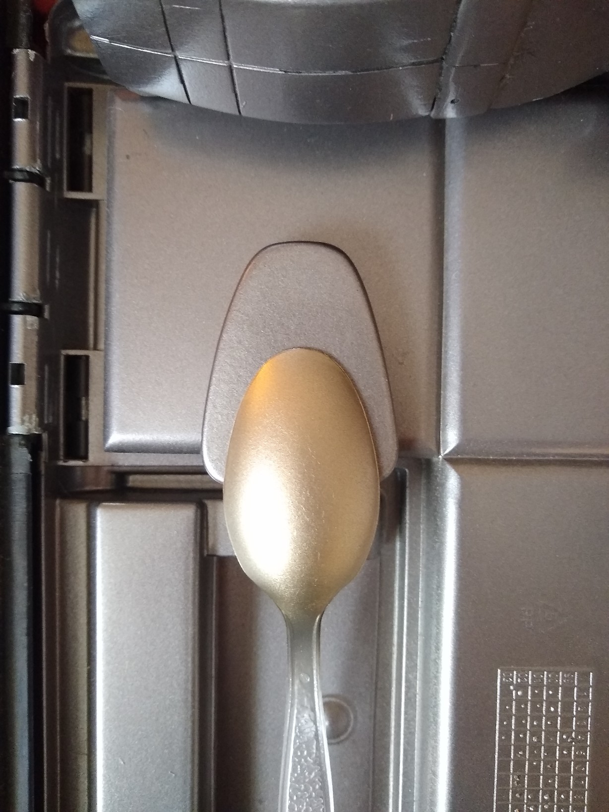

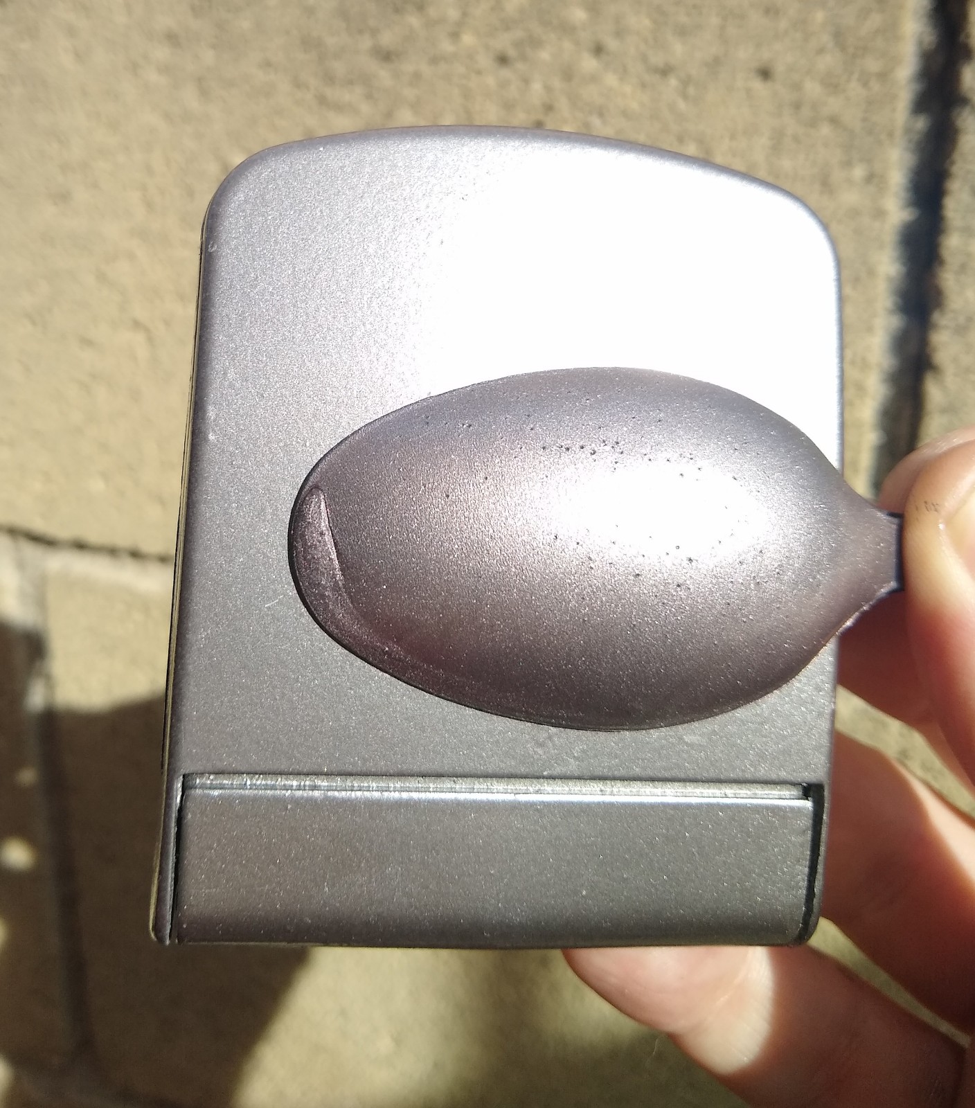

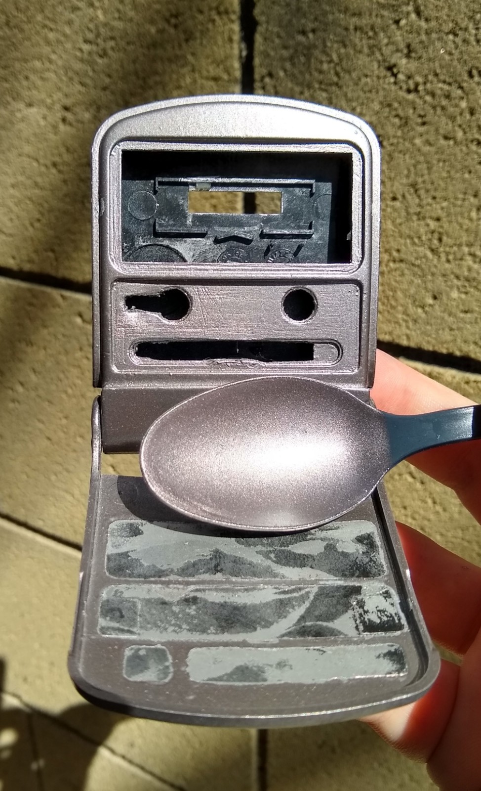

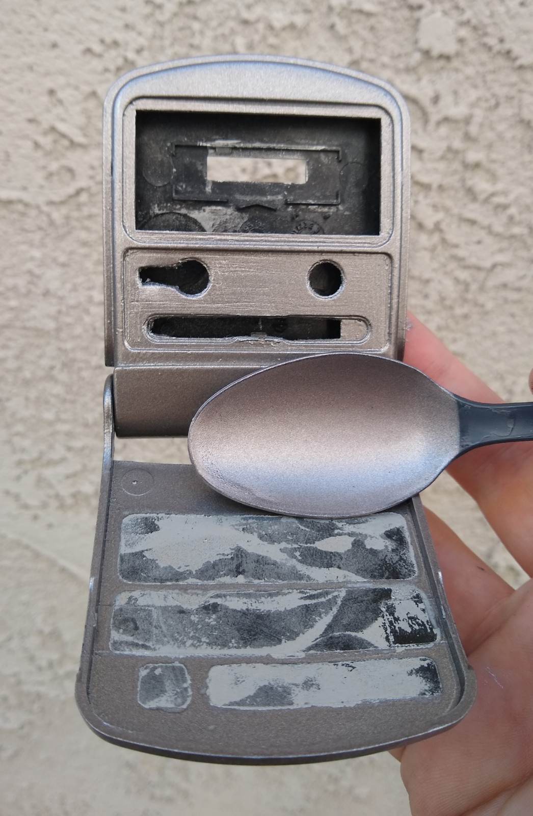

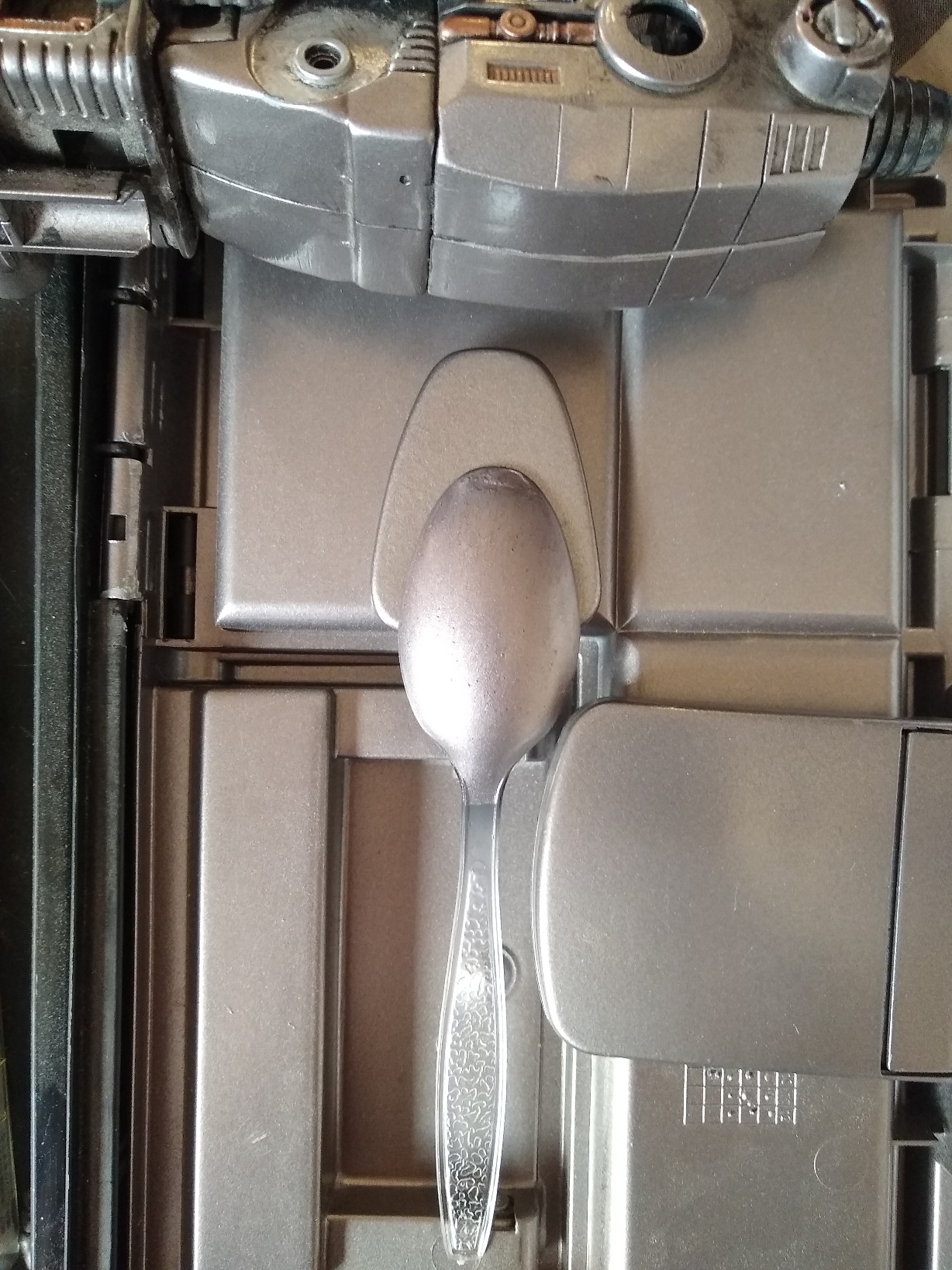

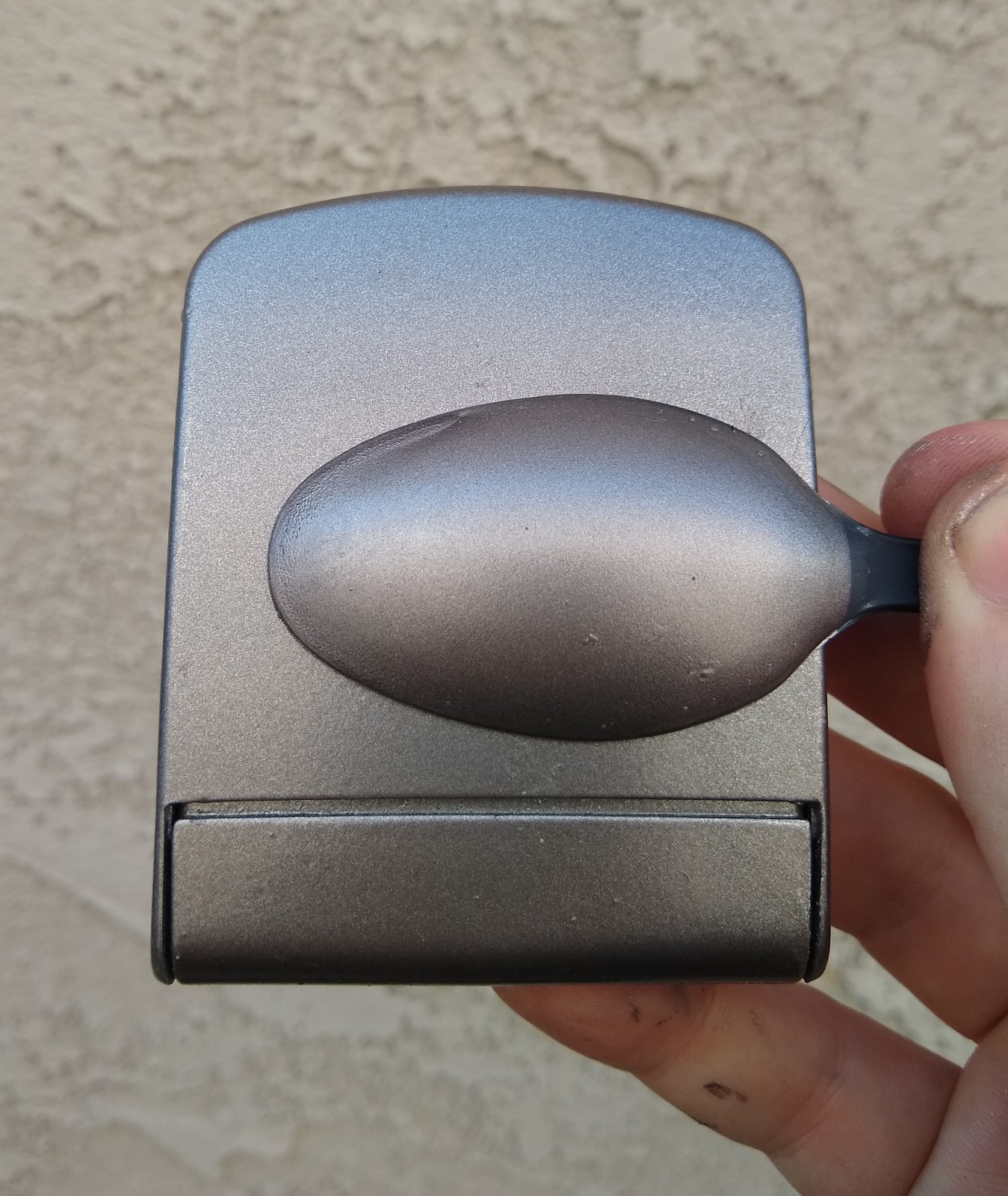

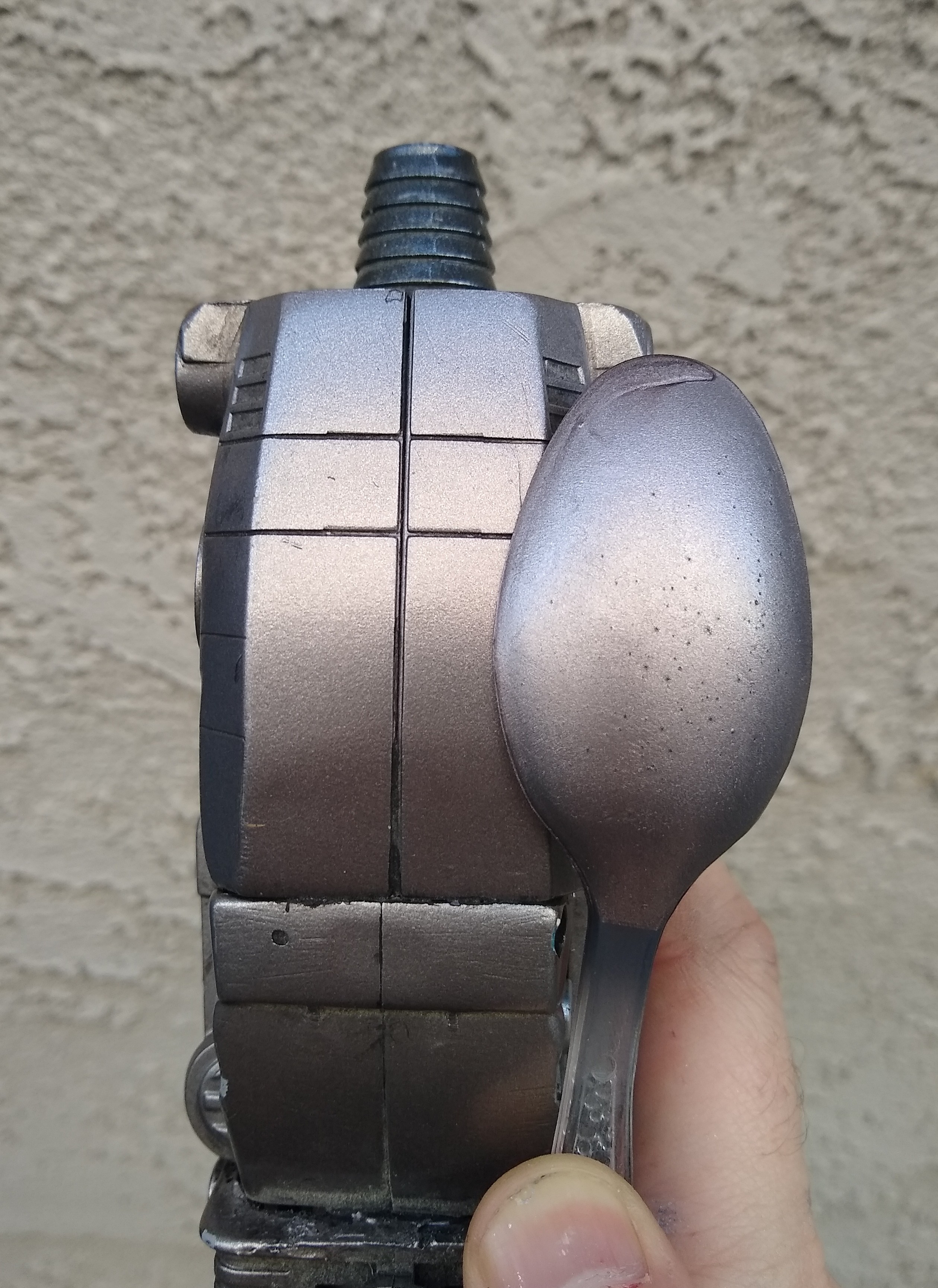

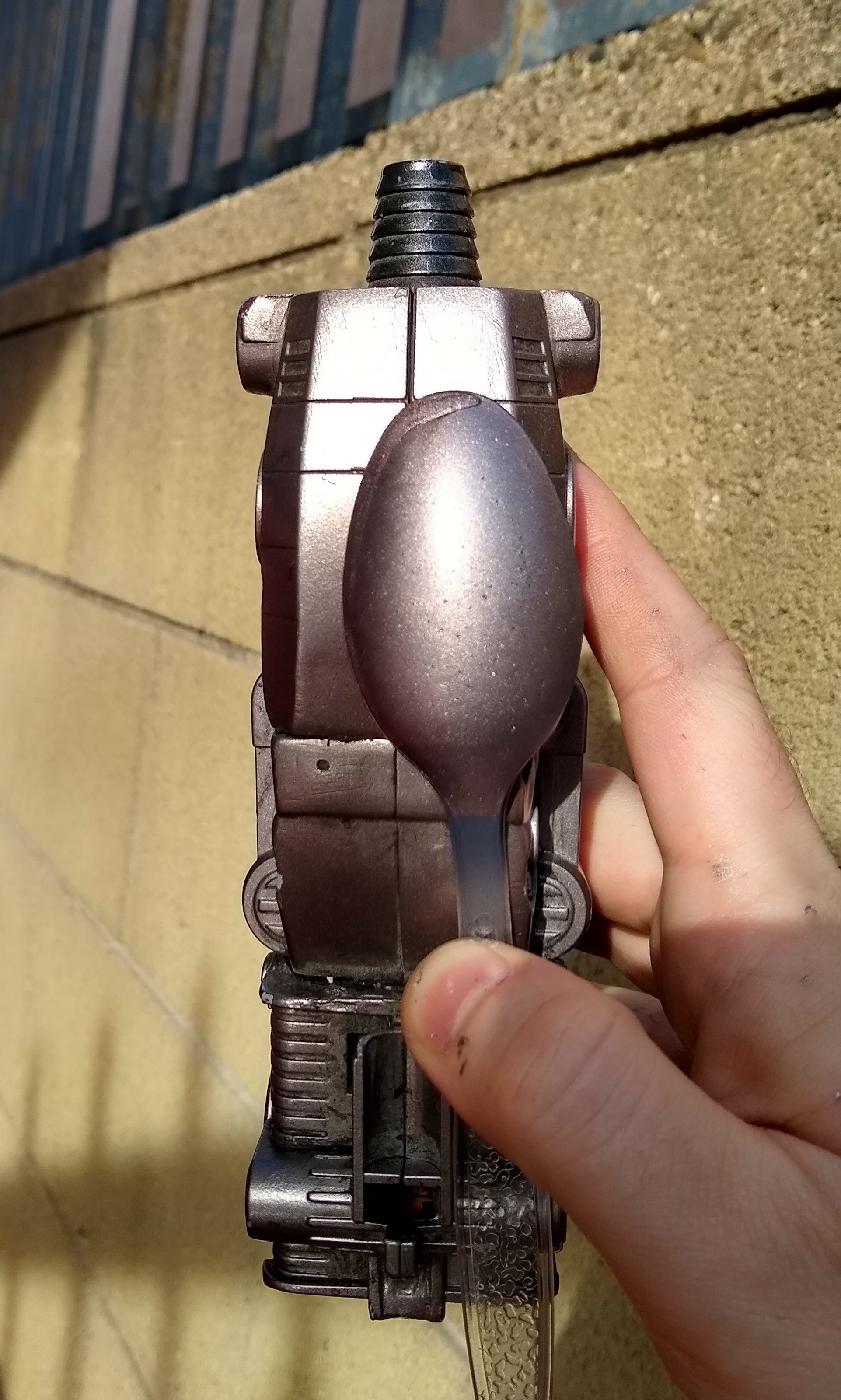

I sprayed each of them into a jar, keeping count of the number of seconds I sprayed each. A few dip tests later and see what you think (the dark specks are bubbles from dipping the spoons).
Against a 7173 sample circa 2002:
Against a 7173 sample from a year or two later:
The final ratio, adjusted a bit for wastage, is:
Precision Gray: 56 to 57 parts
Universal Silver: 23 to 24 parts
Copper: 10 to 11 parts
Med. Garnet Red: 1 part
