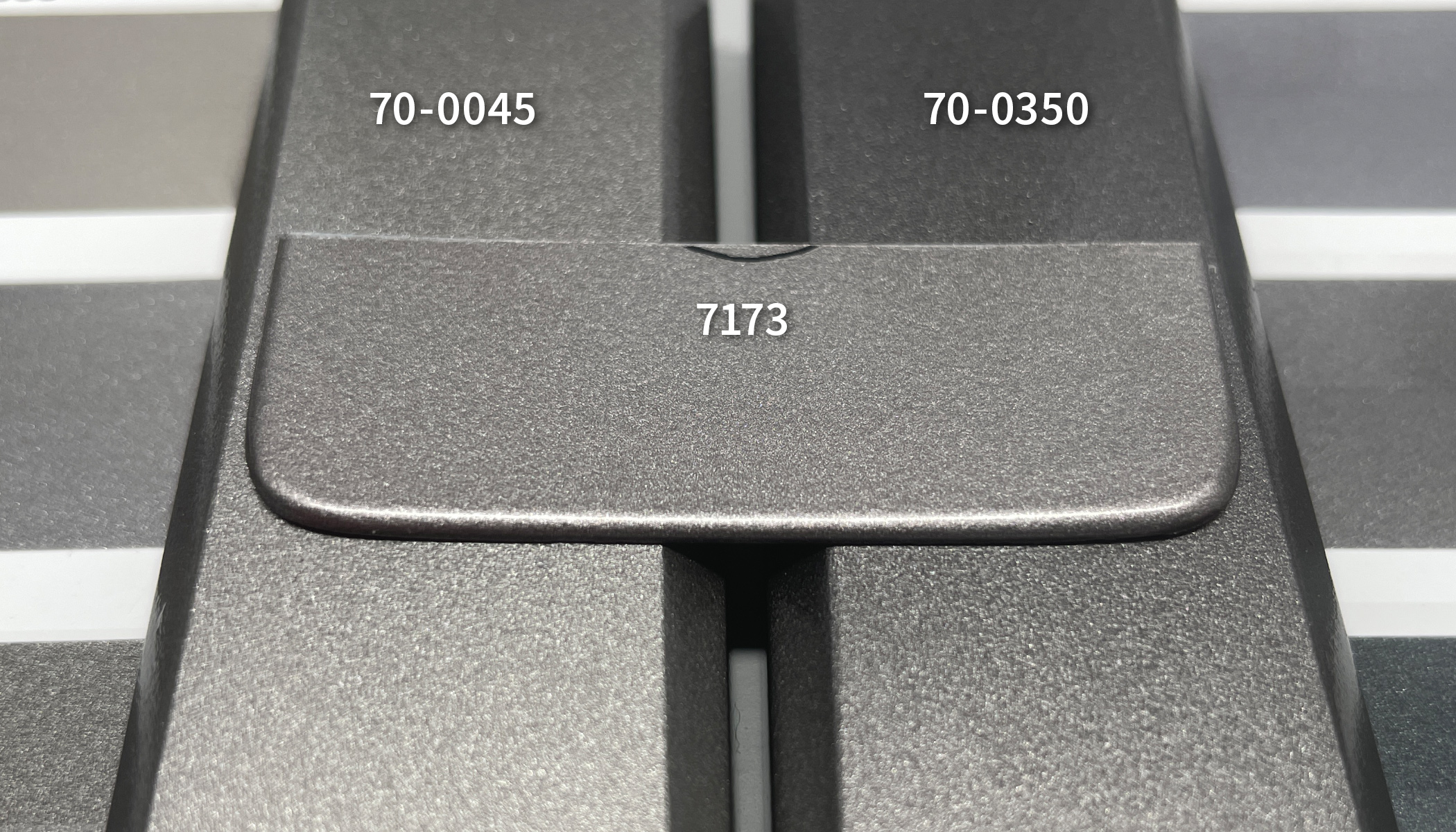

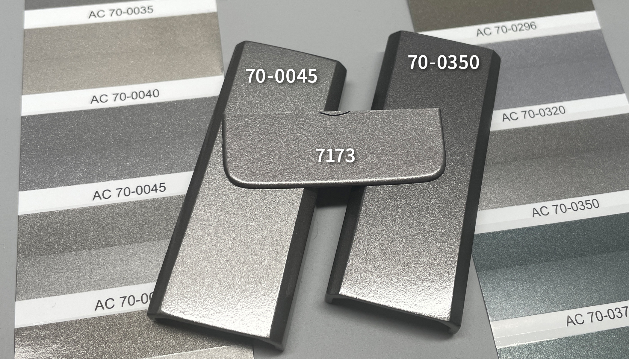

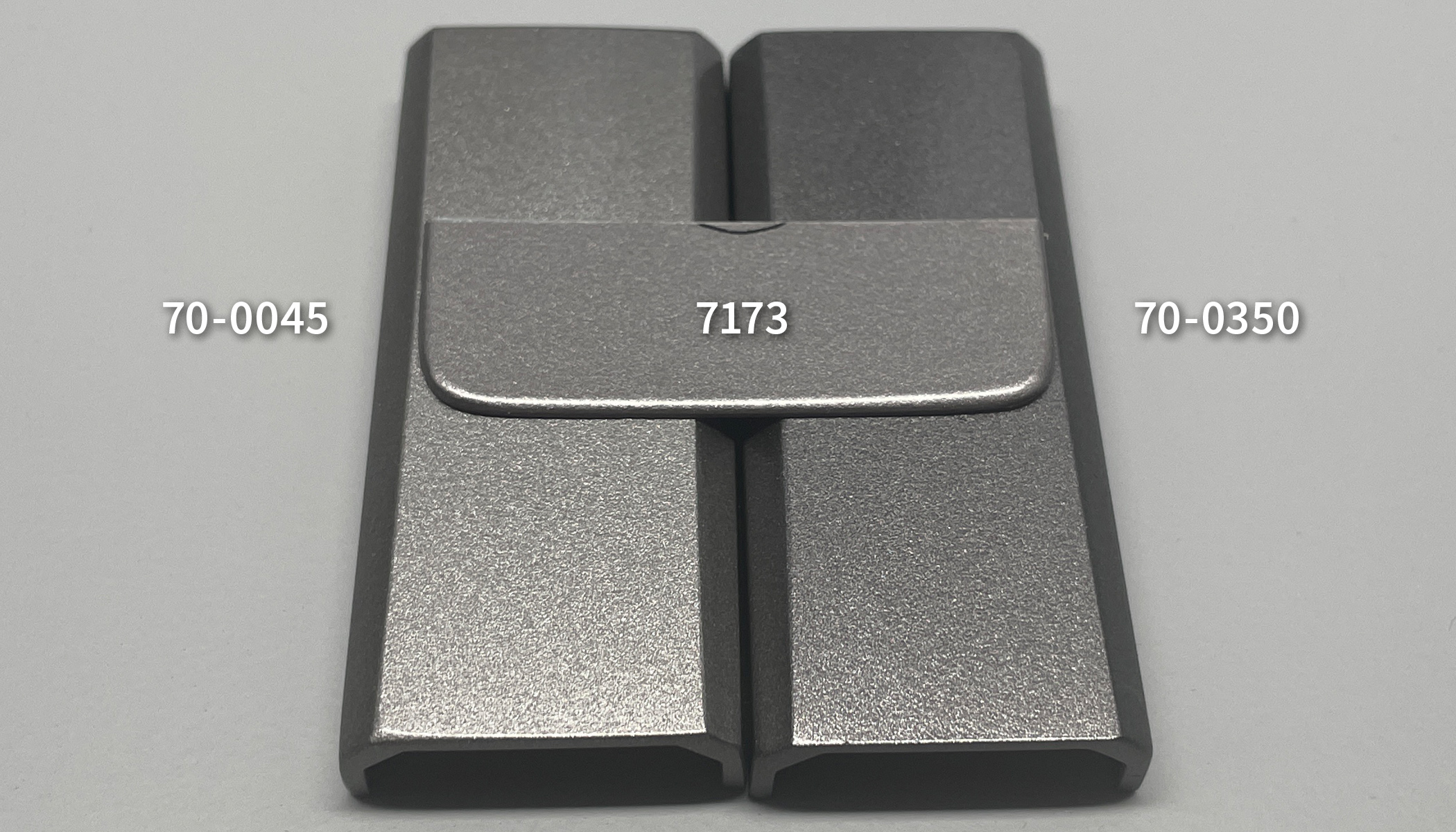

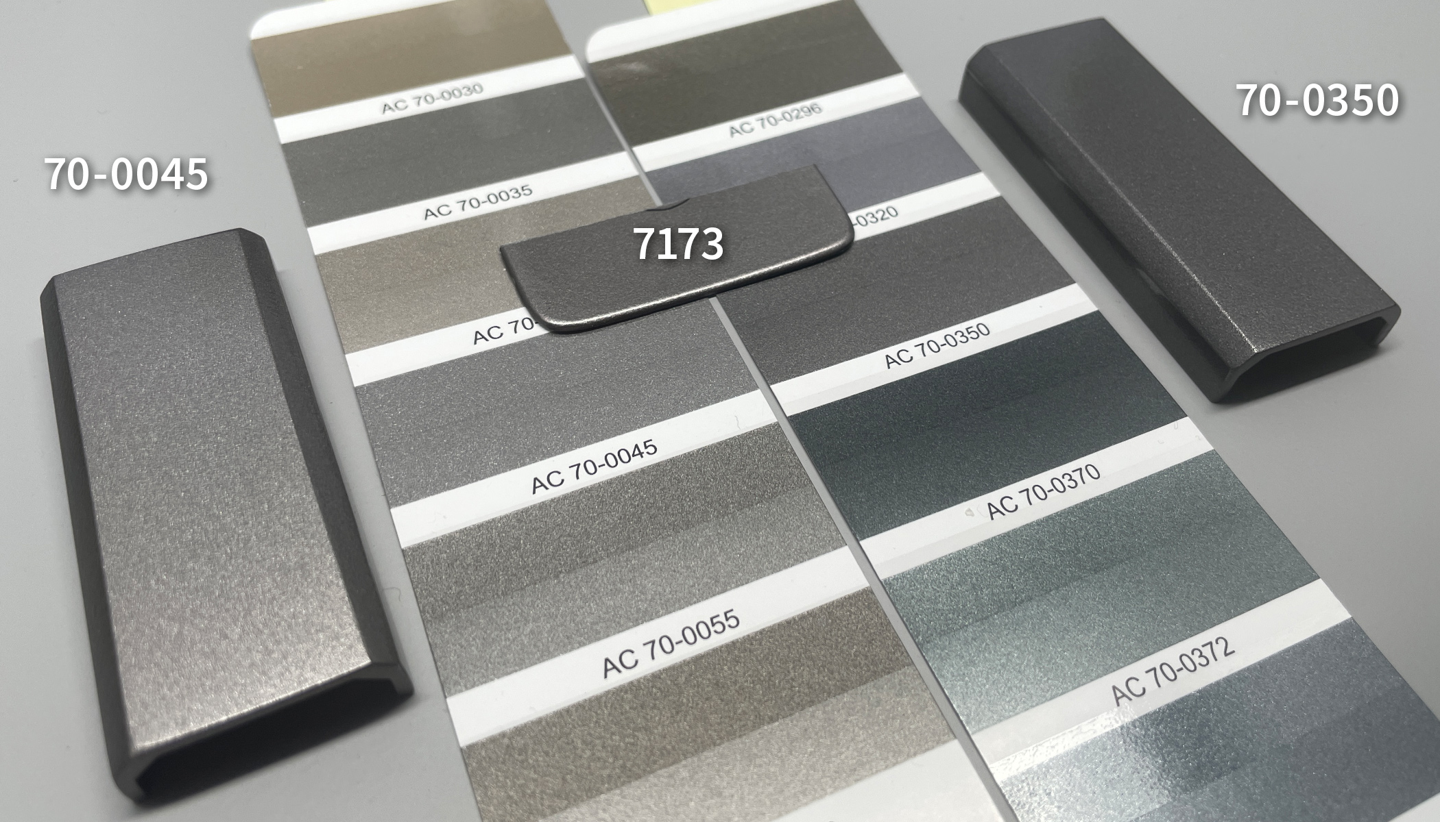

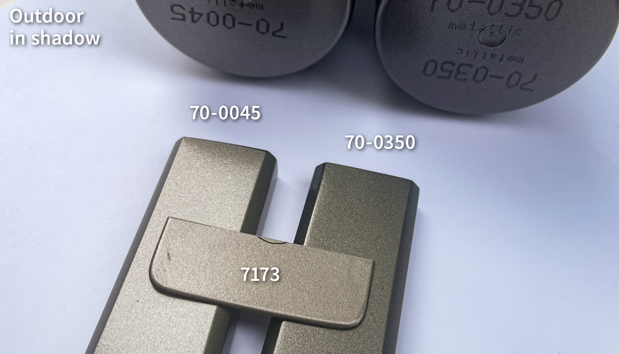

I finally had the time to do a test with the real spray paints by spraying two side panels of a hypospray and compare it to the 7173 sample.
DupliColor AutoColor 70-0045 is a pretty good match!
Note: This is a color code of the "DupliColor" EU brand by European Aerosols, not the "DupliColor" US brand by Sherwin-Williams Company.

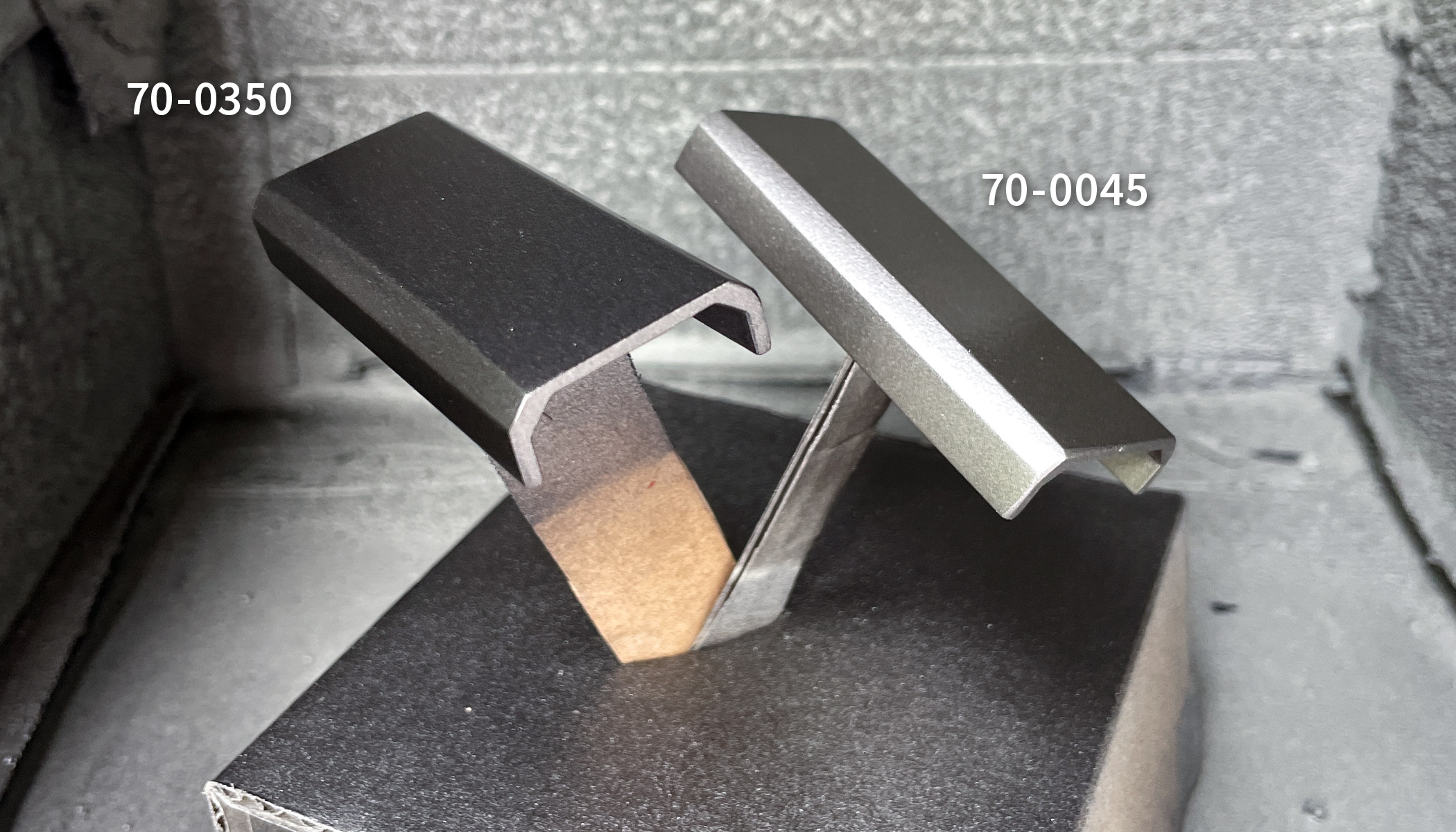

I previously thought 70-0350 would be a better match, but IMHO it is too dark:
It lacks a bit of the reddish tint, but overall I think 70-0045 is a good match for people who have access to this spray paint (in the EU).
