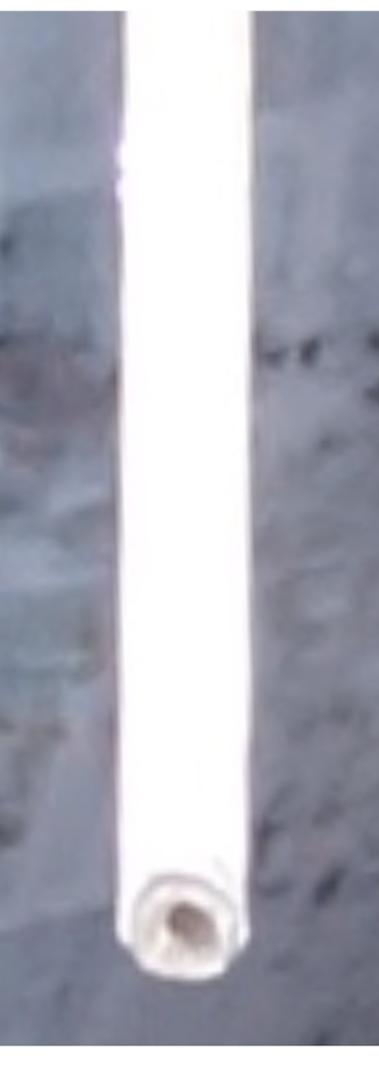

Thanks, that helps my confidence lol I'm thinking of this picture, which I'm interpreting as a few layers of scotchlite, wrapped like a giftwrap tube.

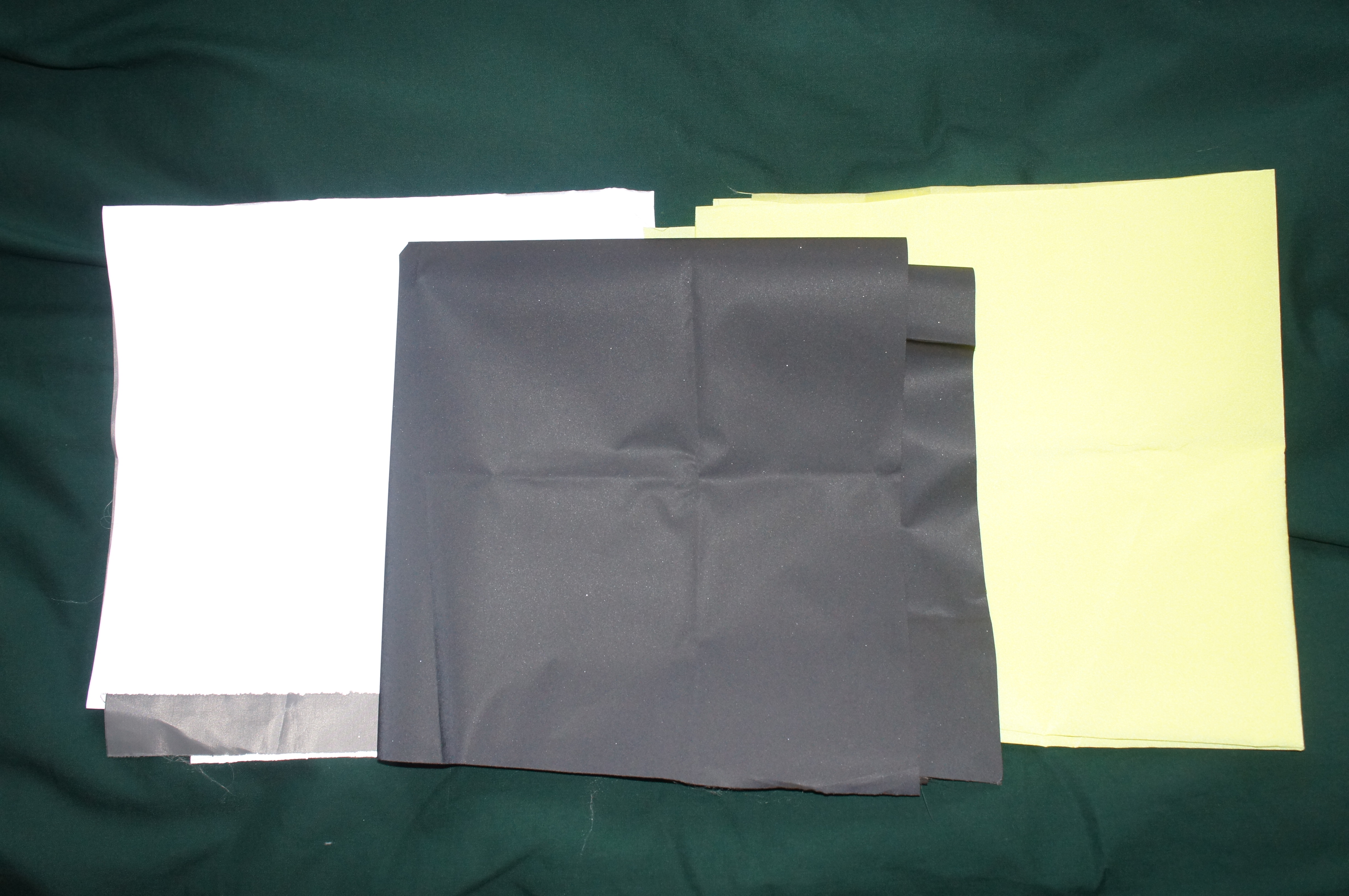

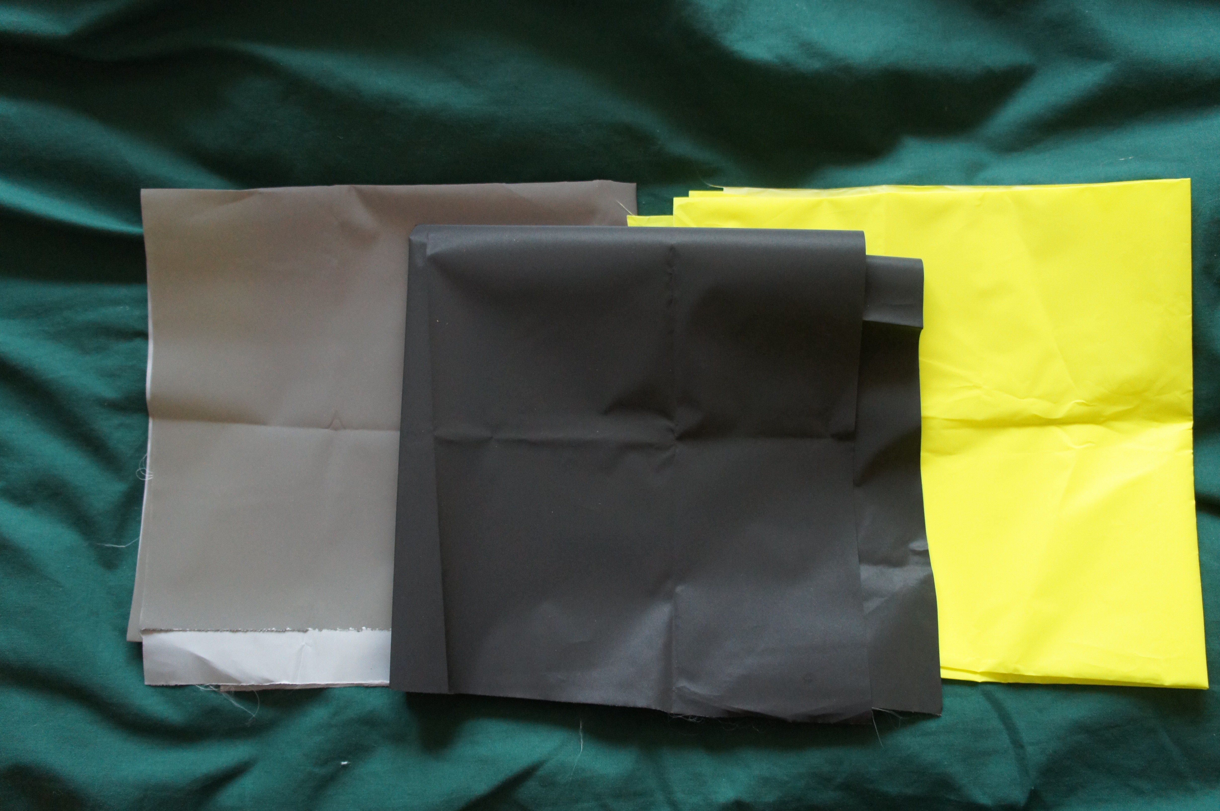

As we're doing fabric on this thread, here's some cheapy stuff I got from fleabay.
& with flash.
The silver is really good, much better than the tape I've got, the yellow is OK about the same as the tape but still looks more like fluorescent yellow to the eye. It's reflecting well in this flash photo. The 'black', in the middle, is just pants. I complained & the vendor is sending me some more silver as a replacement. It's about £3.50 /half meter & 1m wide.
Silver is very nice reflection! I will post a flash test once I receive the scotchlite. What fabric is this?

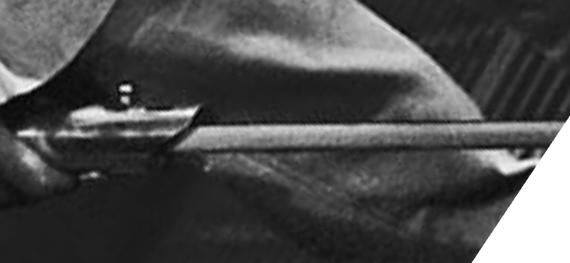

Looks like there might be a hole where the red button went, but also LOOK AT THAT CURVED EMITTER! Looks like the ANH stunt had a cleaner cut emitter than the "tube" stunt used for Jedi and some of ESB
