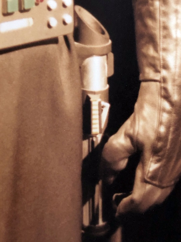

Here is a pic I found from the lightsaber on the Vader display promoting the opening of Planet Hollywood in Cologne, Germany in 1992. The Vader display was made by Don Bies & team.
Sansweet's saber is 100% Bies & Team as well then... whoa

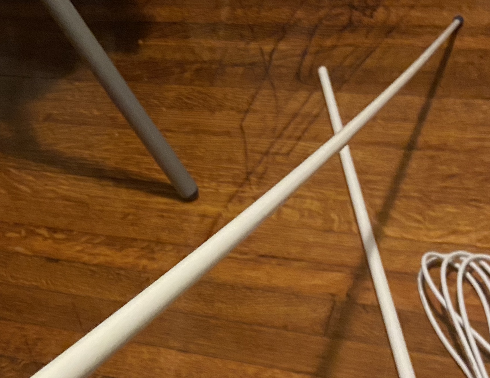

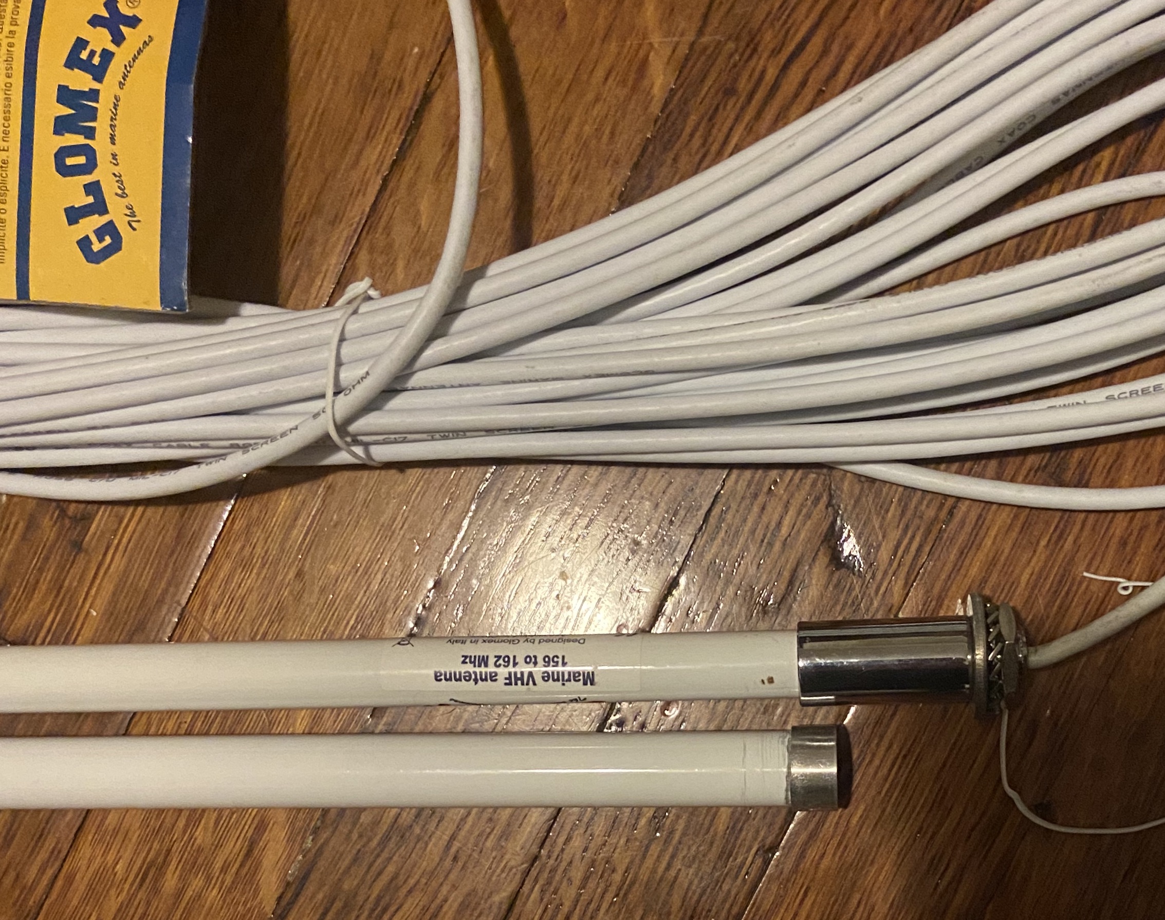

This is a Glomex 5' antenna, compared to the Denmark AC Antennas CX-4 AIS. The REGULAR sized Glomex Halliwax has is the right size. My OBNOXIOUSLY LONG antenna is only just under 16 mm at base. The taper looks excellent though. Also, much more flexible fiberglass!

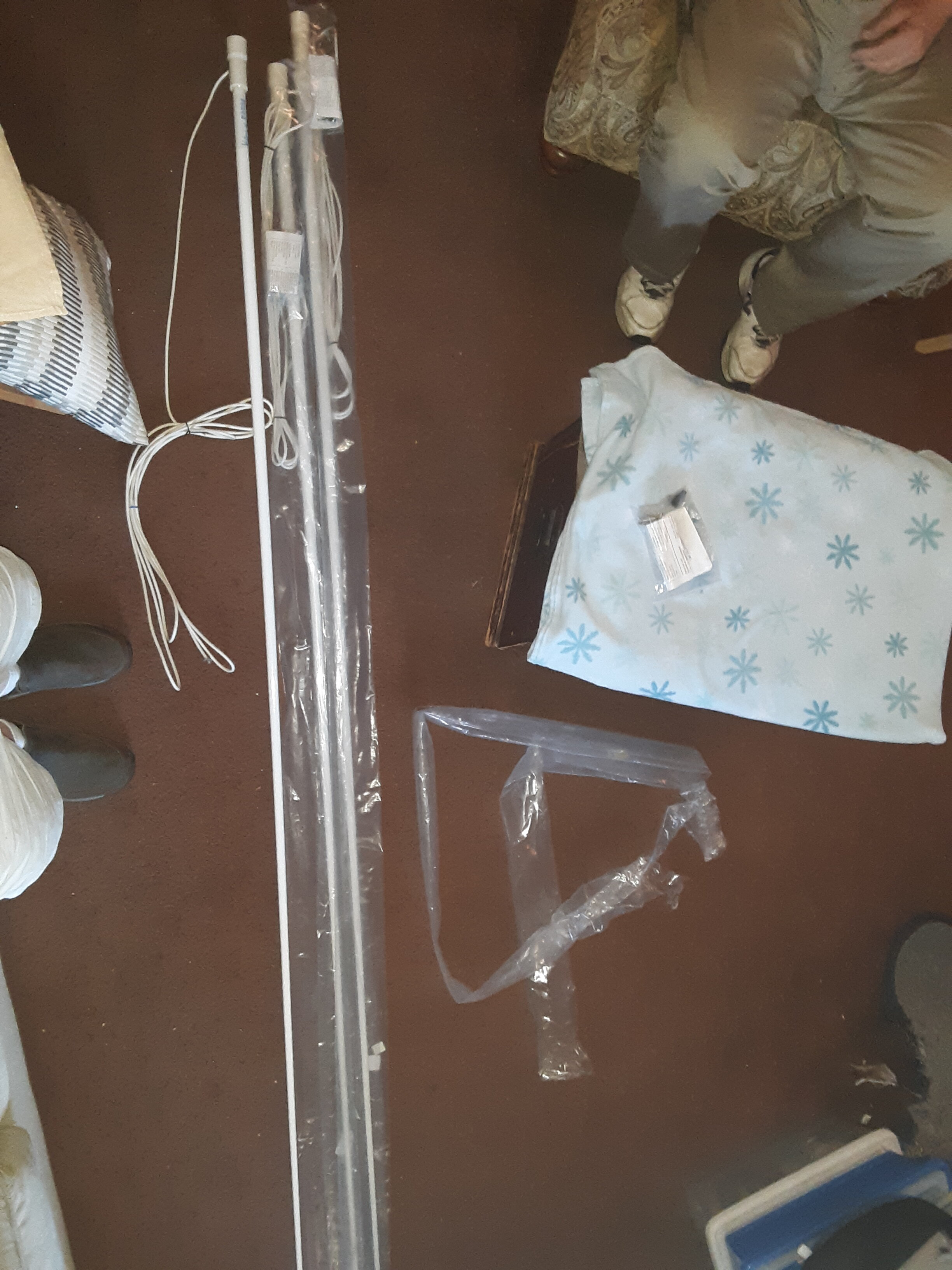

Working on these - see the conversion thread - 8 foot cheap Antenna, out of business company

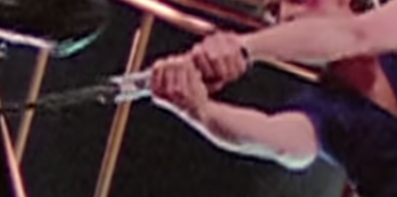

Guys, that blade with the wide, short adapter and long tang is a VERY short blade. Like 2 handles length. What sword was used for fighting with such a short blade?
The Yuma stunt has a super short blade, and the long tang looks like it could go into a ROTJ skinny neck saber. IIRC the ESB stunt in the Wampa cave was a short blade as well.

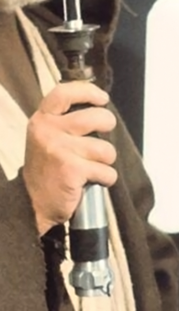

Im looking at that adaptor or collar, and why its so thick if its just a metal sleeve. Might be a bearing?
