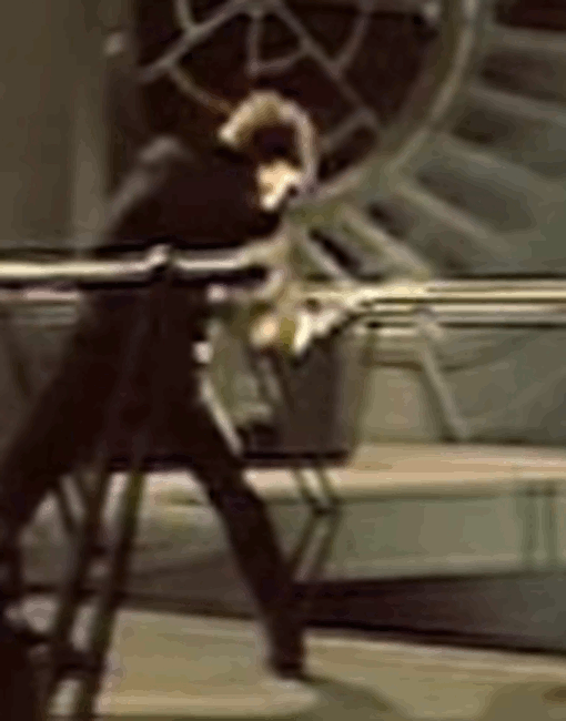

GRP looks to me like it can be made to have all sorts of flex/stiffness qualities. Ski poles you'd want decent stiffness for support, sea fishing rods you'd need lots of flex. I wouldn't write it off just yet as a possibility. Decent flex on that wood dowel too. What breed of wood?
When ever some talks of flex I always think of this ROTJ shot I found.
