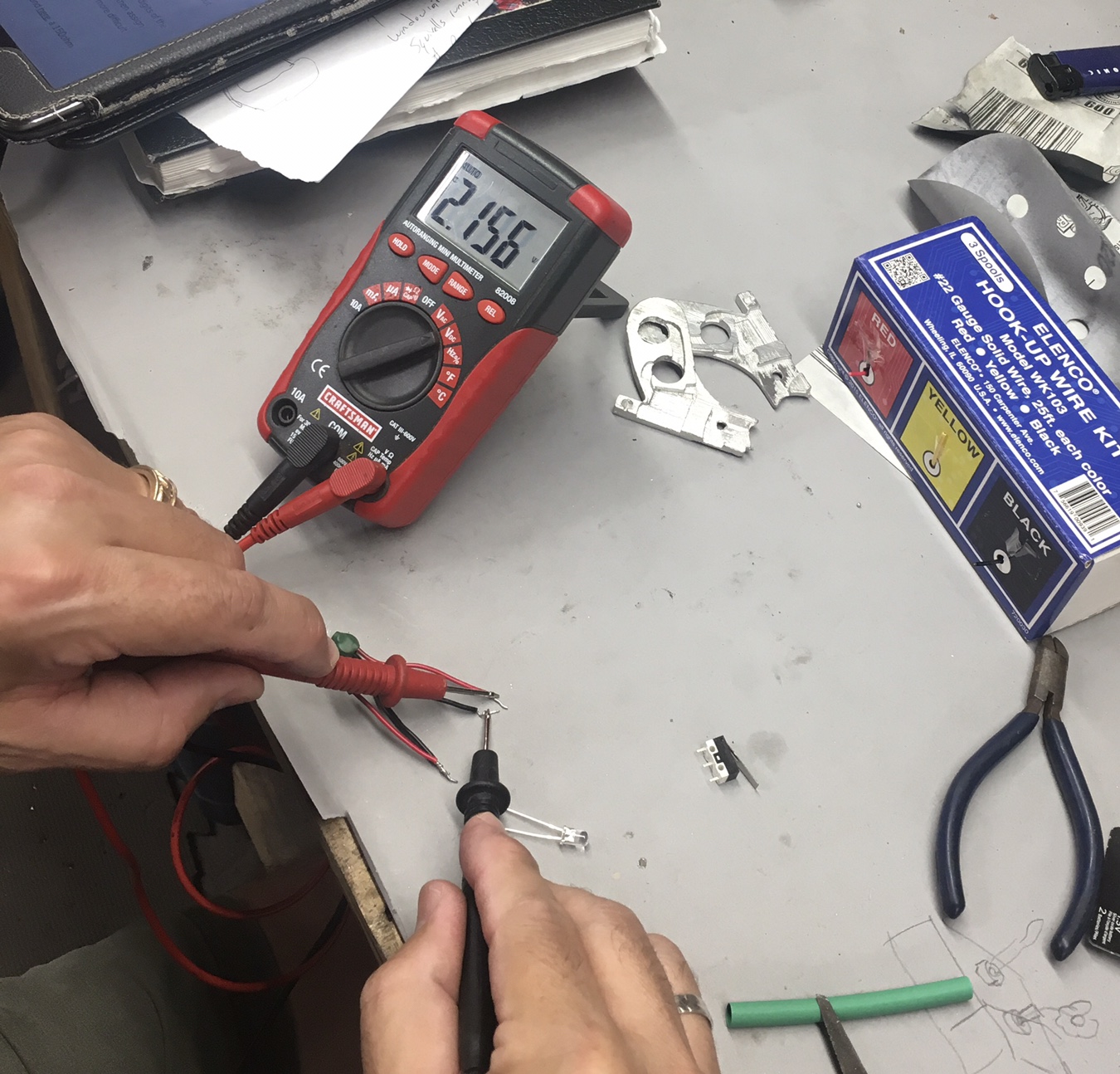

I pulled out my son’s multimeter and did some googling.
I think the led is ok?
I tested another led laying around the shop, which scored a little higher- whatever that means.
Still didn’t light.
Then I tested the battery set up. It’s pushing a little over 2 volts.
So, not enough voltage? Needs a resistor?
What am I doing wrong here?

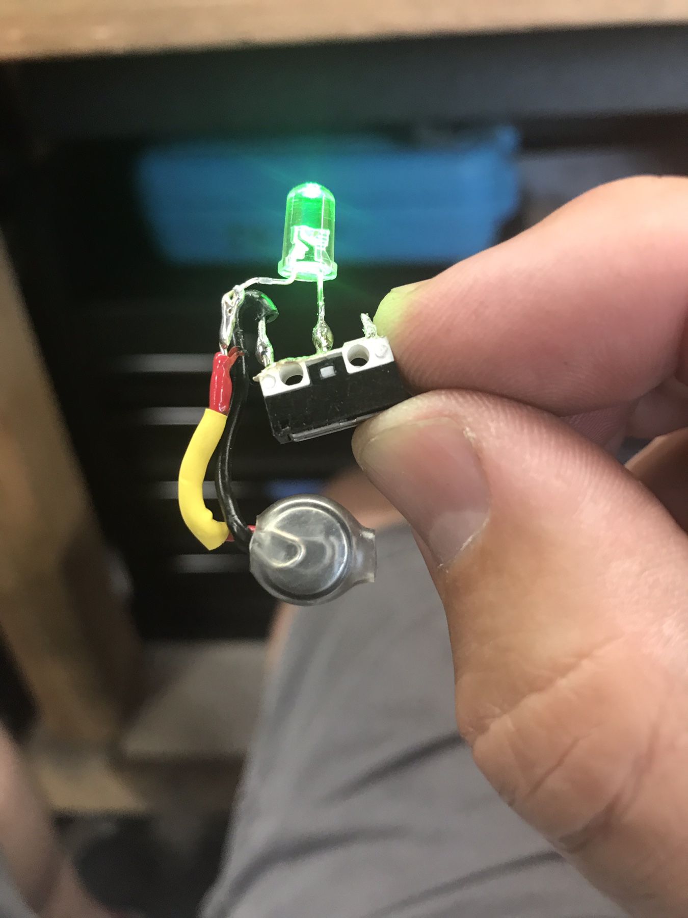

Edit: just tried a 1220 battery and it lights up!
But, it is too big for the openings in the housing.
Back to Mr. Google...
Progress!
Voilà! The Noisy Cricket lights up!
Okay, sure. The heat shield was supposed to cover the bare wires. Um. Premature shrinkage.
The 1025 battery fits in the handle. The wires, I think, will fit in their channels.

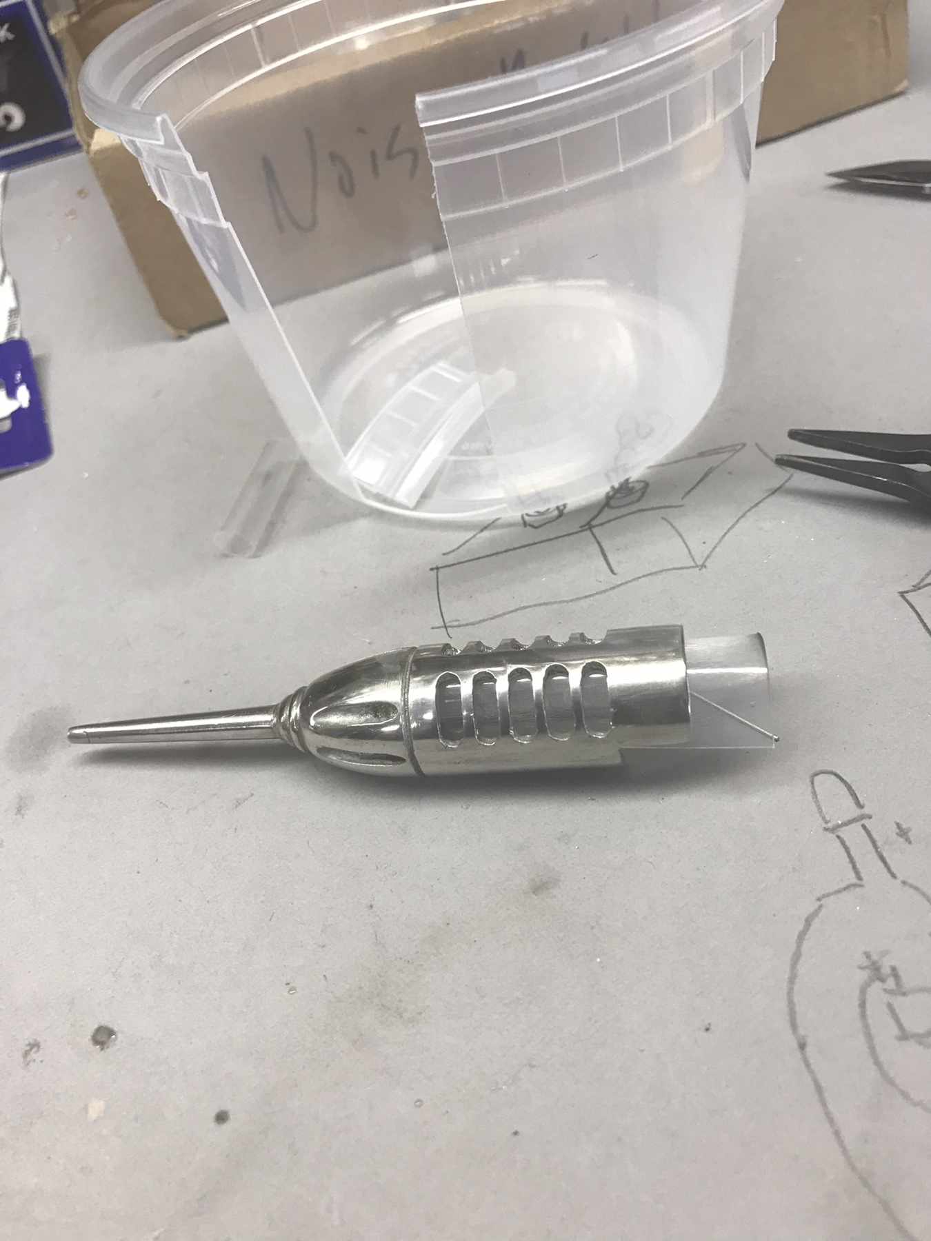

A little plastic from a to-go container...
A little more polish and then time to drill holes.

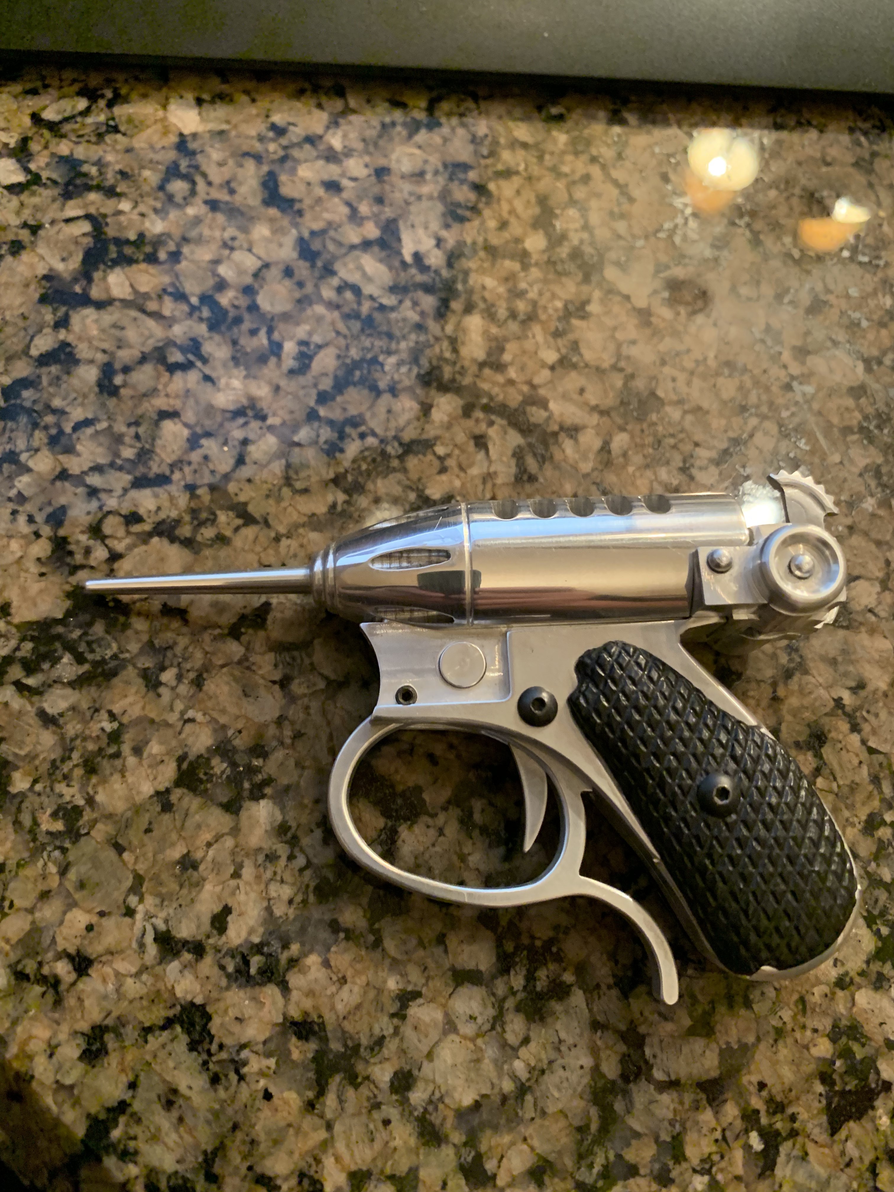

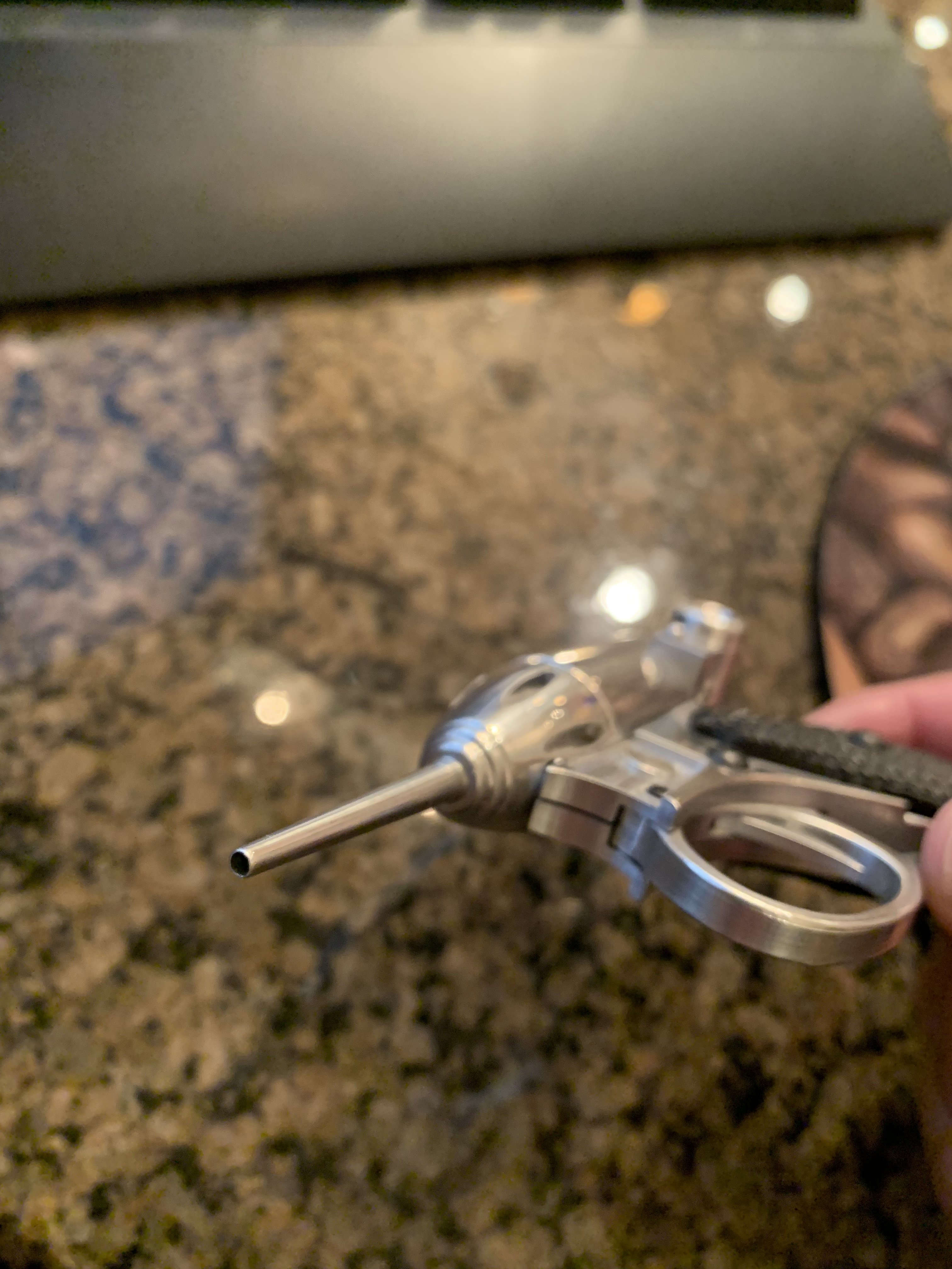

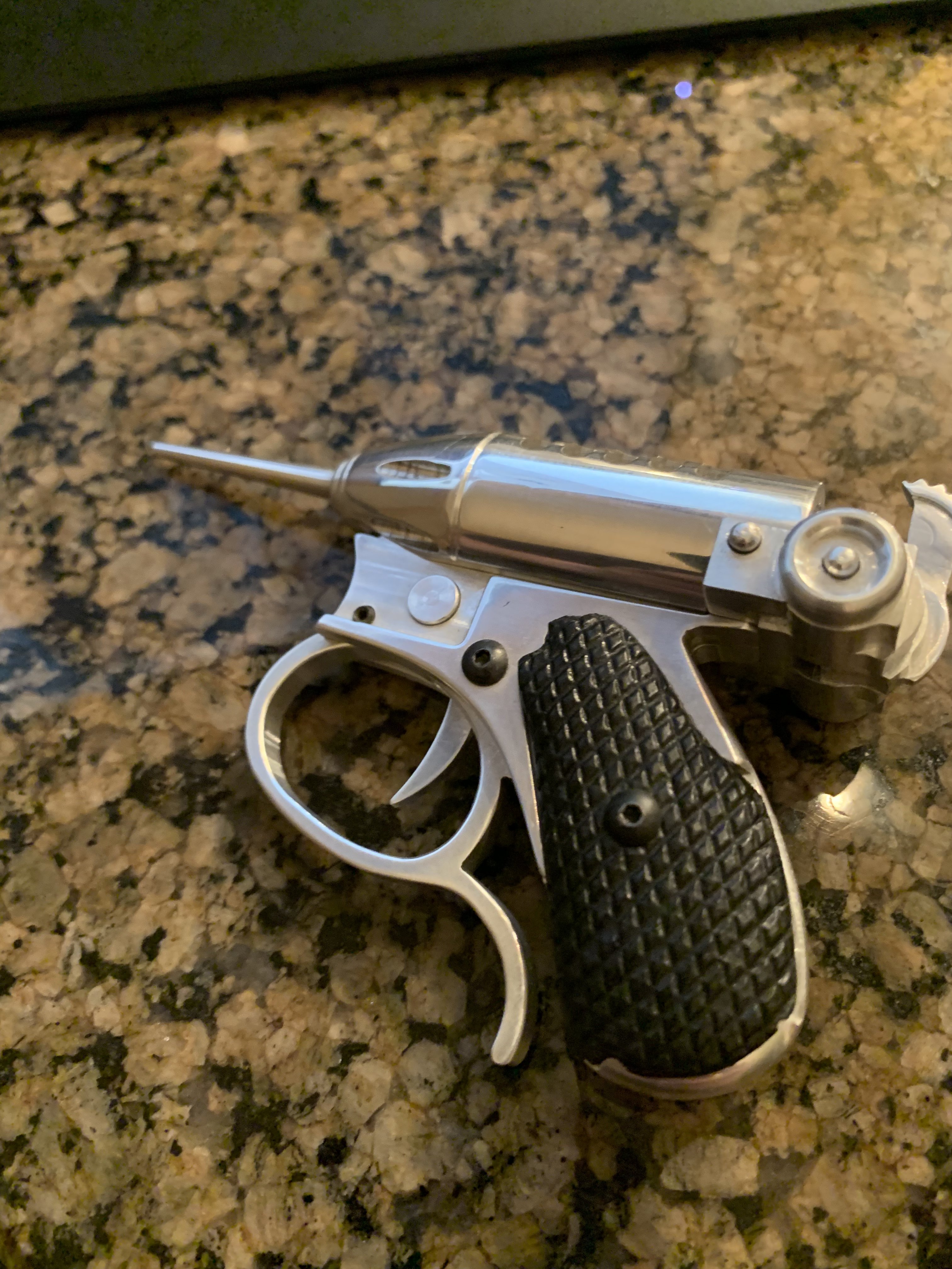

Here is my pride and joy from a run done with the original Cricket as a reference. Not cast. Totally machined. Hard to find now, I am lucky to have it.

Nice one. Any more info about the creator? At this moment I'll stick with the Factory Entertainment one...
guys, this is a wip thread from McKeePhoto on his Elilay kit, i don't think this is the place to show your prop from another maker and discuss it ;)
McKee, any progress? did you get your tap set and experiment with it? Mine is well advanced, I just bought new screws to replace the ones from the kit that didn't match the screenused prop in my opinion, I didn't start the electronics though so it might just stays as it is for a while now sadly. I'm a bit sad that Elilay is not more communicative and still didn't provide any info on the assembly.
cheers
I think the pictures of The Dude can be good reference material for McKeePhoto to finish his kit, certainly if it's made with reference towards a screen used cricket. Still curious about the creator ;-).
the creator is nick's dad, it's from a very old run and it's not available anymore. It's true that's it's nice to have references and this is a nice replica but we have the prop store photos of the real prop for references. ;)
