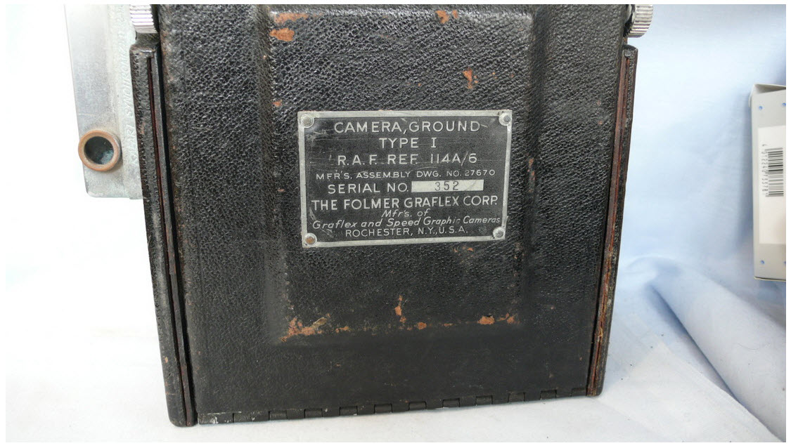

Are you saying each camera was 114A/6, each 127mm lens was 114A/606, and each flash was 114A/63 -- and thus there are multiple flashes with that 114A/63 stamping? That's what I was gathering from comparing the recent photos from you, teecrooz and Edraven99 of these ground camera kits.
Correct (y) (same items have same R.A.F REF numbers)
Chris teecrooz can you post a photo of your S92 R.A.F REF Number Sheet with mine, Drew you will see that the (same items have same R.A.F REF numbers)
Correct (y) (same items have same serial numbers)
Okay, cool. That's what it looked like was going on to me. teecrooz posted an excerpt of it on another thread.
Though, as I was saying, your and Edraven99 's cameras both have individual serial numbers as well, 19 for his and 352 on yours. But we don't see that level of fidelity on the parts list, or any sign that every part in the kit got a unique serial number. Is that right?
(Edraven99's photo attached for easy reference.)
YES each would have their own serial number, sorry I have been referring to the R.A.F REF part numbers on each item (my bad I need to edit my posts) as this has been a discussion on the Clamp Number 114A/63
YES each would have their own number, sorry I have been referring to the stamped part numbers on each item as this has been a discussion on the Clamp Number 114A/63
Great. Thanks for clearing that up, and thanks for sharing the info about the ground camera kits. Very exciting stuff!
