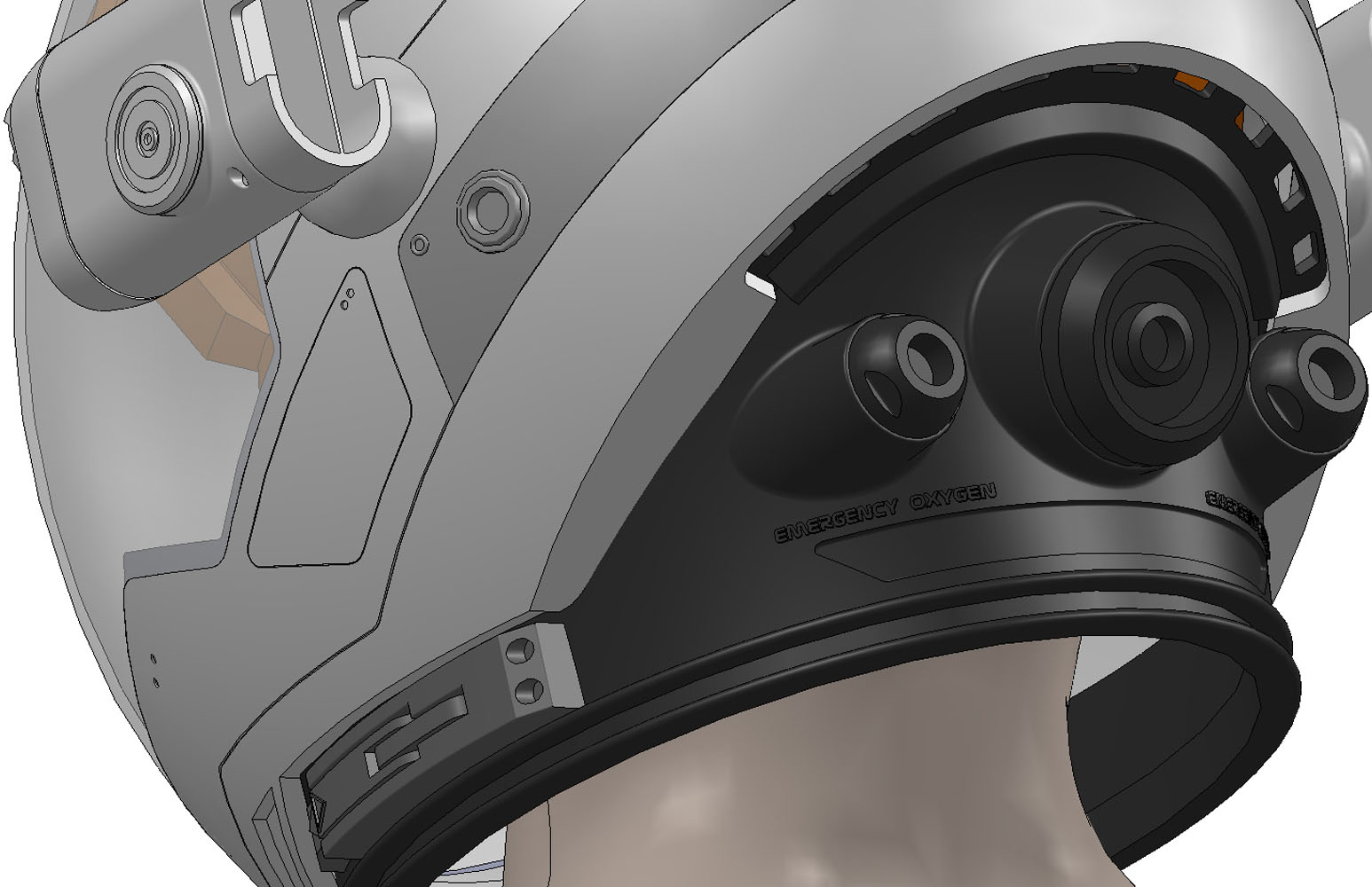

Cleaning and refining the parts. I added a bunch of little details. I want that when you guys get the finished helmet all you do is just add paint and decals and you are done.
Off to a good start, I think. :)

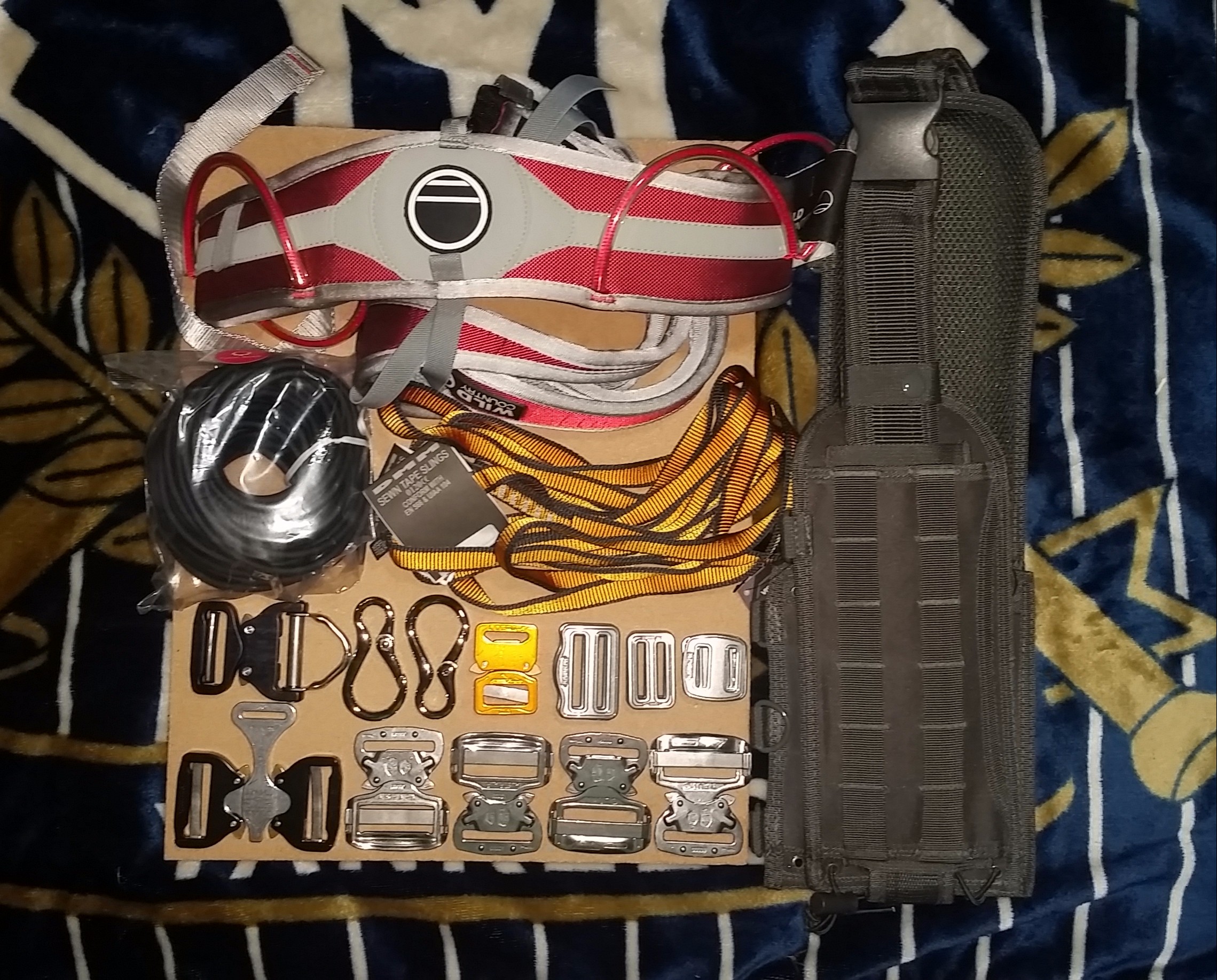

Trying to upload an image from my phone here.
I noticed that the buckles looked different as if they were more loose than the ones you get when buying them and I noticed this little detail showing that all the male ends are thicker brass too!
20151014_141252.jpg20151014_141115.jpg20151014_140424.jpg20151014_140242.jpg20151014_140123.jpg20151014_140004.jpg20151014_135920.jpg20151014_135708.jpg
These are the parts I got so far, got a way to go but I think most of the parts that can be bought are here excluding the webbing, cable connector on the chest plate and of course the buckles.

Sorry for the bad quality photos and the tilted ones, I got no computer for a couple of days.
I believe the 2CoolShirt in the movie is also a Badger Sport brand in case someone want to make a DIY shirt. I was considering it earlier but decided to pay the full price since I can't take any risks with leakage inside the suit.
