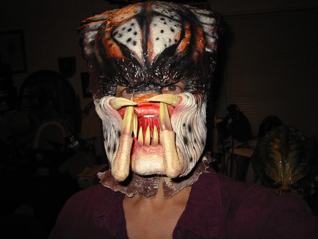

I started on the mask, I'm using this one because I can't find a bio to fit the other one I have...
Many thanks to Silverado for the mask, Bovine13 for the bone dreads, and Bambooie for the foam dreads & dread rings :p

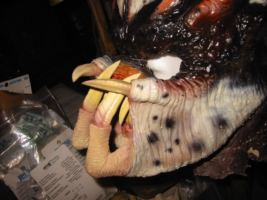

It came with backer rods in it, and some foam dreads (Casey's?), so I am taking the backer rod off and installing the bone dreads and 'booies....
Here's a couple "before" pictures, first one has a bone dread set there for reference... I'm also gonna take the mandibles off to paint them and do a little dentistry on 'em :p

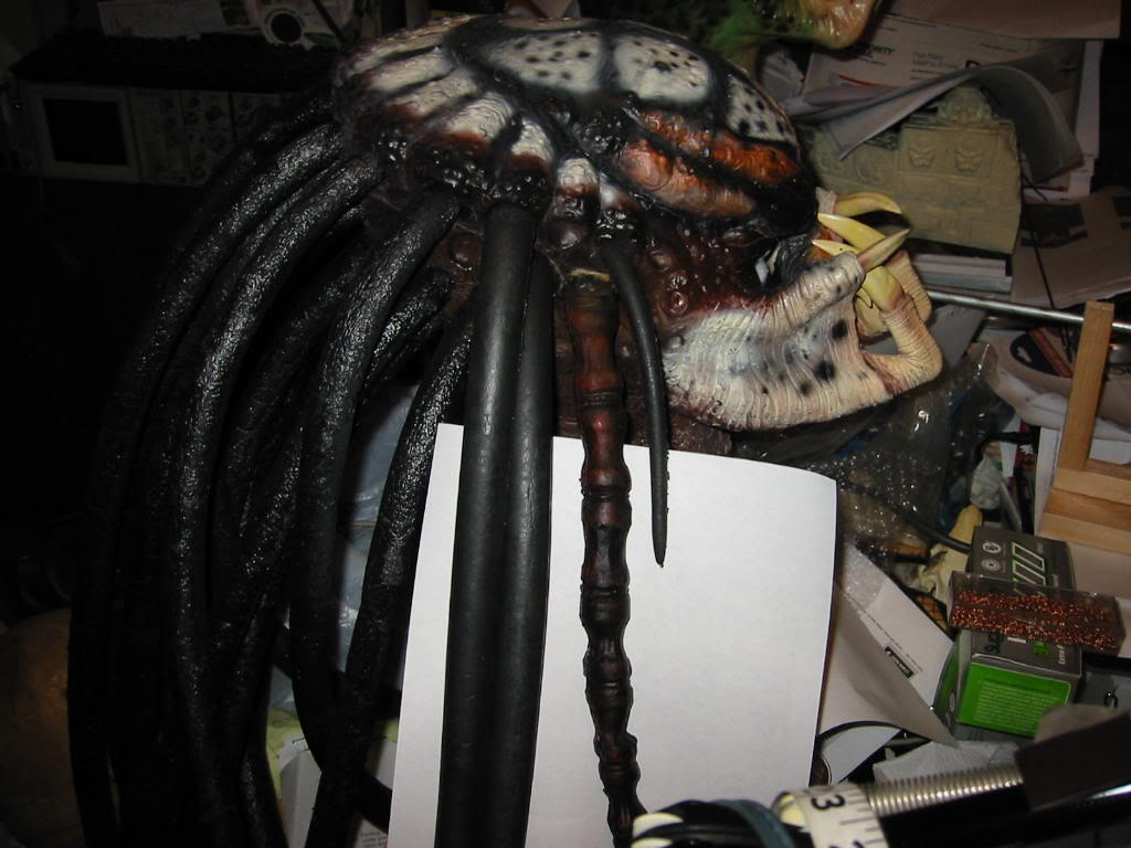

how do those bone dreads move?
They're a little stiffer than Bambooies, so they will go on certain spots on the mask where there isn't a small bend radius....
Maybe I could put stiff wire in them near the root so they would bend right.

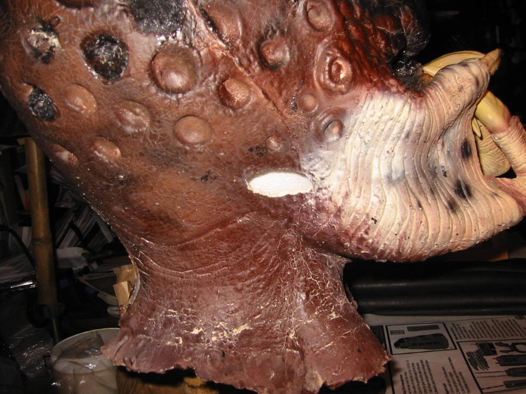

I got all the dreads out of the mask; the trick to removing dreads is cut it as close as possible to the head with an exacto knife, then push the stub through to the inside.

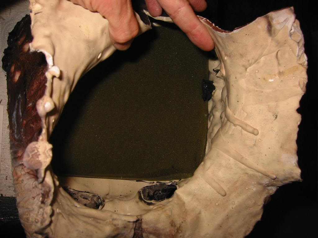

There was very little area that needed filling, maybe an inch at most, so I scrounged around for foam and found a couple 3/8" thick pieces.
I used Dap Weldwood to glue them together and then stuck it in the mask.....
I tried it on and it fit like a glove :)
BUT...... my hearing aids started a chorus loud enough to wake the dead :mad:
I'm deaf without 'em, so leaving them out is not an option :eek:

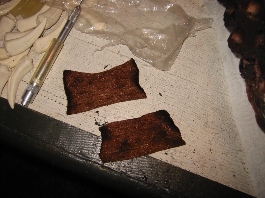

So I thought and stewed and thought and.... AHA, I remembered UltimateHunter's thread about "Do Preds have ears", and thanks to Roninpred's post and pix, I had the solution... cut an oval and put some brown fabric behind it and touch up the cut edges with brown paint.
I know it should be pinkish, so I'll scrounge around for that color material.
I still have to tweak it, make the holes larger... those little stinkers still squeal :)

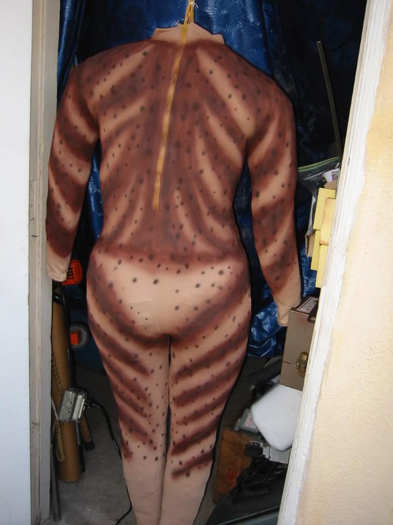

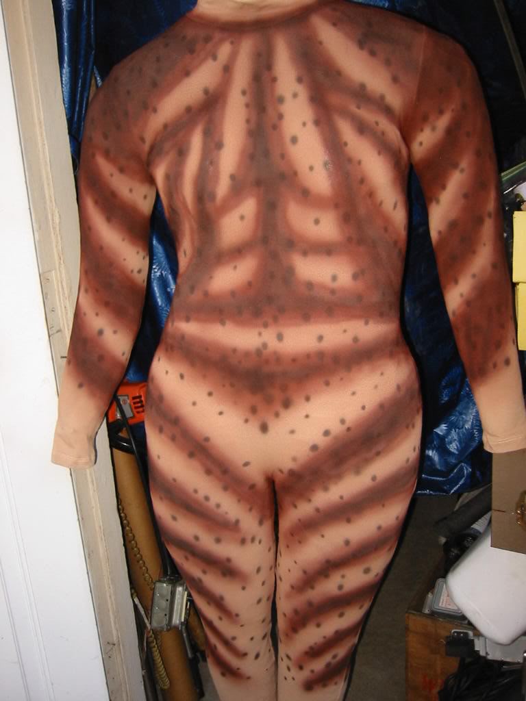

Here's the sequence of the paintup, all the paints are Createx Transparent Airbrush paints, that are heat-settable.
I didn't dilute them this time, I wanted the colors to show thru the mesh better :mad:

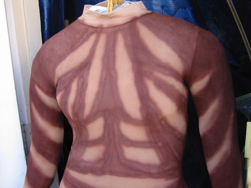

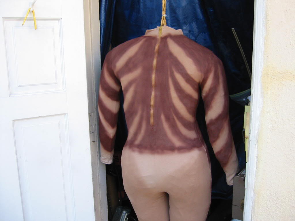

Sand base color, Light Brown stripes, back view It took 12 ounces total of the Sand
front view

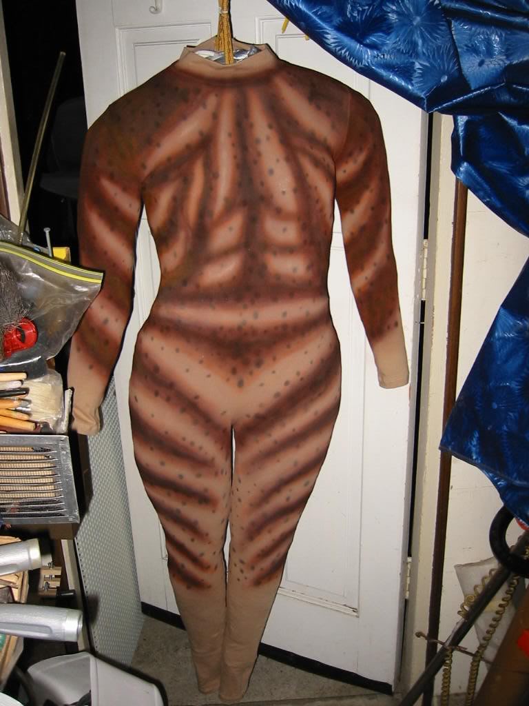

Dark Brown added, plus LOTSA DOTS, front view

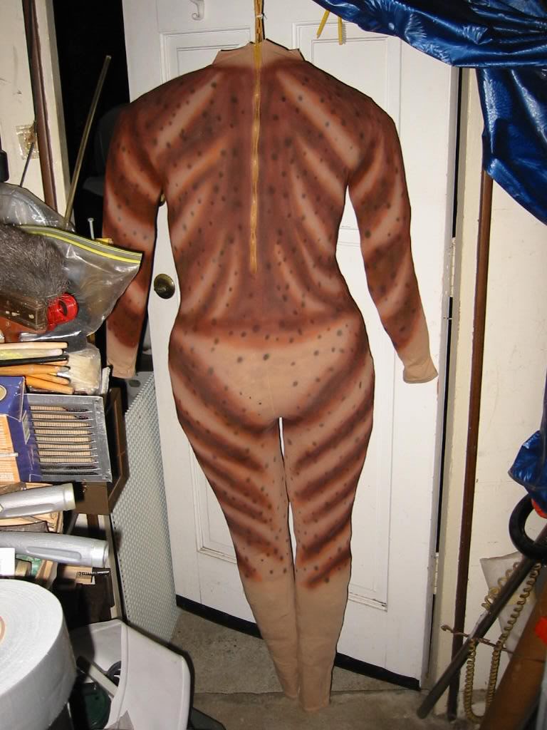

Back view
Added orange to match the mask, back view
Front
I finished up just as it was getting dusk, now I have to let it dry for 48 hours, then peel it off and heat set it.
(To do this, you turn it inside out, stuff it loosely with terry towels from Home Depot, then put another terry towel over the spot to be treated, then iron it for two minutes.
Move on to the next spot and repeat till you've done the WHOOOOLE thing.... )
