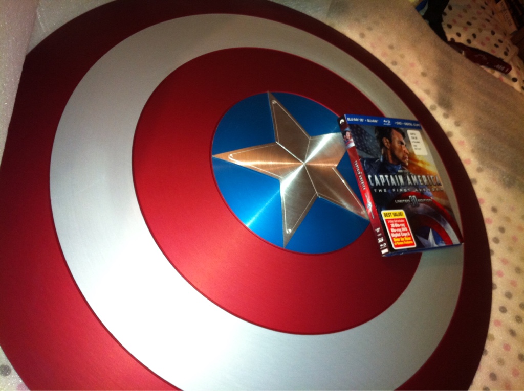

Got the shield home today and hung it up FINALLY!
Awesome shield and display! I can went sand the color with 2000/2500 grit then wash it and clear coat without having to put another coat of paint on right?
I just have to wet sand my red and blue with 2000/2500 grit sandpaper, adhere the star and satin clear coat it. Here it is as it stands now before sanding:
