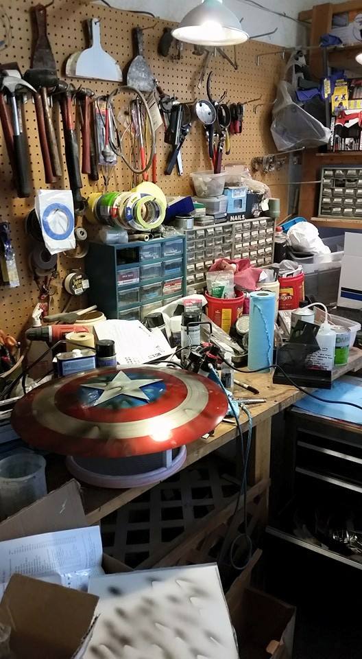

I've looked into it before and there are three ways to achieve the anodized look.
1. Actually anodize the shield through an electrolyte bath.
2. Powder coat
3. Anodized Spray paint
Option 1 isn't possible because you can't anodize one piece different colors.
Option 2 is very expensive and as you say there is a risk of discoloration.
That leaves option 3. Auto body shops don't use anodized spray paint so you could buy the cans and ask them to spray it. Not sure what that would cost.
General Frosty does great work and not to disuade you from his services, but you should try painting it yourself.
I promise that short of dropping or scratching your shield up, you won't do any permanent damage. Bad paint jobs can be removed with citristrip, acetone, and time. Not to mention painting you're own shield is fun.
Buy a sheet of aluminum and practice spray painting it. When you get confident enough, paint just the blue inner circle of your blank, then move on to the red. After that you can take it to a body shop and have them clear coat the thing.
Good luck with whatever way you decide to go with! [emoji1]

Chipping clearcoat suggests poor preparation. I used http://www.amazon.com/Krylon-Colorm...TF8&qid=1433457567&sr=8-2&keywords=clear+coat
From it getting banged around. I know, easy answer. Dont bang it around. But I've heard of clear coats that are scratch resistant but you cant wetsand or buff out because its so strong? Has anyone tried this on their shield?
