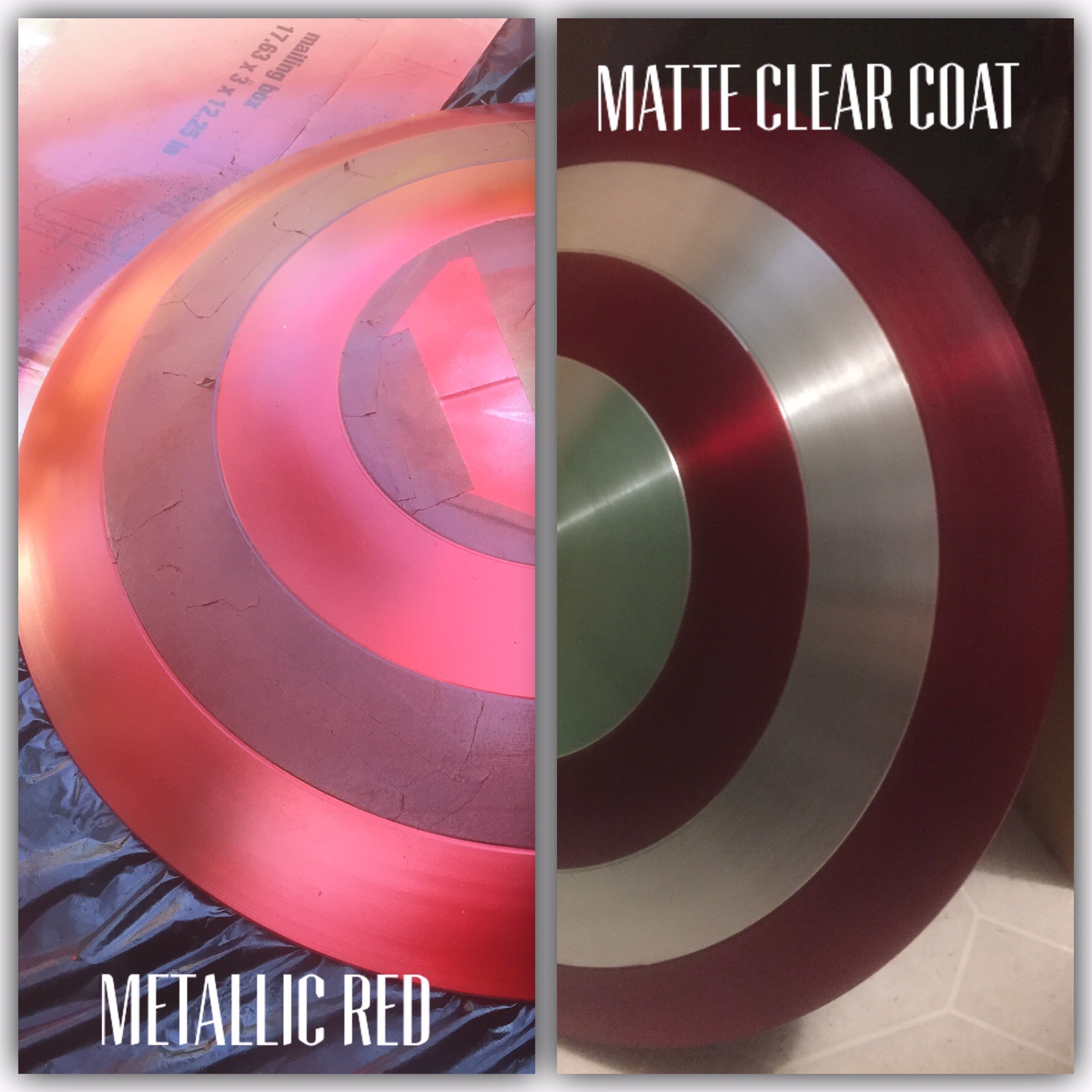

Has anybody tried to do a shield with a matte finish like the one in Age of Ultron? I just bought a shield and was thinking of doing a shield like this one avengers-age-of-ultron-poster-captain-america.jpgavengers-age-ultron-captain-america-costume.jpg1516243_1453476401578715_973952433_n.jpg

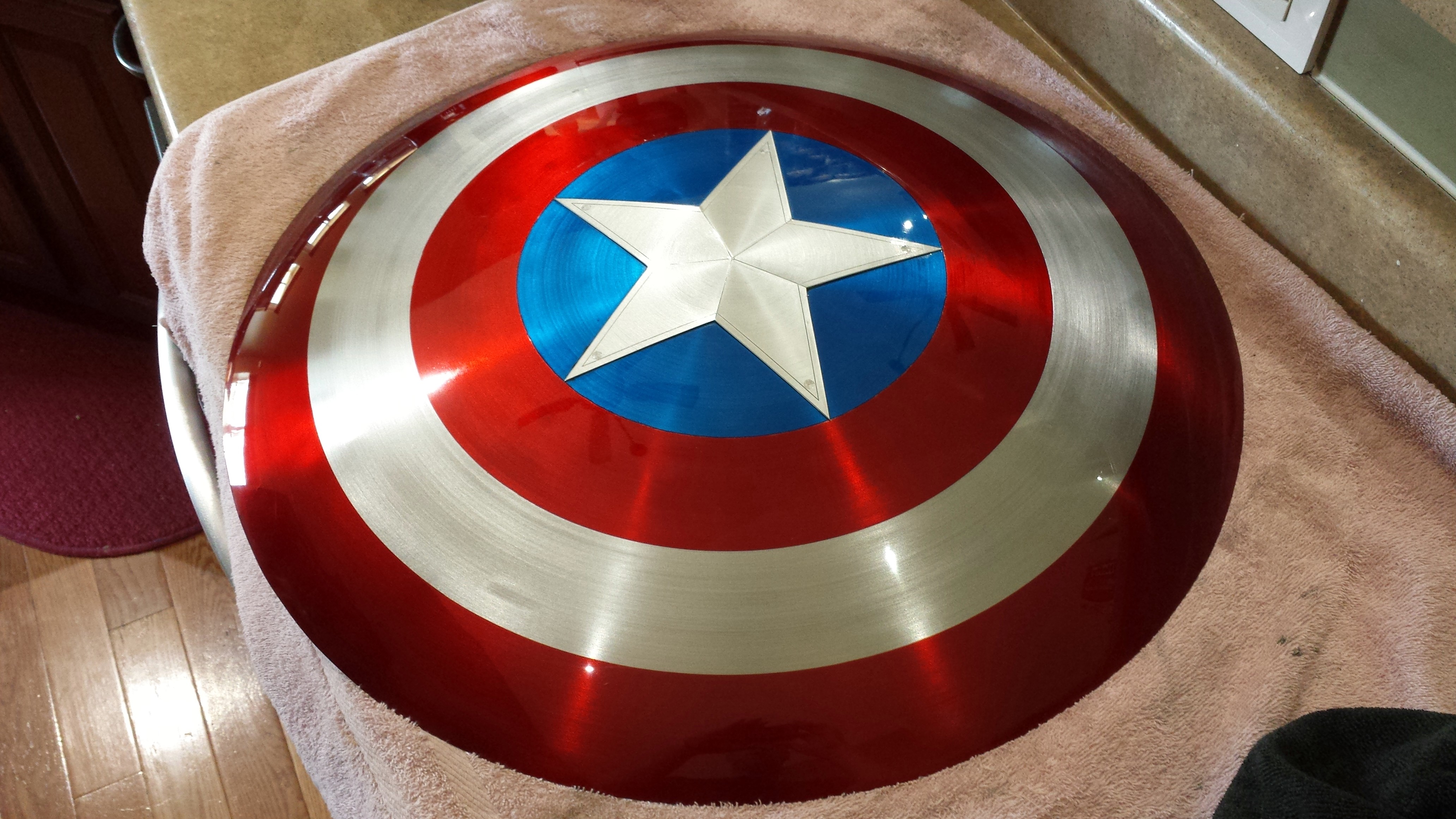

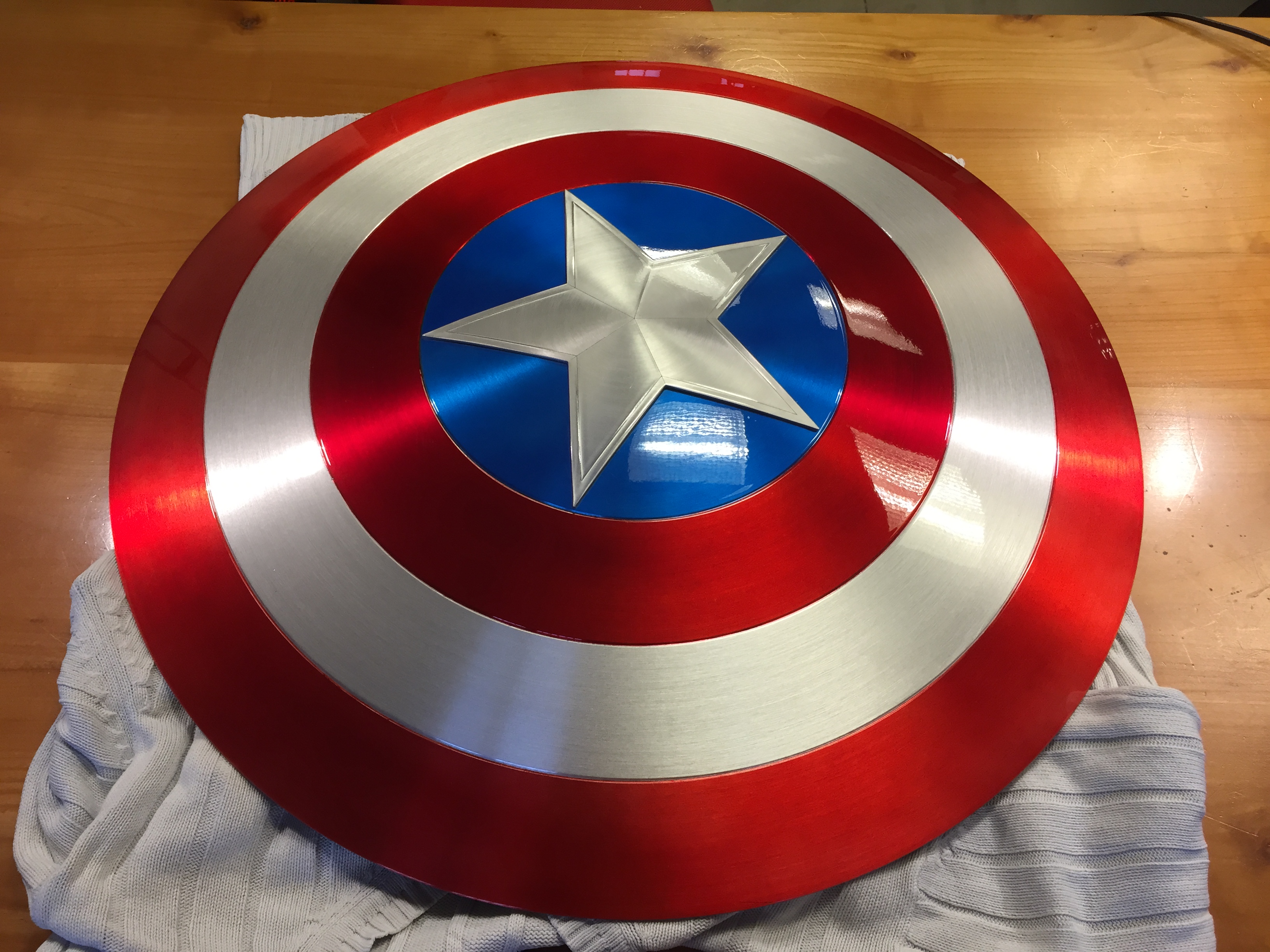

Im finished (maybe) with the shield. Went a little too heavy in certain areas with the black. Oh well. Anyways, here it is.
All of the film shields have been a satin finish, which is why I've never understood the shiny glossy shields.
I know a glossy finish isn't movie accurate, but it is so damned pretty. My sled build was mirror finish since it wasn't going to be 100% accurate anyways. My aluminum spun shields are satin. In my experience, non-RPF-types generally don't care about accuracy...they almost always seem to prefer the glossy paint job when seen side-by-side.

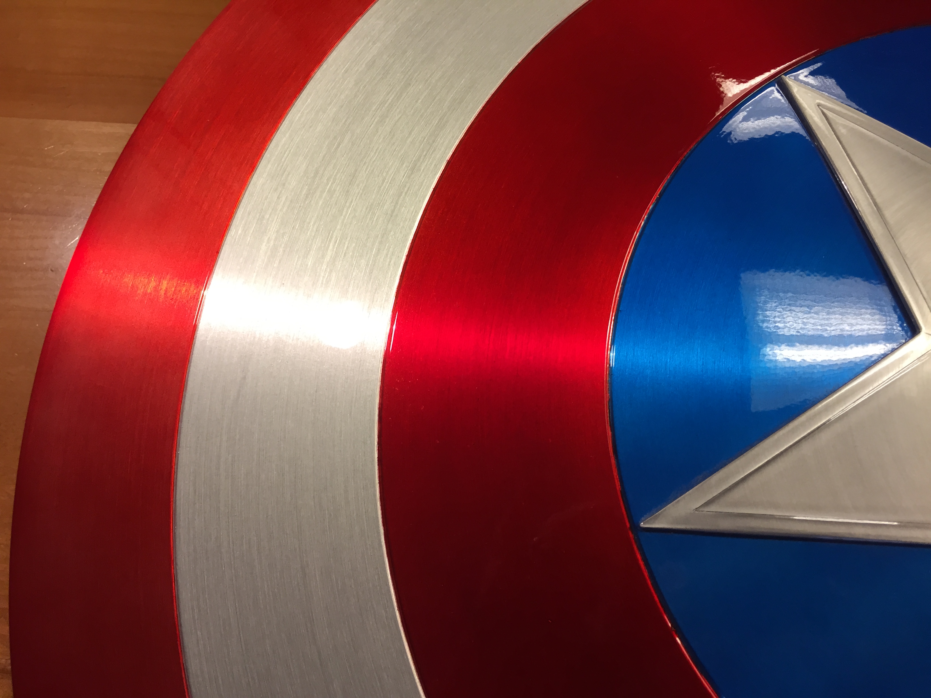

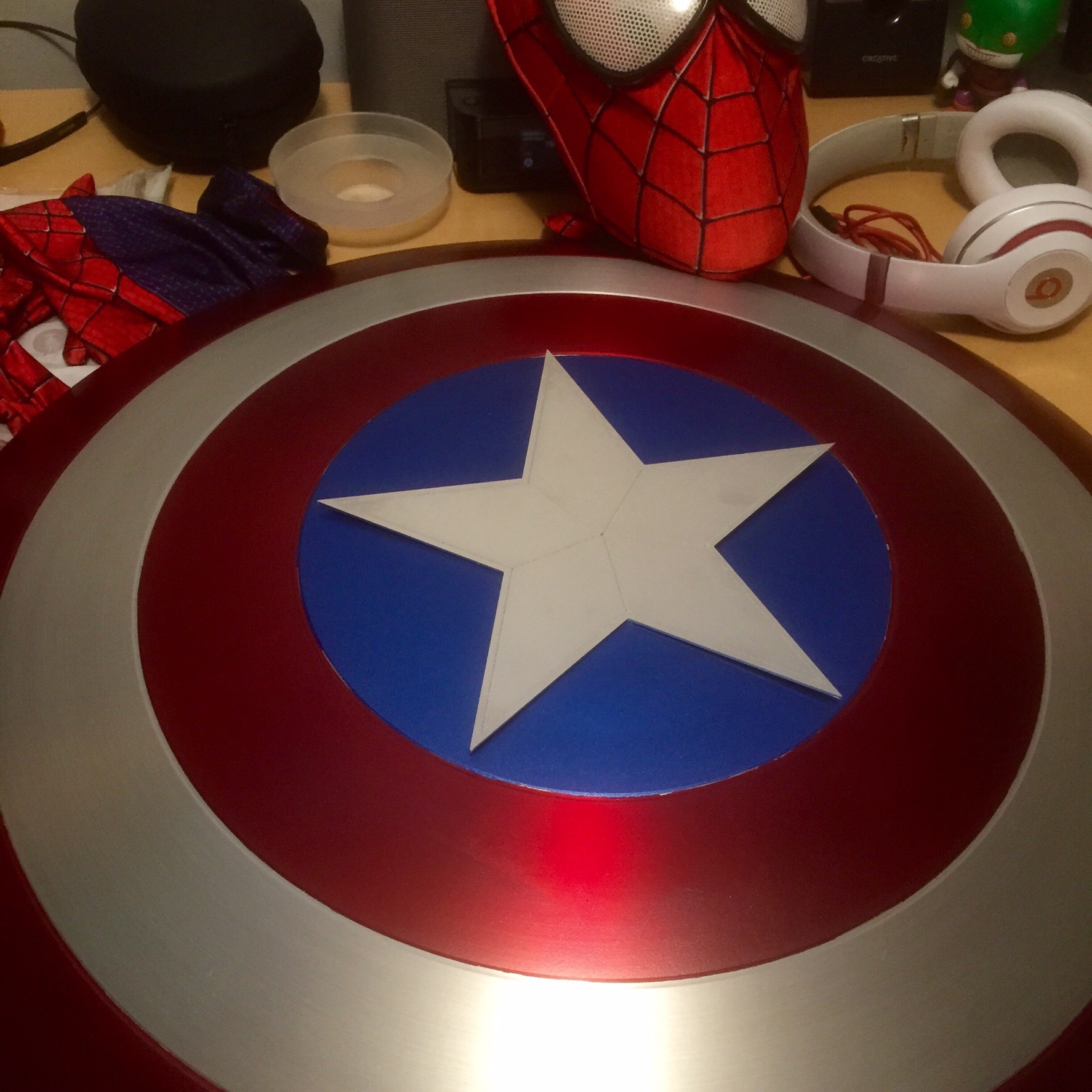

My shield thanks to you fine folks and your suggestions. My first time painting and I learned a lot. It's not perfect, but it's mine .
Thanks for the tips 'n tricks guys!

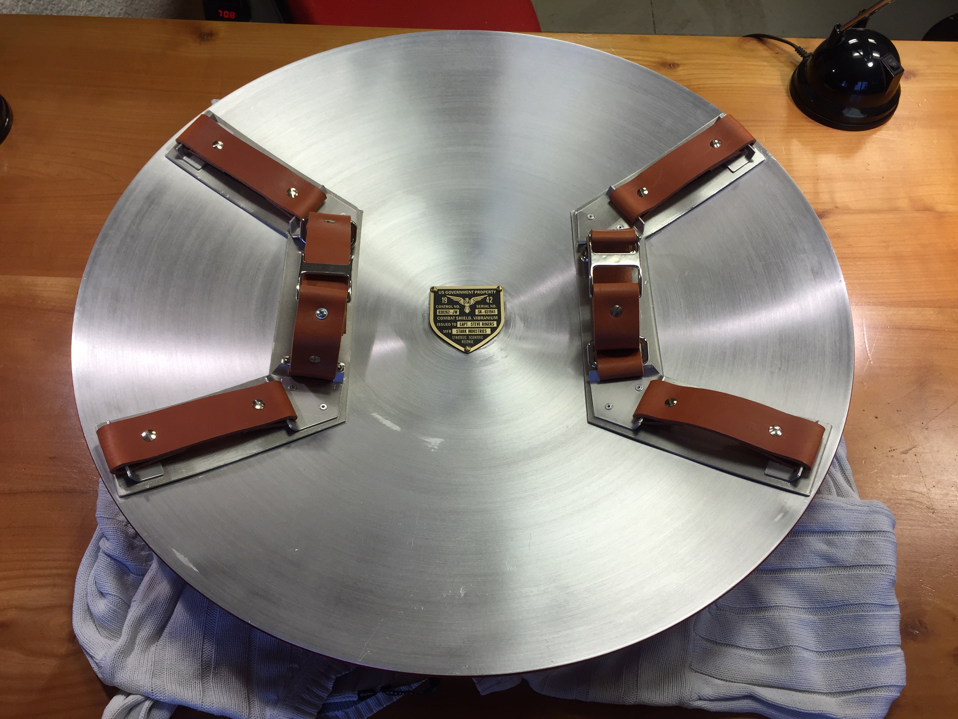

4. Regarding mounting the brackets to the shield I had a quick discussion with Valor regarding the use of silicon glue. He suggested to use mounting tape as you do not have to clamp the brackets down. I somehow came to the idea why not use both since that stuff is sticky and flexible. I used it between the mounting tape. So far it holds on to the shield very well and with the mounting tape you do not need any clamping .. J

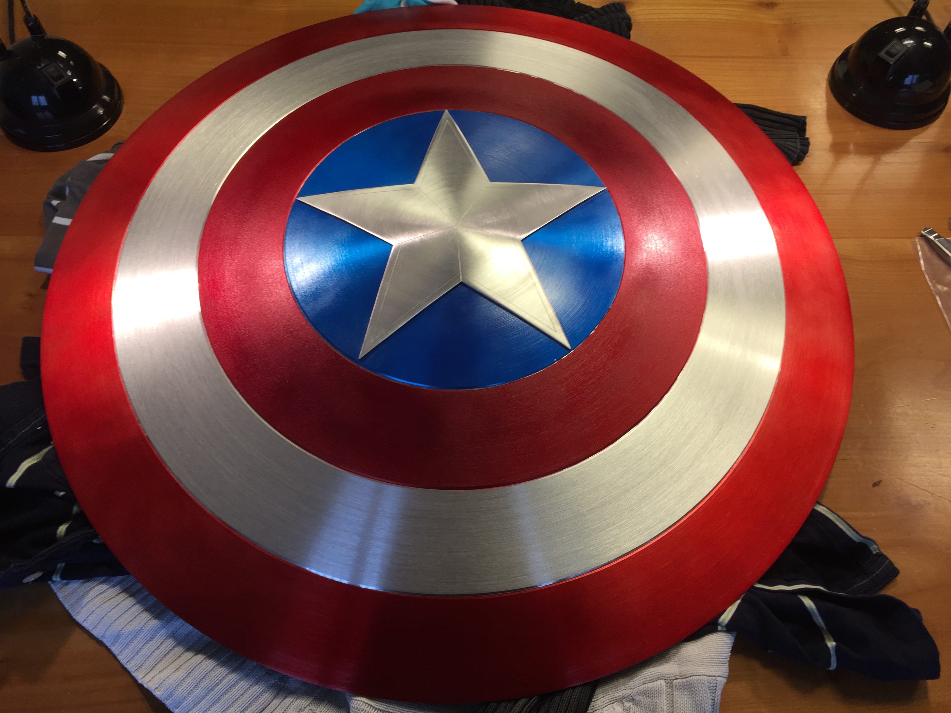

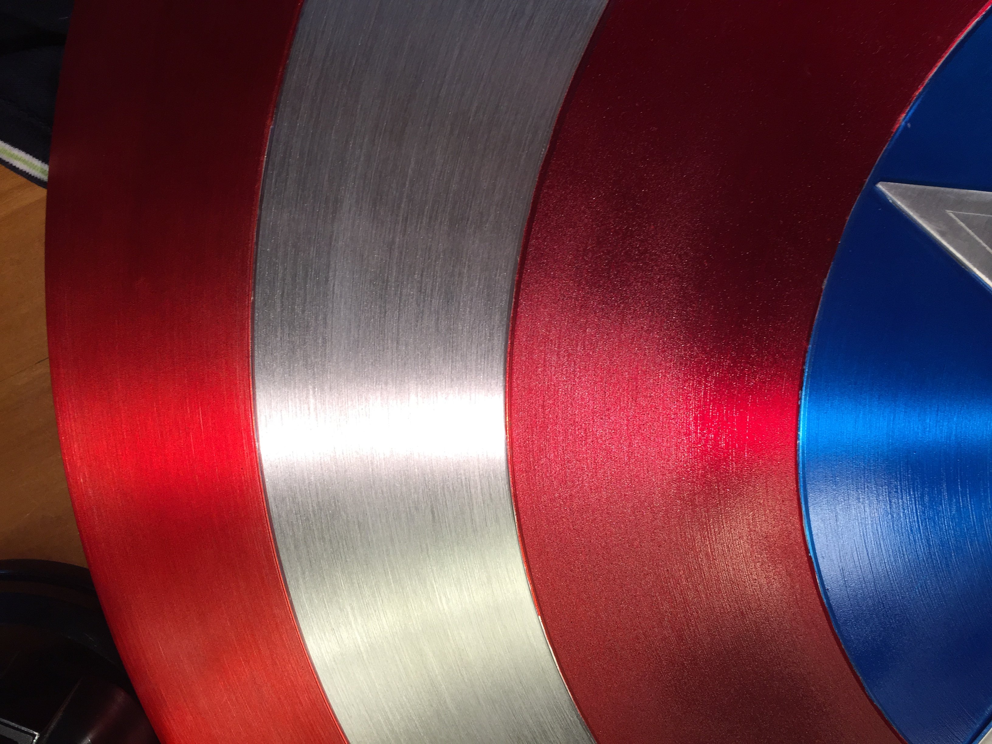

This is the finished version.
Not as good as the ones from the more experienced guys in here but I’m happy with it and….. it’s MINE….:love

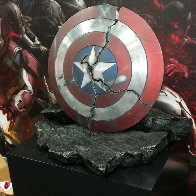

what colors are you guys using for the darker versions of an AoU style shield? I'm looking to repaint mine up here soon, and would love any pointers!
