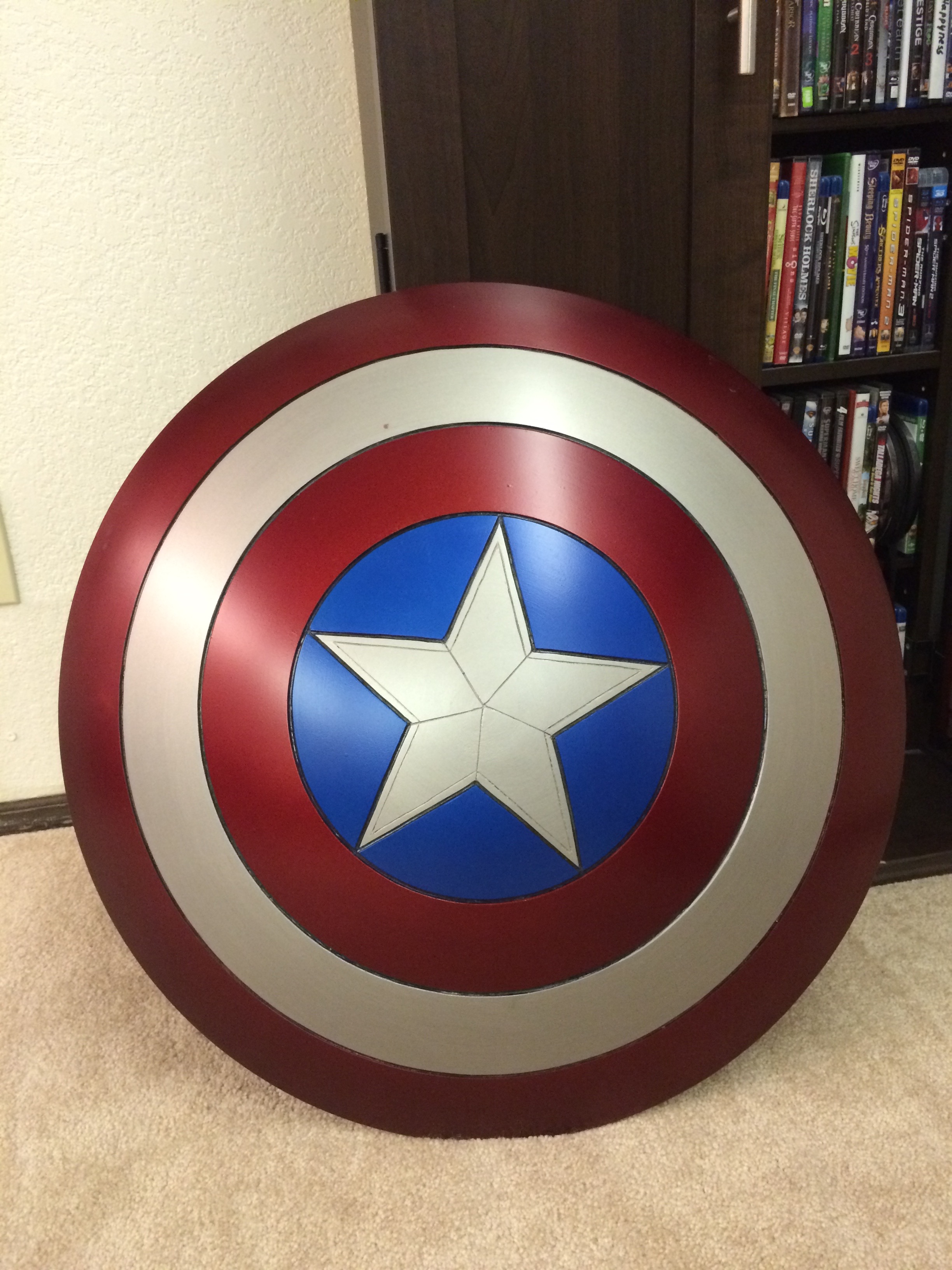

I agree. I have seen many shields that are too glossy. I know its not perfect, but here is my first attempt at the shield that I made from a plastic sled. I used three coats of a matte clear coat, and I think it comes close (at least for the red).

Yeah, mine is definitely too glossy but unfortunately I couldn't get the duplicolour metal cast paint here and after about 5 attempts - getting it looking good (albeit glossy) was better than starting over again. I might redo it at a later stage or add a matte clear coat to see if that sorts it but at this point I just didn't want to start again :facepalm

I'm really liking the colour and finish on that shield, good job [emoji106]

Thanks. The metallic base coat was a combination of a sprayed dark steel, and then a brushed on stainless steel. I used the duplicolor red and blue over that, and then applied the matte clear with my hvlp spray gun. Not nearly as good as many of the metal shields I have seen here, but it is passable for now.

That shield screams AoU to me! Nice job.

Thanks. I wore it to the premier with a shoulder harness I threw together quick. It wasn't totally screen accurate, but it sure beat holding the shield all night.
That seems like a nice affordable way to make a durable, accurate, and light (ish) shield. I'll definitely be trying this some time!
