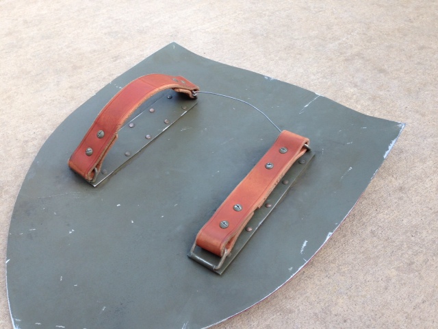

Also Frosty, you mentioned you had a good method for forming the brackets? I've been trying to get them into shape while I wait to paint, and it's proving to be a royal pain. In particular, getting the diametric curve into the vertical portion of the brackets has been all but impossible. I've considered setting it in a vise and taking a rubber mallet to it, but I'm afraid of overdoing it. Thoughts?
A vice is key, but put away the mallet. Here's my process. Stick a folded over thick towel into the vice and close it partially. Then stick the end of a bracket into the padded vice and pull. Use the vice for leverage. Work little by little and stick the bracket in to get the various curves necessary. Once you get going it doesn't take long at all.

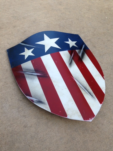

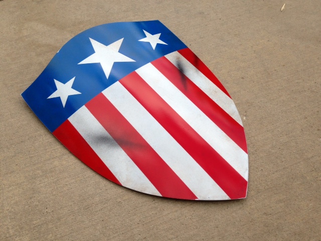

It was just a matter of time until I NEEDED a First Avenger heater shield. I had a few blanks made so I tried a few different things. I had the blanks cut from 1/4" thick aluminum .... it's REALLY thick :)

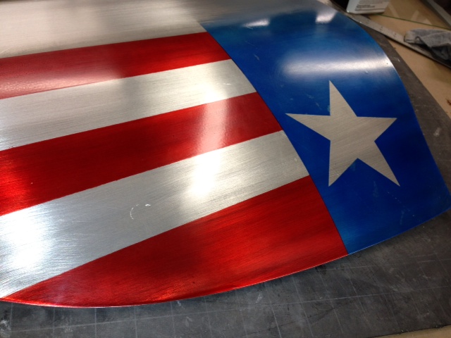

I've painted a couple up with the traditional colors. Even weathered two. .... Tried a military green back on one. Then I wondered "What if Cap decided to keep his new vibranium shield as a heater shield shape?" .... I haven't seen anyone try this so I gave the front of a shield blank a good linear scuffing with sandpaper to get a brushed look, then hit it with red and blue Duplicolor Metalcast. I only did half the shield as a test. ..... I'm really torn of whether I like it. But I thought I'd share.

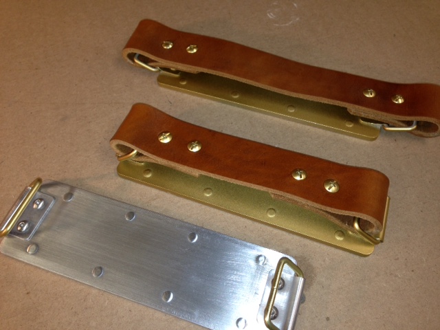

A couple more. A look at the bracket system I'm using on the back. And one more pic of the Metalcast paint on the heater shield for the "modern heater shield" I'm contemplating.
