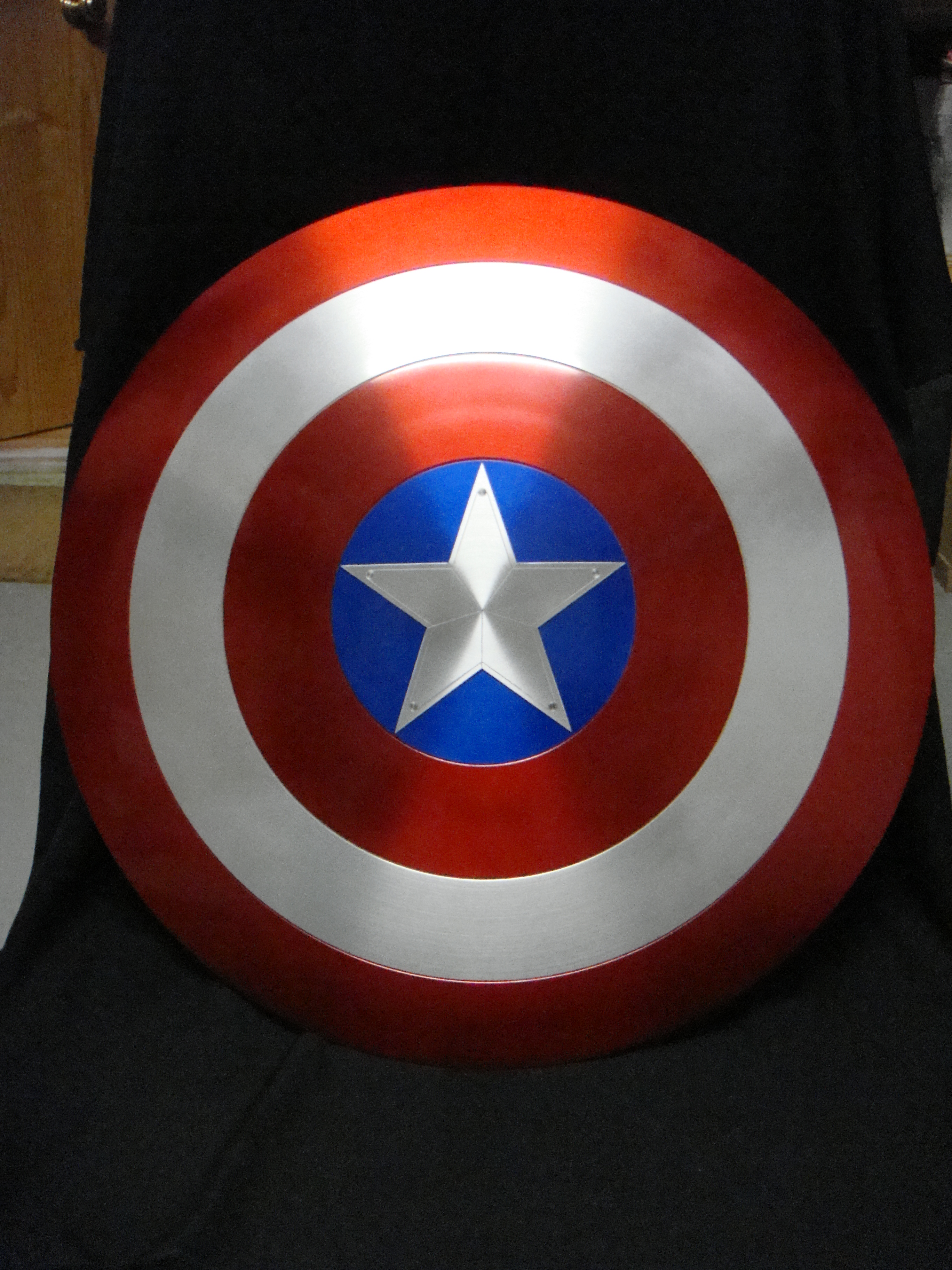

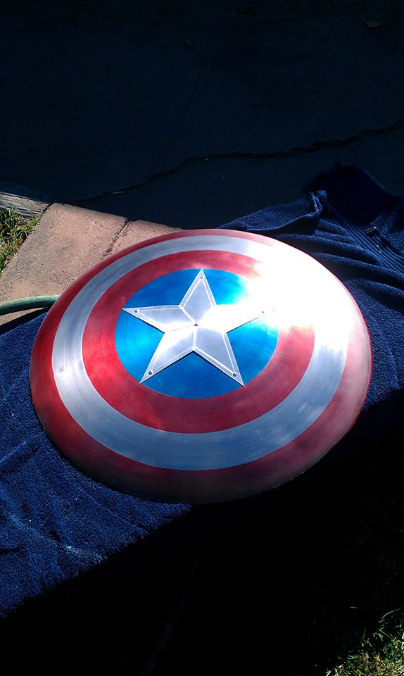

Here's my first attempt! The picture's from a couple hours ago, since I have added rivets to the assembly. I'm putting two of the sleds together so I can get something with some heft. Added the plaque on the back, clearcoated, wetsanded, and now all I have left to do is to angle grind the edges and buff the entire assembly. Hopefully when I get the brackets they'll hold the entire thing together just a tiny bit tighter. So, if anyone was wondering, yes, it is quite possible to construct this with actual rivets, and much sturdier. My only regret is that I might have to redo the red paint. Didn't turn out dark enough in one area.
EDIT: Waxed the whole thing, shines like a gem in the sunlight. Thanks for all of your help, everyone!

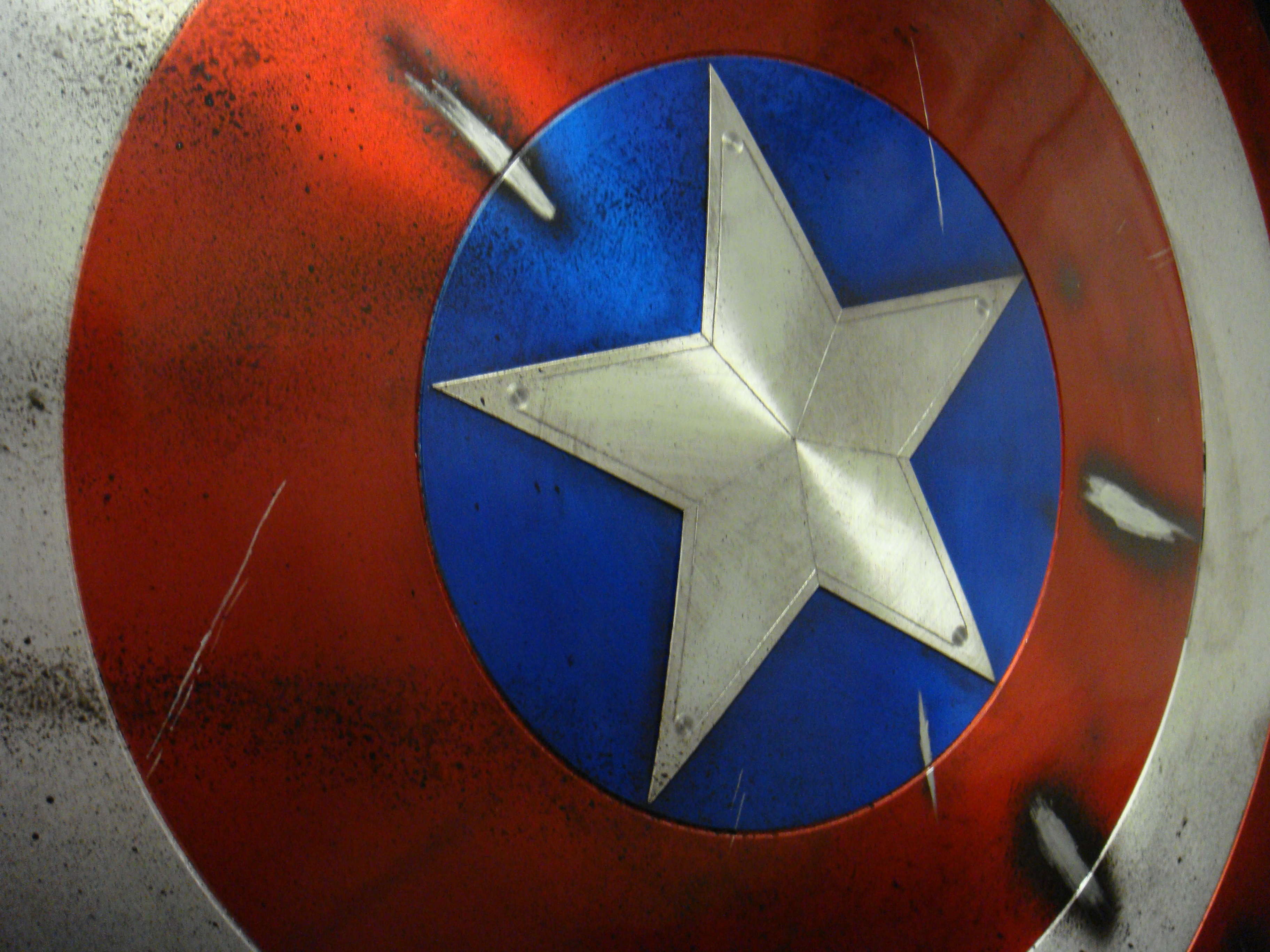

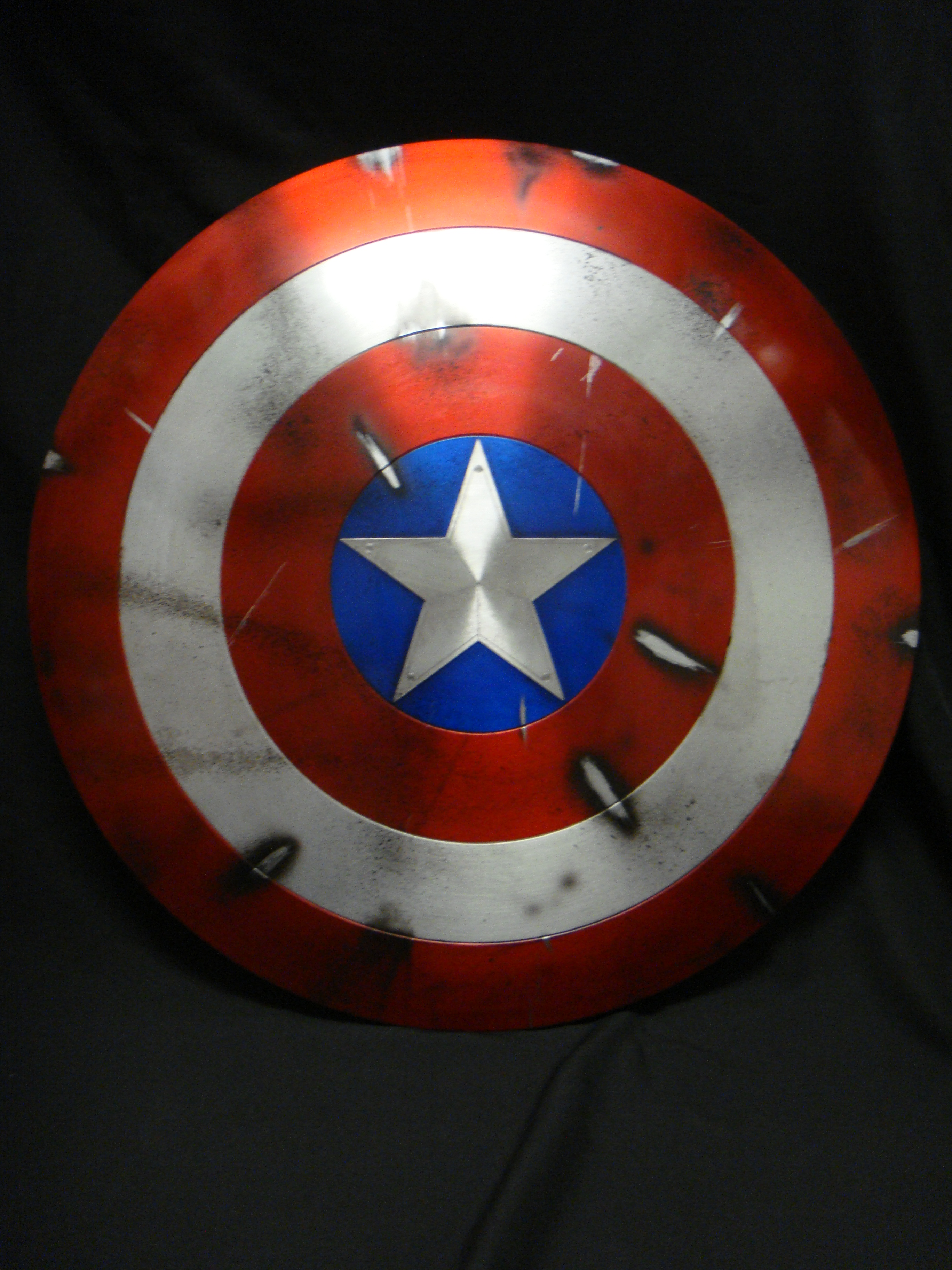

Here my experience: I bought the shield in ebay and the star from Valor forum member. I decided paint the shield before to attach the star. I had used Duplicolor Metalcast and before of the final clear coat, i used acrilic barnish for isolate the paint and avoid some reaction betwen the paint and the clearcoat. After wetsanding with 1500 sandpaper. After i used U-Pol clear coat. Again wetsanding with 1500 sandpaper, and finaly for satin finish, i buffed lightly with foam disc and liquid polish. I clercoated the star with U-Pol clearcoat and attached the star with double side tape. I really like the battle damage finish, then, i sprayed with a manual spraybottle some dark brown acrilic paint over the shield and airbrushed some spots. The scratches was make by brush with enamel silver paint.
I hope that it can someone.
