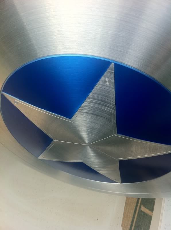

Here's the Duplicolor after drying overnight. The transparency looks a bit better now, I'll probably do it again though as there are a few small imperfections, a few small dots stuck (possibly paint spots) in the paint.
Color looks really great here.
Mandoman that looks great man. Keep up the good work!

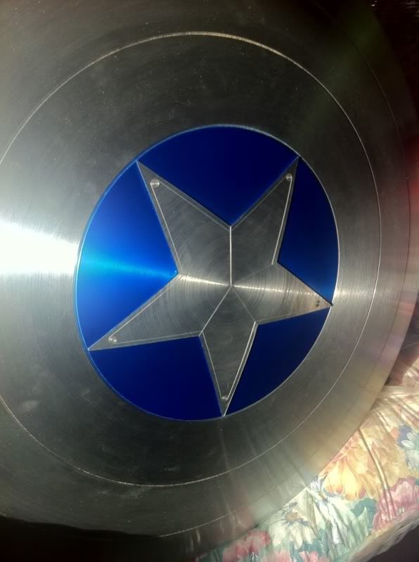

Thanks man! From most angles the Duplicolor blue looks quite good, I actually think I may prefer it to the lighter shade of the Testors. It still has some imperfections and a couple tiny, tiny things stuck in the paint which I'd like to correct, but I don't really have an area to paint that doesn't have airborne particles. I'll probably strip it again (and again), maybe try the Testors blue again even though I like the darker blue. The red is a different story, I'm almost certain I like the Testors red more.
Another thing I'm slightly concerned about is clearcoat. I want to use satin, but how much will it cut down on the transparency, and how much will it darken the colors?

That looks awesome man. The paint job looks very clean. You are only one red ring away from cap shield goodness!

Looking good! I recommend painting before you put the star on next time though. It's funny that your blue testors came out lighter than the duplicolor... I had the opposite experience, the blue testors that I used was actually darker than the dupicolor. Don't worry about the clear coat, use the testors semi gloss gloss coat laquer and it comes out great. Clear coat will not effect the transparency of the blues and reds, but will actually make them pop better.
Thanks! Yea the Testors blue looked a bit lighter to my eye. Definitely more transparent though. In hindsight I wish I had waited to attach the star until after painting. I'll have to see if my local hobby shop had the Testors SemiGloss, I tried some Krylon Acrylic Satin over the Testors on my test piece last night and it didn't look very good to me, Stripped it and painted the Duplicolor on it, so I'll probably try the satin on that tonight to see how it looks.

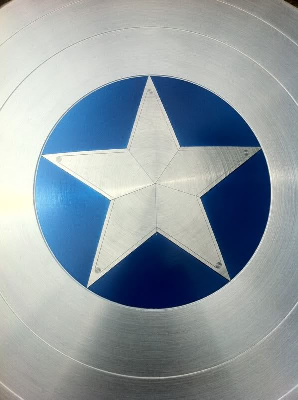

Okay so I redid the blue and got it Looking good enough for me. Painted the outermost red ring and while it looks great from head on, at an angle the paint looks uneven, should I be worried about this or will clearcoat help with that?
