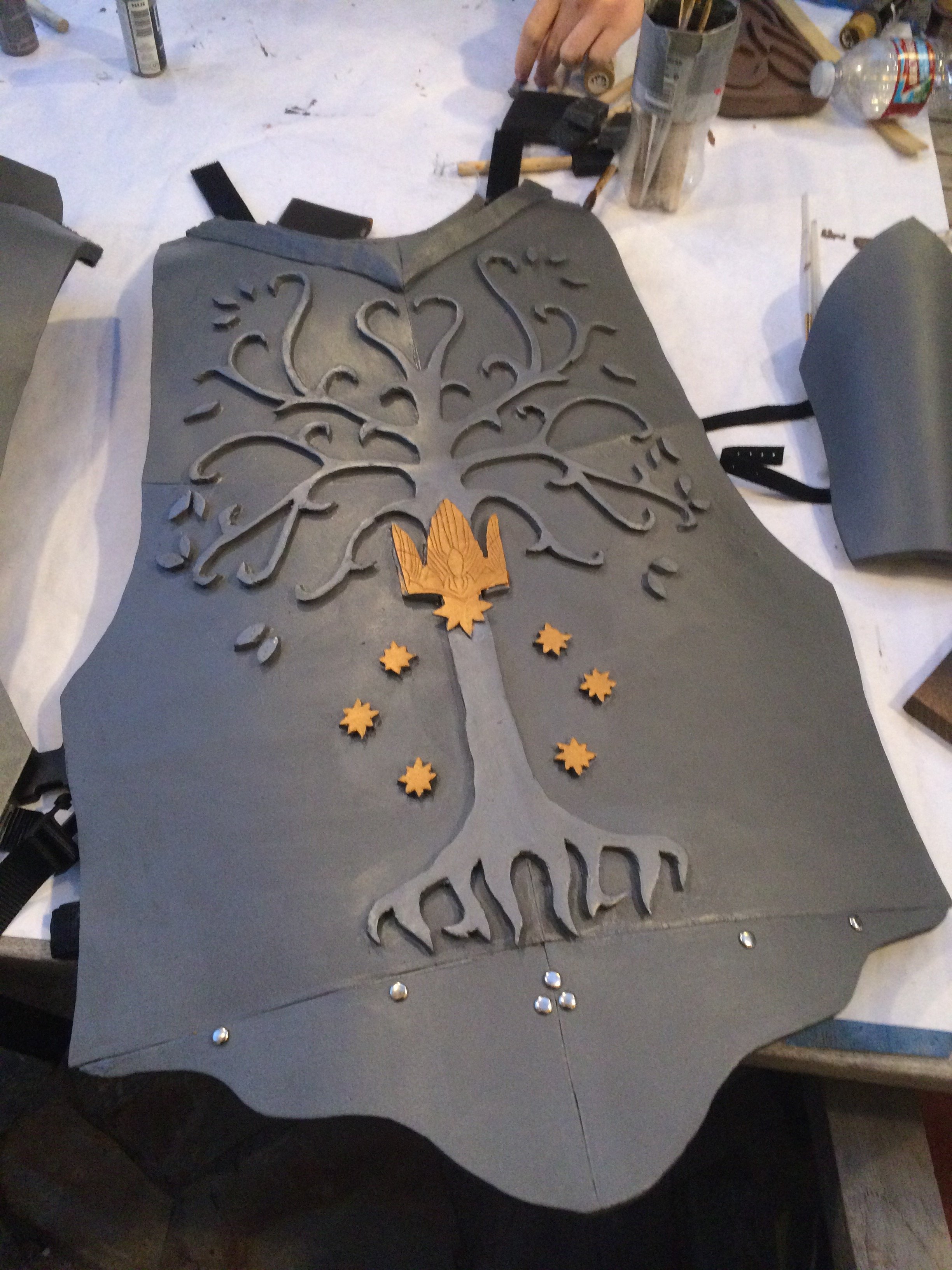

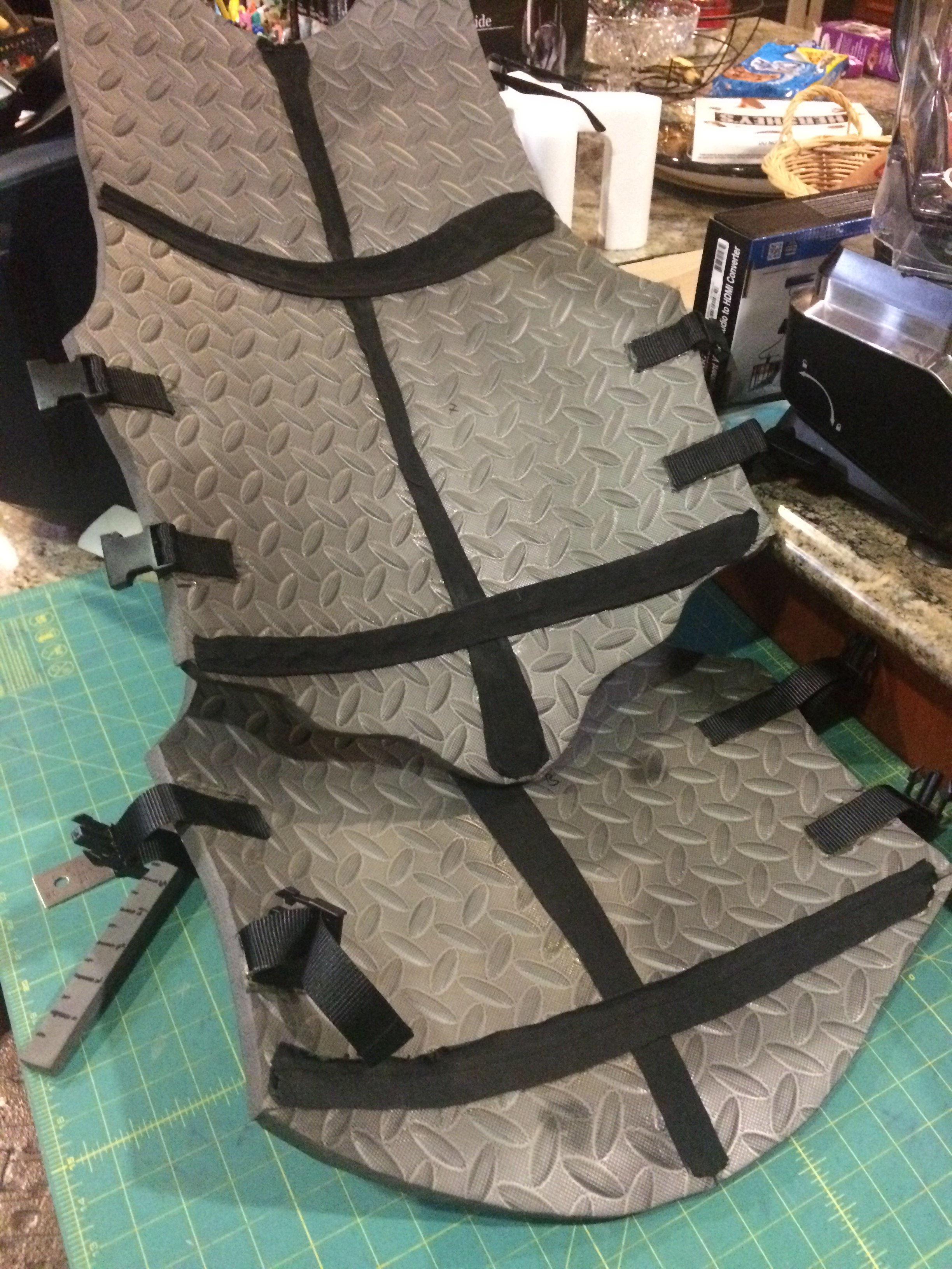

Here is a view of the back of my chest/back plates, showing the strapping of the armor and then cloth reinforcement to protect the seams. And the photo imediatly following it is a shot of my gorget and the shoulder lames getting put together.

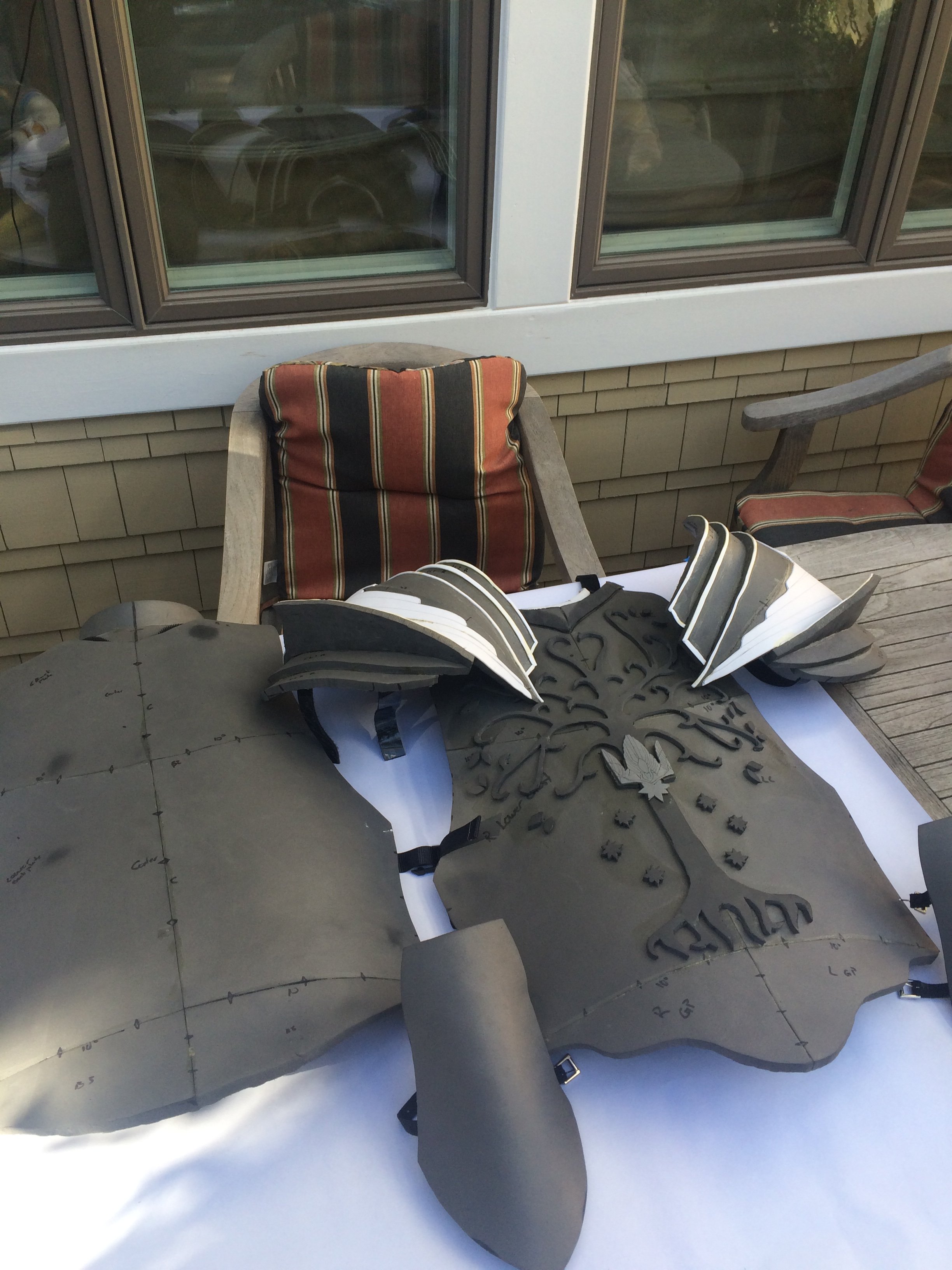

Here I have shots of the armor layout prior to painting followed by the painting process and the various sealing passes.
In these shots I have started adding the rivets to the armor before it gets its final pass of sealer

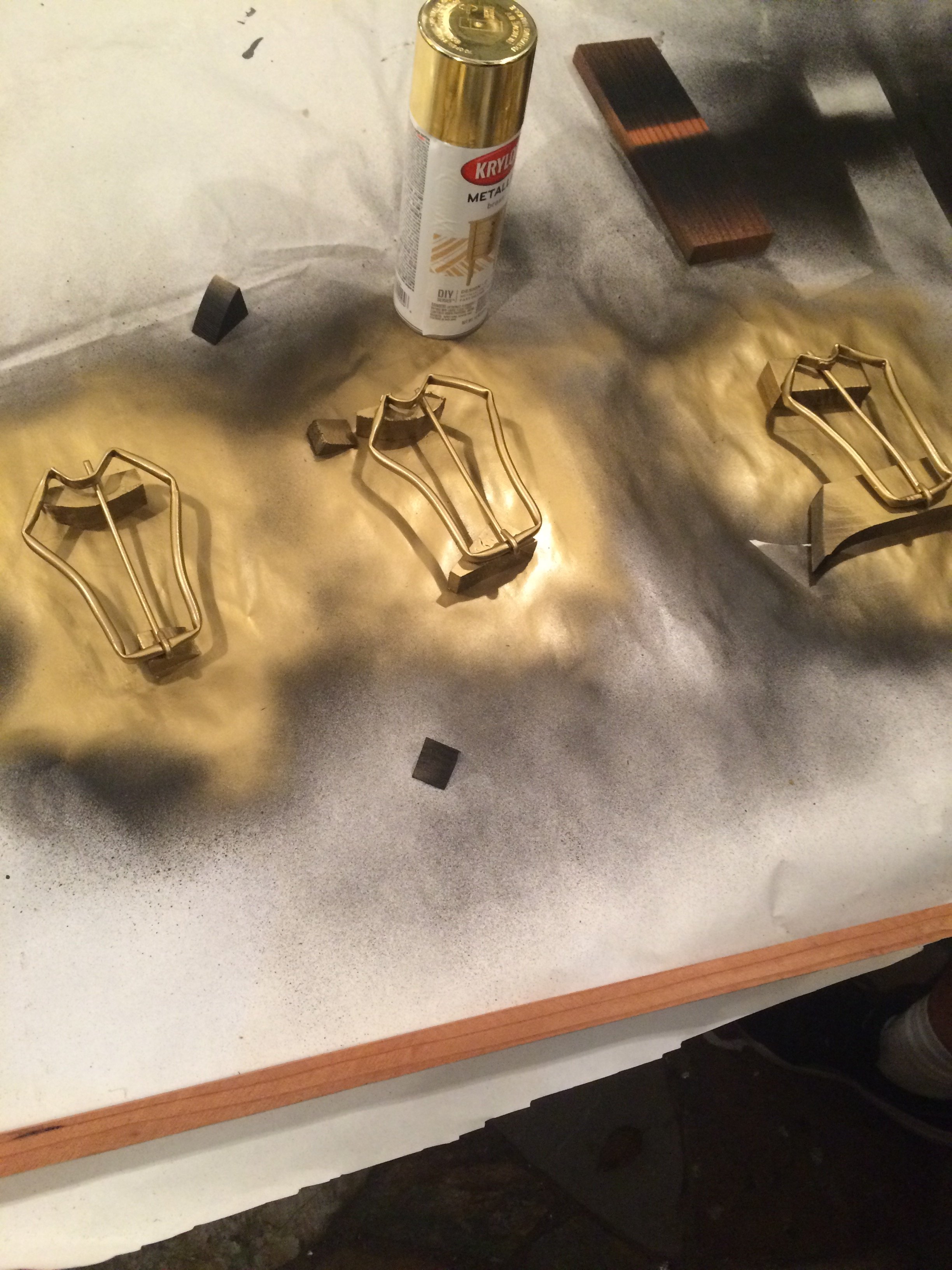

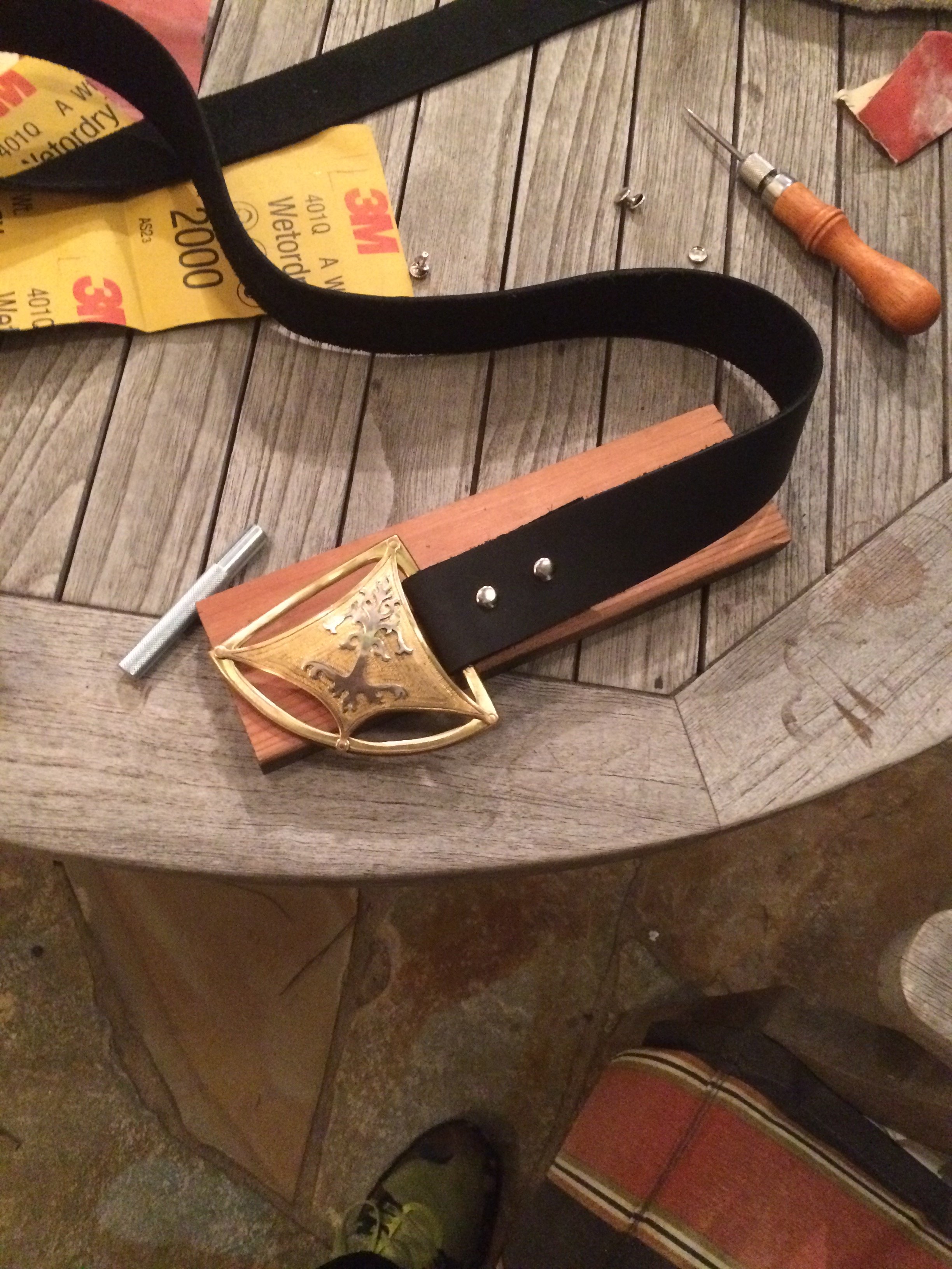

In this post I will cover my creation of the belt.

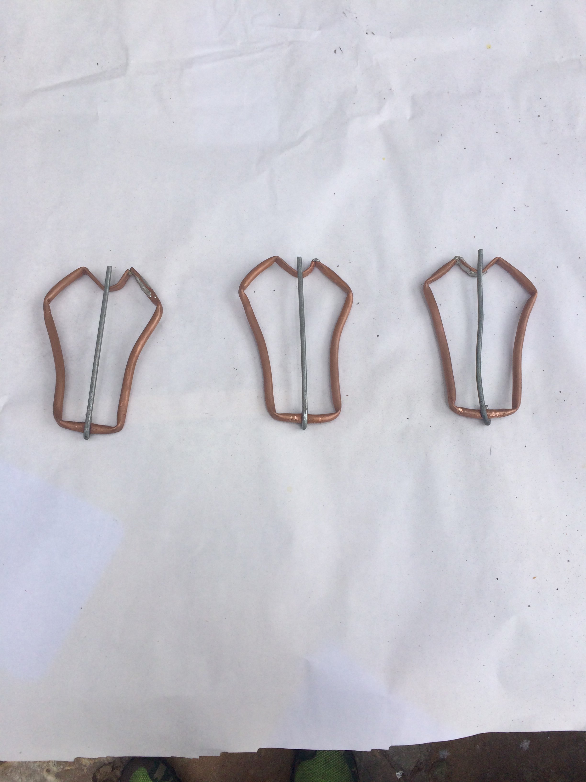

For the buckles I went out and bought some copper piping and bent it to shape/soldered it with the help of one of my friends, I then bent some 9 gauge wire to make the tongue of the belt. I then coated the buckles in plasti-dip before then spraying it with brass spray paint.
For the belt I purchased a long strip of black leather and attached it with rivets to the two main buckles.

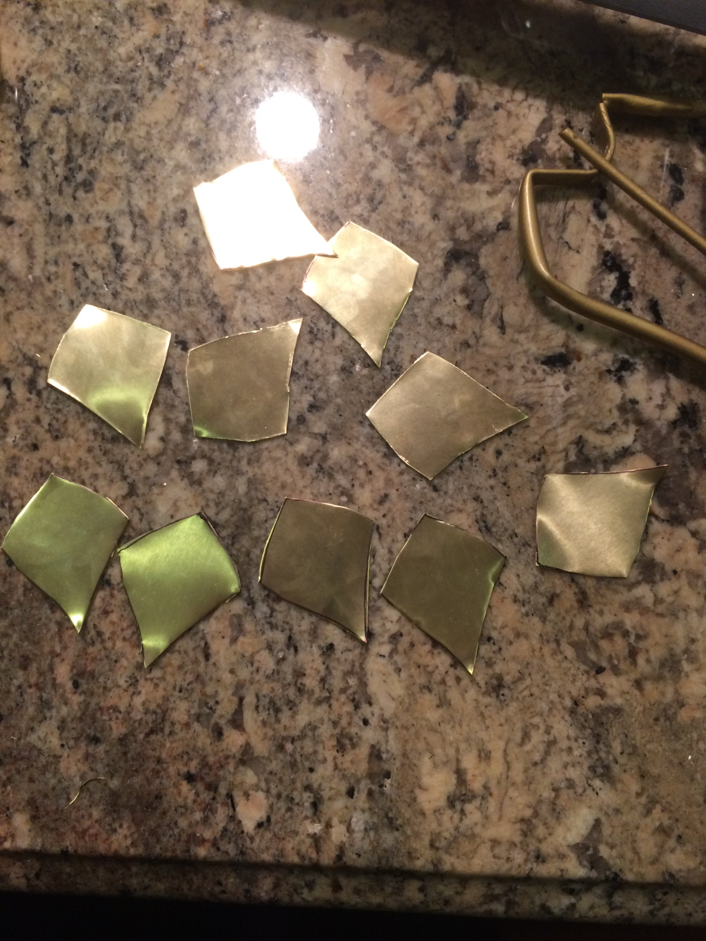

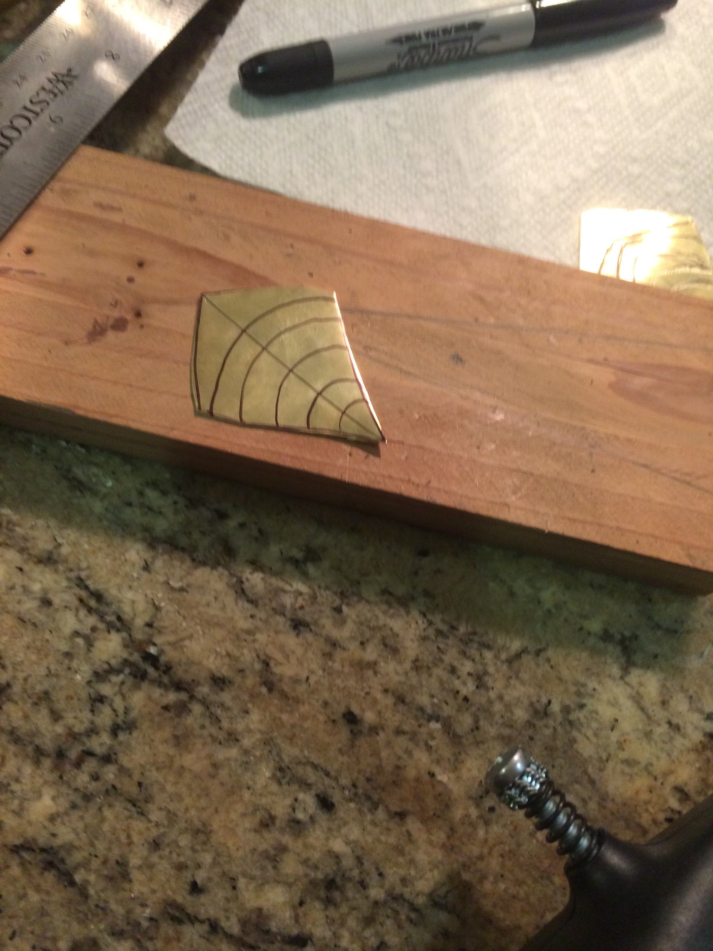

I then cut out by hand 10 belt ornaments that would go on either side of the belt from a sheet of brass, before hand engraving them and drilling holes into them (this was painstaking) Second photo shows the sharpie lines before I engraved it, as a sort of guide.

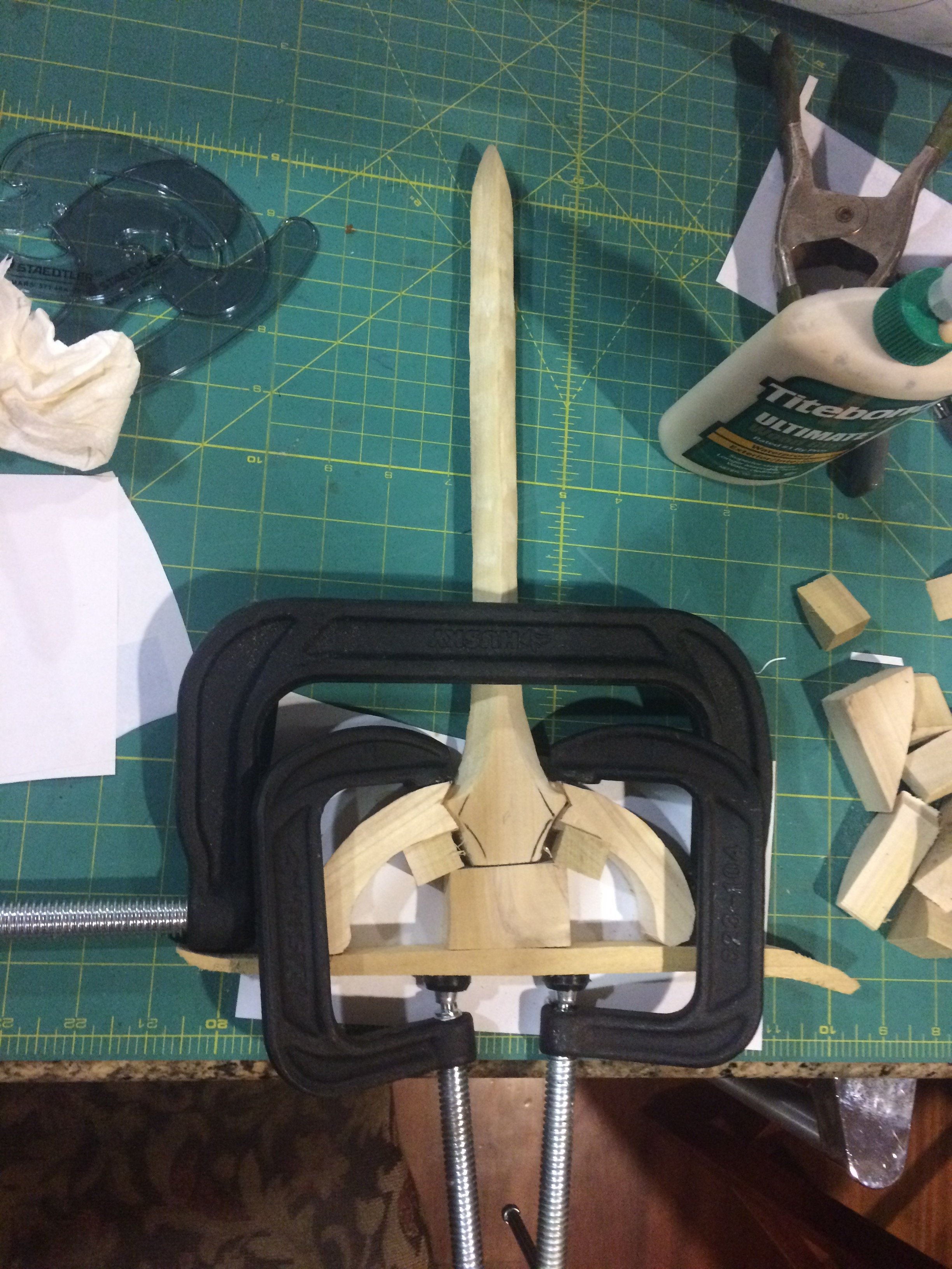

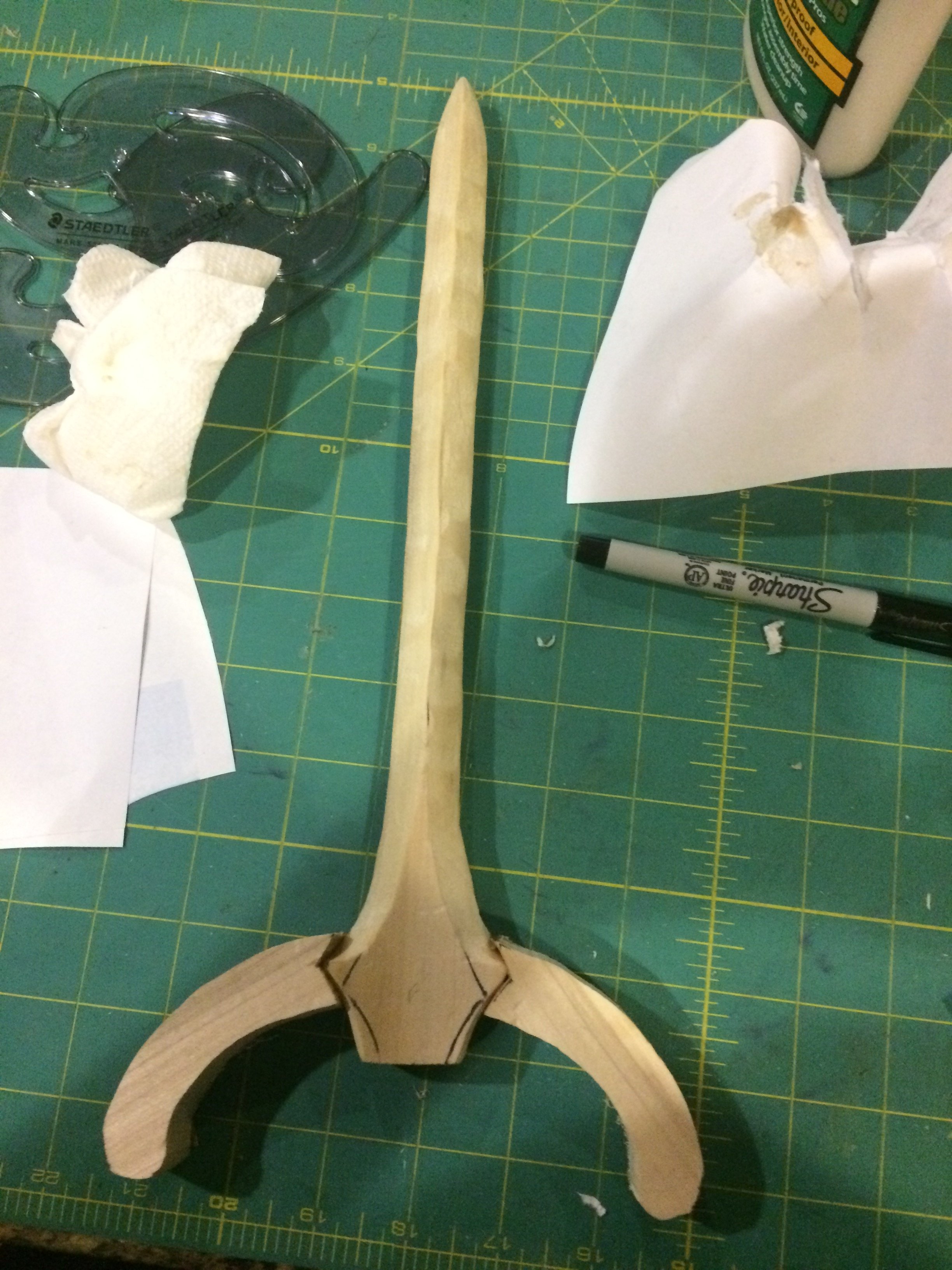

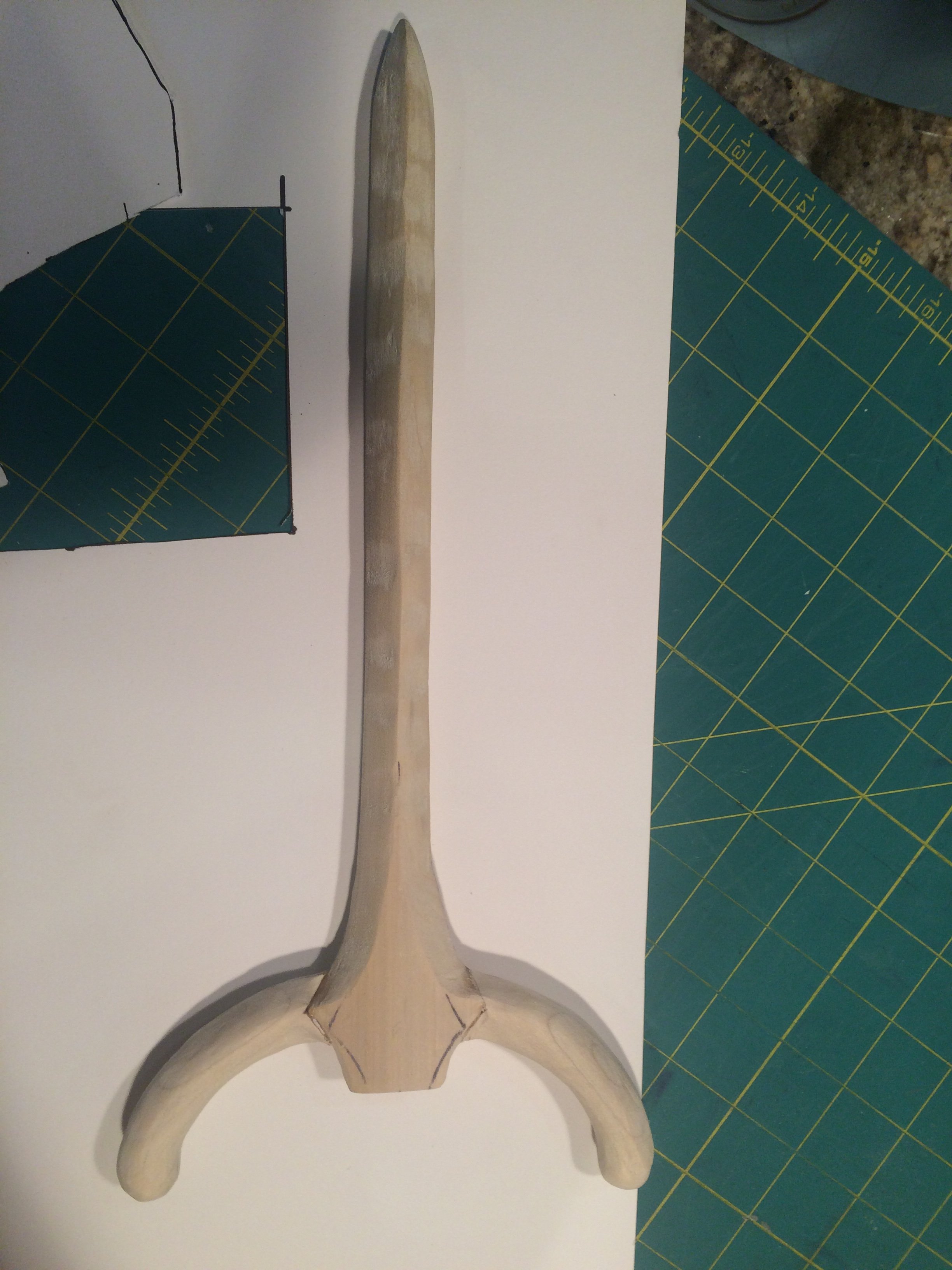

The making of the spear, So what I did was I drew out a spearhead on a block of wood and then cut it out with a bandsaw. I then shaped it with a Dremel, and sandpaper before cutting out and designing the half moon guard at the bottom.
I then painstakingly figured out a way to glue it to itself with various clamps, and after it was glued I used the Dremel to shape the guard on it, into a more round shape.
After that was completed I painted it along with my sword. There are no progress shots for the making of the shaft of the spear unfortunately but what I did was used ebony stain to stain a wooden dowel. I broke the spear down into 3 parts to make it easier to travel with. There is a small detail you cannot see on the spearhead in these photos but for the Minas Tirith logo that goes on the spearhead, and to make the shape for that I used soldering wire. The second photo just shows a scale test to make sure that the spear was in fairly correct proportion, and so you can see it in its entirety.

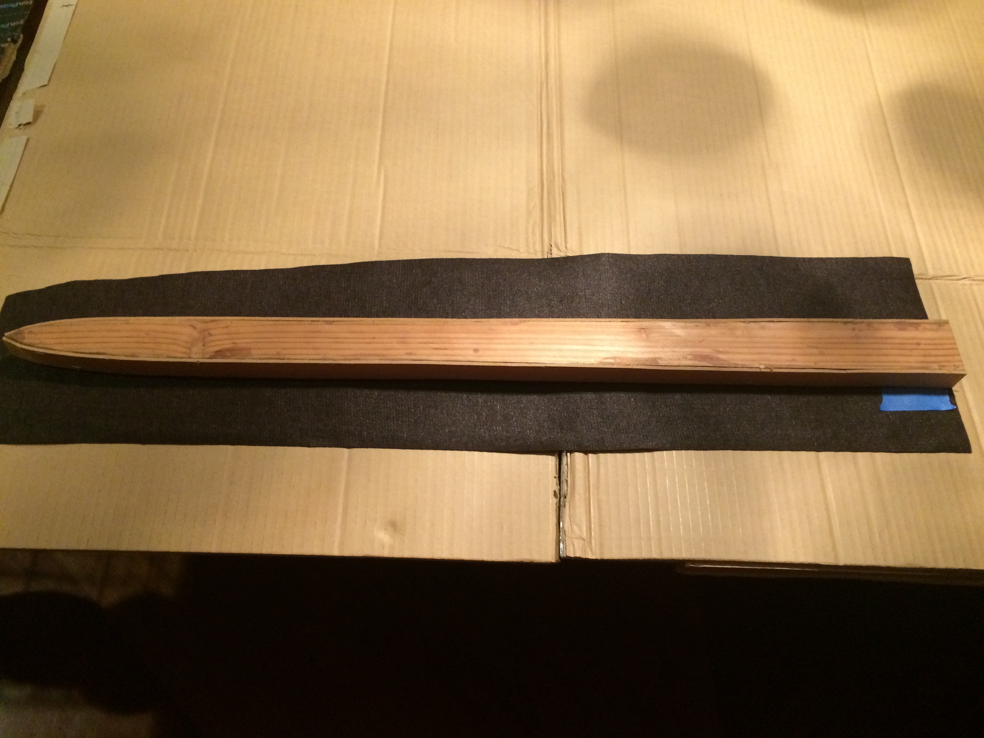

For the scabbard I took a piece of wood and split it down the middle, and glued felt on the inside as to no scrape my sword, I then glued the two pieces together with a bit of plywood on the side to give it the boxed shape. I then covered it in suede for that authentic leather look. I then added brass fittings on it which I do not have photos of either :/
