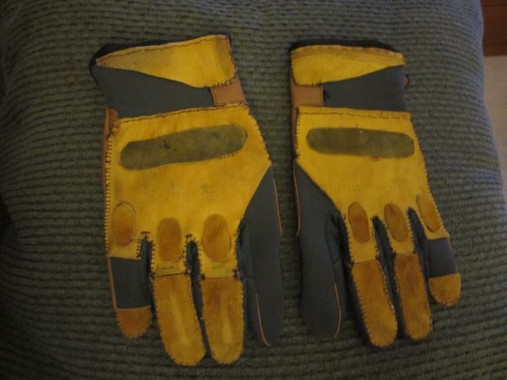

PM me and I'll show you what I did to get to this point. Mind you, I opted to hand stitch two sets of garden gloves after murduring one set of used glvoes (hence the stains and crap, but hey....space gloves, right? This took me two weeks and a lot of finger pain, LOL. I super glued the knuckle armor bits as well as that longer bit on the back and was surprised at how well it worked!

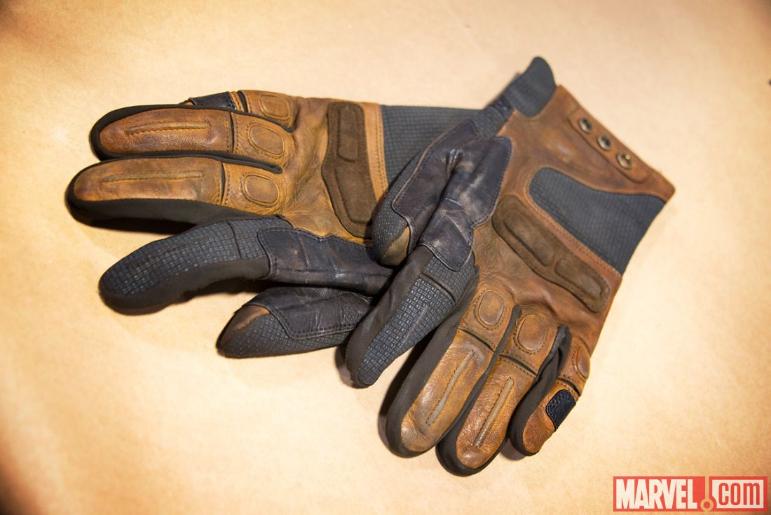

aaand the image that I *just now* found...
At the end of the day, this was the very first bit of replica costuming I have ever attempted, but I'm in the same boat as you...if someone finds the correct gloves, please....oh please....respond and I'll do the world a favor and return these garden gloves back to my yard work drawer in my garage, heh! :facepalm

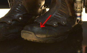

Ok guys, i was sitting here analysing the boots and were i'm going to start from, and i noticed that his boots have a steel tip lining under the leather on the front. Does anyone else concur?
Could be, if its a lining i wonder what type as it seems to have an aluminum finish look. If i can find a material like that, that would save me time in hammering out a peace of aluminum there in the front.

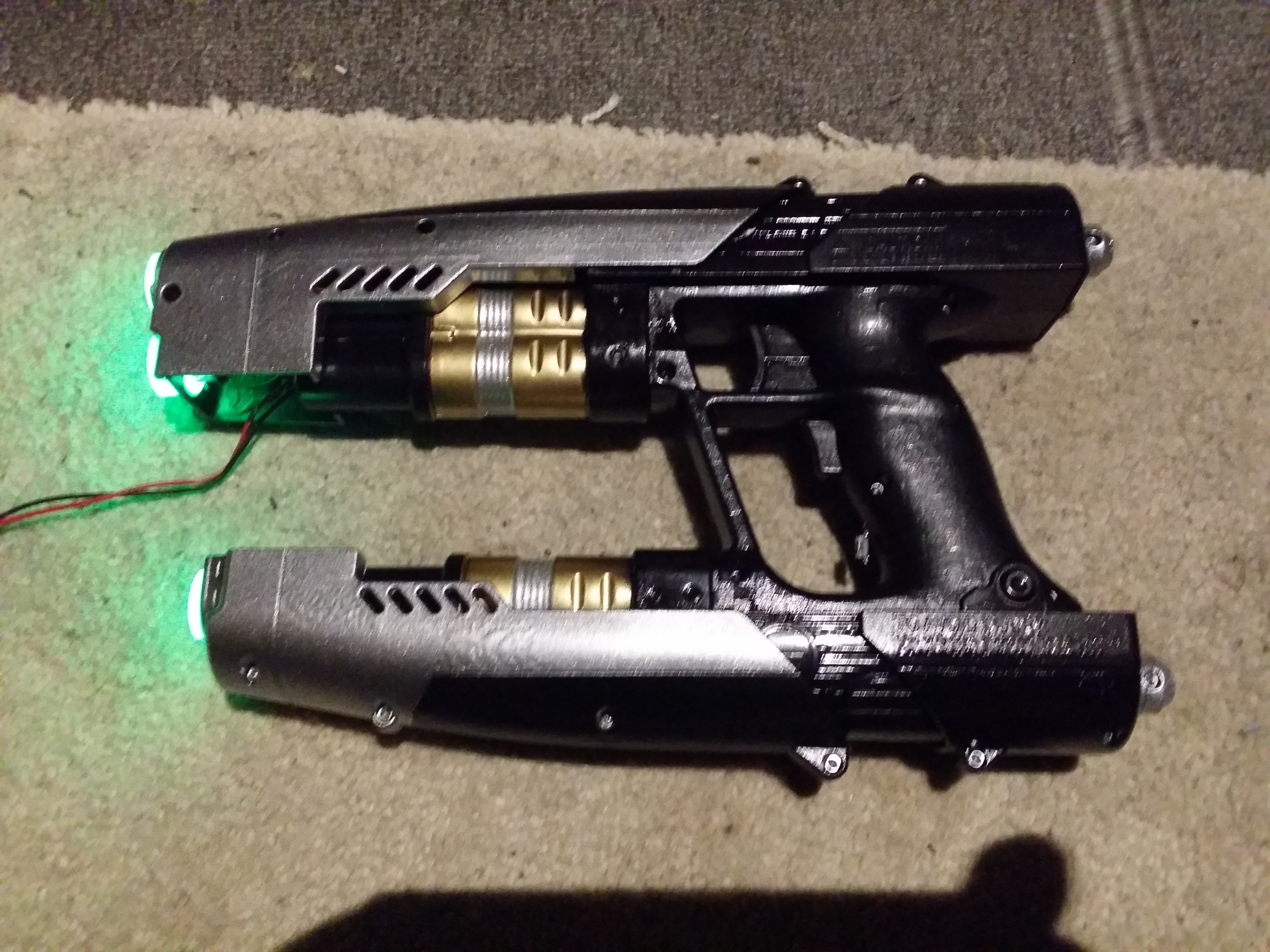

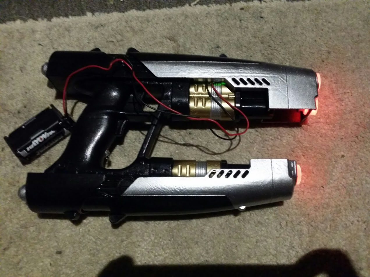

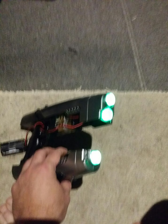

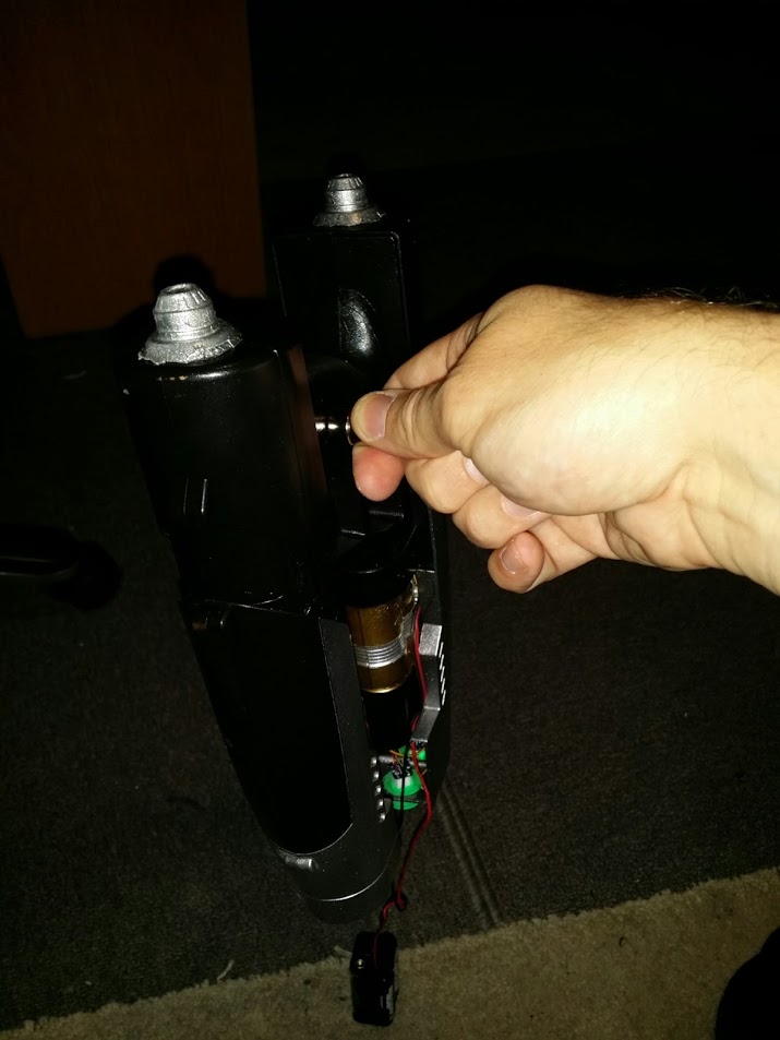

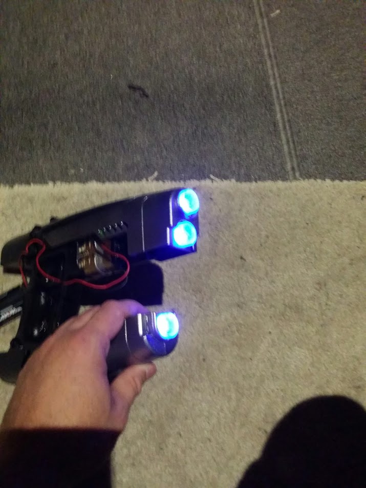

So I had a bit of time to work on this more....I posted these to my G+ already but.....
20140901_225025_Spring%u00252BValley%u00252BRd.jpg20140901_225134_Spring%u00252BValley%u00252BRd.jpg20140901_225119_Spring%u00252BValley%u00252BRd.jpg
I'm really quite stoked with this so far.....
A couple of things. Each barrel is actually just a Neopixel with a circular diffuser that has a concave cut into it to make it diffuse the light evenly 360 degrees.
It's controlled by a Arduino Trinket. There's a single button (located below the 2 original buttons from the Nerf gun) that has 3 functions currently:
1. (single button push) Fire (fires all 3 barrels at once, might add a mode to fire all 3 or fire each individually)
2. (double button push quickly) Cycle color (OFF, White, Blue, Red, Green, Yellow, Cyan, Purple)
3. (single press and hold for 2 seconds) Cycle brightness
What you can't see is that on the lower brightness settings, it actually 'shimmers', kinda giving it that pulsating look (I wanted to make it look like that). On the higher brightness levels it basically looks like it's fully on.
The coloring I'm quite pleased with. I would have liked to maybe make the silver parts be a bit less silvery, but I really didn't feel like taking the time to do it. If I had only put on a light coat of silver paint, it would have looked more 'used' like the movie guns.
Lastly, as you will notice in the 1 picture up above....yes, it is magnetic, and YES, it will hold quite well actually (I could almost get it to rotate 360 degrees and not lose grip.....). I can't wait to finish this gun and the other one.

Nice work with the lights. After watching GOTG a second time I noticed the lethal blasts come out of the top barrel and are a yellowish pulsing blast. When he just wants to stun them it's more of a purplish electrical blast out of the lower barrel.
Thanks, I'll have to go back and watch it again to try and get the coloring right, just for the sake of getting it right.

For just seeing that image you did a great job! I was thinking a combination of mechanix and military gloves but it looks like garden gloves fit the bill.
....huh? What? I did something right? AWESOME! Please post images, make and model number of what ever gloves you go with - I'd be totally interested in getting this right...and I mean RIGHT. (I'm a terrible perfectionist) :p
