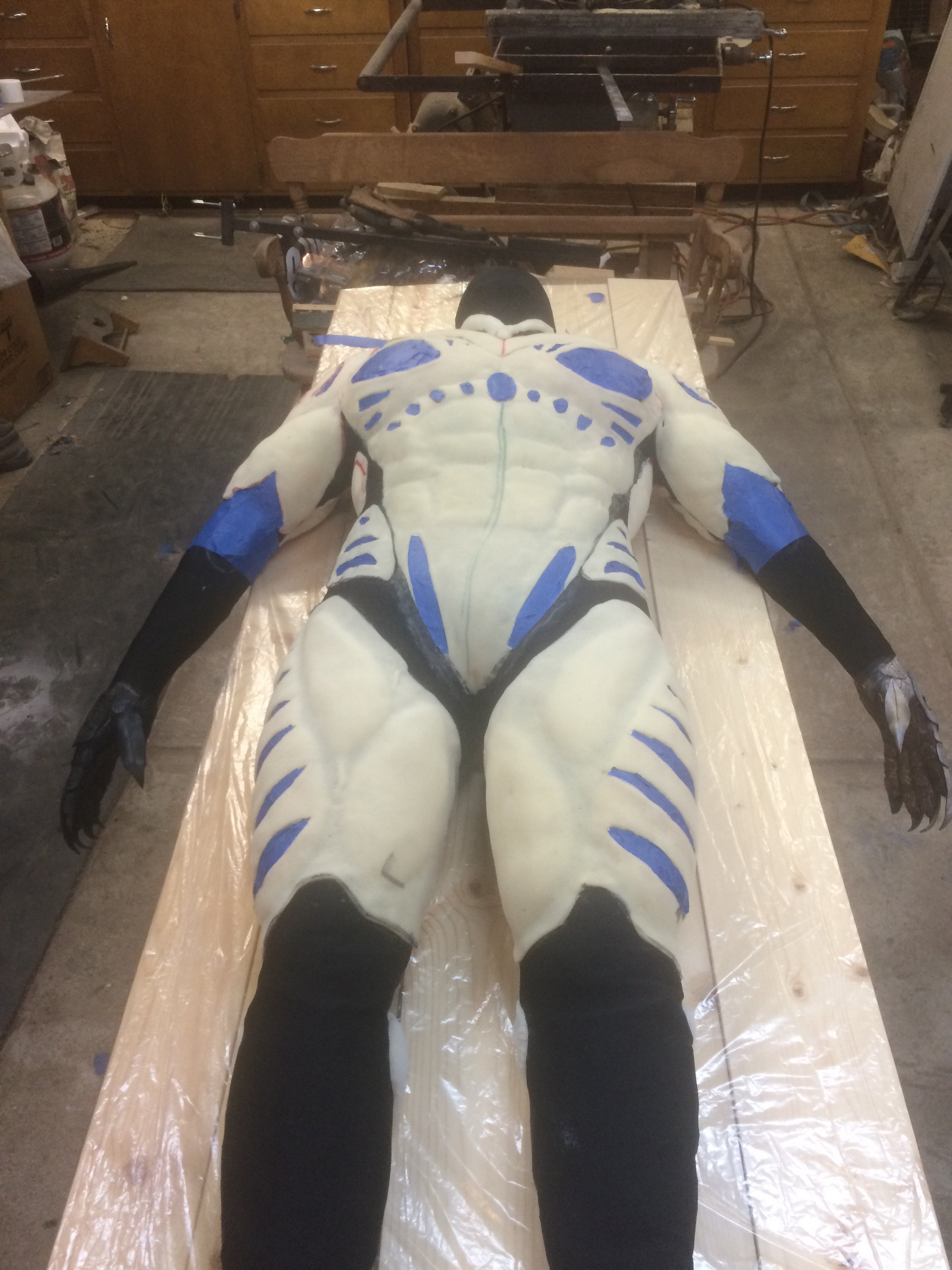

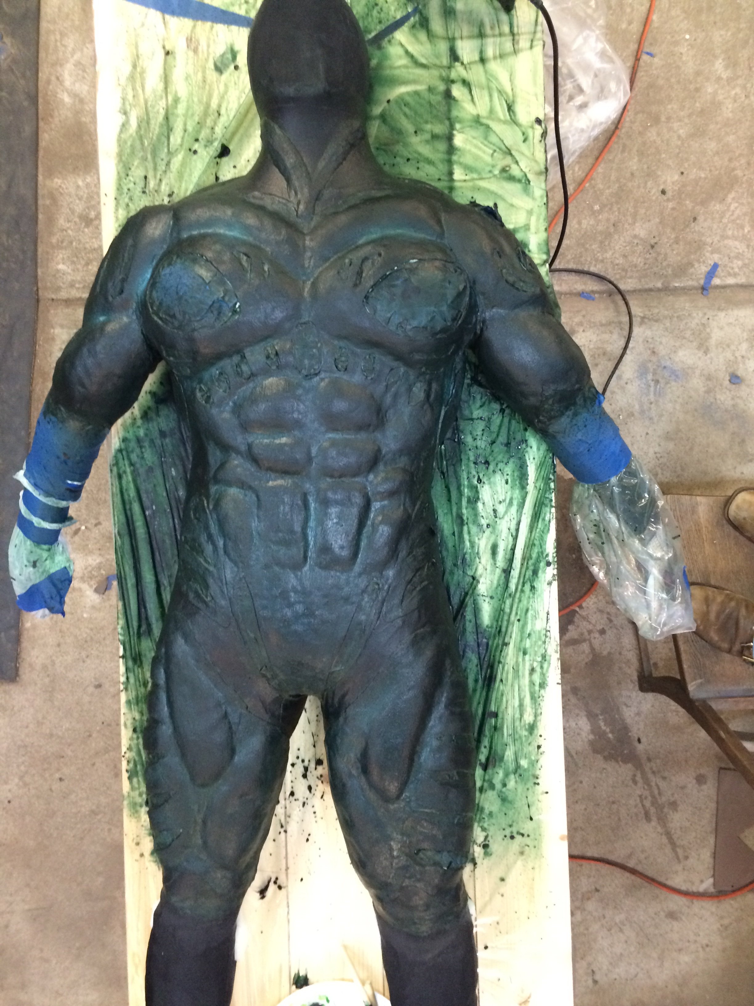

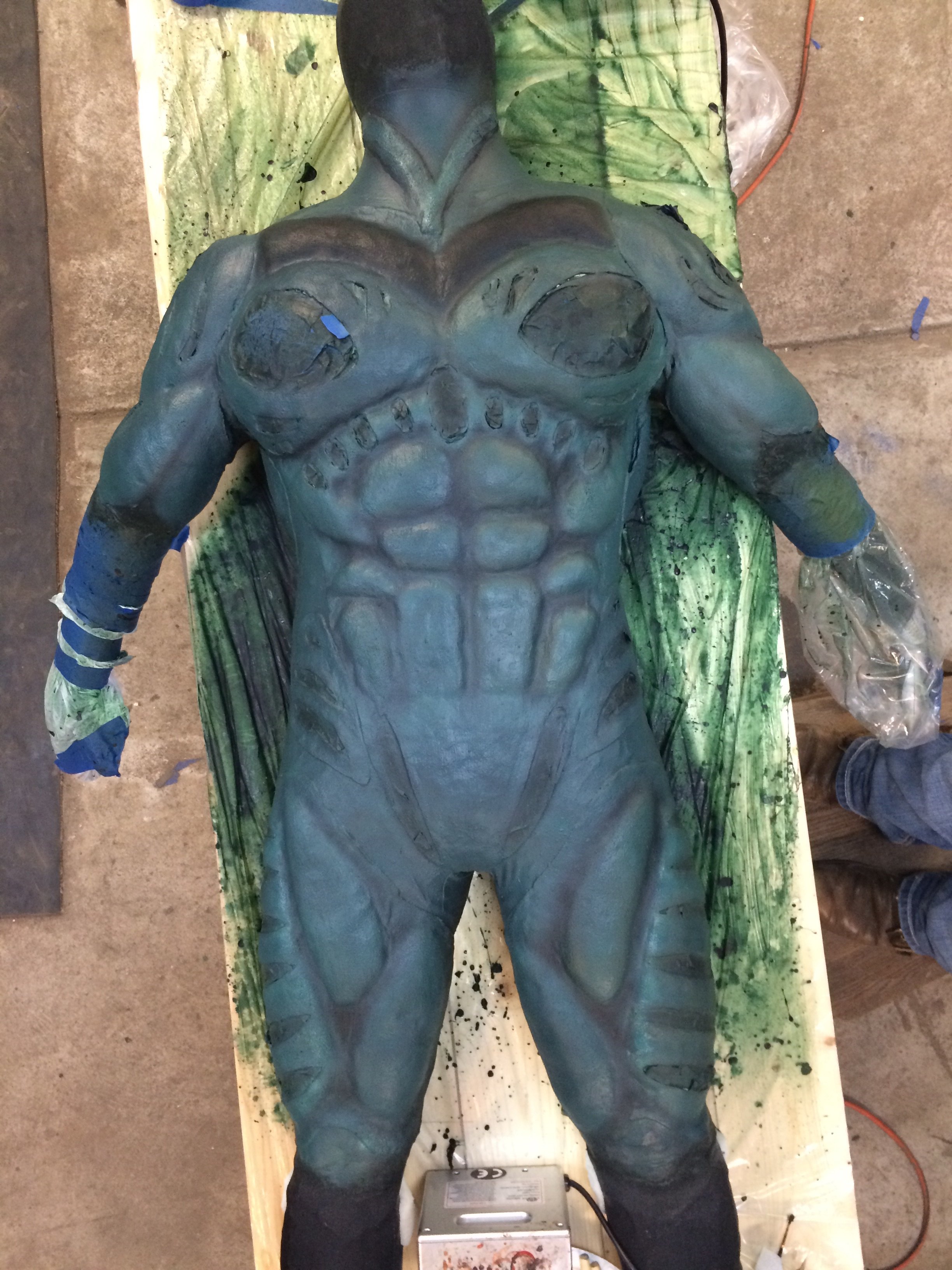

image.jpg2nd coat, im trying to do q green blue then the shading will be done with hunter green and black, I am using leather stain to pigment the latex and it is working fine

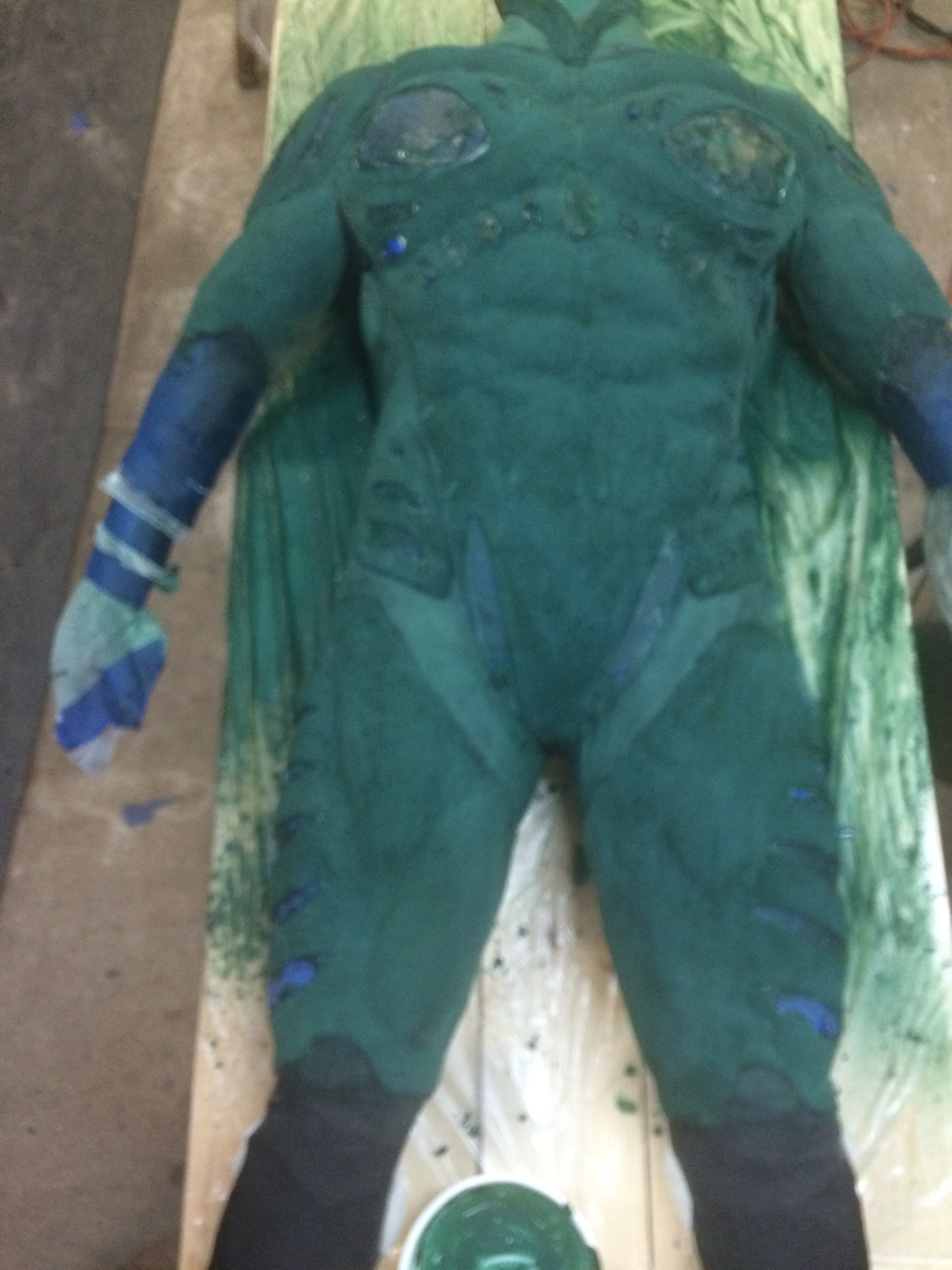

I havent fully decided, image.jpg im lighting the color because I want to go back with an air brush and add the hunter greens and the black to bring out the muscles again
This will dry darker , it's weird to judge the color of the latex, I haven't messed with it since I did a life cast and a fully sculpted batman begins

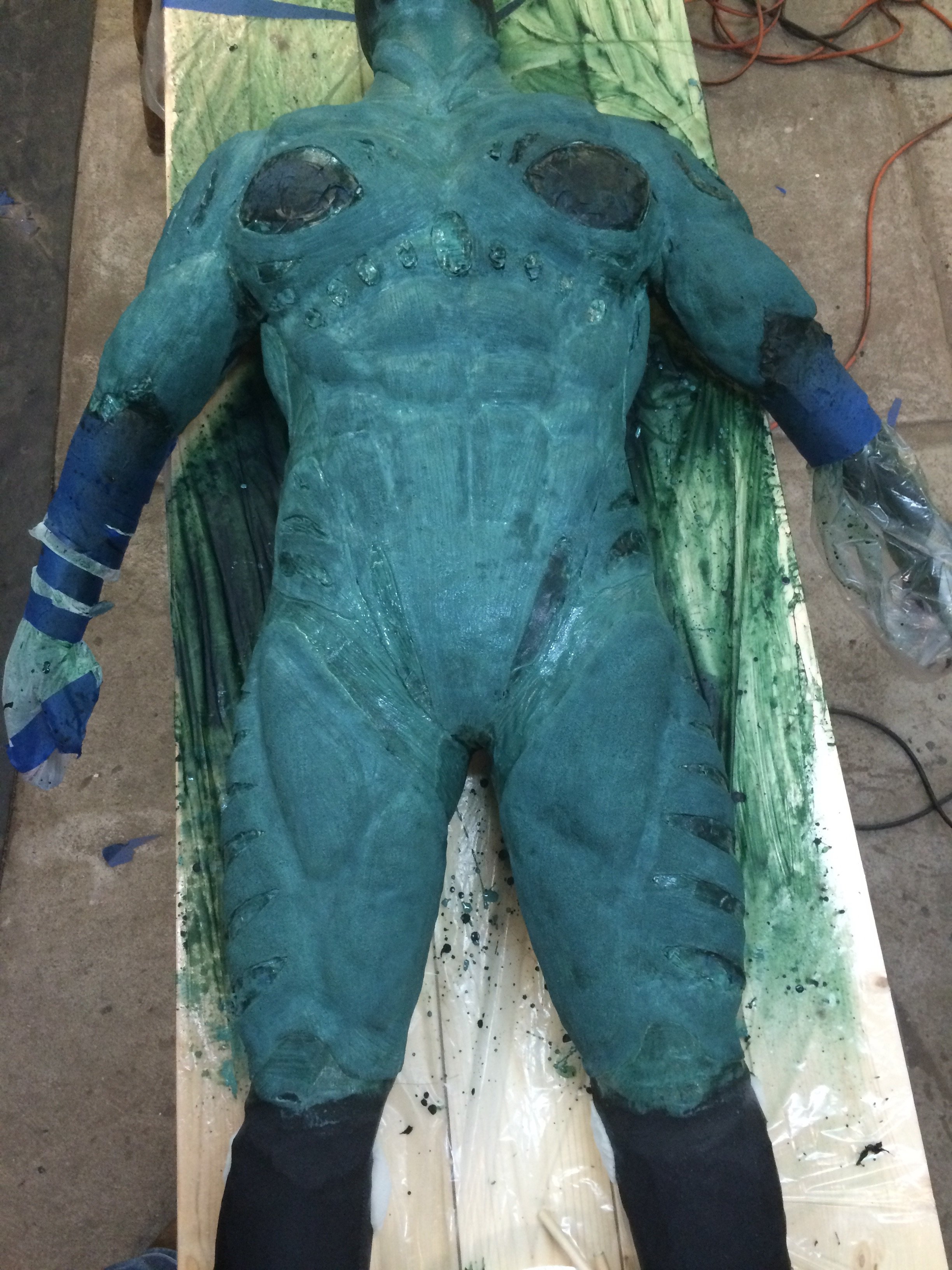

2" uplstry foam, 1" uplstry foam, 1/8" uplstry foam to skin other foam, morphsuit, Barge contact adheasive, cheap razor knifes to shape foam and 1 gallon of liquid latex from the monster makers, and im using randy leather stain to tent the latex, then im going to be painting the whole thing with latex based air brush paint to lighten it up

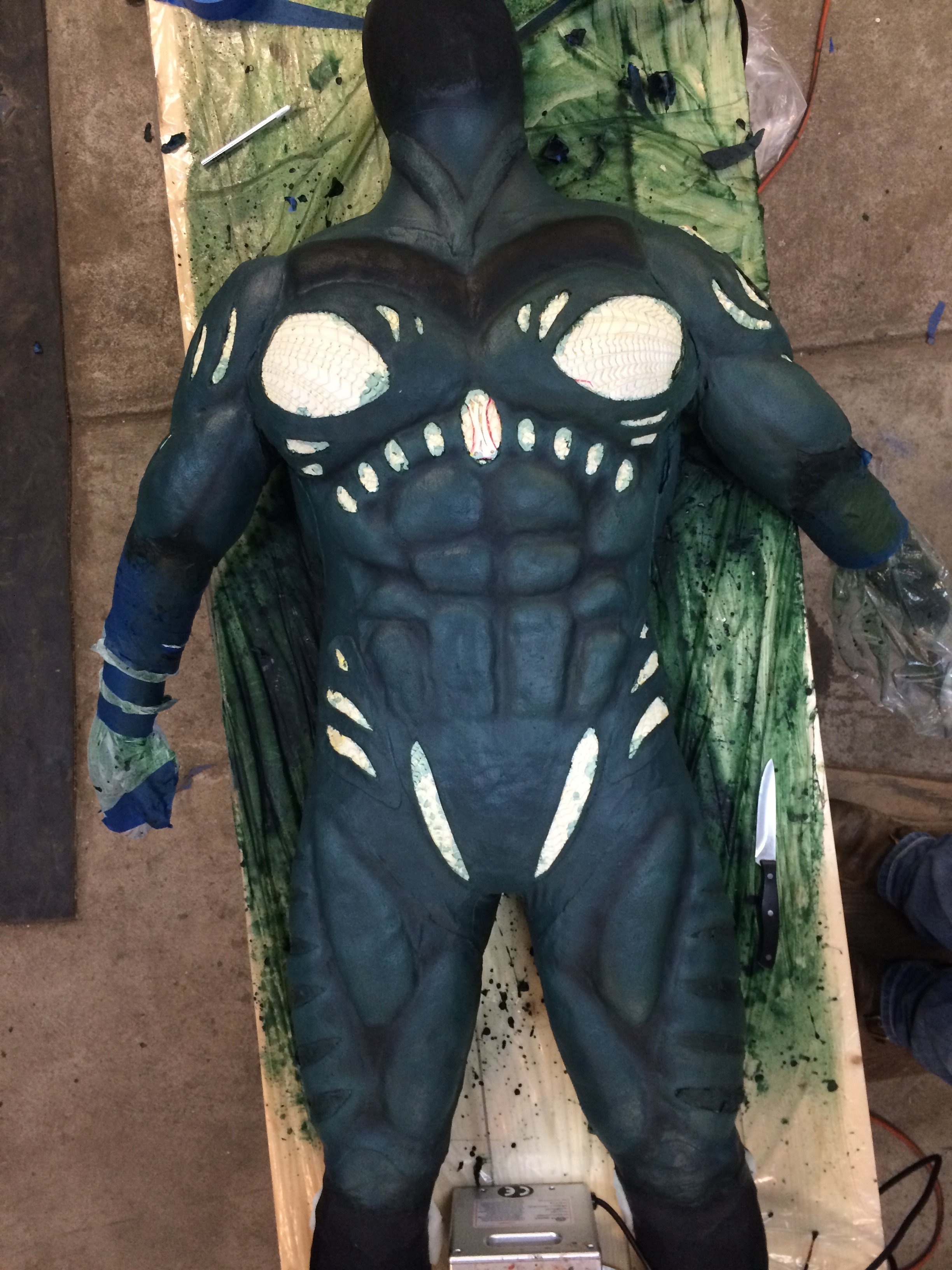

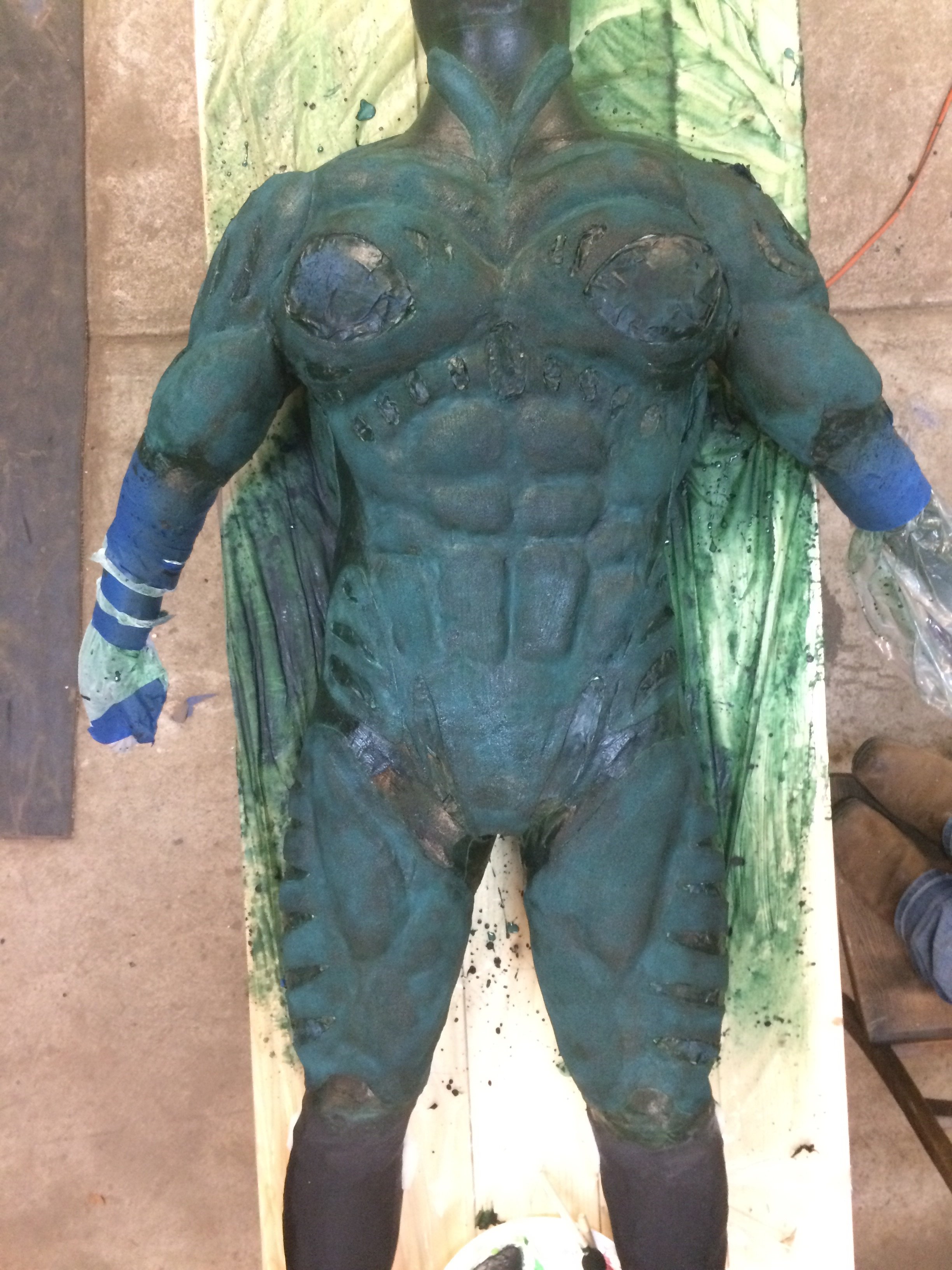

image.jpg I'm going to probably do one more coat and then I'll be using paints to lighten the farthest out points, for high lights then most it all with a dark to unify it
