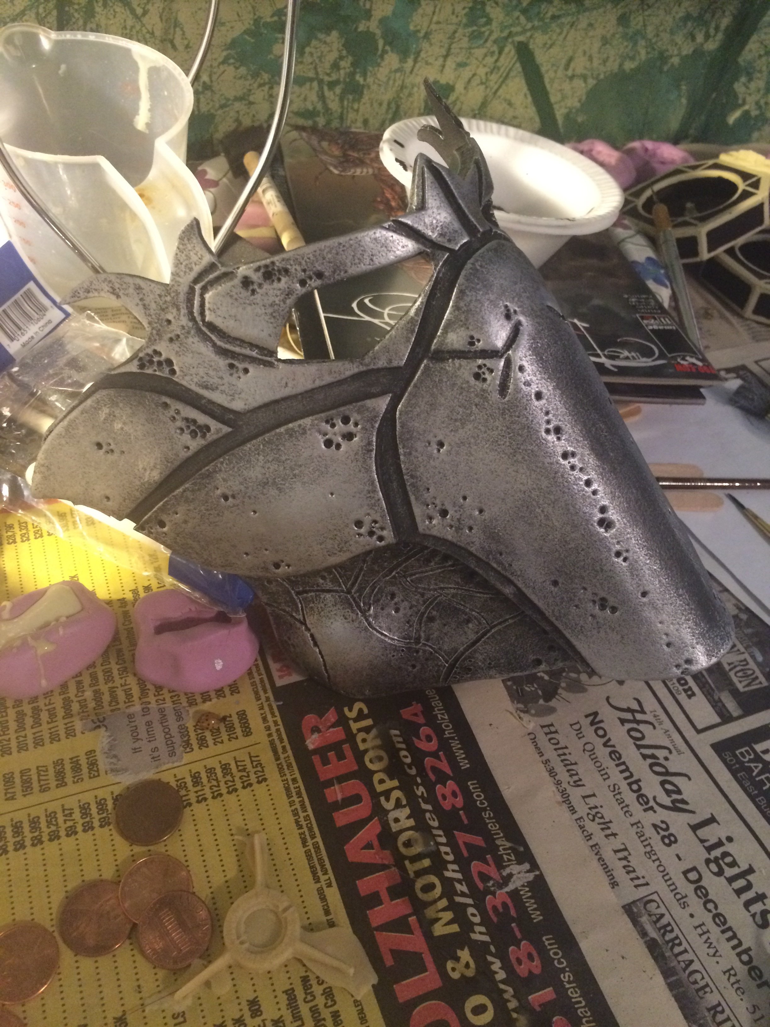

Trimmed the chin and first coat of dry brushing

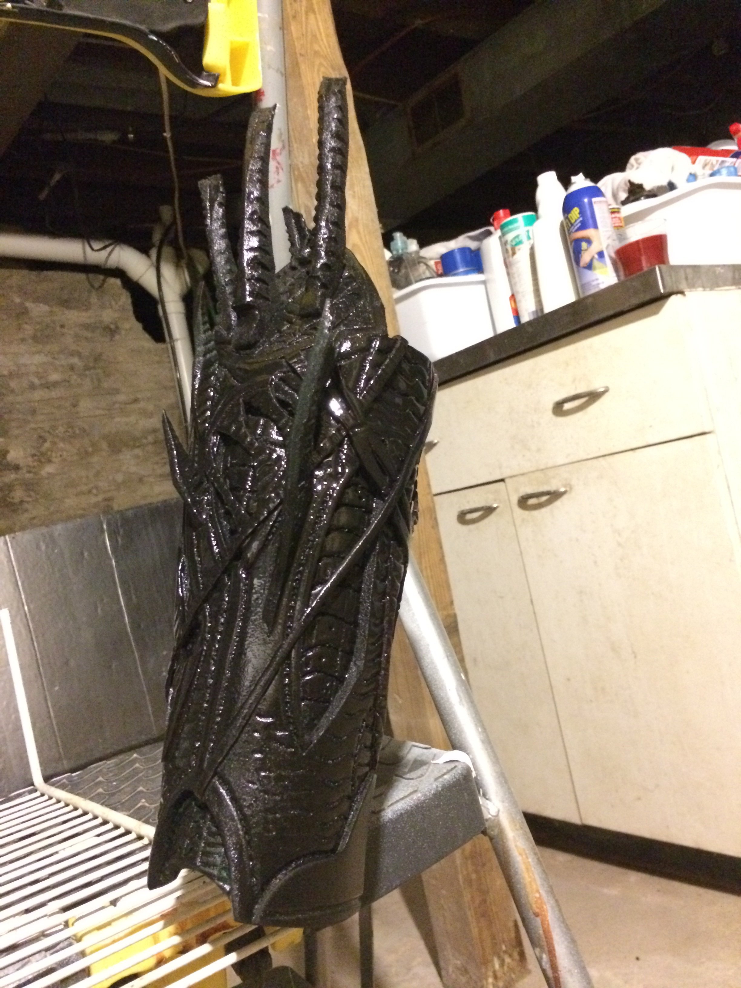

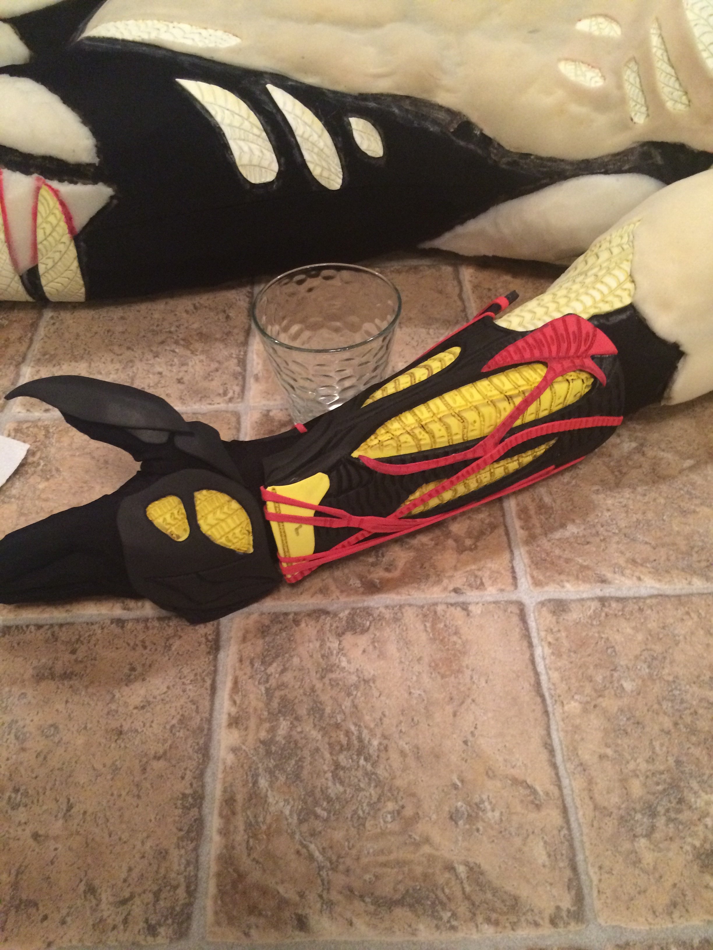

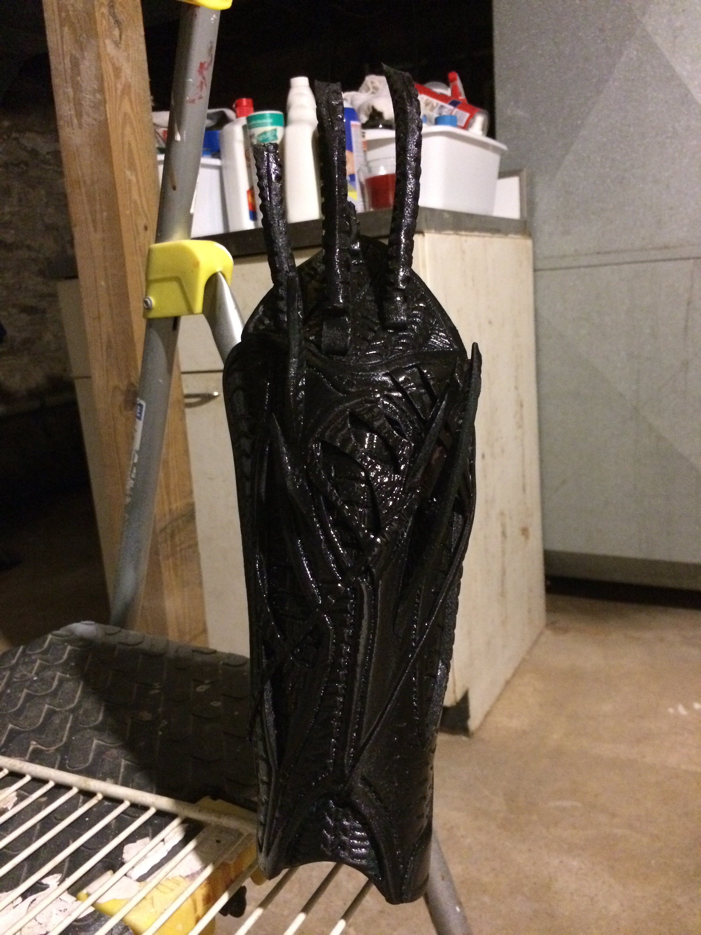

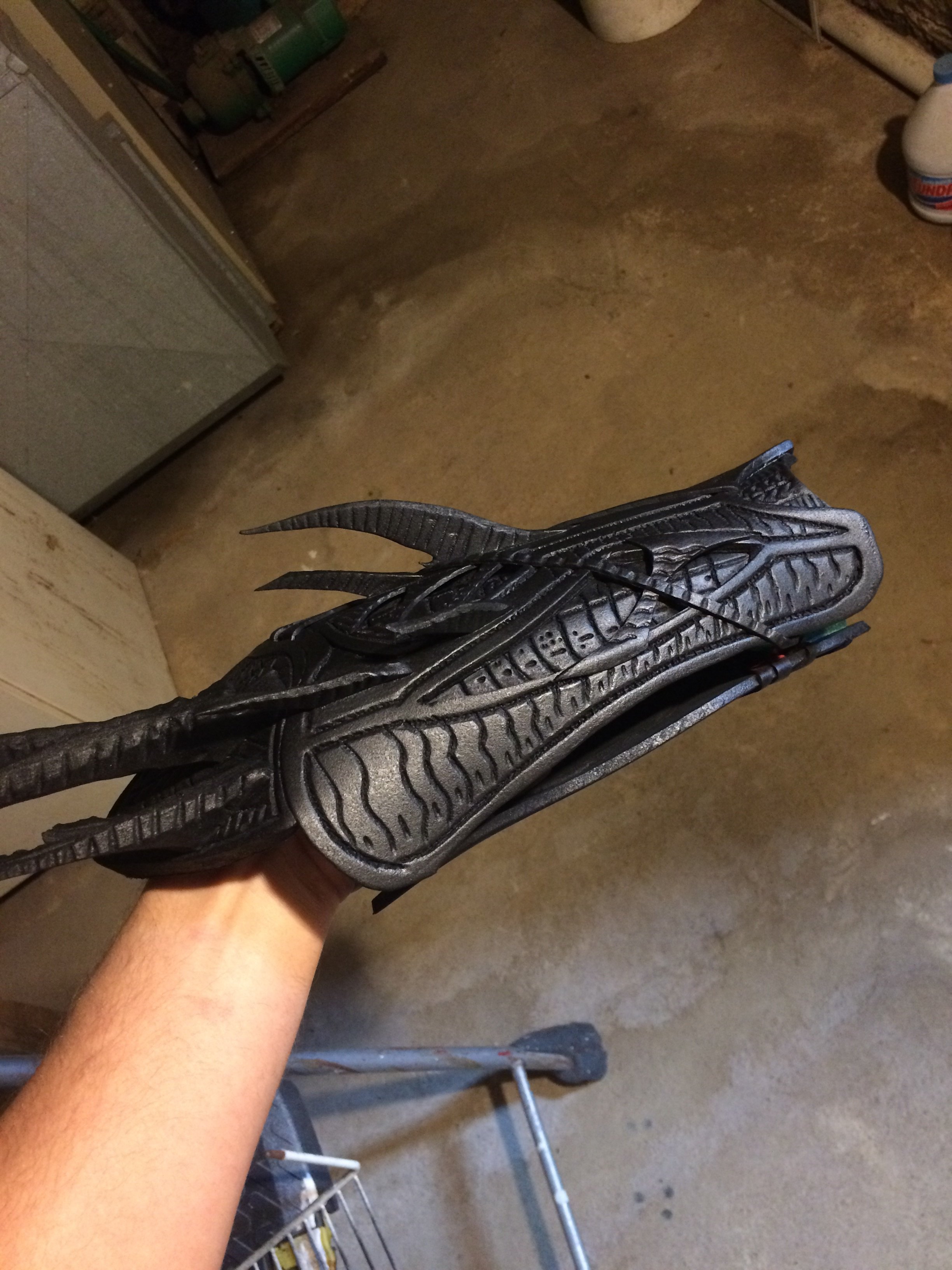

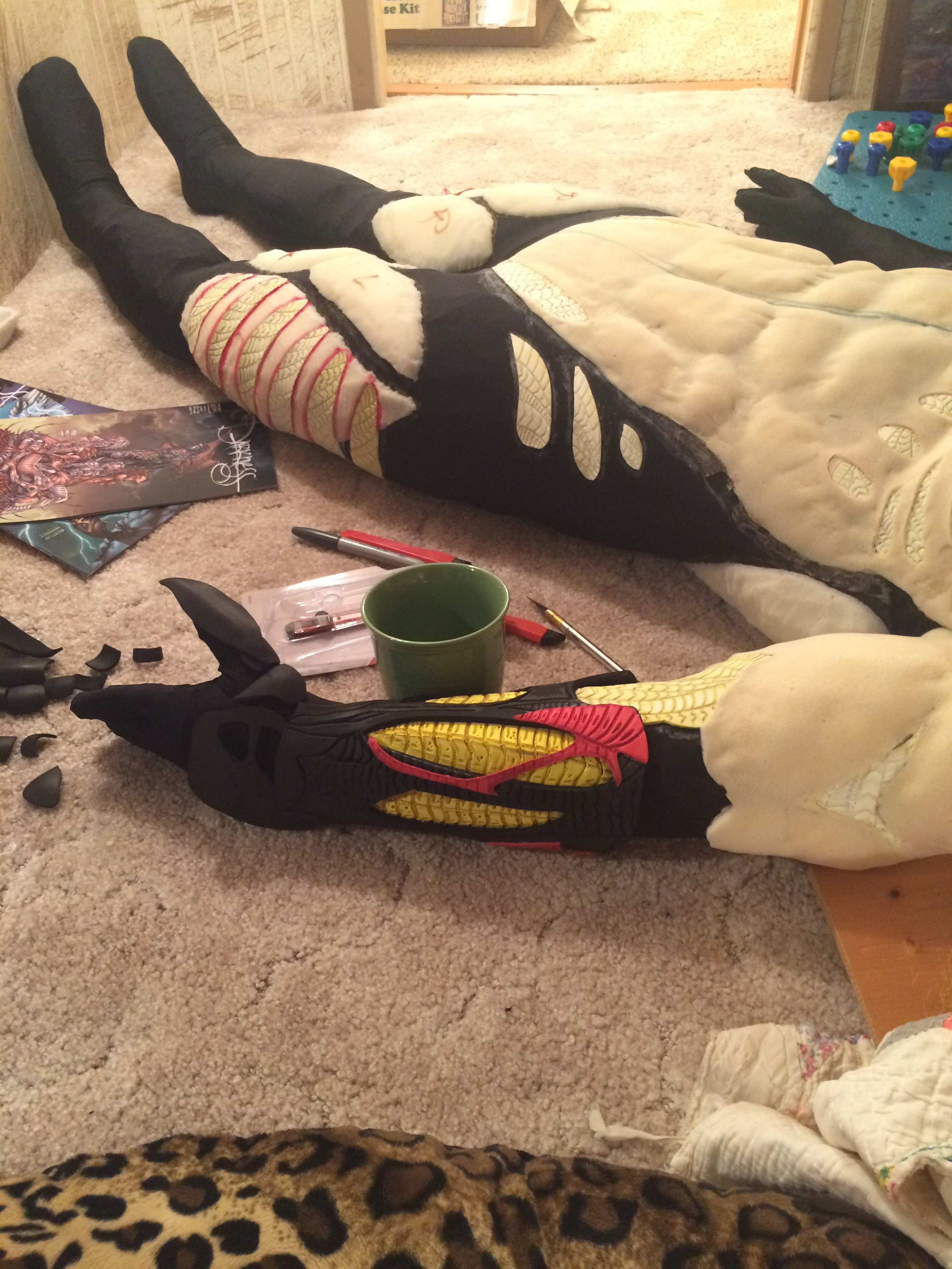

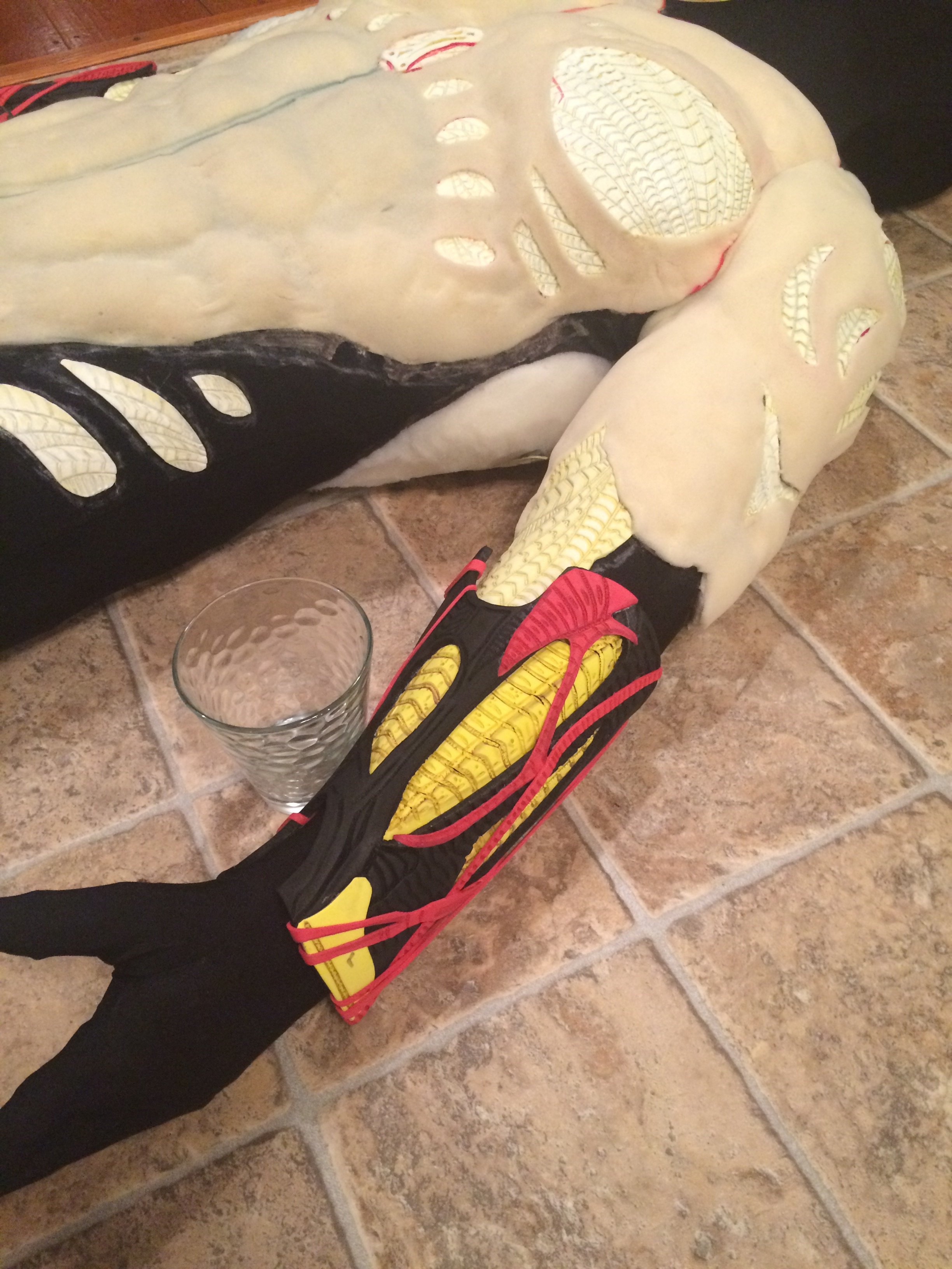

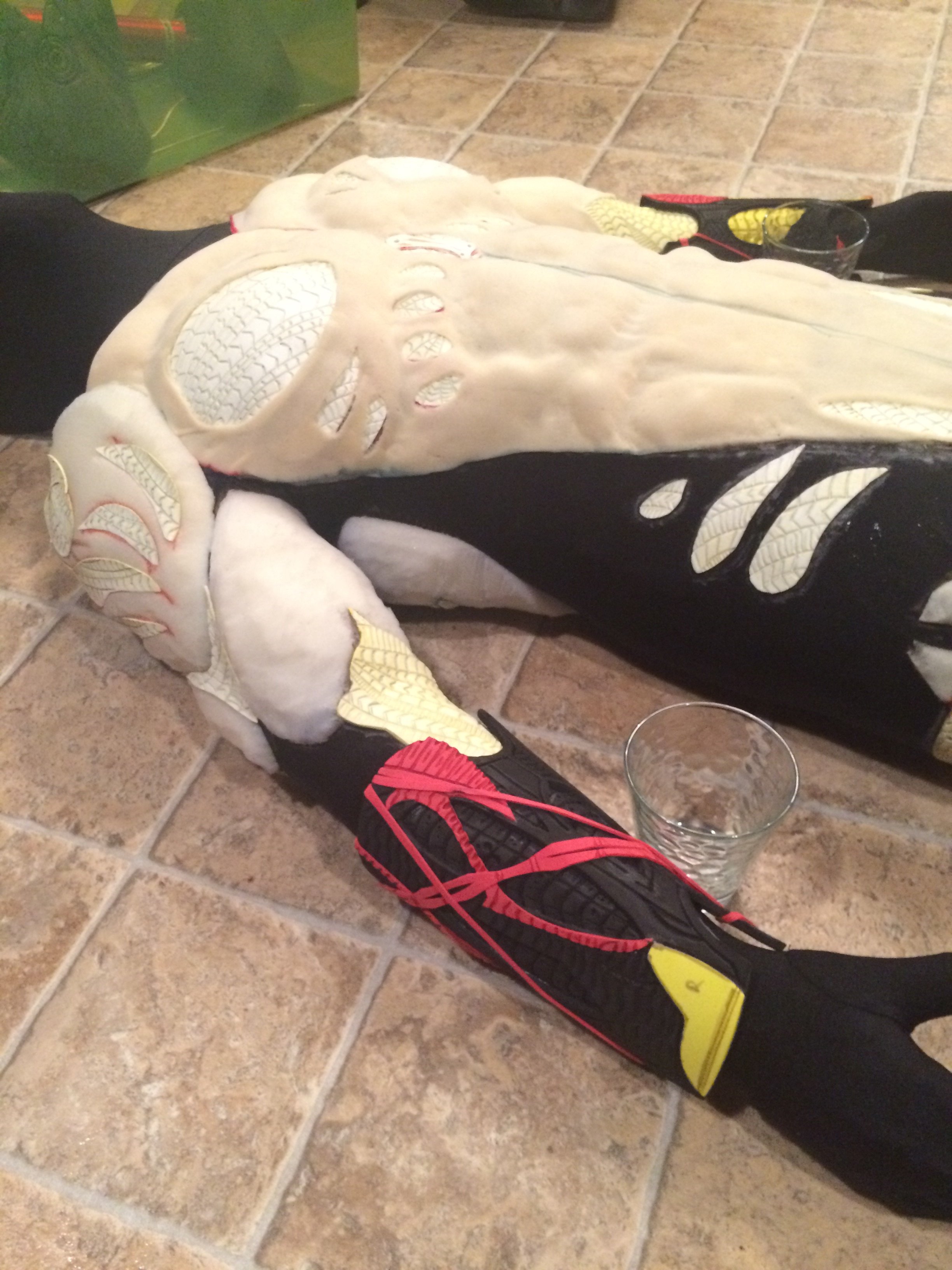

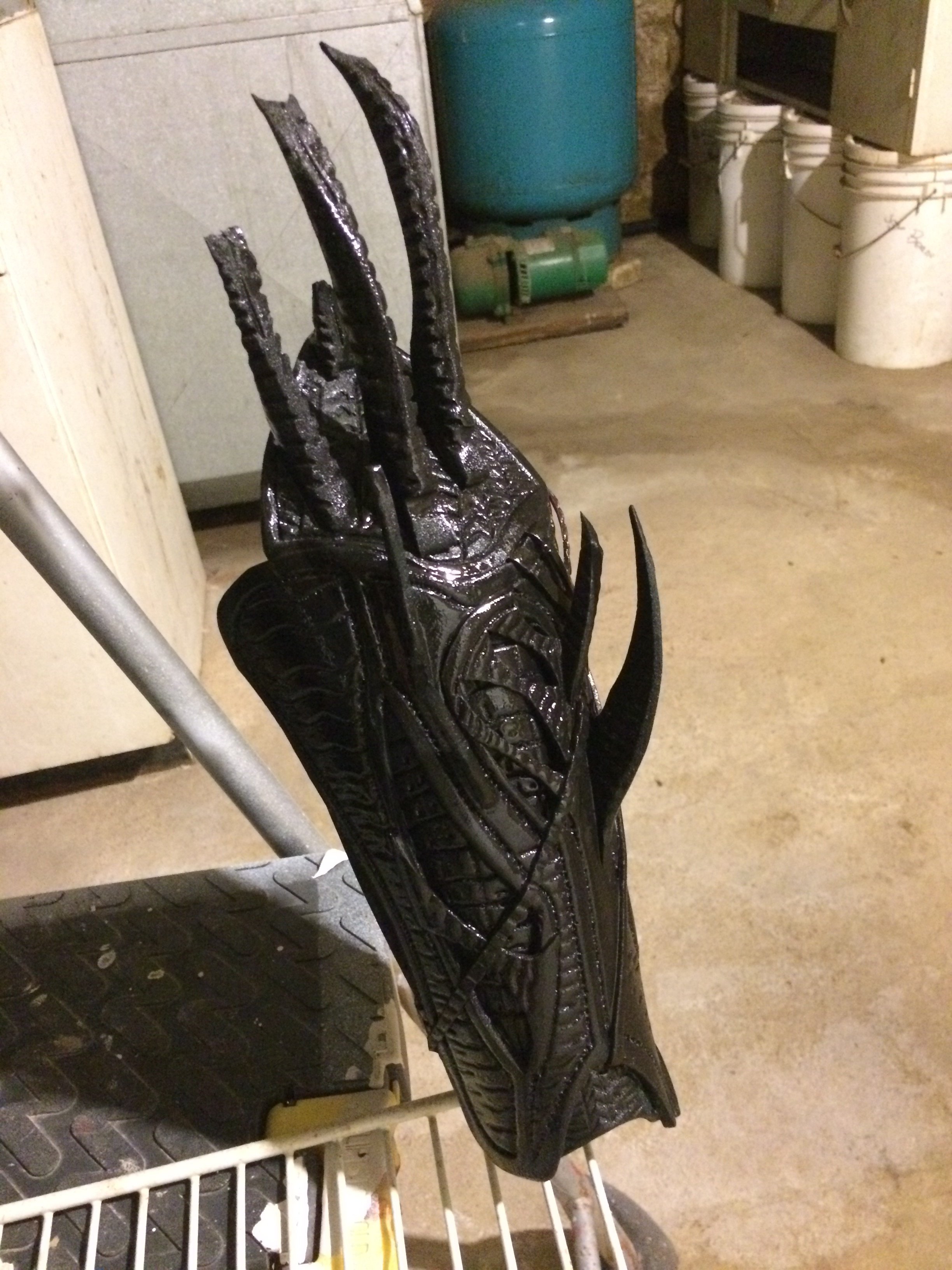

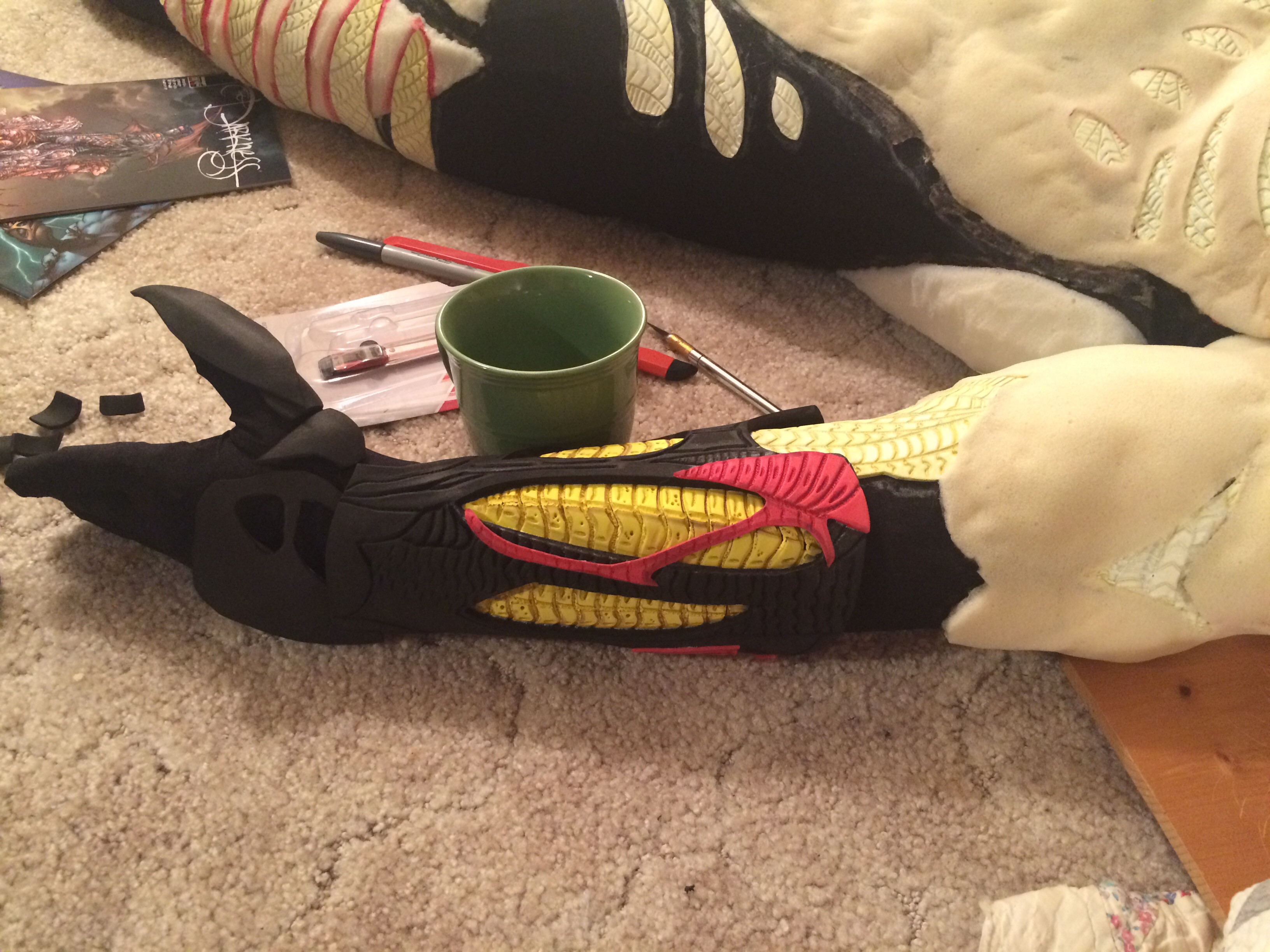

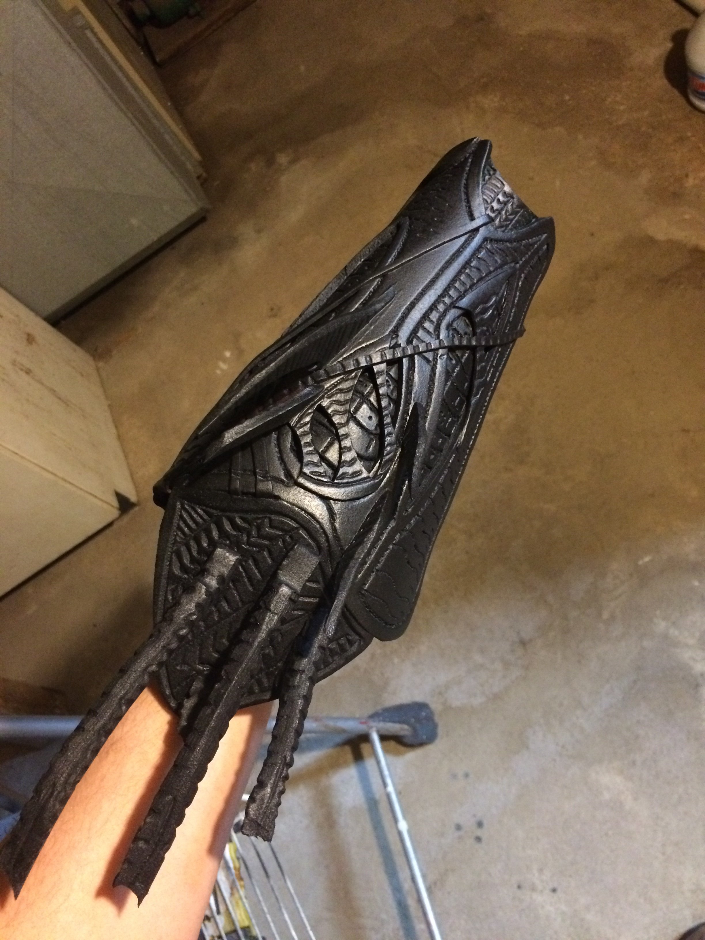

image.jpgimage.jpgimage.jpgimage.jpgimage.jpgimage.jpgimage.jpgimage.jpgI'm starting to lay out the arms and getting everything ready to move forward j have a dead line and it's coming up soon so trying to get it done. I have my latex coming in tomorrow so that's exciting
