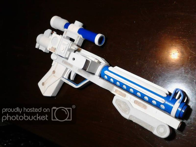

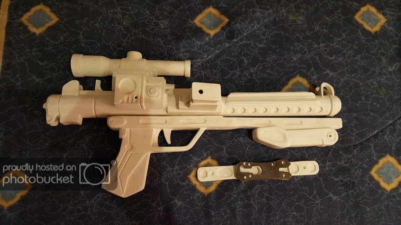

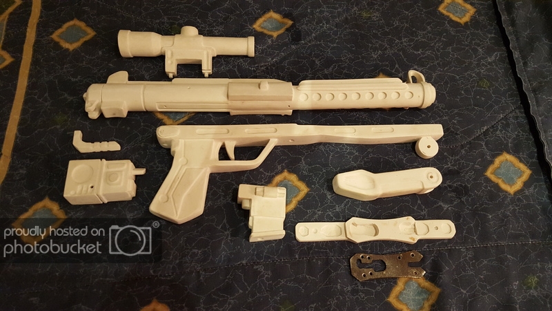

Finally have blasters on hand!
Anyway, the master was scratchbuilt by a friend of mine using wood, pvc, eva foam.
A mold was made of the master, then cast in plaster to sharpen details, define casting lines etc. Then new molds were made and these are the first castings. Leg mount is made up of a solid resin main body with a mild steel bracket plate.

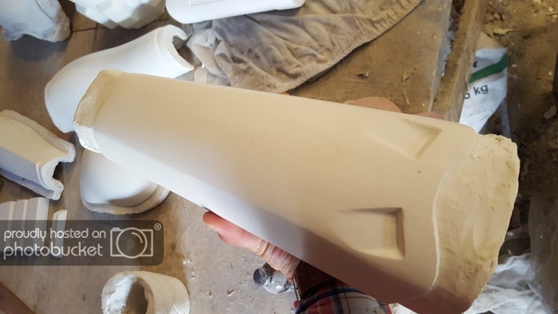

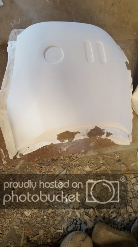

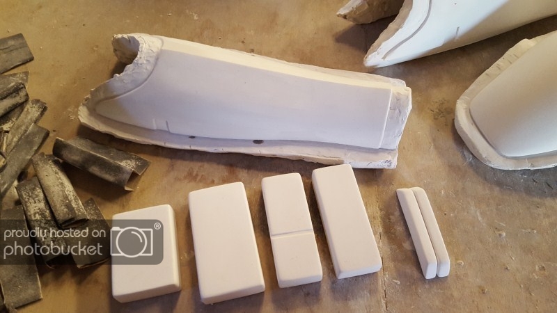

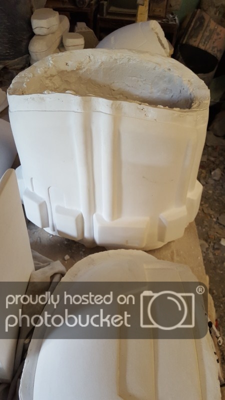

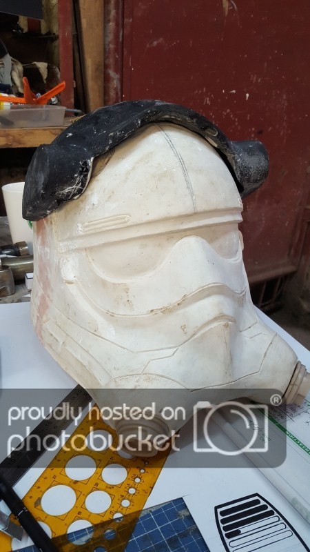

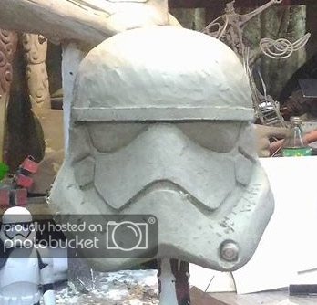

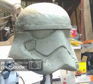

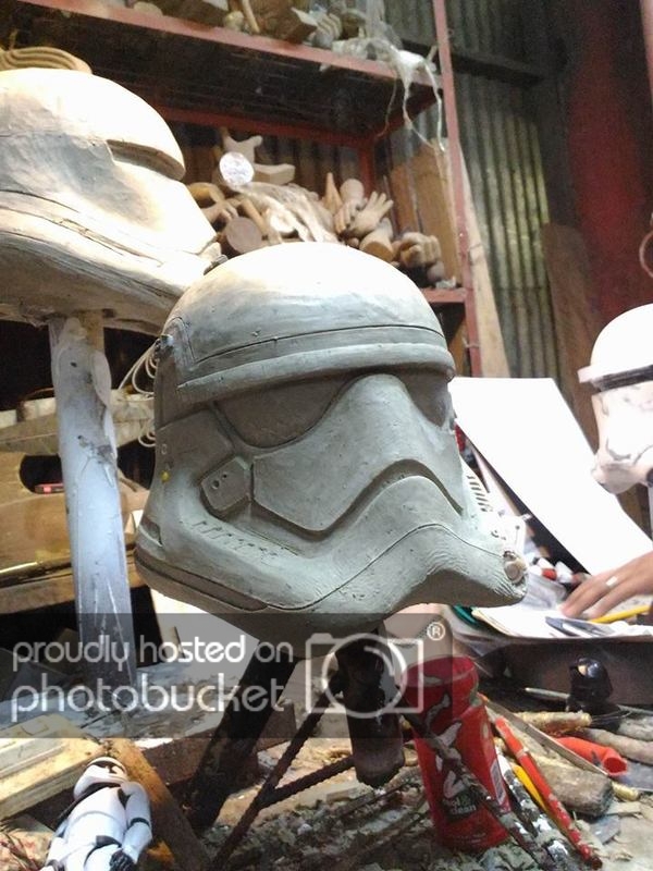

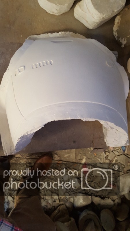

The studio elves have been busy over the break refining the sculpts.
Also working on a more accurate ver 3.0 FOTK bucket.
*Disclaimer: No Anovos armor nor pictures of Anovos armor were used as reference for the updating of my sculpts out of respect for their own sculptors.

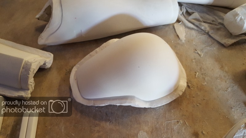

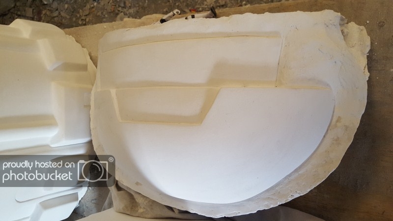

I'll throw this in the mix as well:
tie/snow longer shoulders

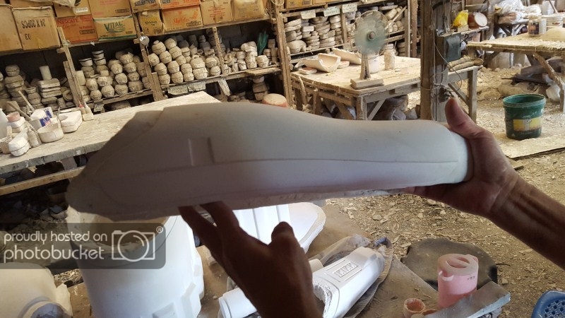

tie/flame forearms: (still need to adjust the vents)

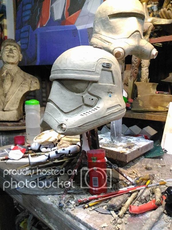

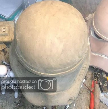

FOTK bucket ver.3.0

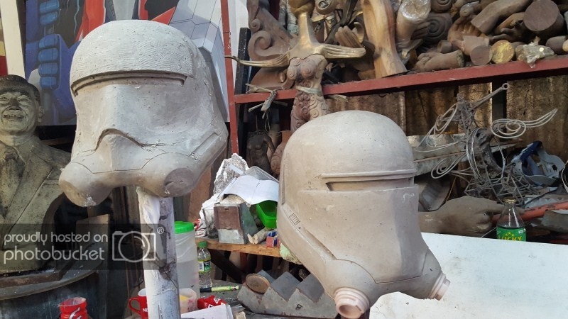

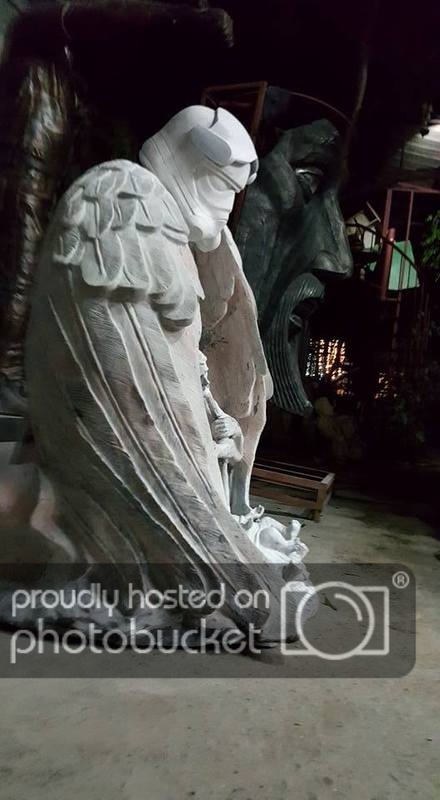

There's also this curious piece:
The studio assistant placed the freshly primered Tie helmet on another sculpture's head and it just worked out...
