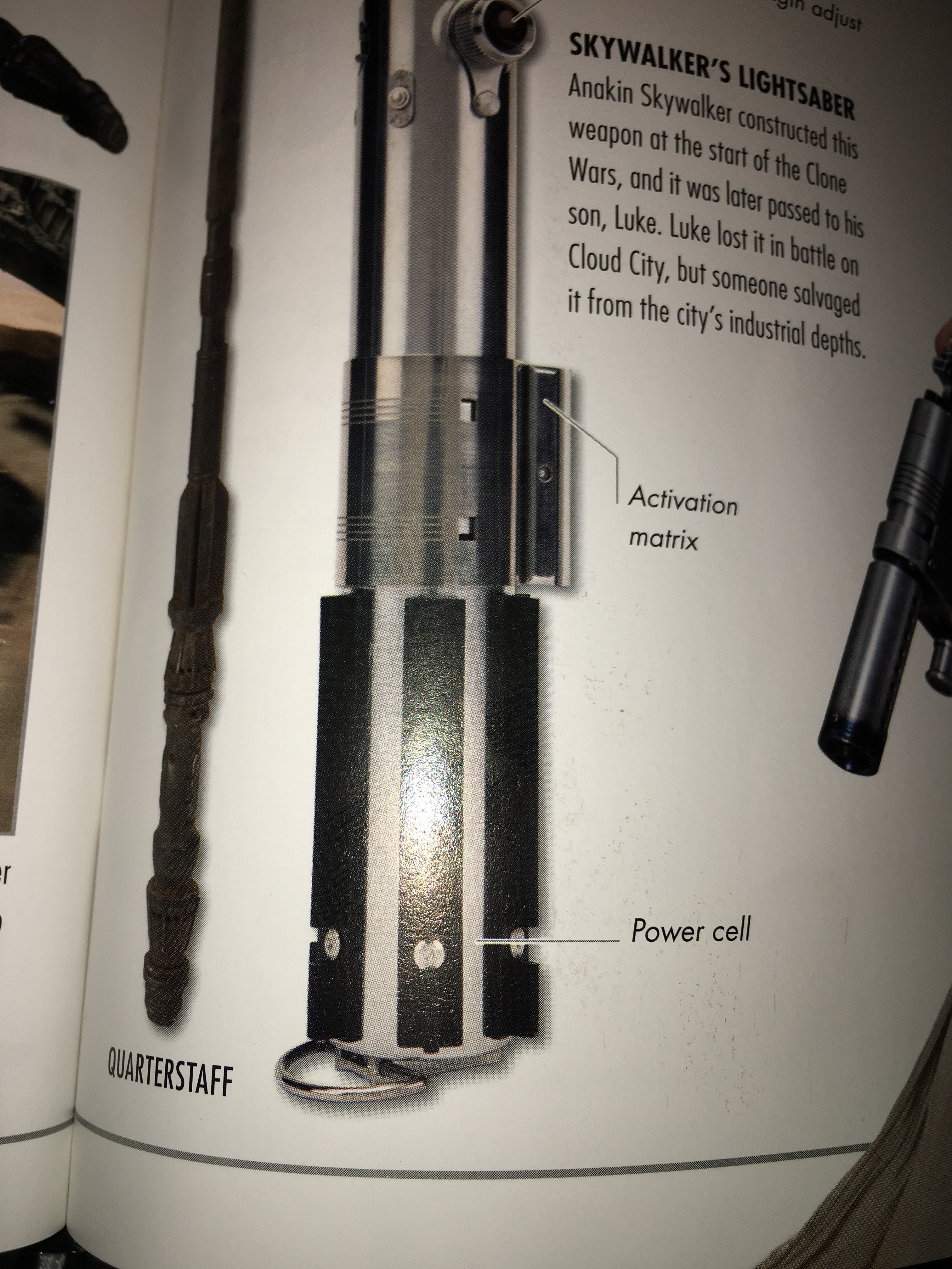

Not sure if this had been posted before, but the Visual Dictionary's saber has the shorter grips as well.
Just an FYI, the TCSS grips are too long to get that 1/8" clearance at the bottom for those going for that look. Those grips will give you about a 1/16" clearance while still being able to install/remove the clamp properly.
Re: That's a Graflex, right (Force Awakens teaser trailer #2)?
I think the gap you're perceiving at the bottom is the Kobold clamp.
There is a little gap between the end of the grip and the end of the bottom tube, similar to the gap between the top of the grip and the clamp.

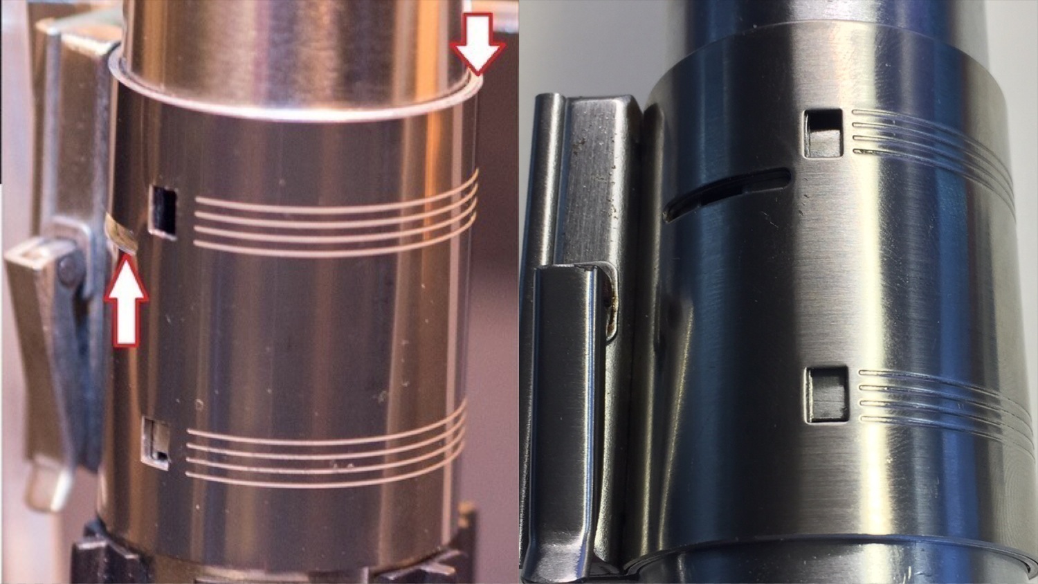

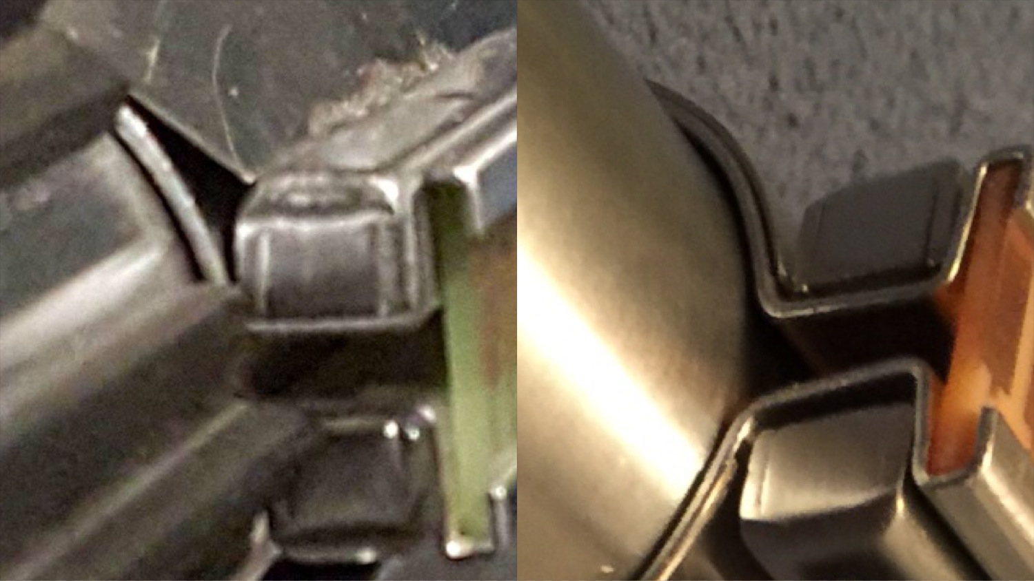

For me, yes. Others disagree.
Regardless of the actual material, though, that overlay is much thinner than the FX clamps, which rules out their use on the LB Orlando saber (left):
And we see in this closeup of the LB Anaheim prop (left) that there is a larger gap between the ends of the lines and the rectangle cut out than on the FX band (right). In addition, the rectangle corners are much sharper than on the FX, and again you see the thickness difference.
(ignore the arrows, they're from a previous photo in this thread)
If all the FX clamps have the clamp grooves distanced from the square holes as pictured here, then it proves that the film prop doesn't use an FX clamp. The spacing of this area on the clamp in the left picture as well as the one in the VD (which appears to be the same as the chest prop) matches that of an original Graflex clamp...
For now, assuming that the movie clamps are either custom creations or sleeve-wrapped originals is probably the most feasible.

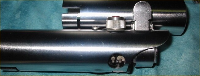

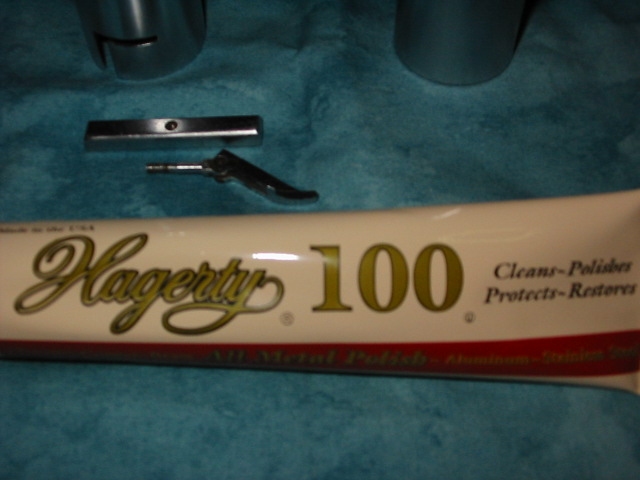

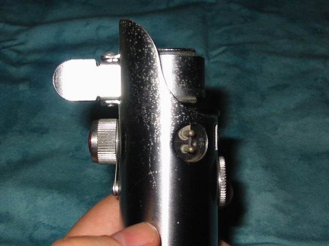

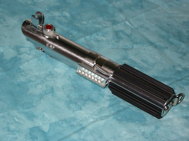

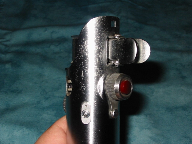

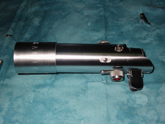

I'm tempted to try this or a similar product on my Graflex, but I'm afraid of it changing the finish. Did you experience this at all with this product? I'd like to remove a little scuffing, but not if it means the flash will look shinier than it should.
This is the product I used to remove the tarnish from my Graflex and some before and after photos. The metal polish worked great to remove all the tarnish, but I don't think it will help with removing scuff marks where the metal is actually scratched or otherwise damaged.
Thee photos are from when I originally converted my Graflex (and only had a crappy camera) so please excuse the poor quality. Also, I've since replaced the bottom with one that has 7 grips and a D ring holder with only 1 fastener.
