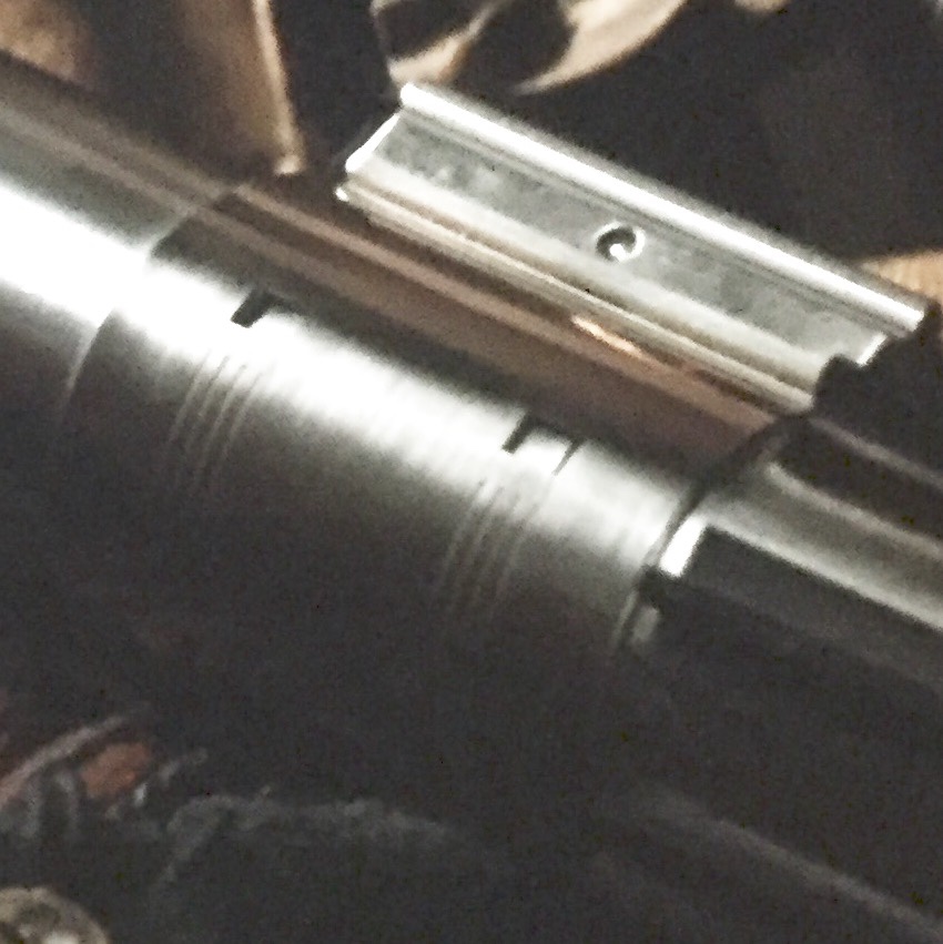

I just want to add that I went to see the film a third time today and I have to side with the thought that the film prop had the short grips throughout, I specifically looked for it in the snow scene. I am starting to think that there was indeed one hero prop version seen in the film with the shorter grips. I am pretty sure the snow scene is just a trick of the angle and there is a gap at the bottom as well.
Has there been any consensus yet on whether the grip gap near the clamp is due to the clamp not being pulled all the way down or if the grips are shorter even with the clamp pulled all the way down?
If im not mistake you can tell by looking inside the square cutouts on the clamp.
If the clamp isnt all the way down it should be indicated by a hole inside the square.
All the way down and the tube should should cover the inside of the square completely.
You're right! In this picture I took from the Maz chest, the holes are indeed partially covered, indicating that the tube is all the way down, which again means that the gap would be shorter if it were up.
Excellent!
(Btw did you mean" partially" or fully?)
Looks like the tube is all the way down...Unless its an entirely custom made clamp (which may not reveal holes for some reason) we should probably wait to confirm with the BR,
Note- in the VD photo it seens o indicate the tube is not quote all the way down...theres a slight hole visible insude the square.
Also, is it possible that the other pics showing the grips going all the way to the clamp is simply a result of the tube not being pulled down rather than longer grips?
