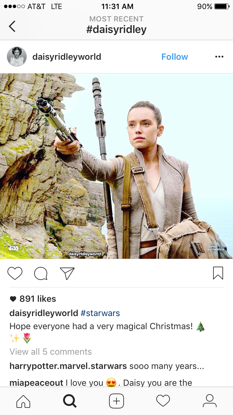

It's an on-set photo from EP8.
The lever looks funny because you've seeing the reflection of the lever on the clamp, giving a weird double-lever illusion due to the angle of the photo.
http://media.fotki.com/1_p,rttdgggt...ggwgws/9/976173/4001324/54505591014601-vi.png
this is where i wish i had social media... just too much drama that comes with it. i agree with you again, looks like shadowing. i imagine its the same saber used from ep7. i wouldnt doubt they made a few more of them, and i wonder who they used for the props this time around?
thanks for clearing that up... she must switch hands because in ep7 she's holding it in her left
I am going to use rivets myself for mine once I get Roman's Graflex on Monday. Not only because I think they work fine for TFA, but also I want to build mine as I think the TFA prop guys did as an idealized version between the previous sabers. I almost wonder if grinding down the glass eye was intentional just to give it a hint of gold as in the ROTS saber. Crazy idea I know.
As for that EP VIII pic above if that really is the EP VIII saber it looks as though it could be the same Hero prop as nothing stands out from the TFA hero. Everything appears to be in place invluding the orientation of the circuit card and the D-ring. I say IF because it could be that they are using the TFA saber again as the EP VIII hero or it could be they just used it for that scene since it was early in production and there is a new EP VIII hero.
Good catch on the saber being in her right hand. At first I wondered if it was mirrored which happens often to promo photos but then the Graflex would have been flipped.
