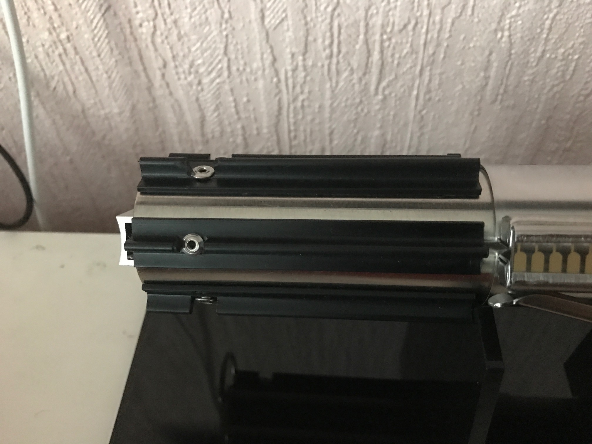

Ive got some TFA Roy grips on the way and i noticed that I may have a possible problem when attaching the rivets.
I have a rivet gun that has 3 different tips for different sized rivets...it seems that these tips may br too large to fit into the girp spacing for the rivets.
Have any of you had a problem with this before?
I had the same issue so I used a small nut which filled the gap (as Lichtbringer suggested) which worked but was fiddly

Just a word of warning though that I ended up using epoxy to secure the rivets from the inside of the tube. For some reason the rivets didn't close as they should have :confused

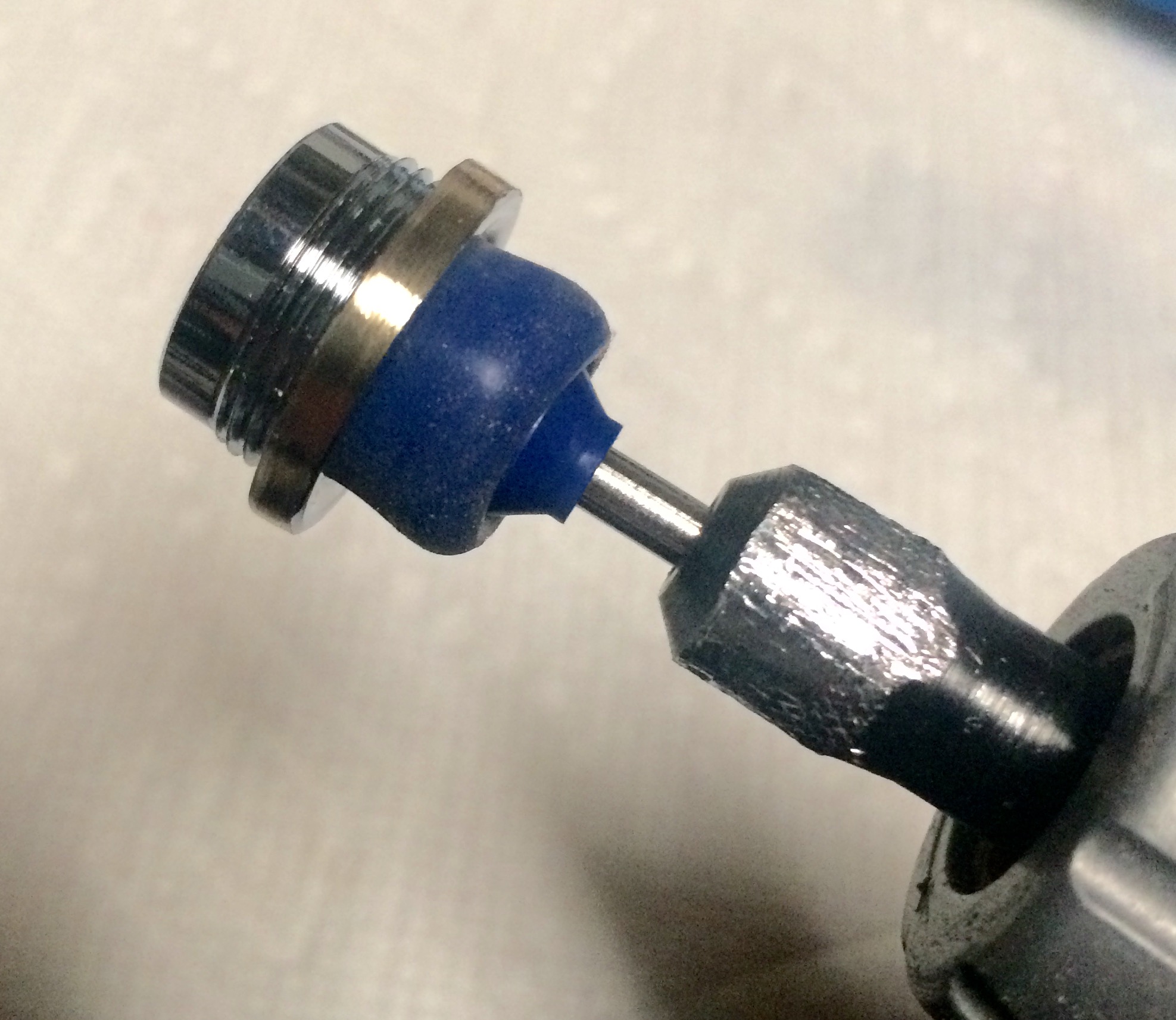

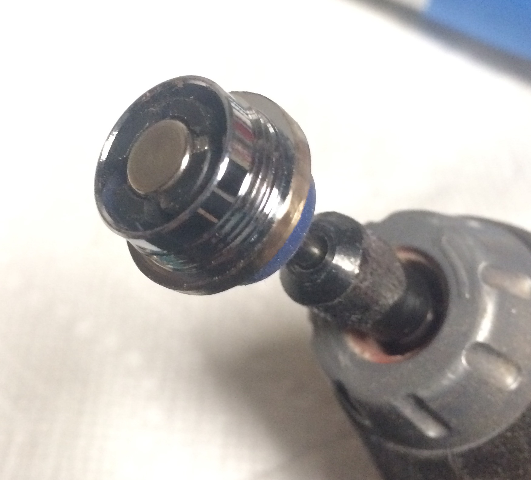

Here's my solution for turning a vintage style glass eye to remove the knurling. This is from Roman's new graflex. I pushed it on to one of these new-fangled Dremel drums that expands when you pop it down. It was a tight fit but it worked. Just ran it along a file a few times and then sanded smooth.

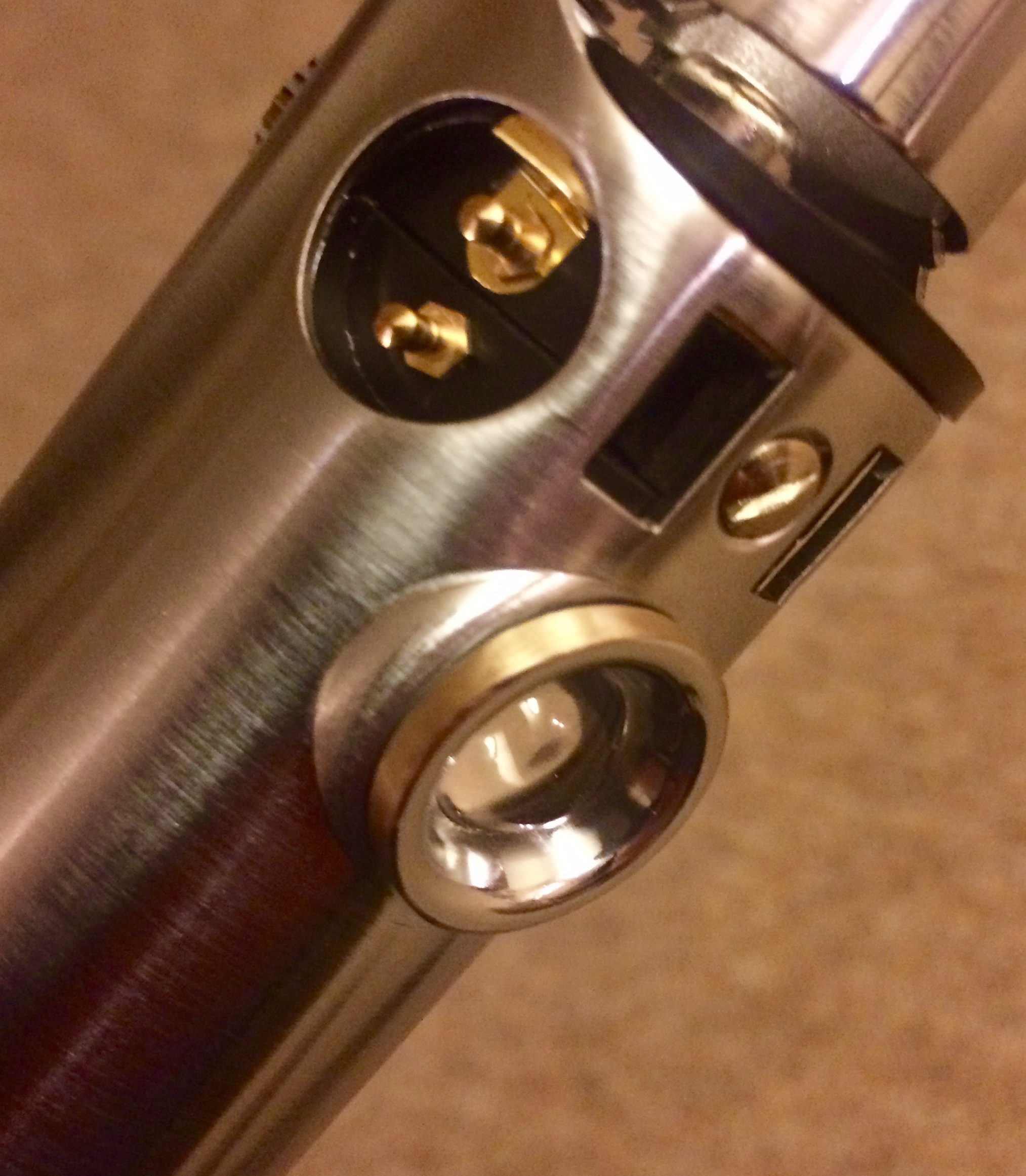

I still haven't decided if I want to file the glass eye ring. Remind me, there is a version that isn't filed in the movie?
Everything seen onscreen is filed. The Maz Box variant could have knurled, it's seen from the reverse side.
The Launch Bay sabers, made from Graflexes by the prop team, are supposed to be accurate, but aren't. They re still knurled as well.
