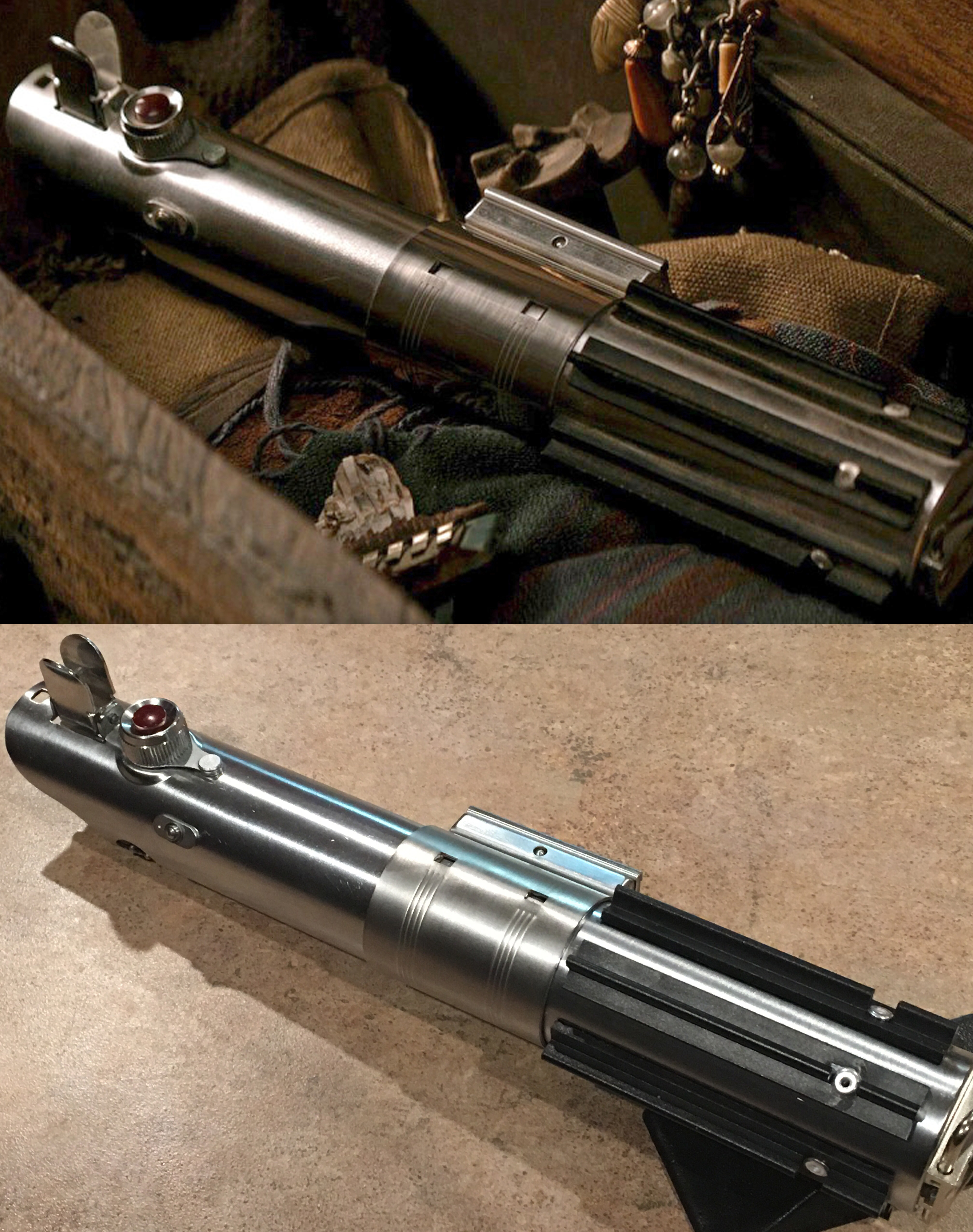

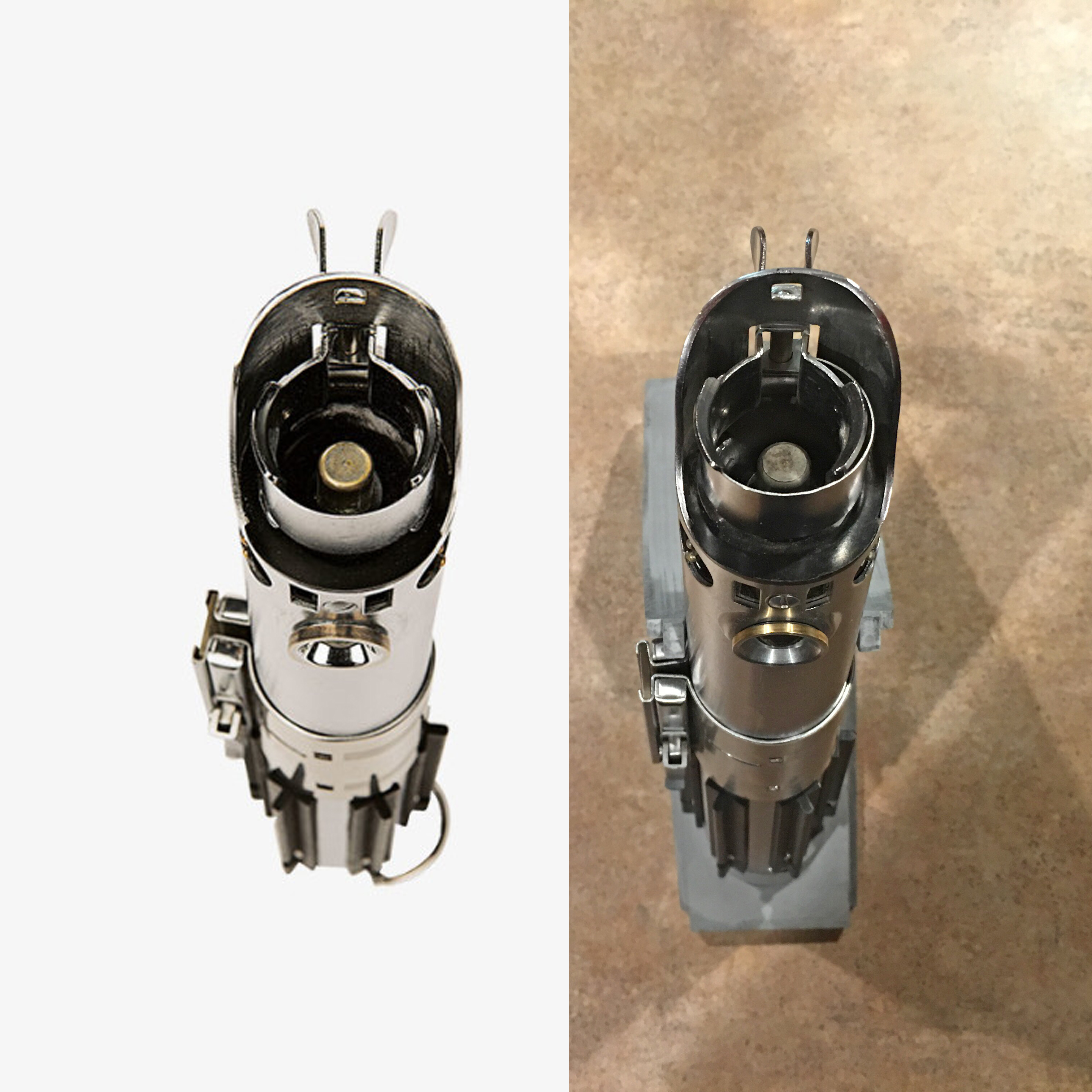

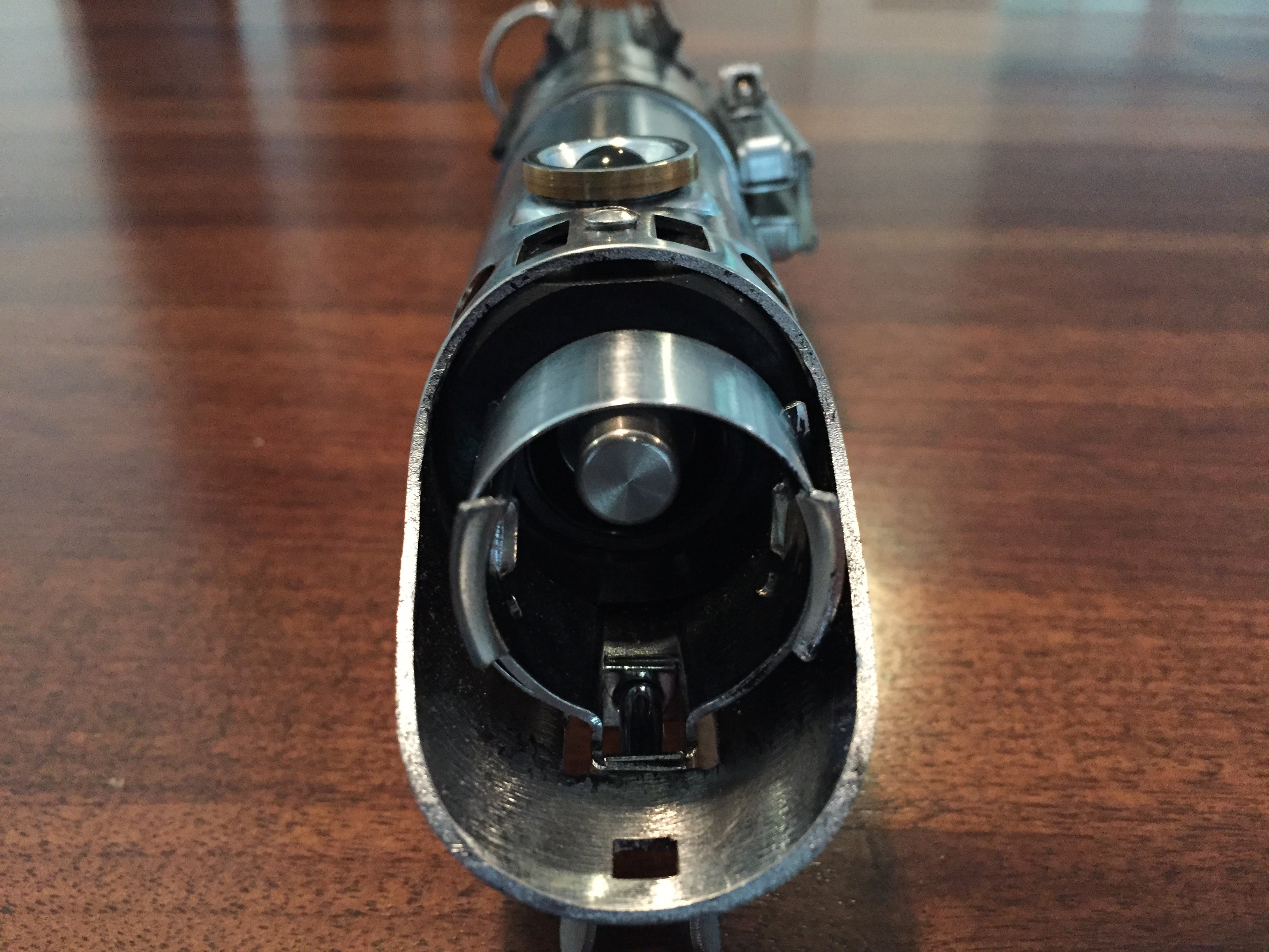

Hey guys, I've 'finished' my vintage TFA saber :D I used the Graflex 2.0 grips as potentially temporary options to make it look different from my ESB. I also went with the Maz box saber, again to differentiate. I accidentally cut the grips half a mm shorter than Roy's calculated dimensions but ended up with the grips looking much further than half a mil from the end than the movie saber, so I'm not sure what happened there:
View attachment 658062View attachment 658063View attachment 658064
Not quite sure why the RPF upload decided to rotate the images there...
Here it is in all its screenshot comparison glory :D
View attachment 658065View attachment 658066View attachment 658067
Thanks again to Roy for his screen accurate parts kit :D
God yours looks so much better :lol

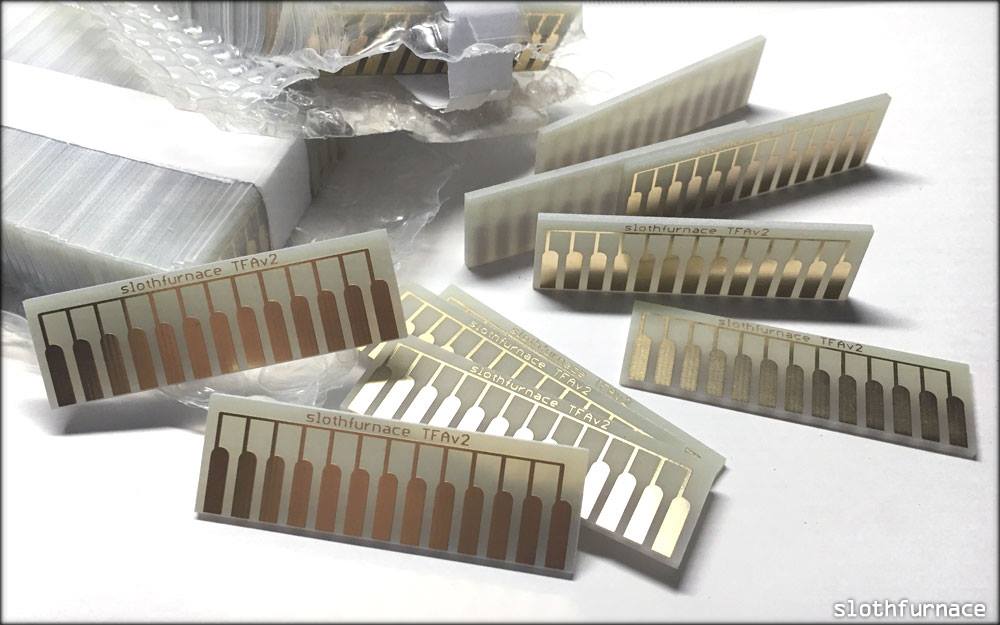

For what it's worth, my translucent TFA cards are here...
And though they're not as clear as I'd like, they are nice translucent FR4 PCB material, gold plated traces - selling them cheaper than my other cards as they didn't turn out quite as clear as I'd hoped. - $15, free shipping as always.
www.slothfurnace.com
now if we could somehow take the traces off yours and put it on Roys card, we'd be set!

I actually used the ANH style grips and flipped them so the original 'peg' for mounting in the 2.0 was nowhere near the rivet channel I cut in the grips :D I also cut that peg off...

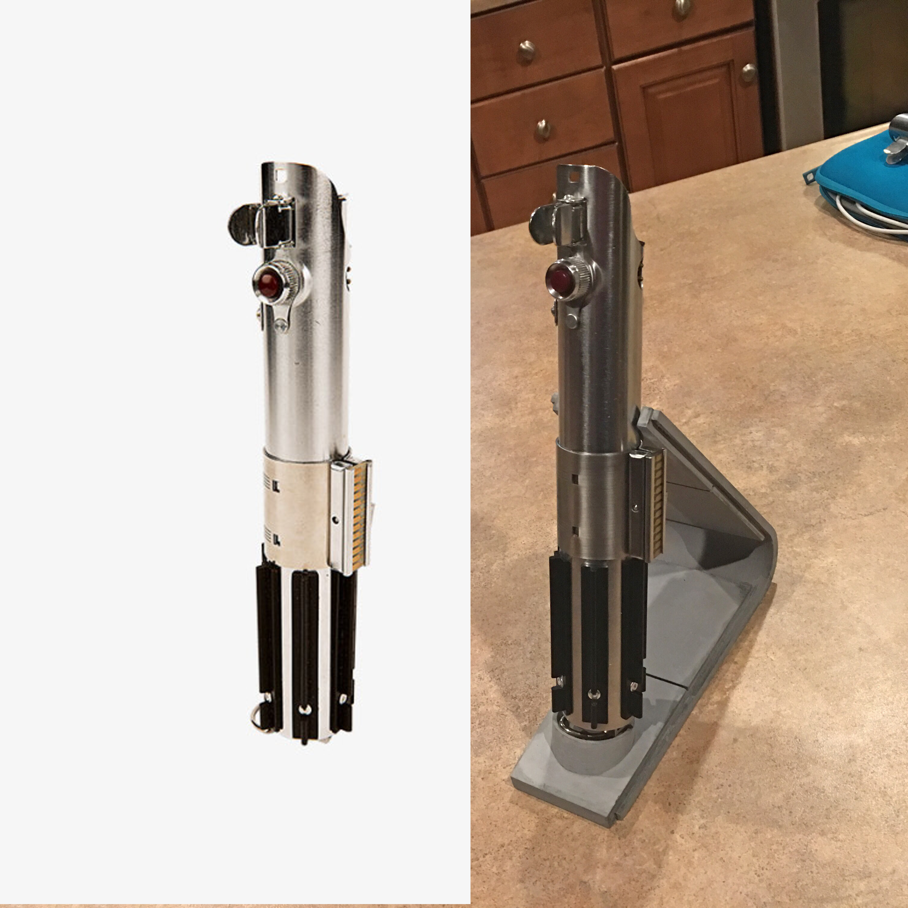

I don't know how I missed this. beautiful job!! where did you find that stand for the saber?! that's a genius design
Thank you :D It's my own 3d printed stand based on the PropShop ones for their lightsabers :) I might start an interest thread if I ever hit the required post number :lol I've got a few different stand designs and I always get comments wherever I post saber pictures so maybe I should take the hint ;)
oh defiantly count me in on a stand if you do! wicked nice!

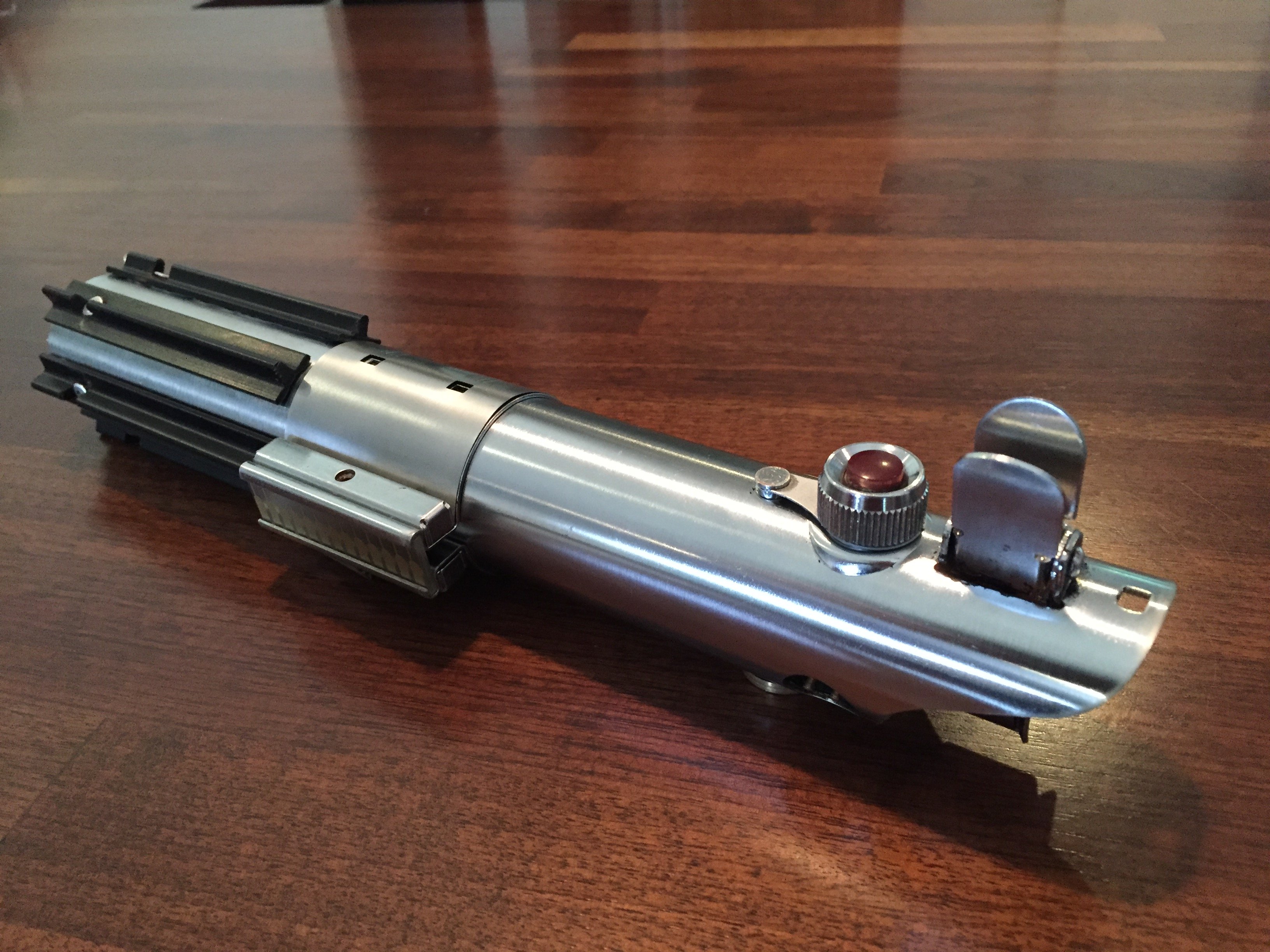

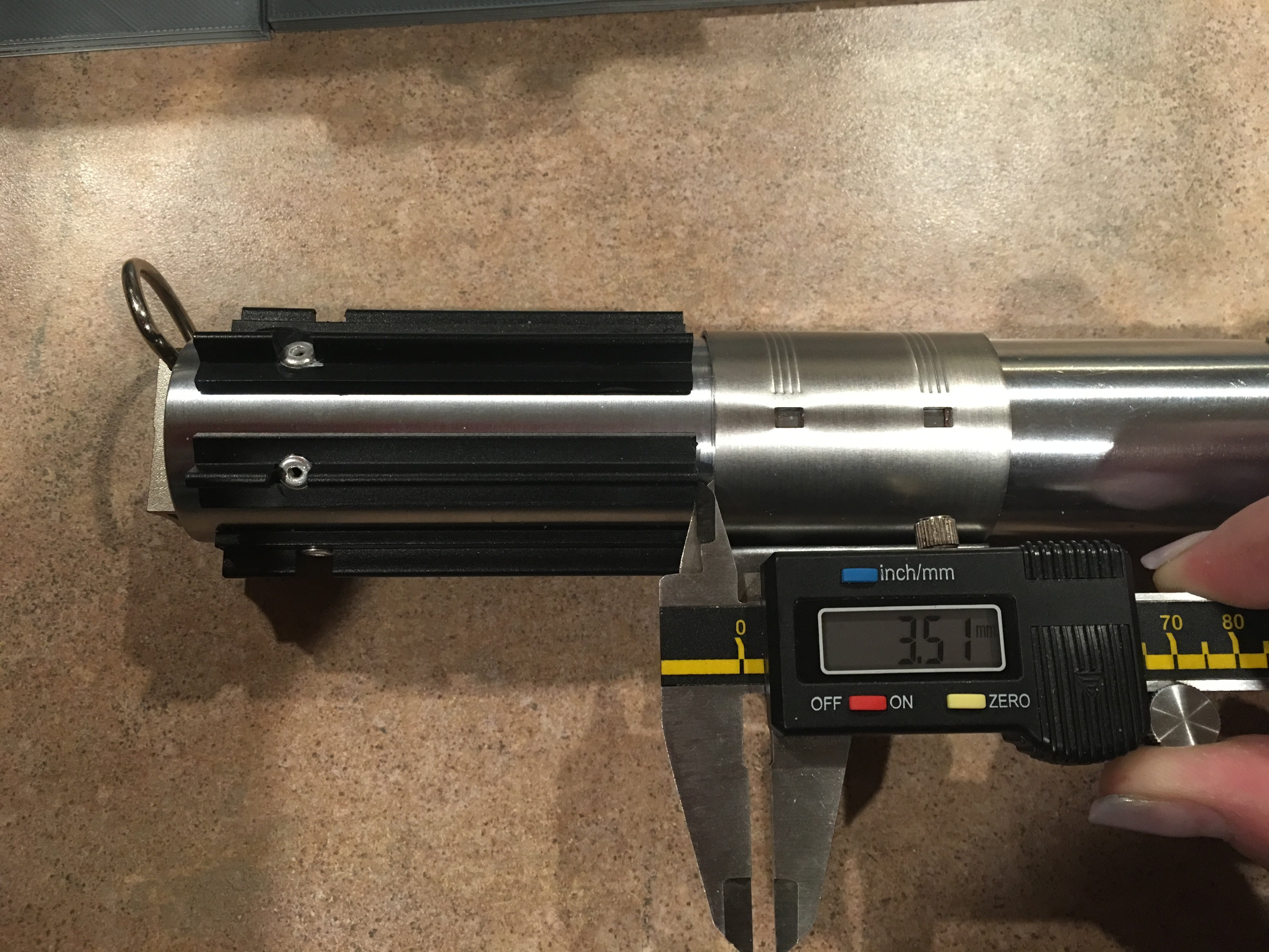

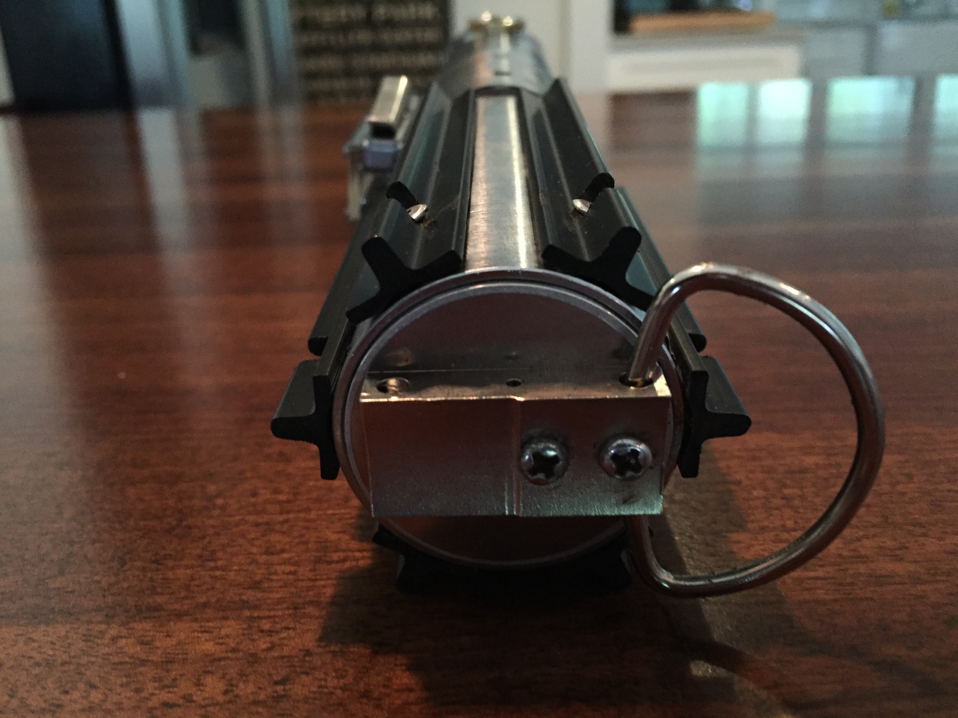

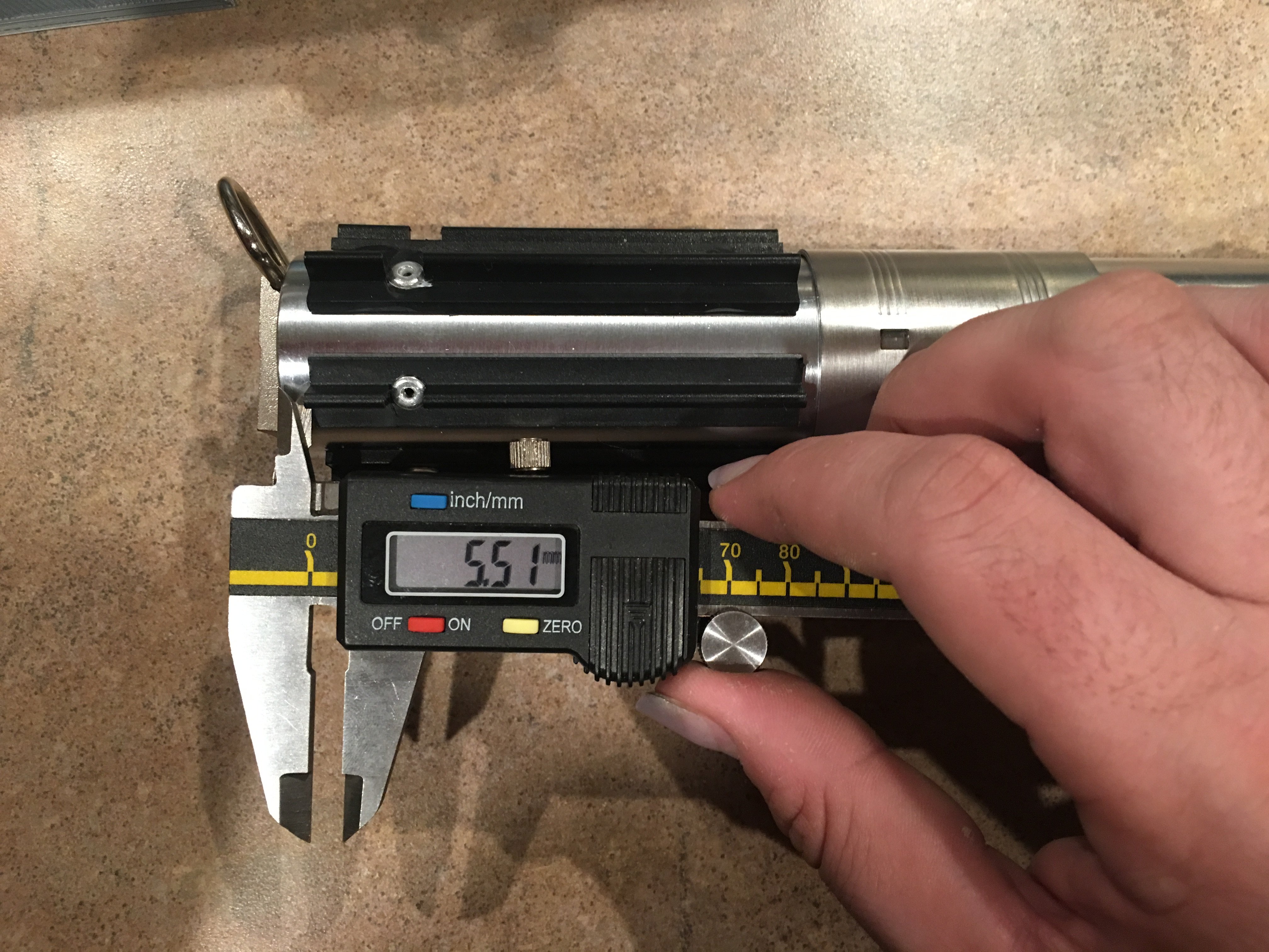

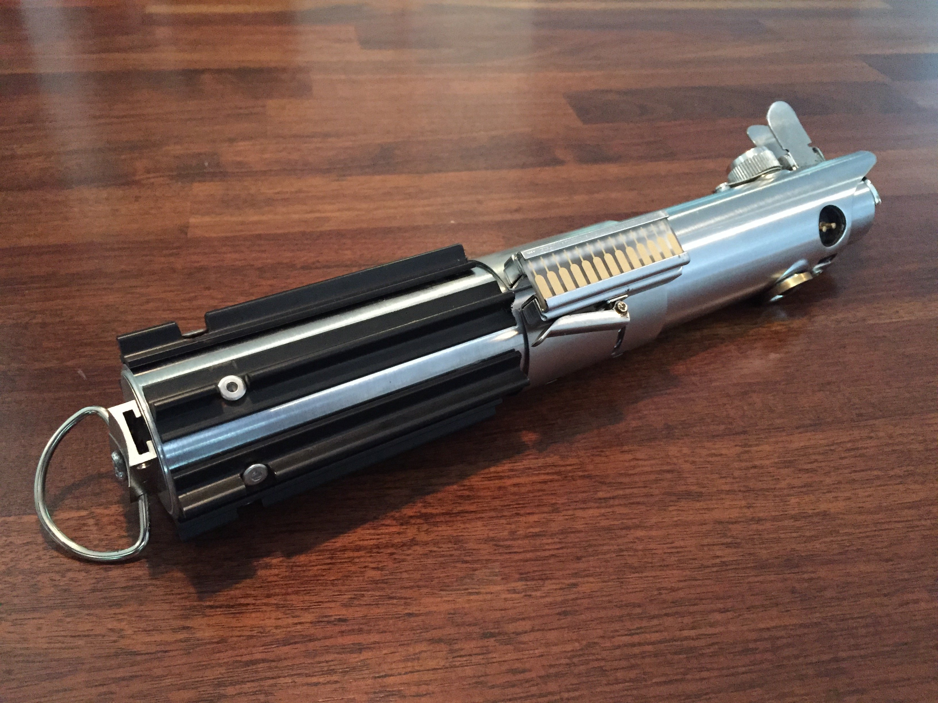

Hi all, today I finished my TFA Finn Hero :D. I started with the 2.0 as a base and for what its worth its pretty bang on. It'll be great for electronics too if I choose to go that route later down the line.. I used Roy's TFA set and KR Sabers emitter screw, blade plug, and slide switch. I had a spare beer tab from my ESB conversion and it fits great on the 2.0. I painted the 2.0 button burgandy but instead decided to go vintage. For the Koblold I used two old phillips screws from an old lightsaber toy mostly because I like the aesthetic. For the grips, I had a couple options- I had the stock 2.0 ESB grips, TCSS rubber grips, the 2.0 ANH grips that I could manually notch, or Roy's grips that came with the TFA set. I originally planned on using the ANH grips but I found the plastic to be pretty unforgiving so I used Roy's. I cut the grips so the dimensions of the notches are accurate and the overall length is long enough to keep a 3.5 mm gap from the clamp. I knew that if I cut the grips to an accurate 88mm then the gap between grip and clamp would exceed 3.5mm. I think they're 91mm, same as the 2.0 grips. For the rivets, I took the pins out, cut off the heads and super glued them to the grips which were then super glued to the 2.0. I'm pretty pleased with how smooth this process went and wish I did this on my ESB. Anyways, here it is:
View attachment 661631View attachment 661632View attachment 661629View attachment 661630
Nice job Puffchin. :thumbsup
